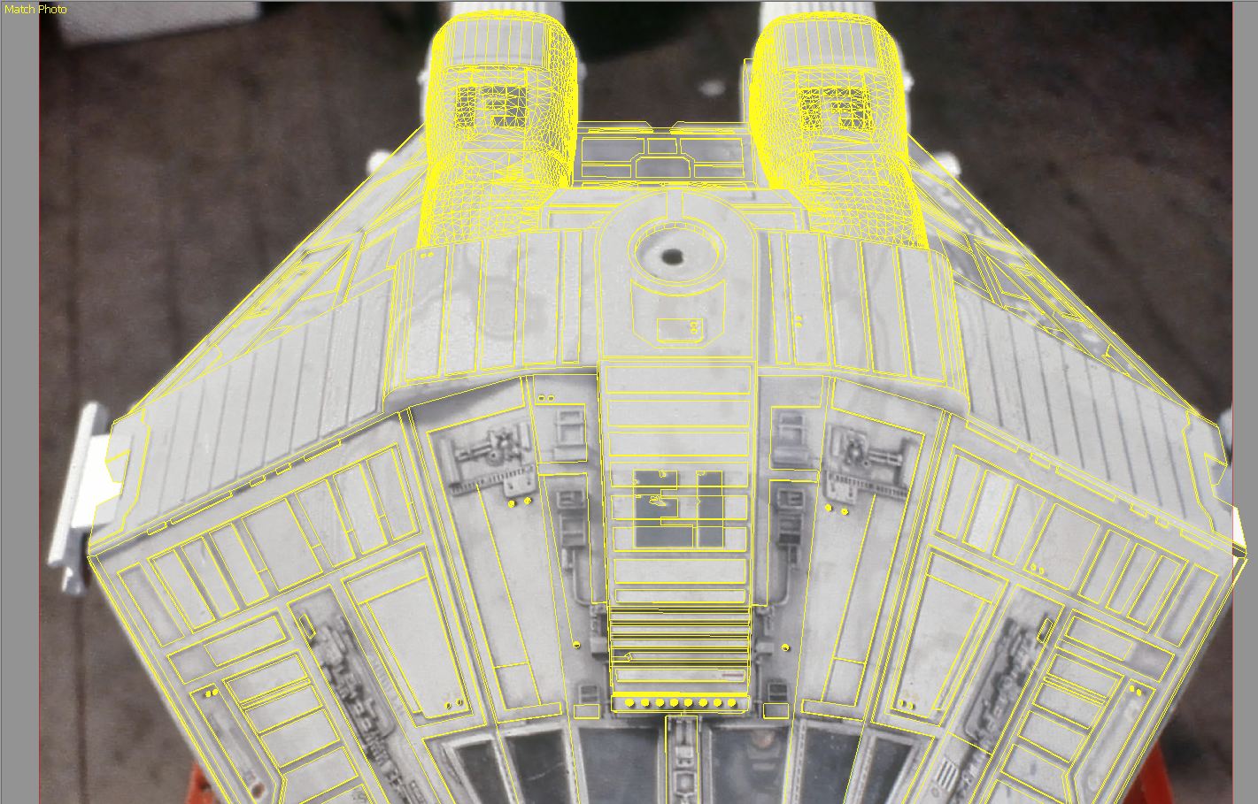

I just need to confirm their exact location and size using the 3D model overlay.

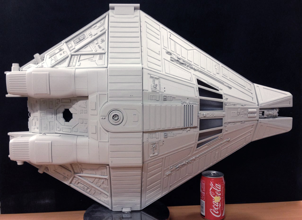

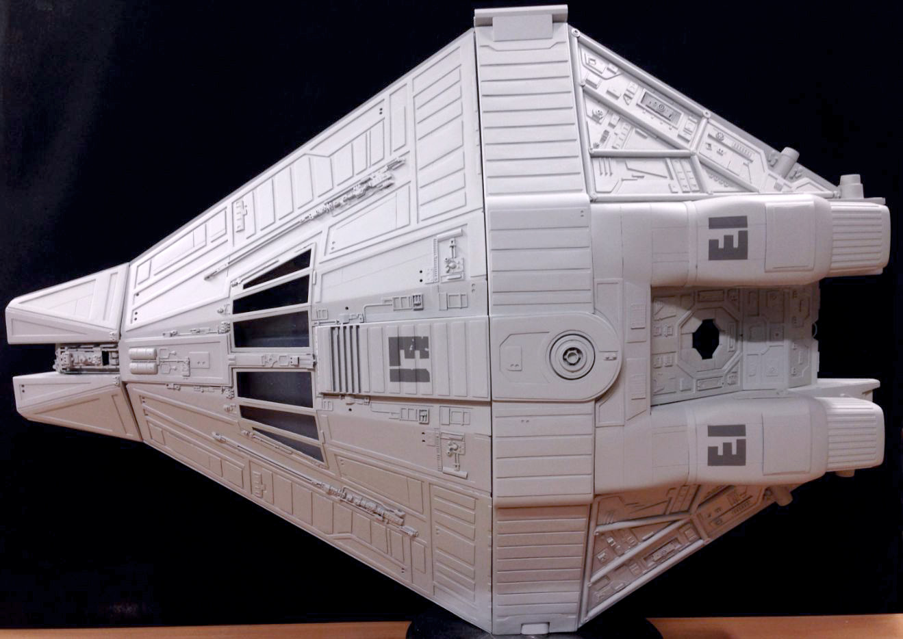

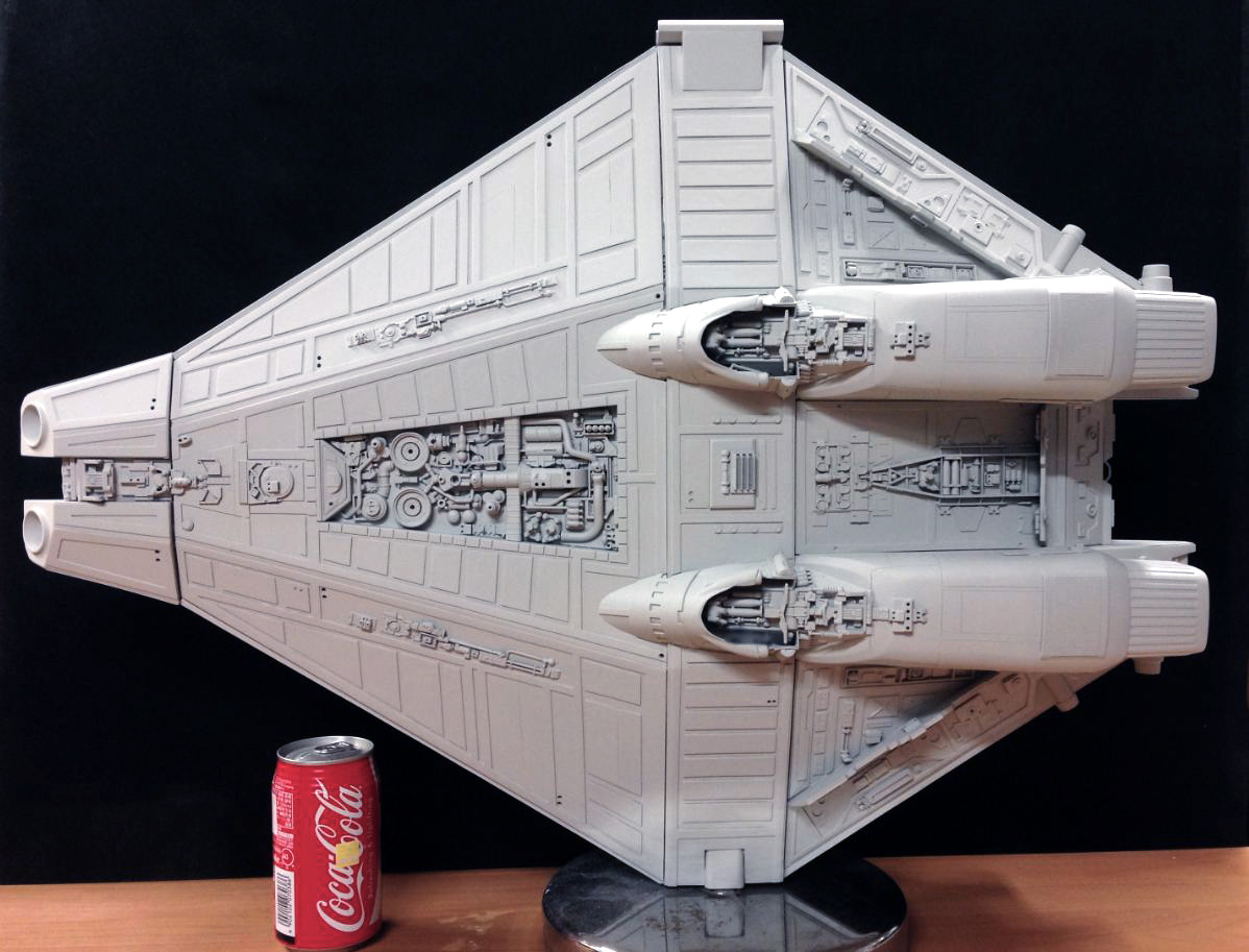

And we have a white ship!
Painted with auto primer - as per the original (according to Phil Rae).
She looks just as she would if she'd just rolled off the production line - not a scratch or mark on her.
That will all change shortly...;)

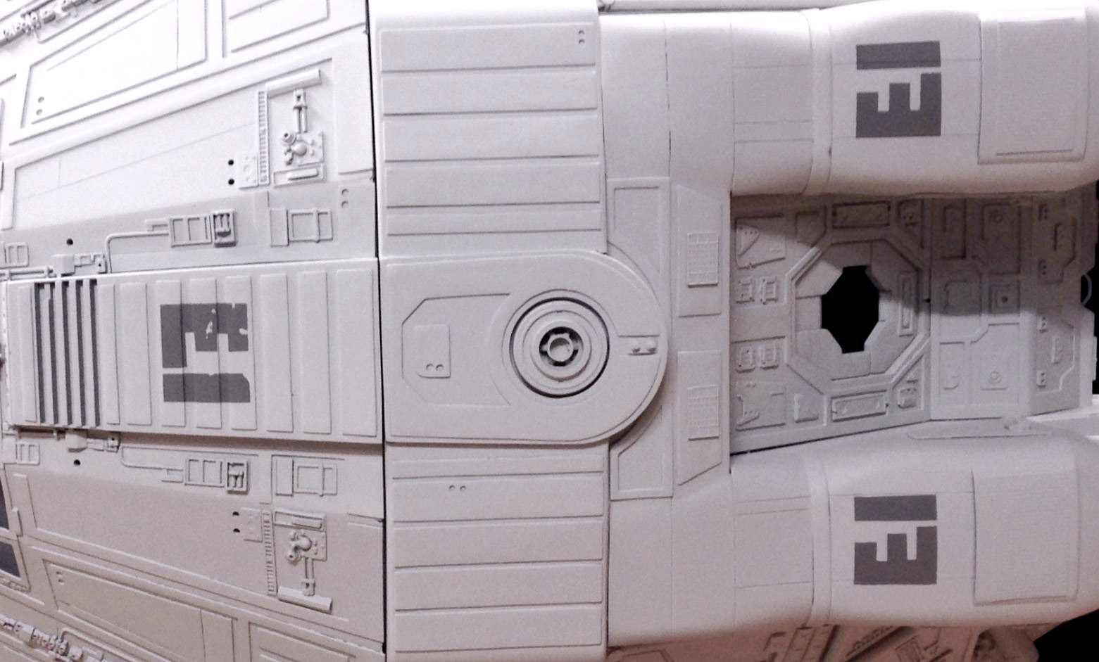

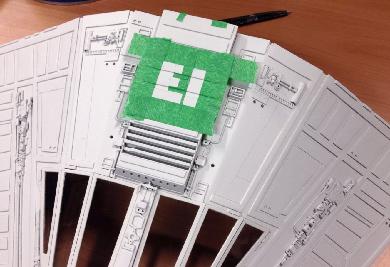

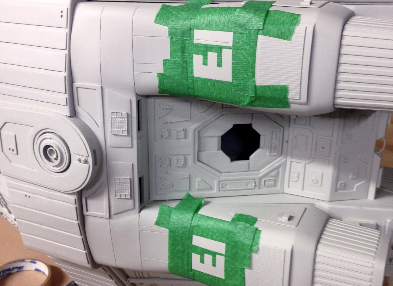

I have mapped the "E1" markings to the 3D model and will be adding them shortly.
The "E1" markings have been added.

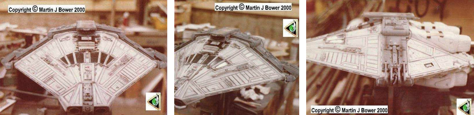

On the original model, they were masked off with tape to create stencils.
You can see them on both the front and back of the ship in Martin Bowers BTS photos below.
I believe they were then painted with grey auto primer.
I have also added minor damage to the front "E1" to replicate the marks seen on the original.

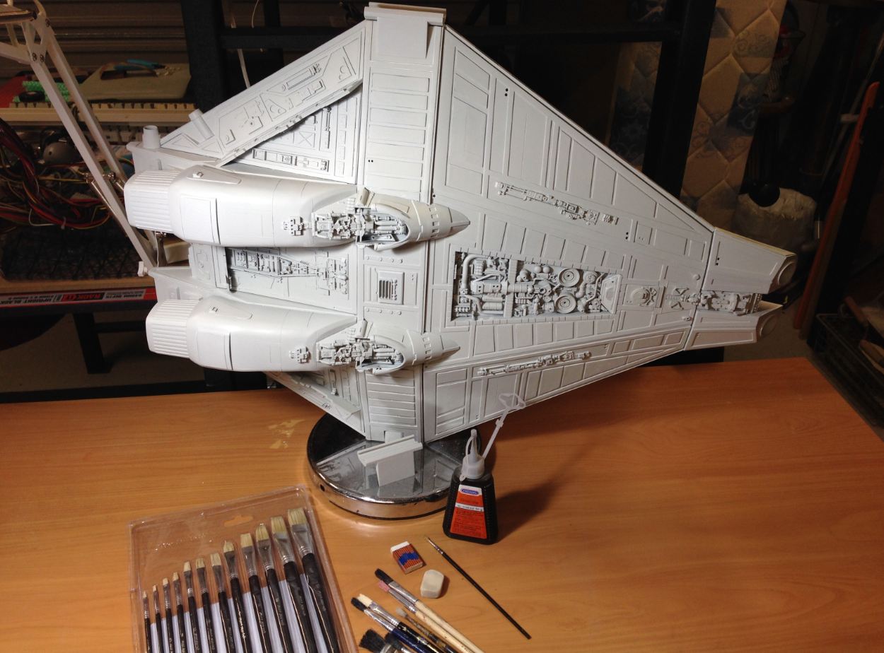

I took a step back from the ship over the break and spent some quality time with my family.
Sometimes it's more beneficial to do that rather than force yourself to keep pushing on and make a mistake.
I'm now back and refreshed and ready to take on the last steps to finally finish the ship off (just in time for the 40th anniversay!)

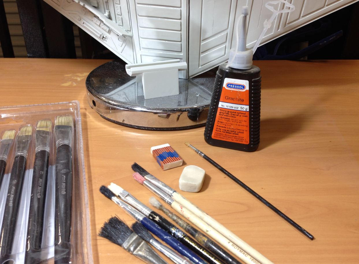

I've gone over the model with some wet and dry and brought it all back to smooth, ready for weathering - a blank canvas.
I will be using only graphite powder, brushes and an eraser for the majority of the weathering (in keeping with the how the studio model was done). I will also add the pencil and drafting pen markings used on the original and some black acrylic for the inside of the engines and some of the deeper crevices.
This should be fun!
More updates soon...
