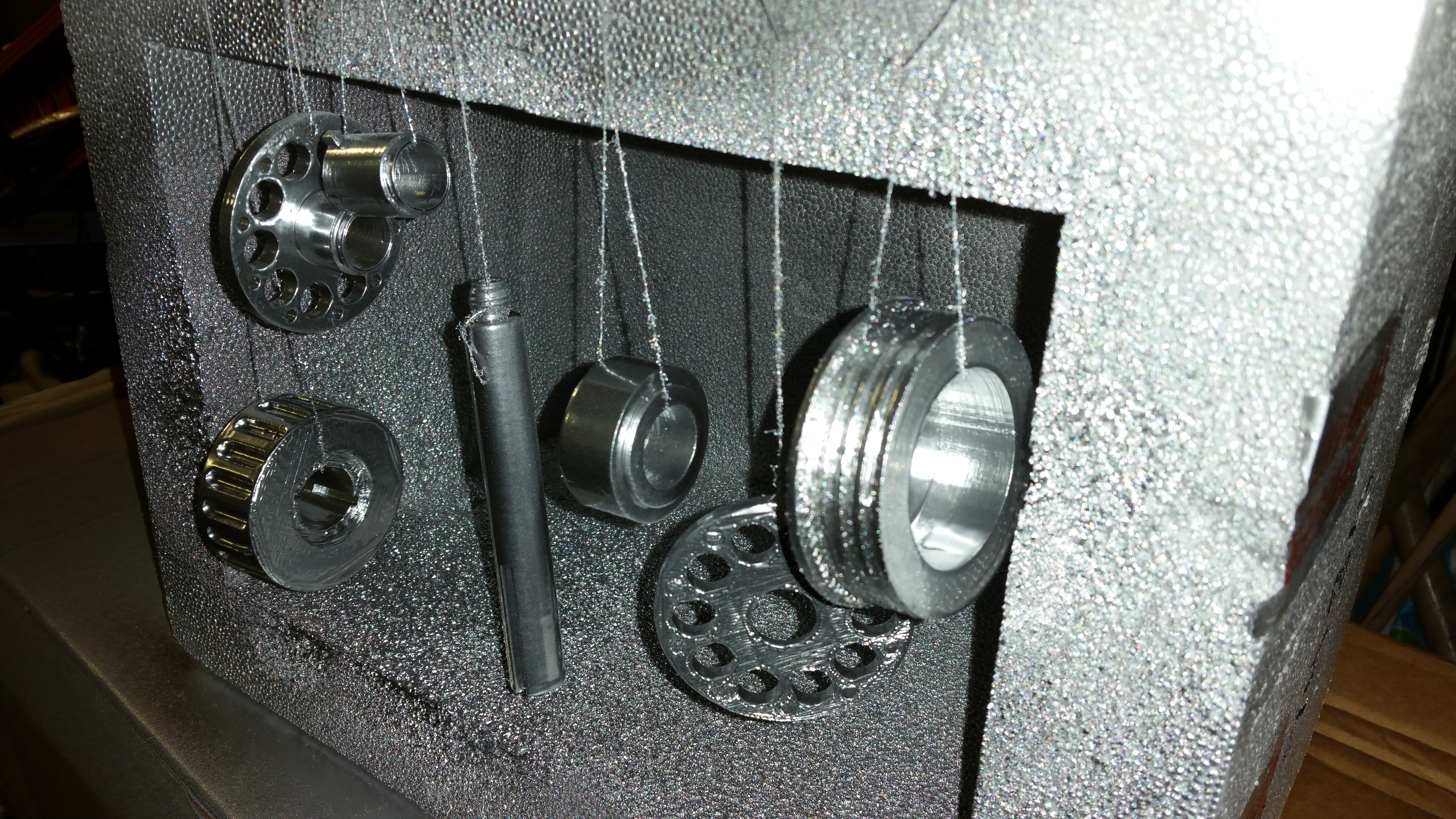

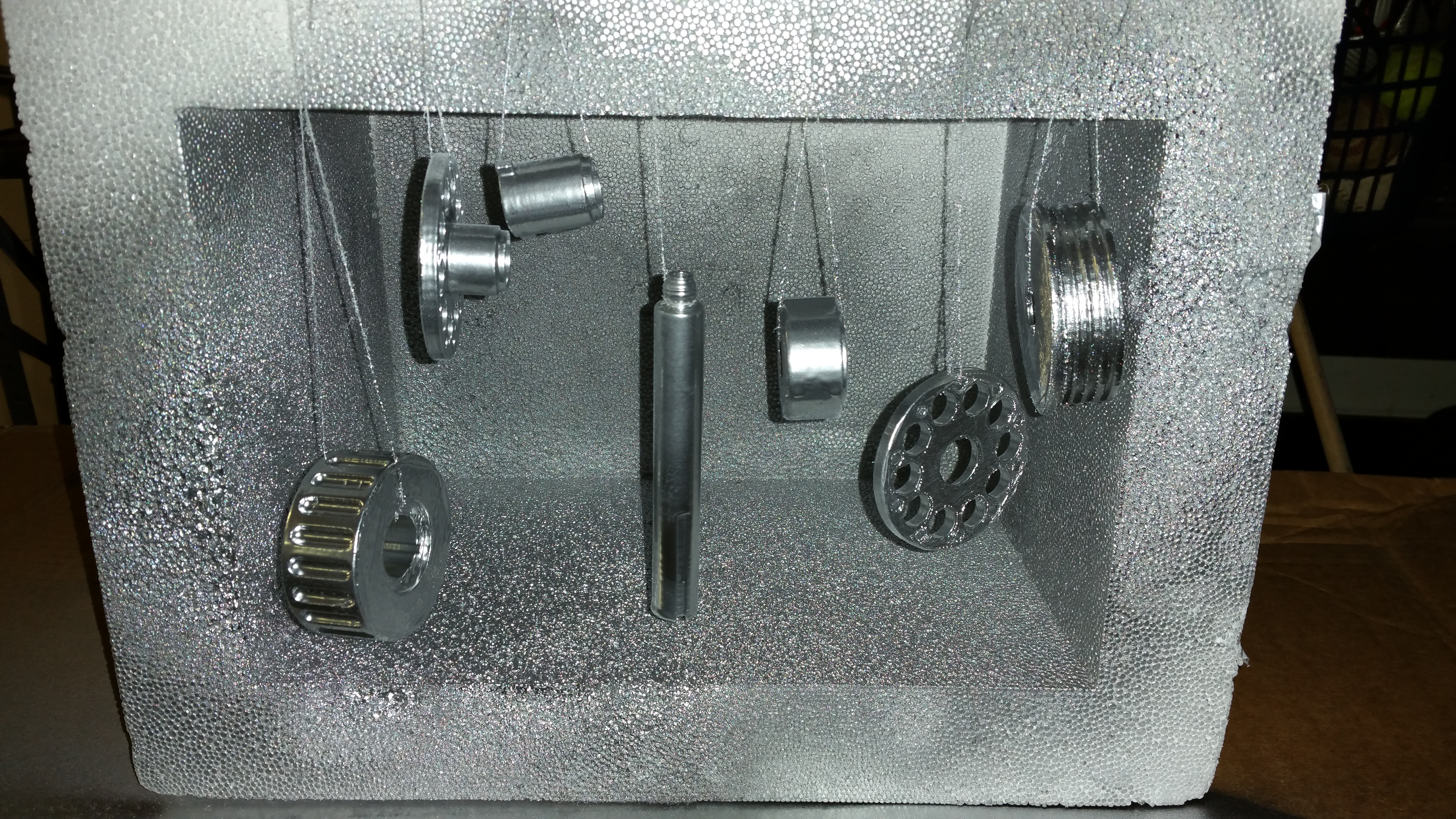

Yes, it's a 3d printed Jurassic Park Cryocan
edit: not sure if those photos will work, may be too large. if not i'll post 'em to imgur at a later time after i complete the project
