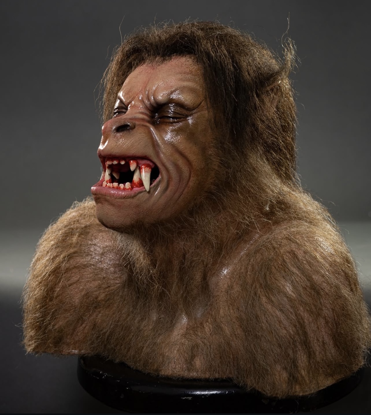

I think my preferred method is using the fabritac for 95% of it, especially where a full head of hair is needed. Prosaide is great for the hairlines and sparse hair. Also eyebrows.
I must qualify this by saying again I’m not great at hair work by any stretch of the imagination, but these pieces below show some hair work and styling I’ve done using the above method.
Thank you again! You have been incredibly helpful. I think your hair work is quite nice, that eyebrow is particularly impressive. I feel confident enough to give it a go now :)
