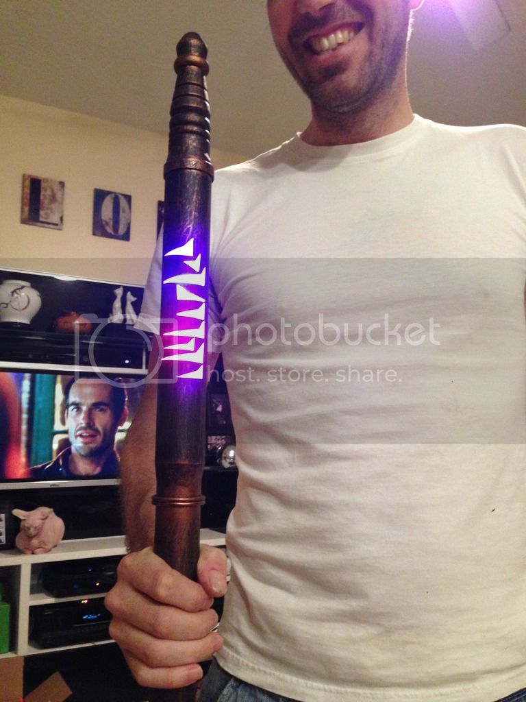

Acrylic won't stretch much, so it's difficult to do compound curves or vacforming. However, it will bend just fine to do simple curves such as cylinders.
I used OPTIX acrylic sheet from the local hardware store to make this tube on a wizard staff, using a cheap heat gun and forming it around a dowel. Masked off some runes with blue tape, gave it a paint job, peeled off the tape, then dropped some lights in to make glowing runes on a staff.
