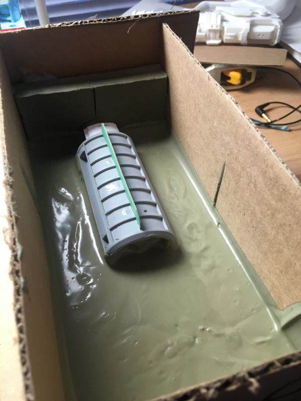

Thank you! I’m 1/3 of the way through molding the barrel, and my brain has been hurting trying to think ahead as well as inside out to alleviate any potential casting imperfection areas where bubbles could form.

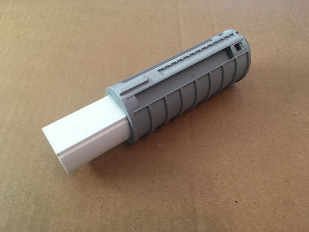

I had Skylu3Design model me a plug to aid in the molding process, which i had Rocketeer print on his Raise.
I glued the plug in place with thin CA

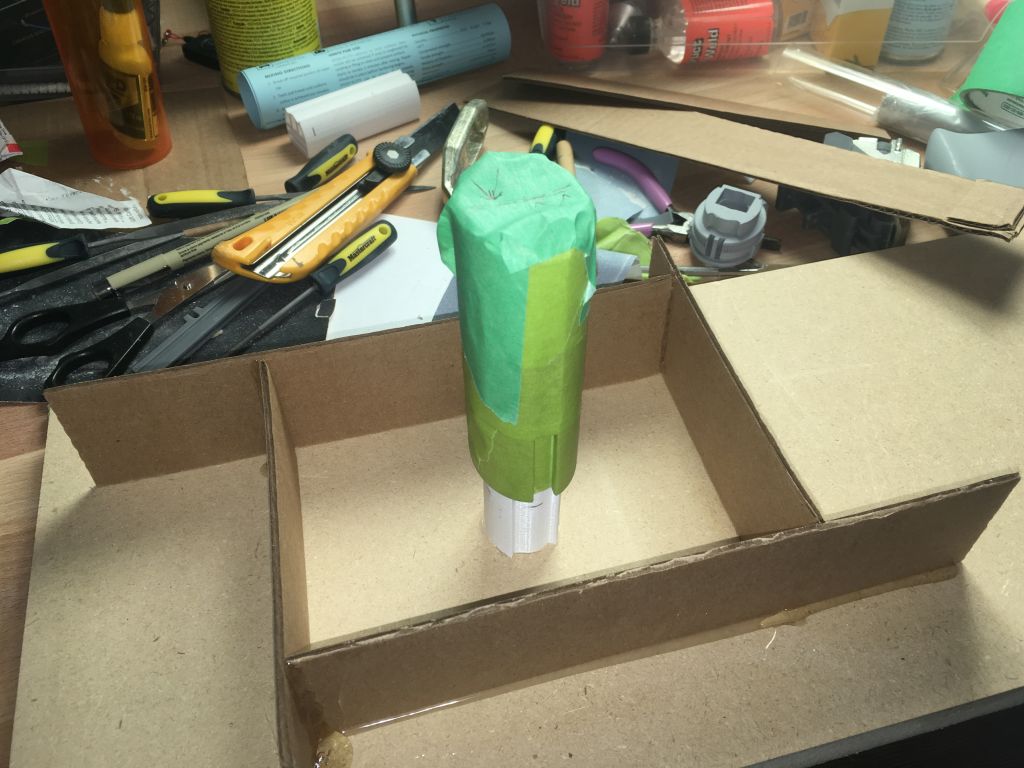

Taped off the barrel to avoid any unnecessary cleaning, and built a box to pour the clay into.

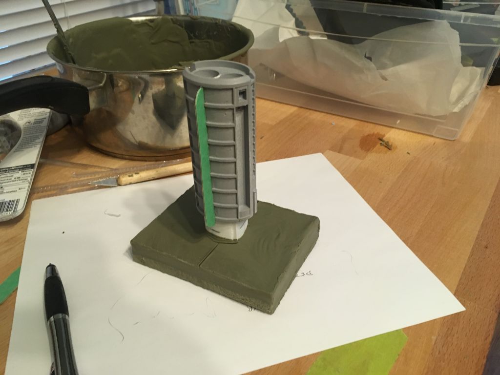

After pouring, i added an air bubble escape fin for when i’m casting the pewter.
I built a box and poured the clay.

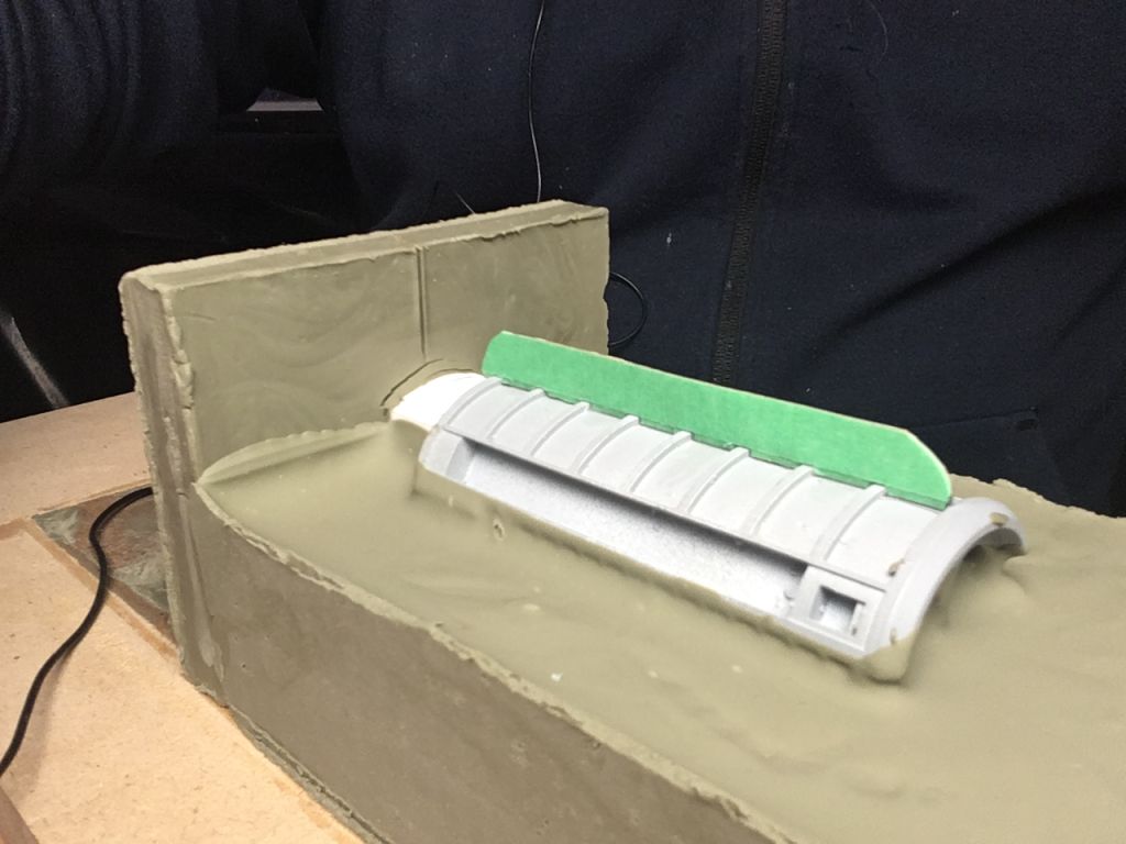

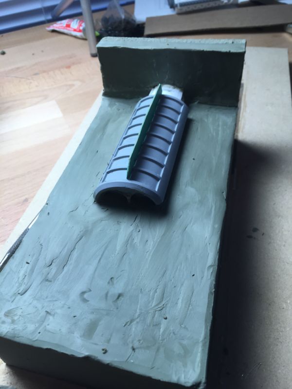

Removed box for better access to clean the piece.
The barrel just prior to Mineral Spirits wash.

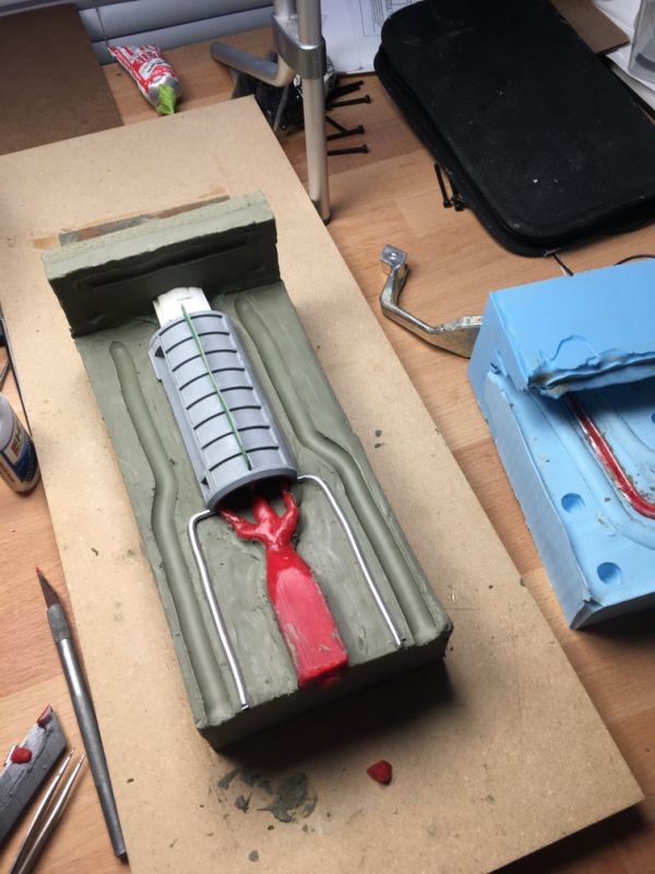

Cleap-up, sprue, and air vent complete.
After this, it was boxed and the first section of silicone was poured. It’s currently post- curing in my workshop with the heat cranked.
I can’t put it in the oven yet, because my wax sprue would melt.
