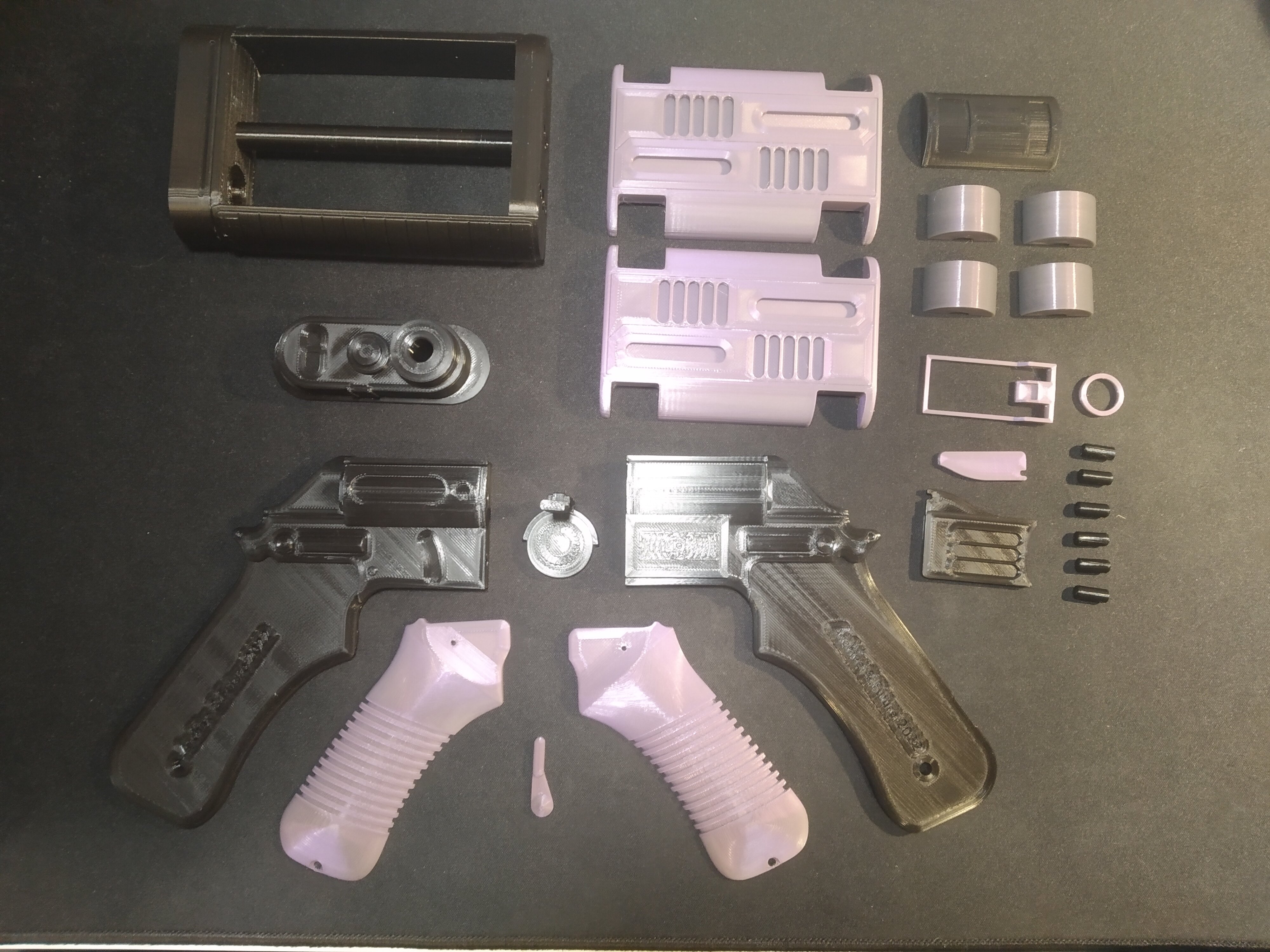

I have just finished printing the fantastic Archive&Future´s Andor blaster model that you can find at Cassian Andor (Andor Series) Blaster (MW-20 Bryar Pistol) . I´ll be updating pics in this post just to make me scratch the time to finish it.
I can´t stop thinking about how it can totally fit a sound board and a servo in the magazine to make it spin. I am sure he will eventually will add it, but in the meantime this is my little homage to the best Star Wars since 1983.
The printed pieces. The included 4mm pins were too small, so I scaled them to get 5mm ones. I used 100% infill as I believe weight gives more "feel", and to be able to sand and drill anywhere. I ran out of black filament and used a purple one, everything will be sanded and painted, so it´s not important:

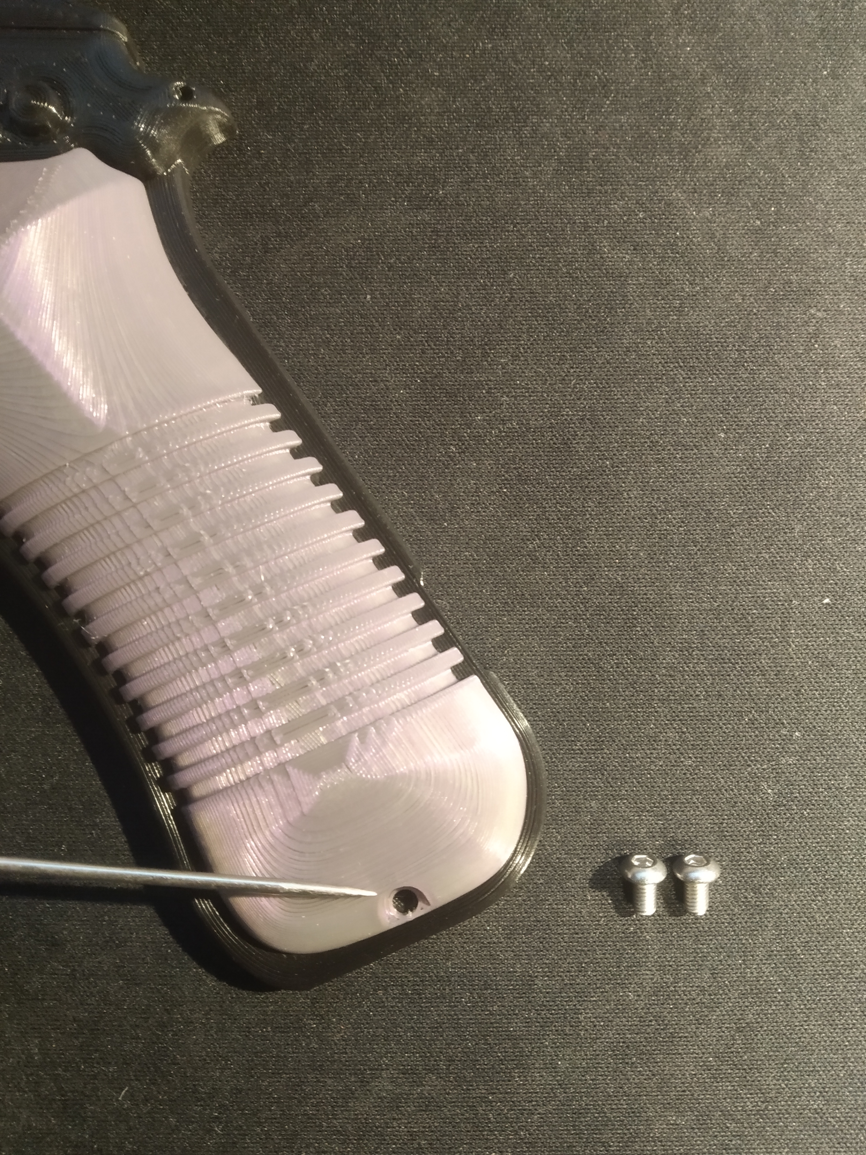

I will use M3x5mm hex screws to attach the grips:
