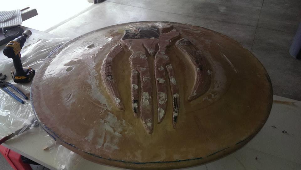

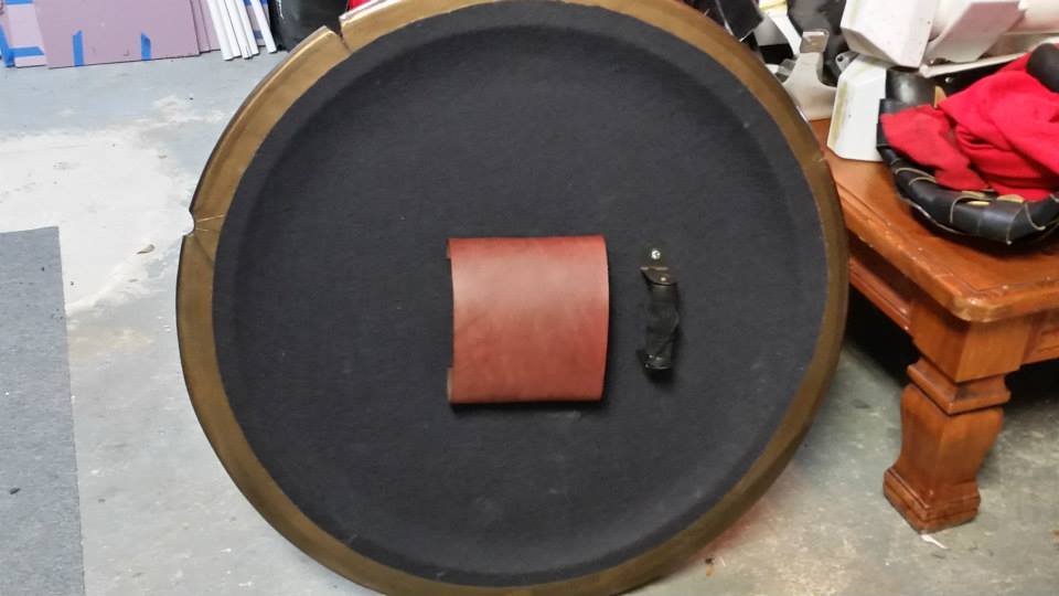

The shield:

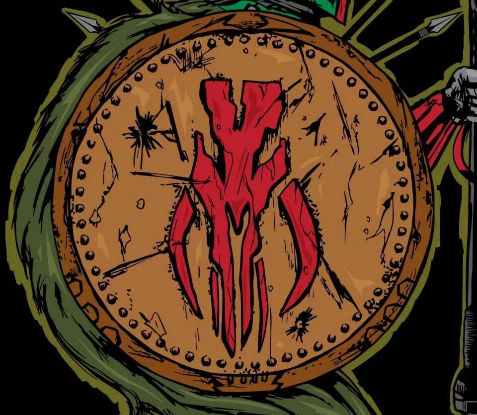

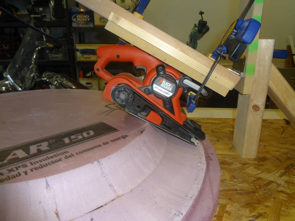

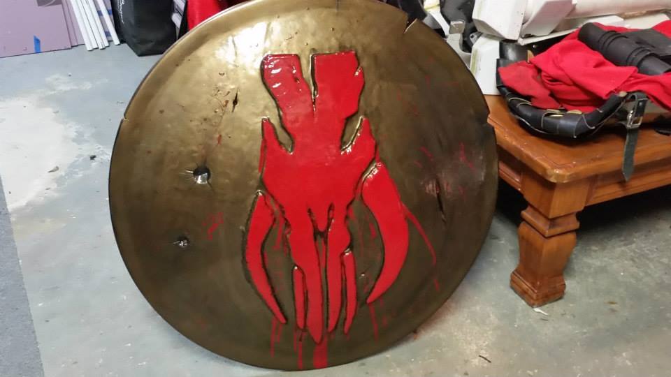

This was the first thing I was able to work on. I contacted Brian Kanoy and brought up the idea. He is quite a master with tools and creativity. We came up with a plan using home insulation from Home Depot as the core. We would then cover it in fibergalss. (My first time to ever use this.) To start we cut the 4'x8'x2" foam into two pieces. after gluing them together we put it on a spinning point and used a hot wire to cut a 3 foot diameter. We then used a table saw to cut the backside indent. Using a board with a nail we would spin the foam over the blade, move the board forward and spin again. This slowly removed the section we didnt want. Next we flipped it over and did the same on the outer edge. Next we used a belt sander, hinge, boards and clamps to create a sanding station that we could lower the sander onto the spinning foam. The clamps allowed for quick adjustments and angle changes. When we finished the was a fairly perfect dome. We then coated both sides in fiberglass. Using the fabric to strengthen the outside. We put an extra layer on the edge, knowing it would take some abuse. We then focused on the symbol. I reached out to Juan and was able to get a high res version of the artwork. After a little photoshop to extract the image on the shield, I printed up a couple of sizes to see what it would look like on the foam. Once we picked a size it was glued to a chunk of foam and traced with the hot wire. A real cow skull was used as reference on the symbols texture. Using the wire we cut a half inch thick layer and then mounted it on the shield. Many layers of fiberglass later (and lots of sanding) we had the core done. Brian made some screw mounts that we sunk into the foam and fiberglassed into place. A lathe was used to form the handle. A leather strip was used for the fore-arm brace and a layer of felt was glued to finish the back. Antique Brass spray paint became the core color of the costume. I used a bright red for the blood coating of the symbol. Using black acrylic paint and water I antiqued the front and edge. A basic clear coat was applied to finish off the project.
