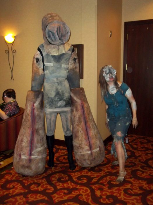

This is a rather large monster from the video game Silent Hill 3.
I wanted the costume to have the same imposing height as the one in the game, but did not want to use dry wall stilts to add the height to the form. If I had used dry wall stilts, the legs would have had to be made thicker to hide the placement of my feet and the proportions would have looked way off.

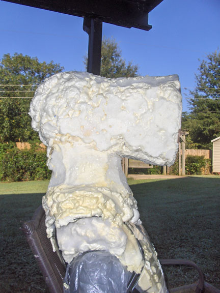

I took my Motocross chest/shoulder armor from a previous costume and filled it's interior with expanding foam while it was on a duct tape torso of myself. Some cotton batting I used to fill the space up inside the shoulders got stuck in the expanding foam, but it's not big deal. Using more expanding foam on top of the shoulders I built up a neck and eventually the head, all as one piece.
My intention was to keep it all one piece to make it easier on my neck when wearing it, but I wasn't happy at all with the lack of movement that caused. More on that later.

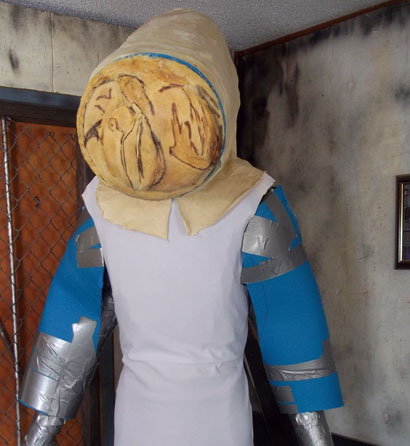

To add bulk to the shoulders of the upper torso, I bought and cut down two large mixing bowls and also attached them with heavy gauge steel gauge wire. Attach the head to the shoulders, but also to allow for movement and to reduce pressure on my neck, I added to screen door springs to the suit, from the helmet to the back of the motocross armor. In this image the springs are parallel, but I discovered that crossing them over each other allowed for more tension and when I covered them with pipe insulation tubing, like this:
It added even more support for the head.

Hours later, after fully coating each of the lower arms with latex, I mixed latex and a little acrylic paint together and began to paint them to look like living flesh. I did not want it to come off as just bland and one color. Sure Silent Hill is full of dirty dusty colors, but this thing is a living creature and I wanted it's "skin" to look alive. I also replaced the blue camping foam on the upper arms with more mattress foam. It gives way more flexibility when moving. I used 3M Spray Adhesive to attach the foam to the shoulders. The foam itself has a nice texture to it when combined with the latex that makes it look even more skin like. I used plenty of reference images to paint the arms and to see where all the slices and openings were located. I tried hard to paint the arms to look sore, and infected, without over doing it with a bunch of blood and gore. Most Silent Hill monsters are more dirty than they are bloody.
