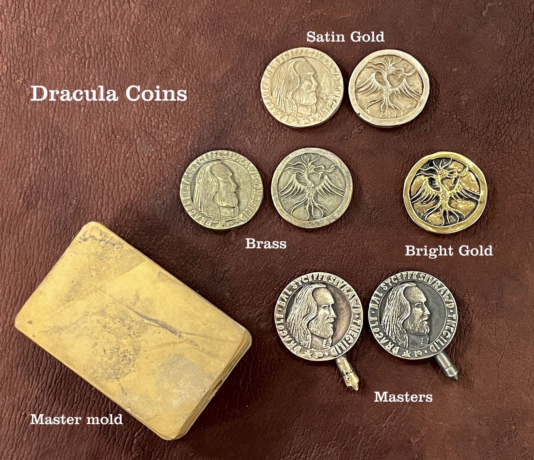

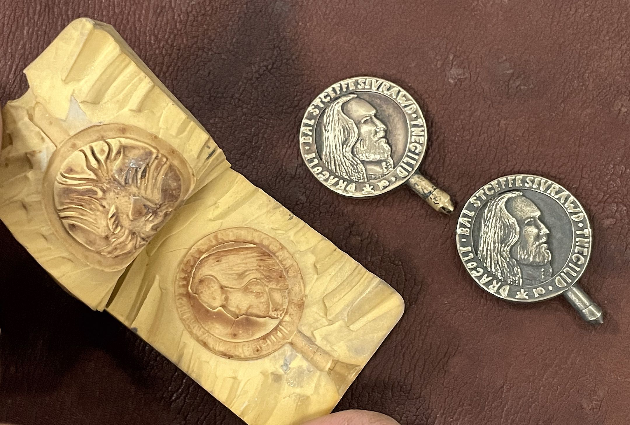

The original I sculpted from wax, which then bronze masters were produced. Using these masters a set of vulcanized rubber molds were made. We then ran a batch of bronze coins, which in turn were used to make a larger vulcanized rubber mold of about a dozen coins. From this mold we produced the coins for the film. most of these coins were gold plated and delivered to the prop master. As many of you know, these never made it into the final cut of the film, but were featured in the book about the film, and more recently the reverse of the coin was used as the artwork on the Blu-Ray disc.

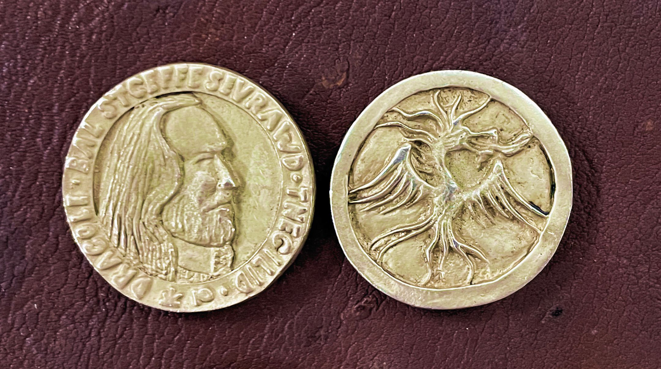

What you may not know, the the rim of the face side has the following words;
"DRACOLI . BAL STCEFFE SEVRAWD . TNEGILID"
Which was the name of my company when we started the film, backwards...
"DILIGENT DWARVES EFFECTS LAB".
These are the original Master bronze coins and one of the prototype molds. (Not for sale)

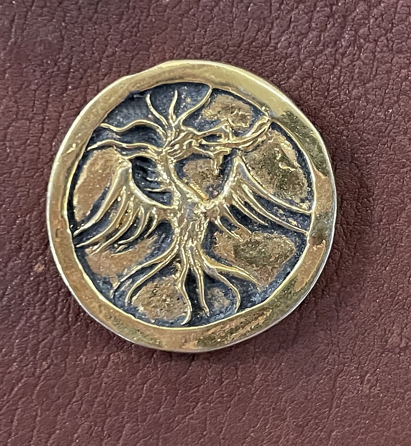

Close up of the satin gold plated coins and the back of the bright gold plated coin.
The coins will be cast from the original 12" mold in pewter, then plated in one of three finishes.

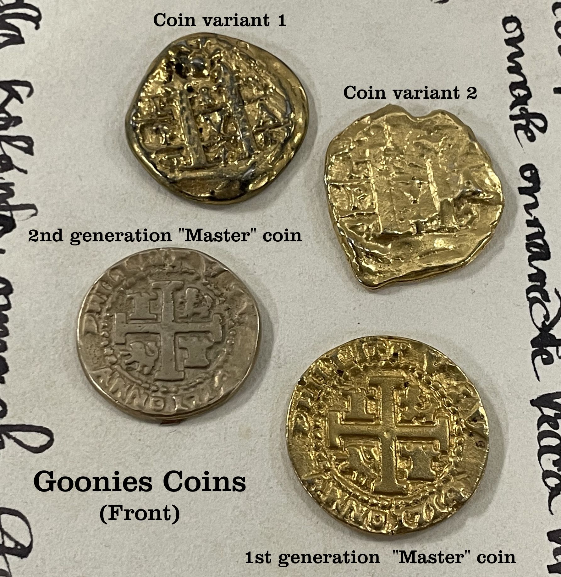

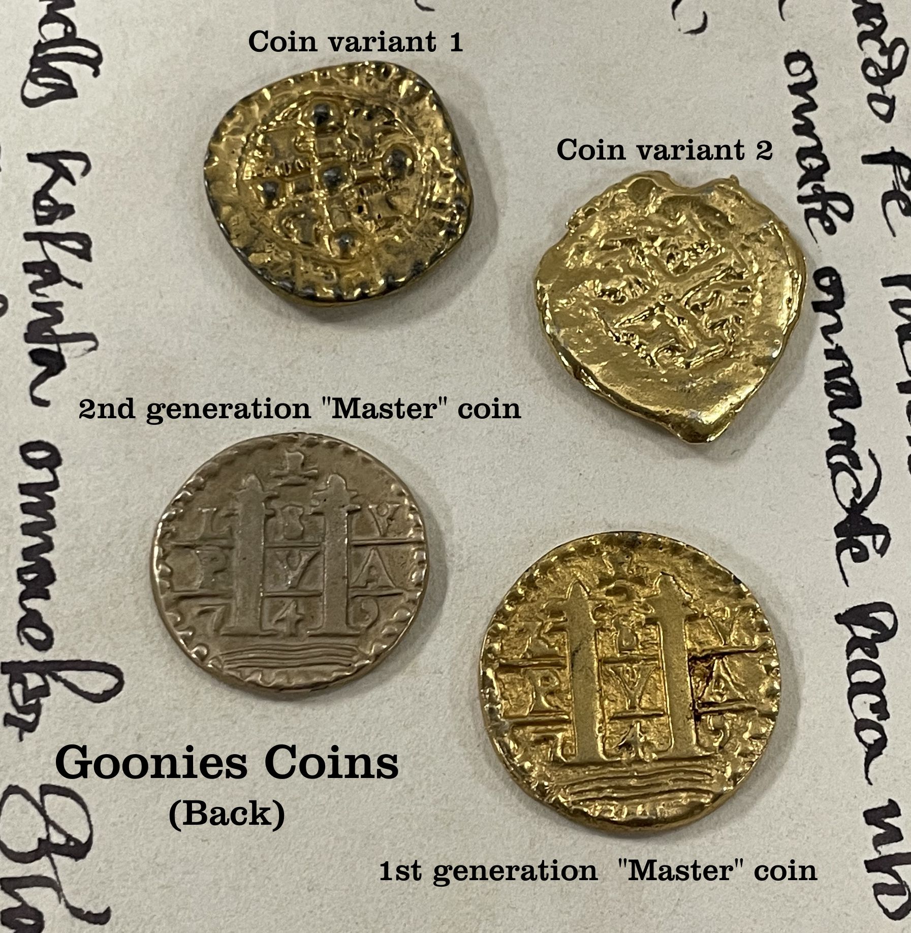

To make the coins, we had one of the sculptors make one master coin in wax, based on a Spanish Doubloon, this wax master was cast in Sterling silver.
From this coin, I made a number of variations. This was done by pressing the master coin into Wed clay, then distorting the clay by compressing it or stretching it, sometimes I made additional impressions in the clay. Then a wax was poured in this clay impression. This same thing was done for the reverse side of the coin, and the two one sided wax casts were joined to make a two side coin. The coins were made deliberately thick (real coins are much thinner) this was done to take up room in the chest while using less coins.
These coins were pressed into a series of 12" vulcanized mold discs and these molds were used to make the final coins. As a result of the different generations of molds and subsequent casts and production molds, the original unaltered "Master" coin ended up 2 different sizes because of shrinkage. (see photo)
The finished coins were gold plated with 24K gold.
Although expensive, gold was a better long term choice than brass plating. If brass plated, the coins would be shiny / reflective, but to keep them looking this way, they would need a clear lacquer coat, to keep them from tarnishing. However, with handling and banging against other coins, this clear lacquer could then be chipped and abraded, allowing the chipped areas to tarnish over time. Since gold does not tarnish, it was chosen.
