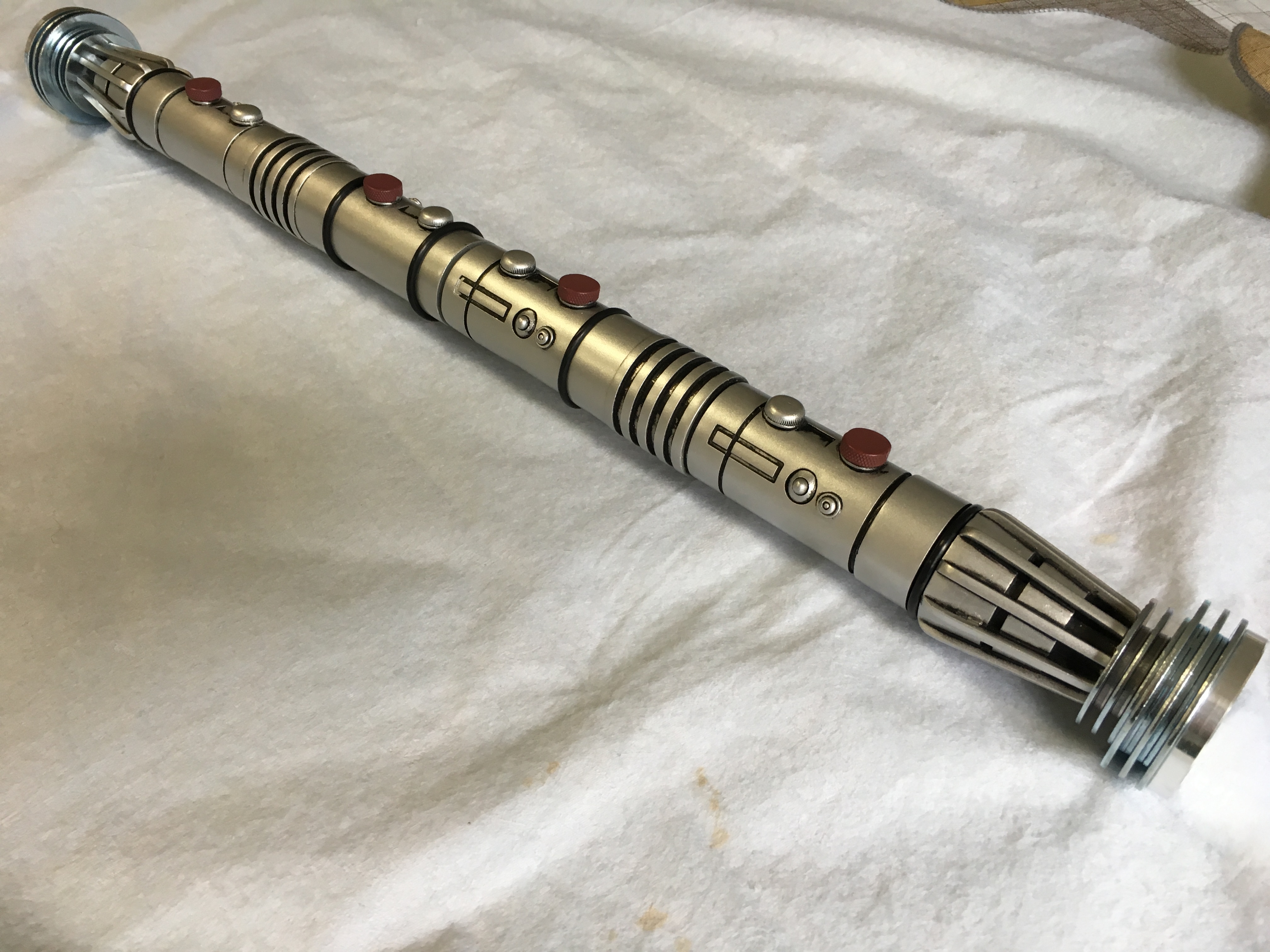

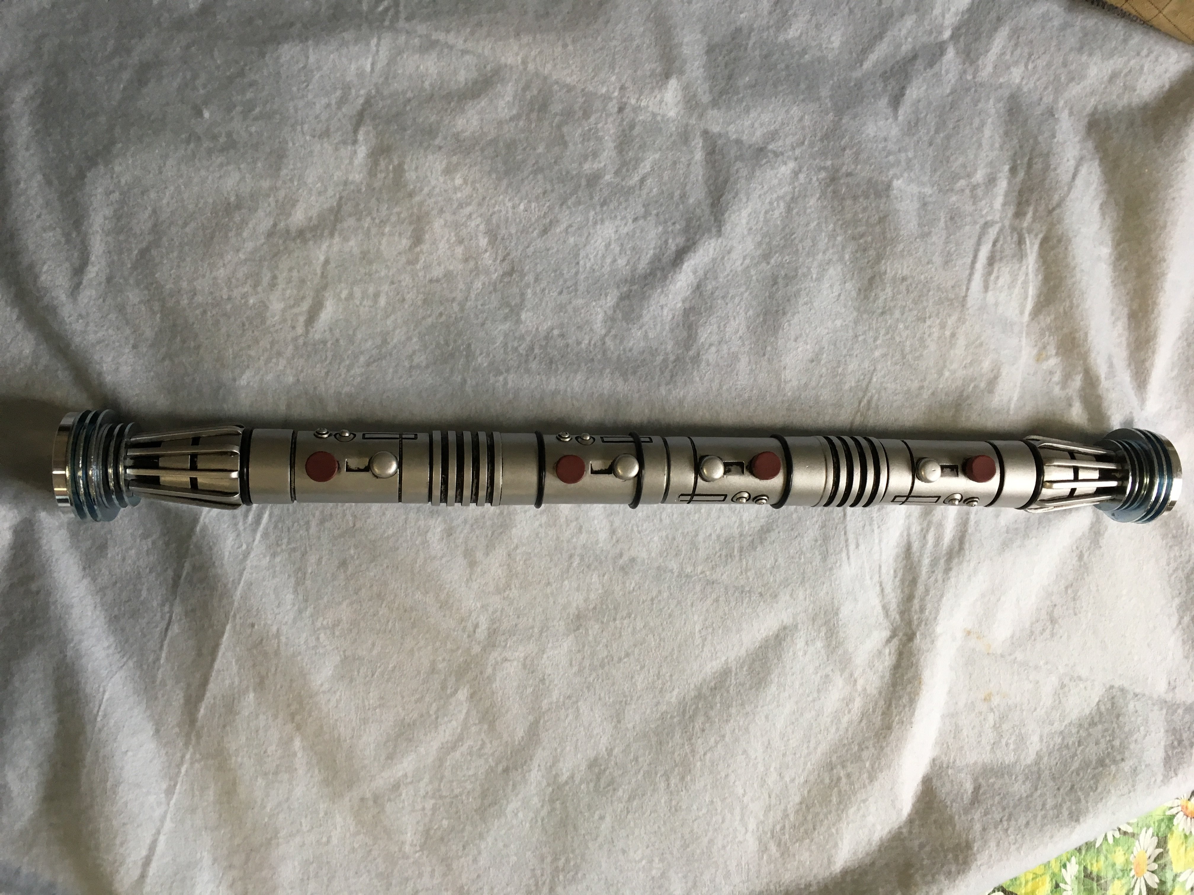

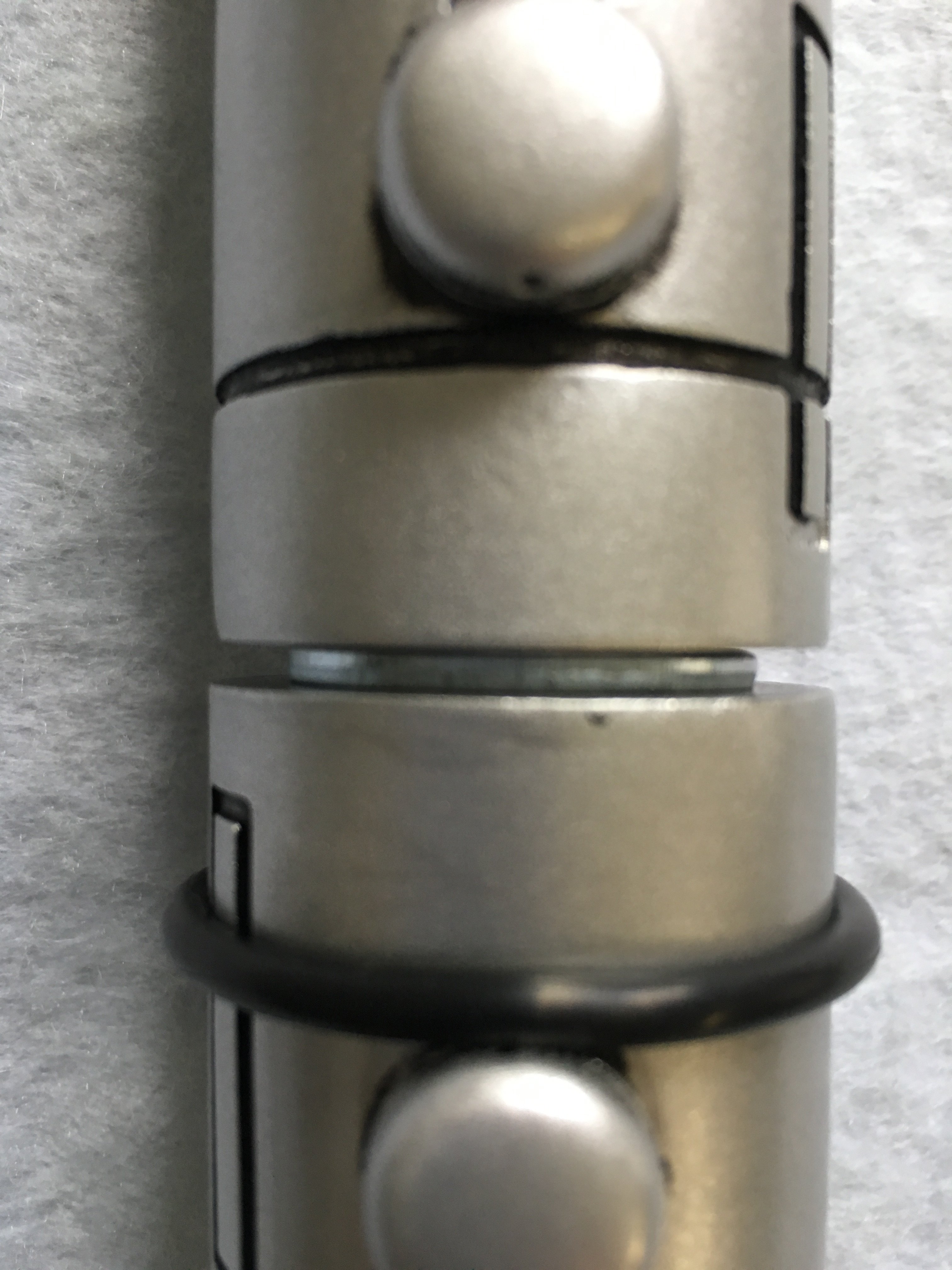

Mine is now complete. My approach that might be worth noting
- I used a metal 3/8" washer as the in between middle hilt piece
- I used a manual saw, no electrically powered equipment. I sawed the threaded rod in ten minutes, with a clean edge. I used a 3/8" nut to clean the sawed point, barely any cleaning/smoothing needed. A manual saw with a thin blade can sit in between two threads, thus giving a very clean cut
- Alignment can be done with both hands, no need for a second person. Screw on the emitter at sawed end of threaded rod and then compensate, bit by bit, by reversing the hilt
- O-rings provided are very tight. These can be fitted by enlarging the O-ring's diameter/elasticity using the metal hook of a coat hanger. Fishing wires are dangerous and could cut your fingers.View attachment 1015824 View attachment 1015825 View attachment 1015826

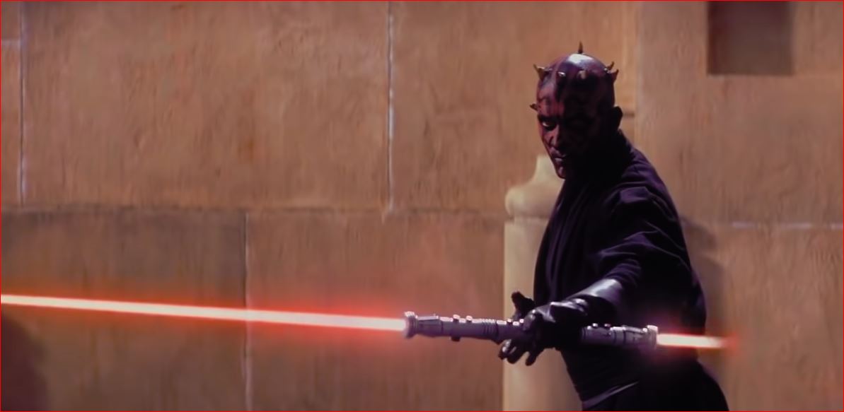

Did the movie prop have covertechs? I didn't think it did. Anybody know?
There have been a few reference photos posted. I shared one on page 18 -- Limited Run - Darth Maul TPM screen accurate lightsaber prop -- that seems to have the covertec on the underside. It isn't exactly opposite the buttons (which is no surprise, since the buttons themselves aren't aligned); looks to me to be more of a 7 o'clock position (if the button is 12).
^ Thanks, I think this screen shot from TPM clearly shows there is one, too. I assume there is only one coveretch per your photo and per this screen shot. It is clearly visible below.
