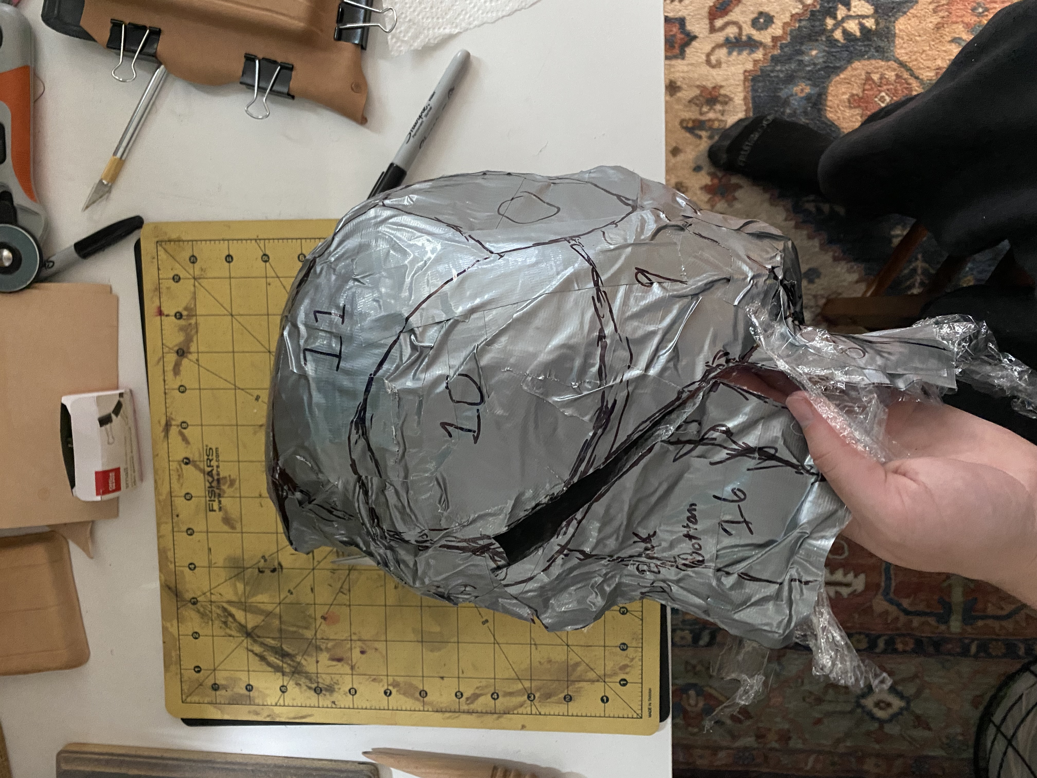

The mask was fun to figure out. Started with a base made off my head with the faceshell
Pretty happy with the result. I think there’s some gusset in the mask that helps the top seam open up, so I might try to fix that after the premier, but this will do with some airbrushing.

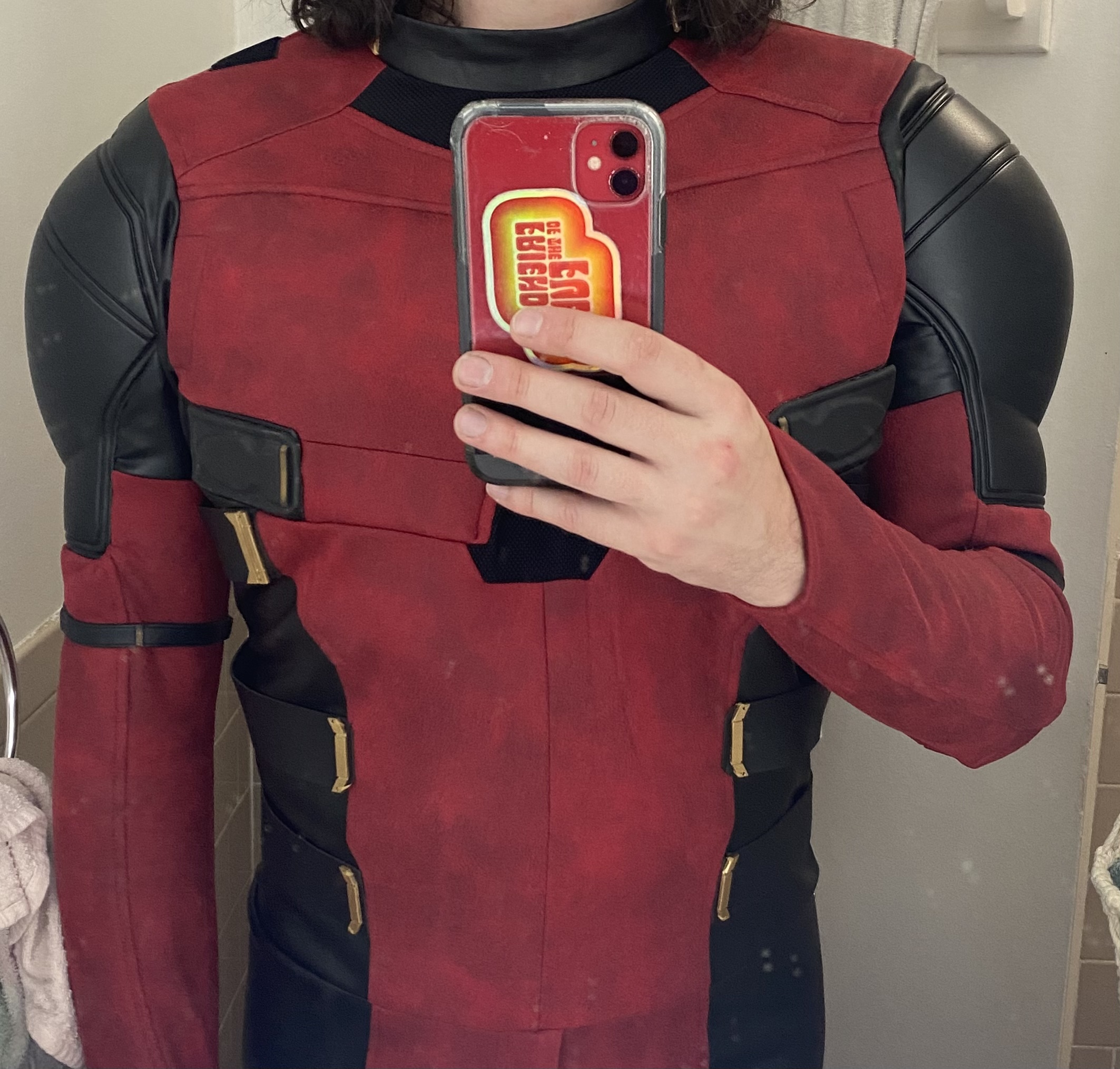

A week to go so here's an update!
Got the mask glued to the faceshell. I'm convinced there needs to the a gusset for the forehead seams, and I should've used tacky glue for the whole mask, but barge did a decent job. Every project is a learning experience! For my first attempt, I'm pretty happy.
Next, I finished sewing the shoulders! I used some spare canvas as bias tape, and after gluing that to the inside of the shoulder's seam allowance, I back stitched by hand with bonded nylon and they look great. I definitely will be gluing the side straps down. The way they kinda float off the sides looks odd. I also plan to remove the plastic hardware and fill the holes before repainting them the correct gold/silver.
Next up, drop holsters! Finished painting the base plates, but I had to resize/print the holster as the gold airsoft deagles I purchased didn't quite fit, but I plan to paint those with plastidip tonight. The leather straps are cut and ready to attach once fully assembled.

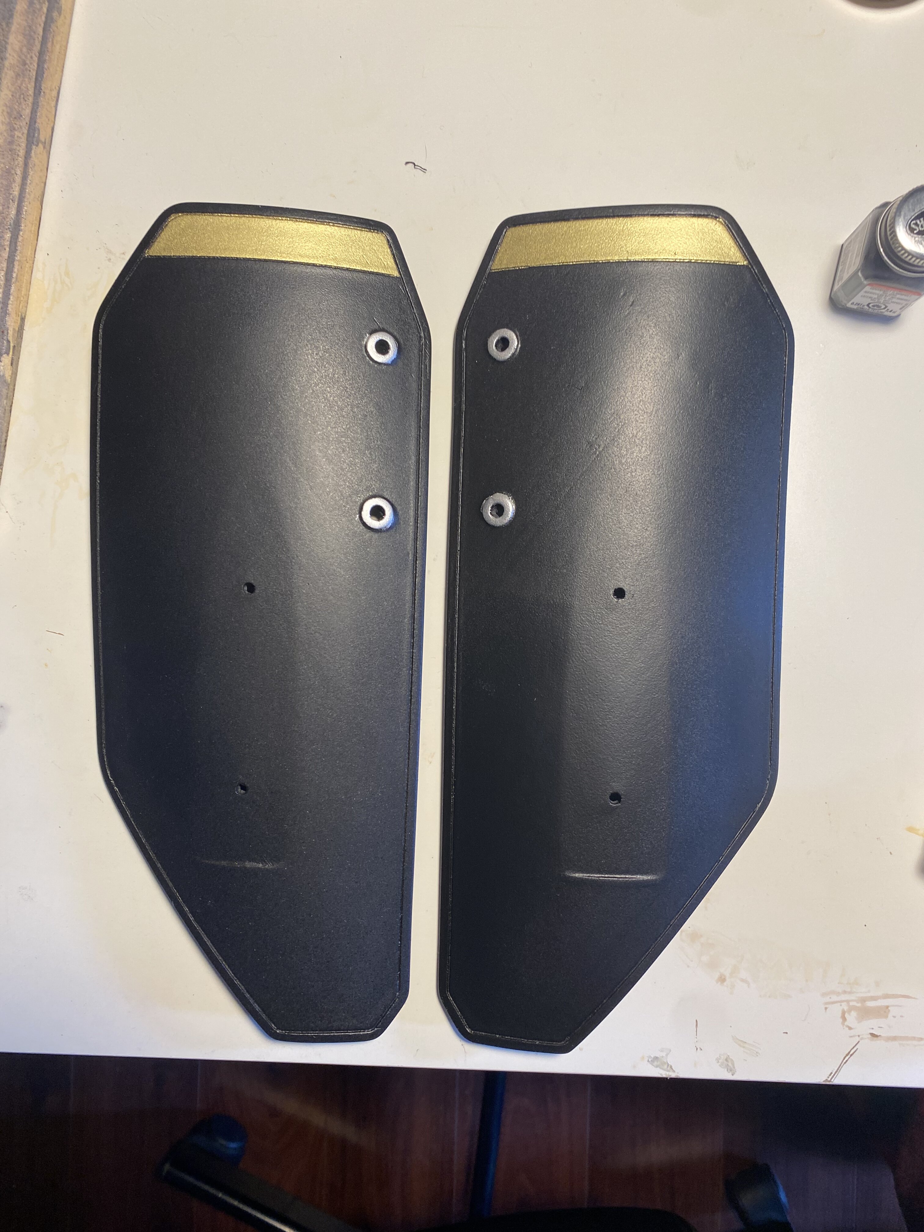

Well life is busy so I completely forgot to update this thread, BUT I think it came out pretty nicely! Finished it right in time for the premiere. Still plenty I want to change and upgrade of course, but I'll try to be content for now I will probably completely remake the katanas, as these fell off on the tracks during the shoot and the right sword and scabbard snapped in half I have shin guards printed and I plan to finish them up before a con in February.
