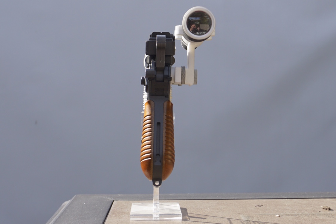

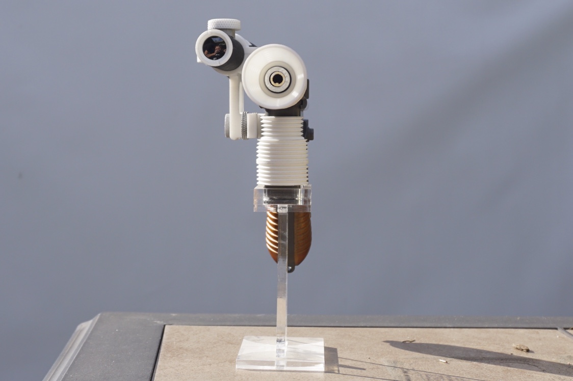

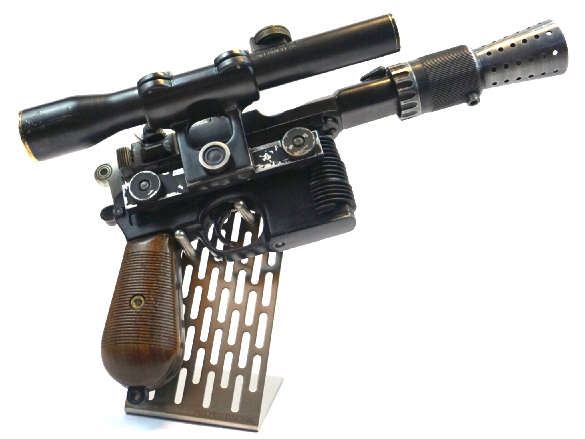

Always tinkering, alway improving. Solo’s TFA blaster..

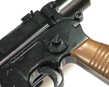

I get this question a lot so here is a basic breakdown between Solo’s ANH, TFA & SOLO:ASWS “Hero” blasters. Each pictured below starting with ANH, then TFA and finally SOLO:ASWS..
They are all basically the same to the naked eye but it’s in the details that gives each their own independent life. They all are built on a Mauser with a mount, scope, heatsink, bull barrel, flash hider & mystery disk. But what follows is what separates them. It’s even more complex and detailed but this is a good start..
  • ANH - built on a live fire authentic Mauser. Not a denix replica that’s pictured but the real deal. It’s believed to be reused from the film “The Naked Runner”. This Mauser has a magazine plate (not a separate cartridge like TFA & SOLO) that is flush with the bottom.
  • TFA - built on an airsoft Mauser. A few different airsoft models where used but it’s believed that the hero was built on the model “HFC m712” airsoft mauser (as pictured). Just like the SOLO prop the whole lift side had to be replaced with the selector switch first being removed. Plus it has a magazine cartridge that comes out from the bottom with a release switch clearly seen on the right side. It’s not flush on the bottom because of this.
  • SOLO:ASWS - also built on a airsoft but this time it’s believed that LucasFilm just bought a bunch of the AWC airsofts (they already closely resemble the Hero prop with its parts) and remodeled it a bit. Again the whole left side had to be replaced to remove the selector switch. Plus it’s the same as TFA with the magazine cartridge and release switch.

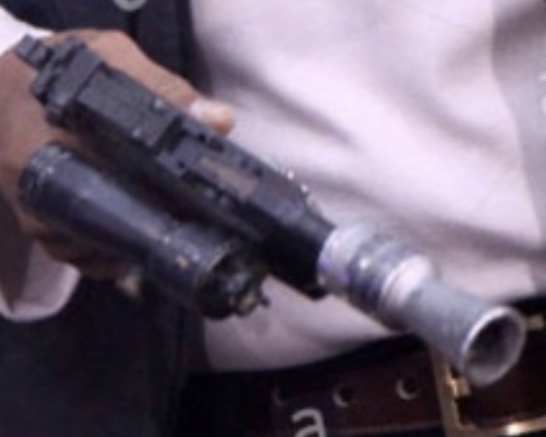

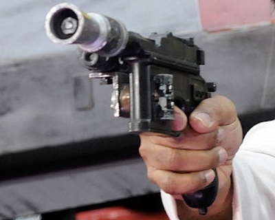

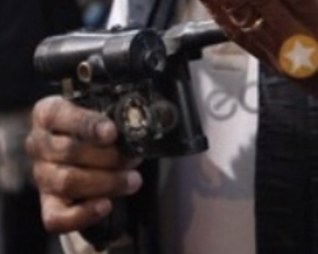

Curious brownish thing that (between the mount and the pistol).
Pistol i assume was MGC? Could see he was holding it pretty heavy (not rubber stunt) and that difference in black on the bolt’s extractor.
And did he at one point remove the flash hider?
The FH falls off at the end of the video lol
It’s the Hoth blaster from TESB. Yes it’s built on an MGC but the whole build really wouldn’t be that heavy. 2/12 pounds I’m guessing. This looks to be the same prop as seen here..
