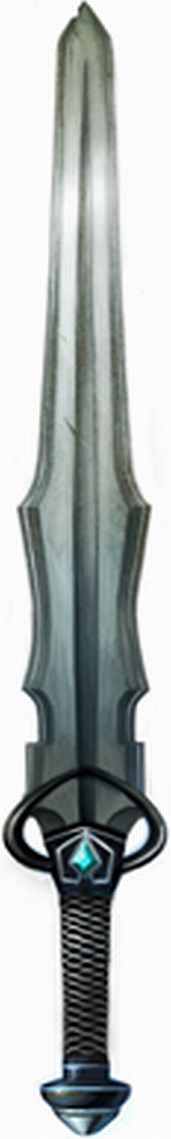

Quite a while back I helped a fellow forum member, daenarahd, who was looking to recreate a "dagger" from the Dragon Age universe. This was, if I remember, in the lead up to the launch of Dragon Age Inquisition. Being a fan of the franchise, I did my best to provide some design outlines of the blade in question. daenarahd provided most of the reference photos:
Apparently, in the Dragon Age world these things are considered "daggers." To keep the authenticity a bit, I judged the size from the character Leliana. I also looked up some details on the longest blades that can still be considered "daggers." I came up with a rather large 24 inches, which still doesn’t represent Leliana's proportions, but it keeps it closest to the extreme length of what human society might, very rarely, call a dagger - the thing is a sword, but whatever.

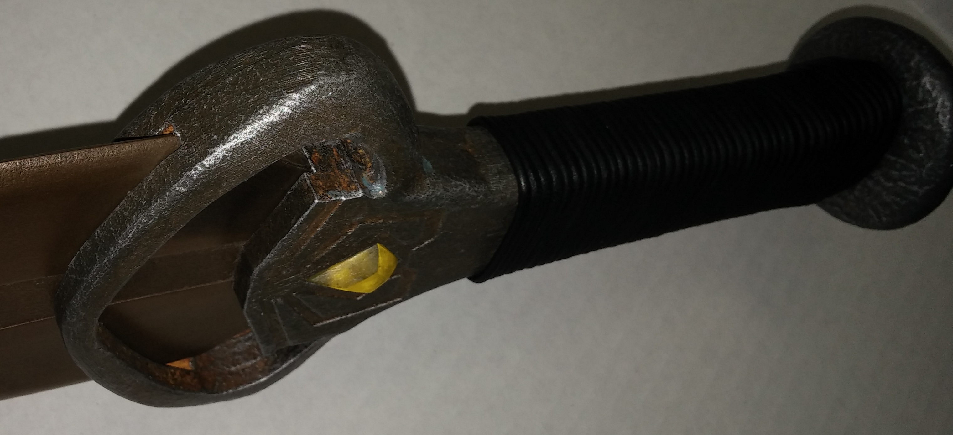

I cast three versions. One, pictured above, has a cold-cast bronze blade and an "iron" (metal powder and paint) hilt and pommel. The other two I have finished are both "steel" blades (cold cast aluminum) with bronze painted hilts and pommels. The Gems are cast clear with either pigment added or nail polish placed on the back for the color and simmer. The tang of the blade does not extend the full length of the hilt into the pommel, as this was outside my available length for MDF from the laser company. As such, the blade only goes part way through the hilt and is pinned in place with 1/16 inch steel rods. Hilt is wrapped with leather cord. One version has a suede flat wrap. Some of the blades are aged, others are not. The "iron" hilt I gave a strong aging, with rust and grime. Makes the bronze blade and gem really stand out.

The blades were quite tricky to cast (one of the largest things I have solid cast thus far). I especially had some issues with the metal powders not always coating the whole mold or the resign (I used onyx) getting a bit too bubbly. The smooth on onyx is great for cold casting, but it is far more temperamental with humanity I think. Some of the blades have a slight "black" huge to areas were the powder was not thick enough or ran down as I poured the resin. It was a bit of a trick working alone. The blades tended to need quite a bit of cleanup, particularly the tips, were, despite my efforts, a few bubbles always seems to sit. I usually had to fill a few small holes with epoxy sculpt or filler, then paint with some matching colors or weather the area. The hilts, which I cast in three pieces, two halves of the hilt and the pommel separately, often needed internal cleanup to fill some holes. I was also never able to get a very clear "line up" on the two halves of the hilt after pulling the resin. They always seemed to flair out a bit more than the original. Probably my mold walls were not thick enough to fully support the mold full of resin, but I was working on some slim margins for the build, so it worked out better than I thought. Casting the 3d print required a bit more work, as even after lots of sanding and finishing, the silicone would still grab the smallest lines I could not even see on the original. Still, the paint hid quite a bit.
