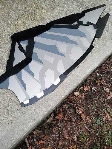

For the wing material, I picked a 2mm foamedPVC. This stuff is AMAZING. Lightweight and easy to cut, but works like styrene.
I laid the printed template down over the foamedPVC and figured out what panels would have which wing parts.
That resulted in the following...
And this is the same wing - closed (folded down)

I used the templates again to figure out where the paint colors should go and which colors to use.
...and then started taping off areas to
Once all the wing parts were painted it looked like this...
