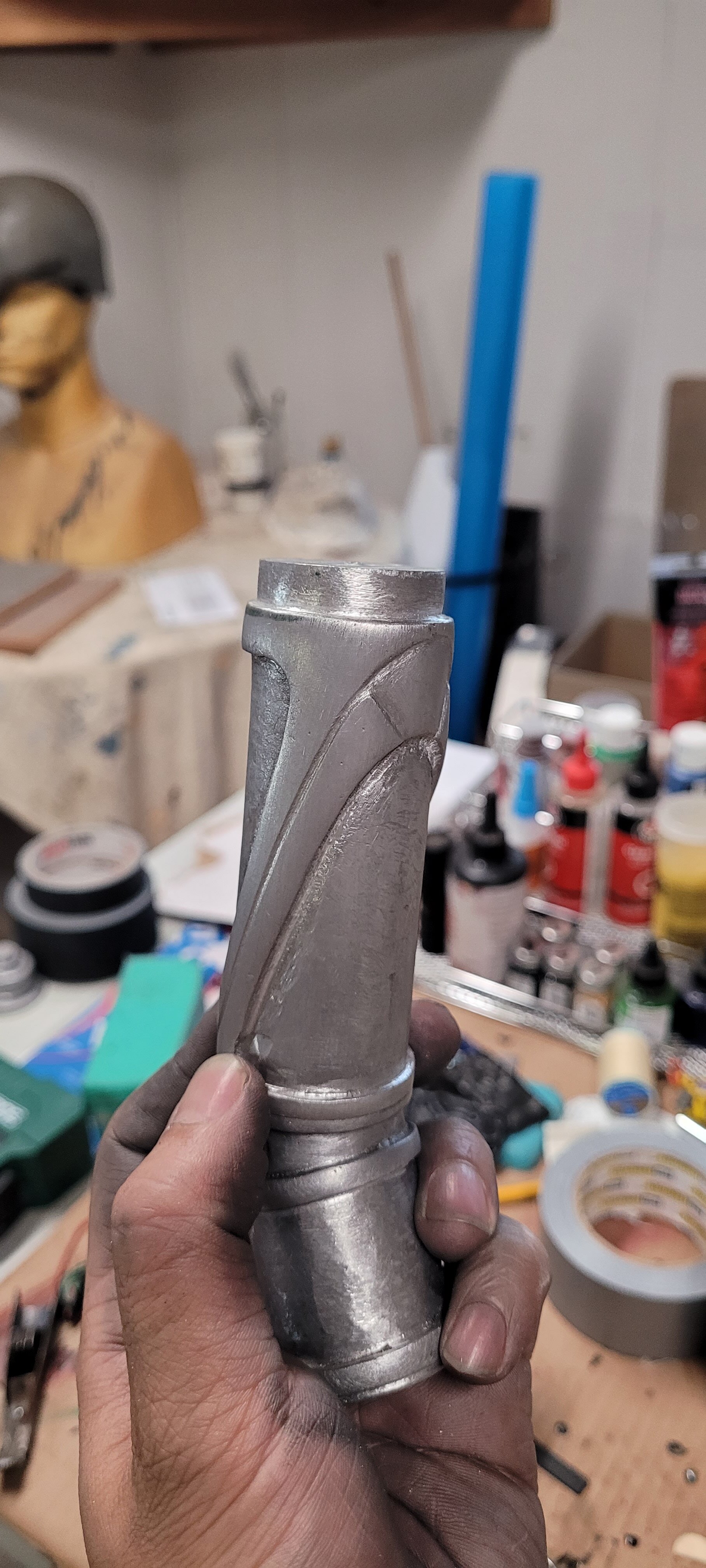

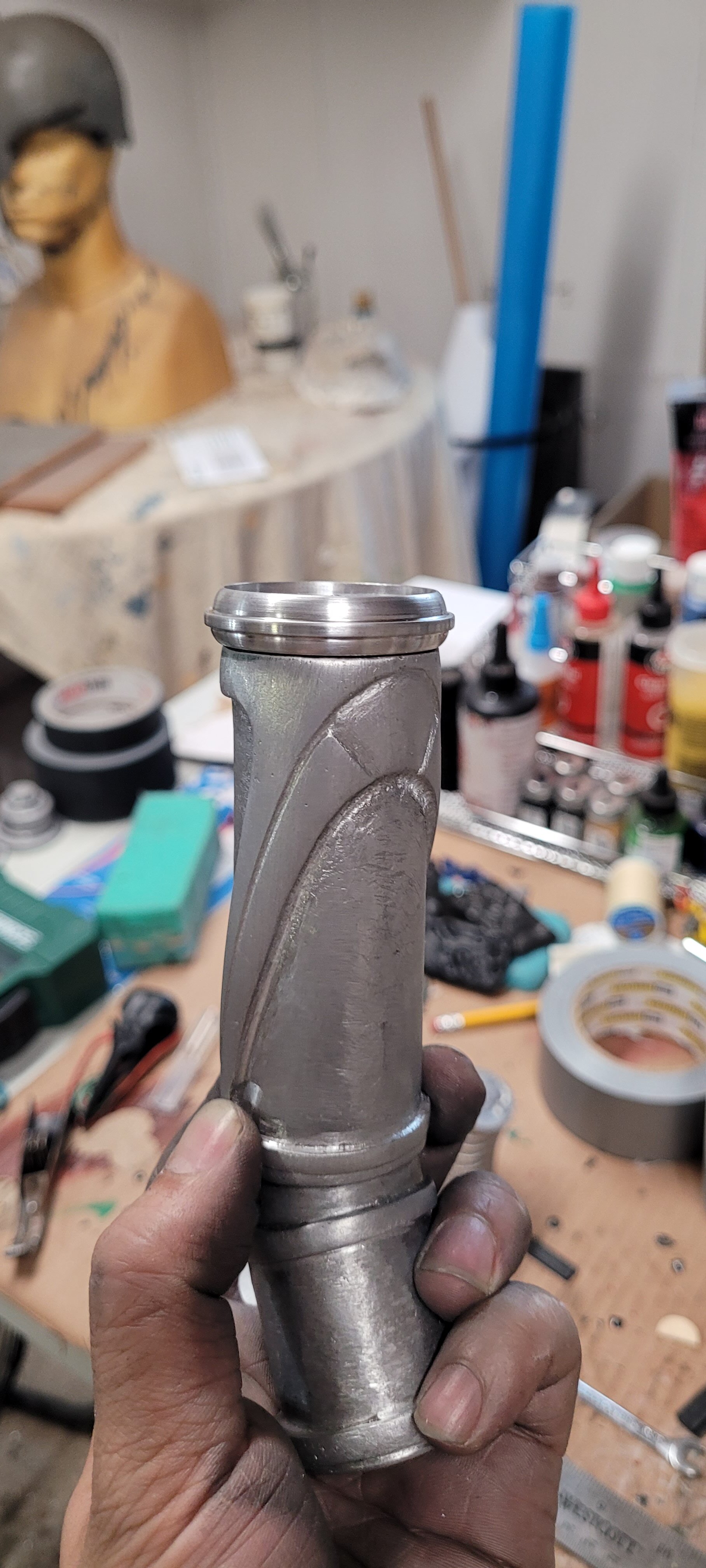

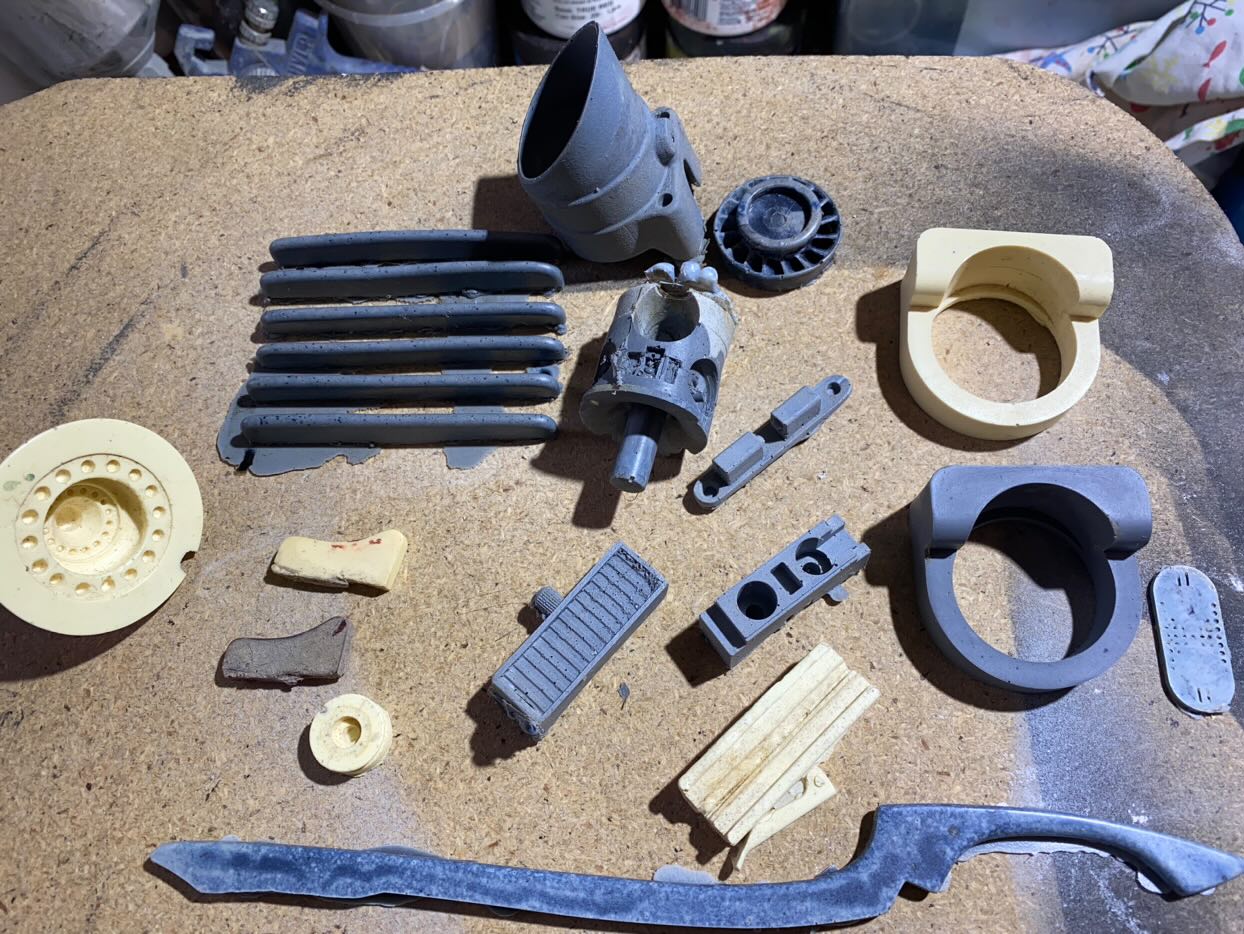

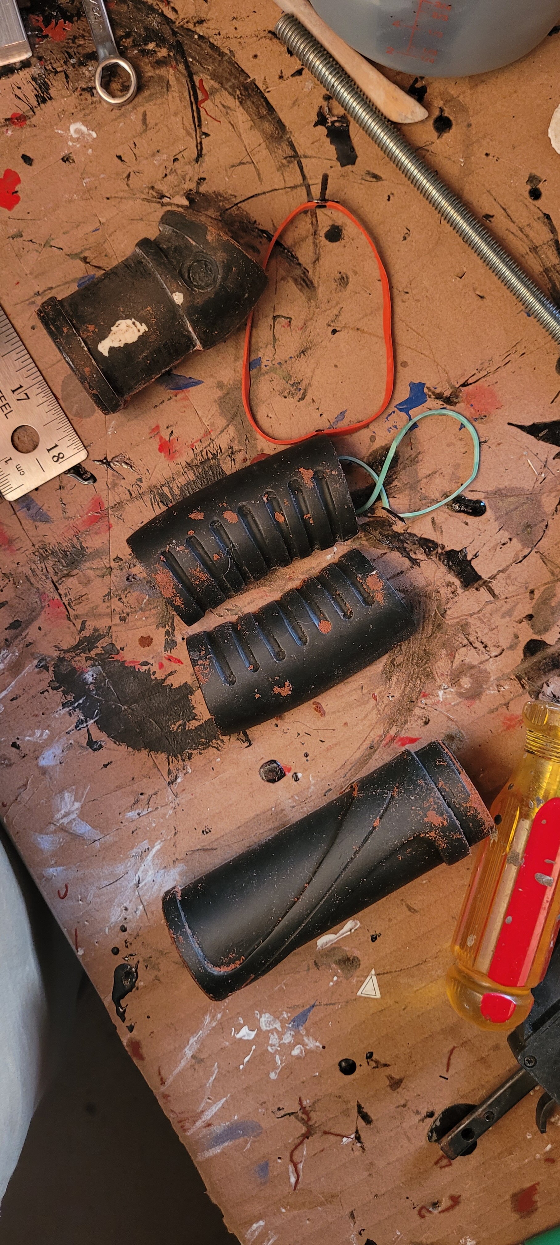

I wish I took more photos of the process but such things slip away from me while I just actually make the thing. As all my casting projects go, it all starts with a sculpt. The knuckle joint and the main grip section were made from PVC and Apoxie Sculpt, and the curved foregrip area is just Apoxie Sculpt and sintra where it parts.

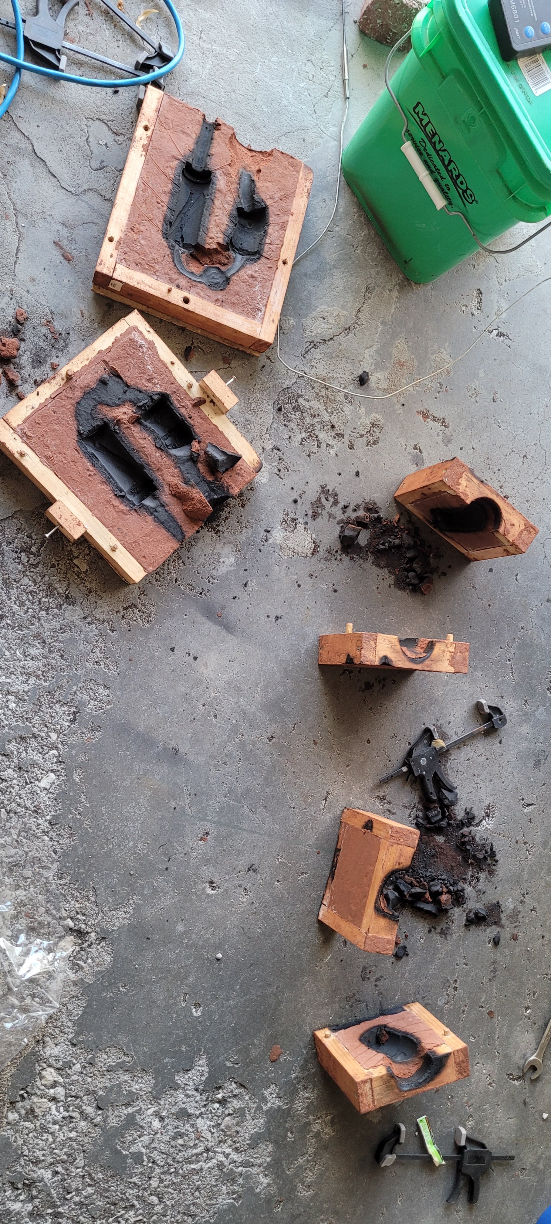

If the Hero AotC were metal, there are two ways I think it could go: either the thing was cast for the majority of the parts, or it was made with aluminium tubes. After going with casting, as I've already have the materials and experience with it, I honestly wish I had the tooling and resources to make this from aluminium tubes and round stock! It took a goofy number of attempts at casting to get decent casts to work on. Had they been tubes, I wouldn't have had to worry about warping. I didn't split the knuckle and grip sections because had I cut down the middle, the casts would've turned out even more oblong and wonky as metal casts tend to pinch at the seams when cooled.

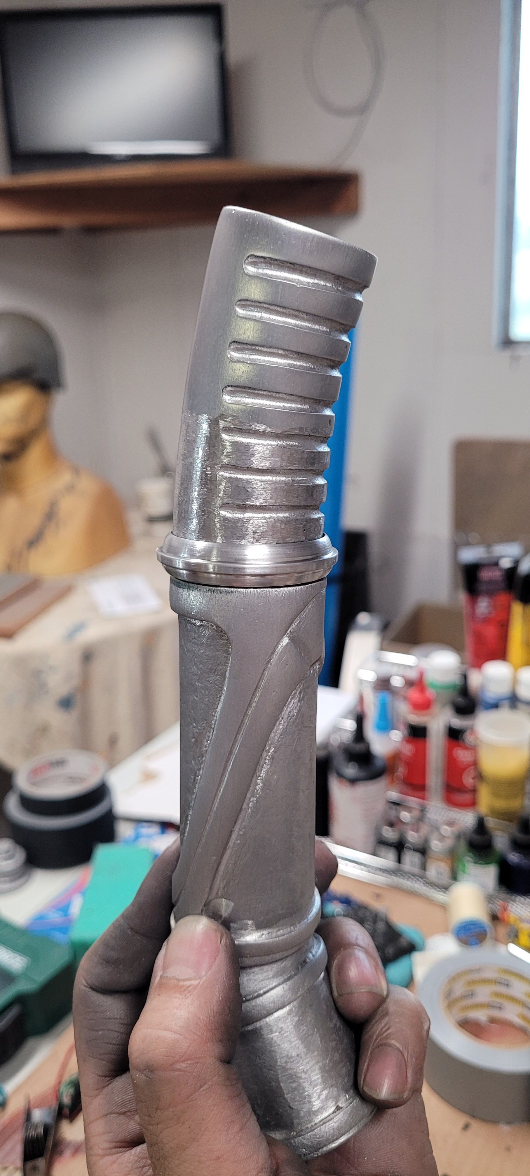

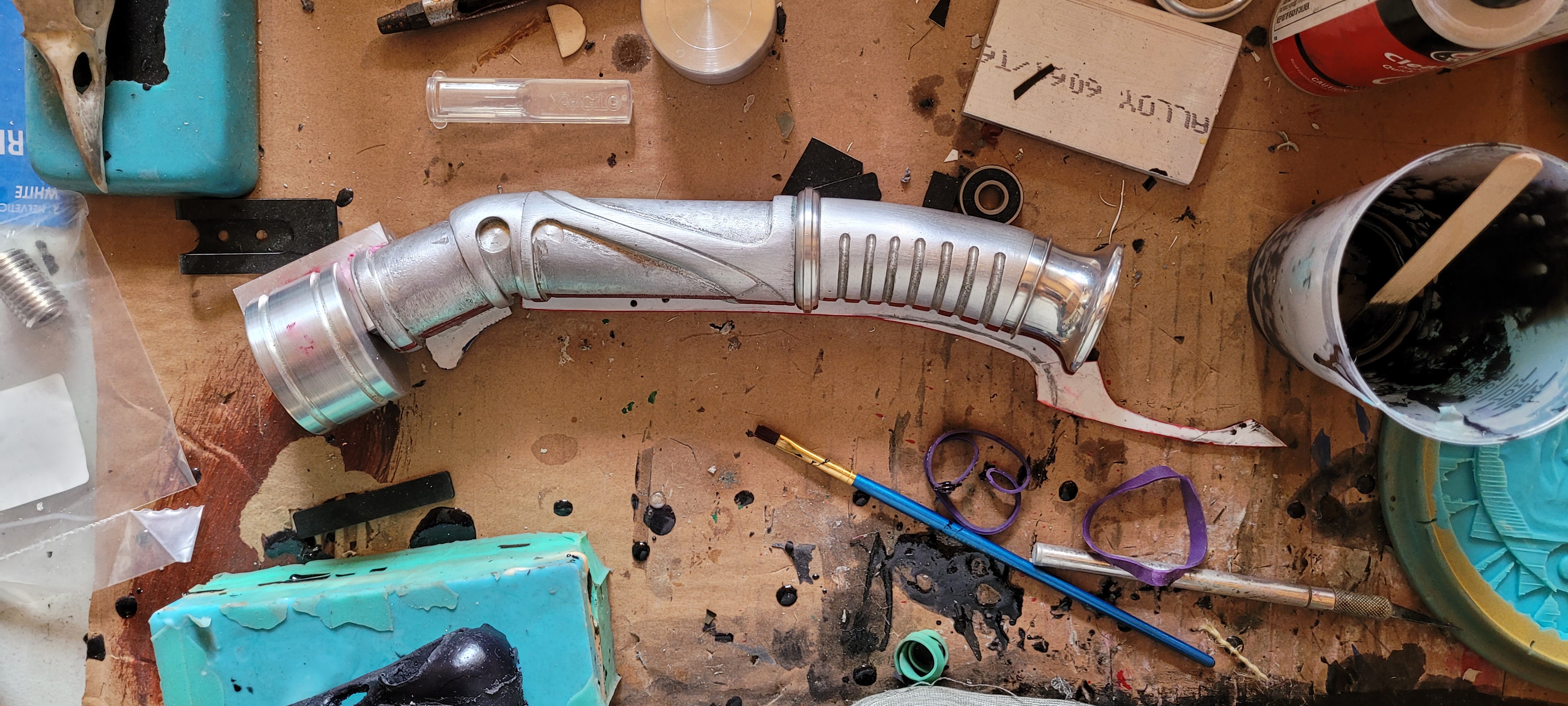

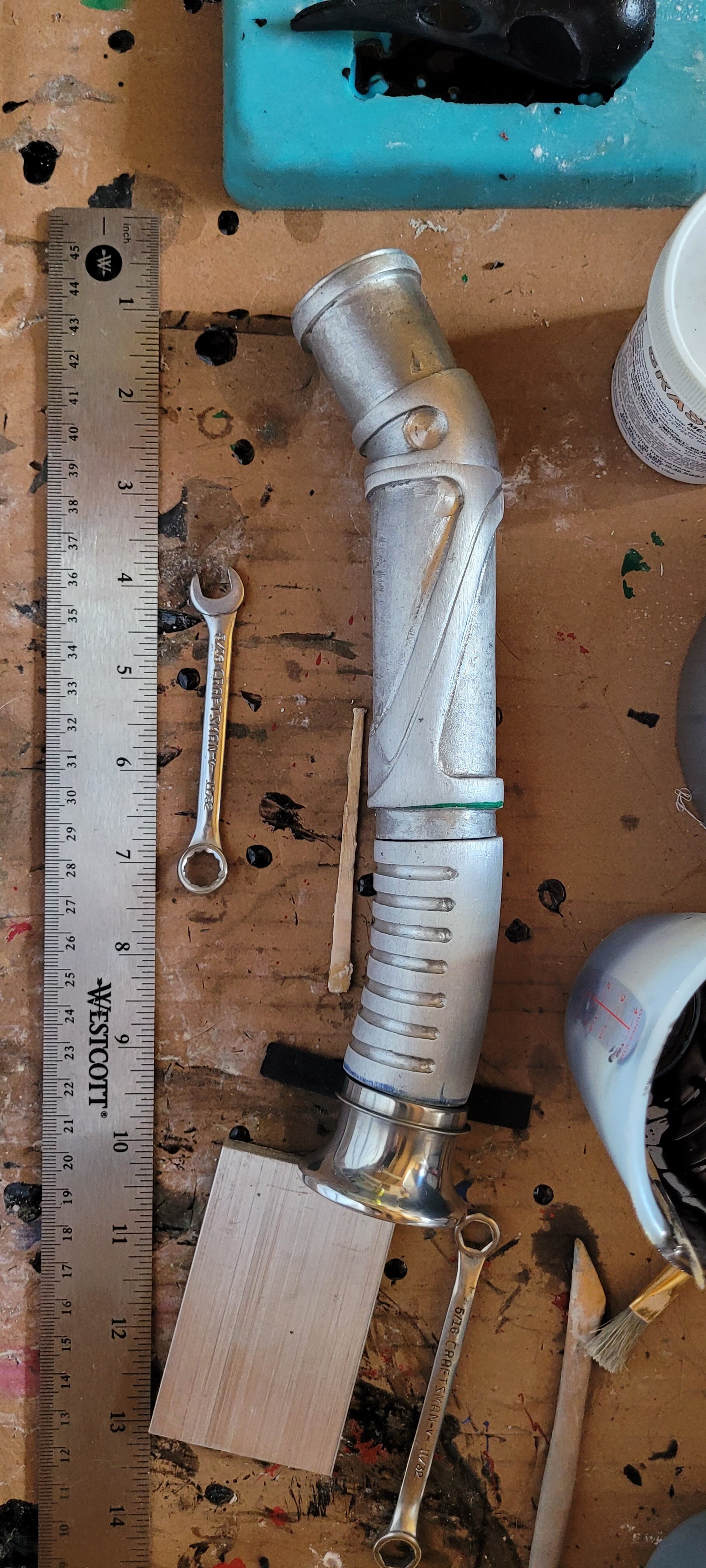

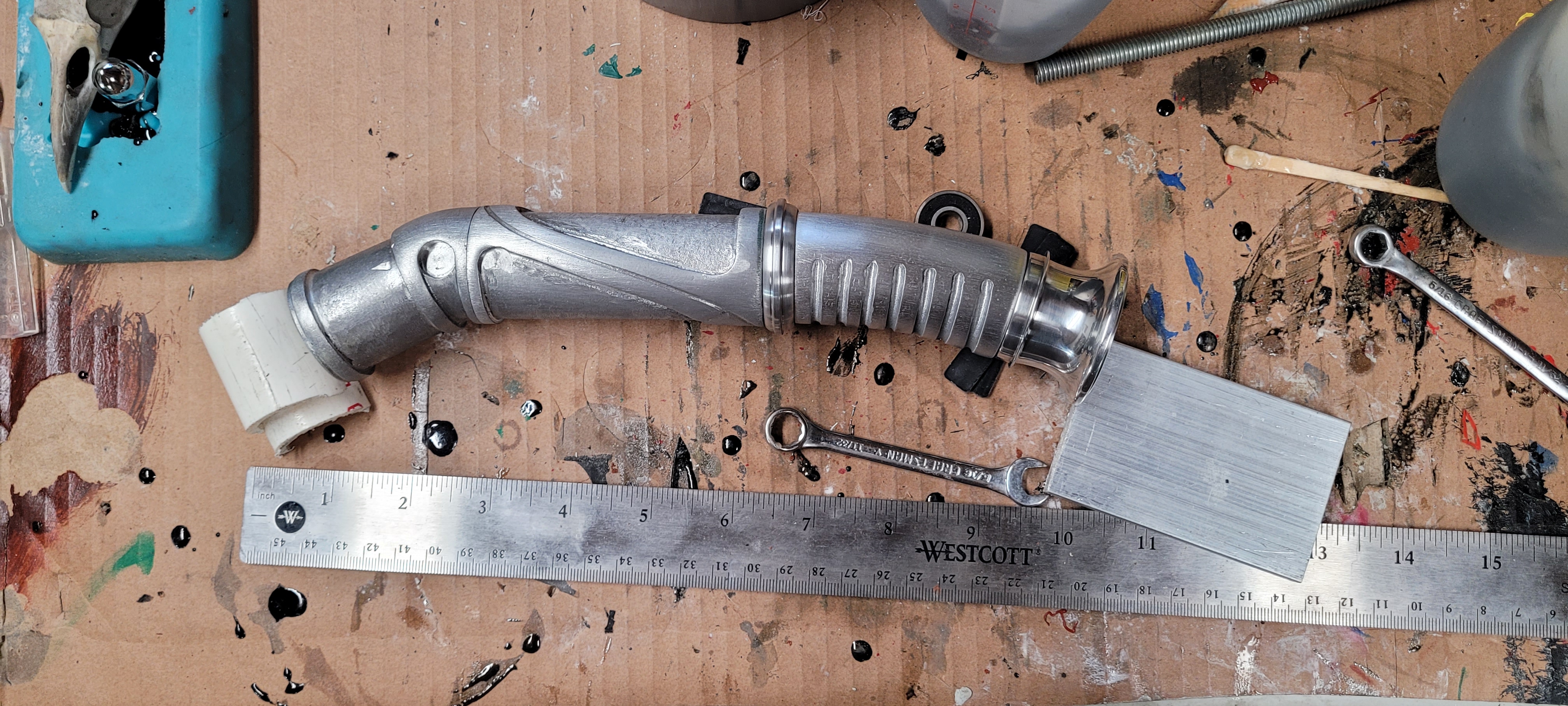

This is where it currently stands. The emitter was the last part I made as it was the last bit of similar-sized roundbar I had, and I'm currently waiting for more to arrive so I can make the pommel, pommel bridge, grip ring and prong. The emitter took a heck of a time to cut down as I can only do things manually on my little bench lathe.
Plans for the immediate future are brass buttons in the knuckle and, possibly, bronze cap in the emitter/foregrip sections just for some subtle color variation.

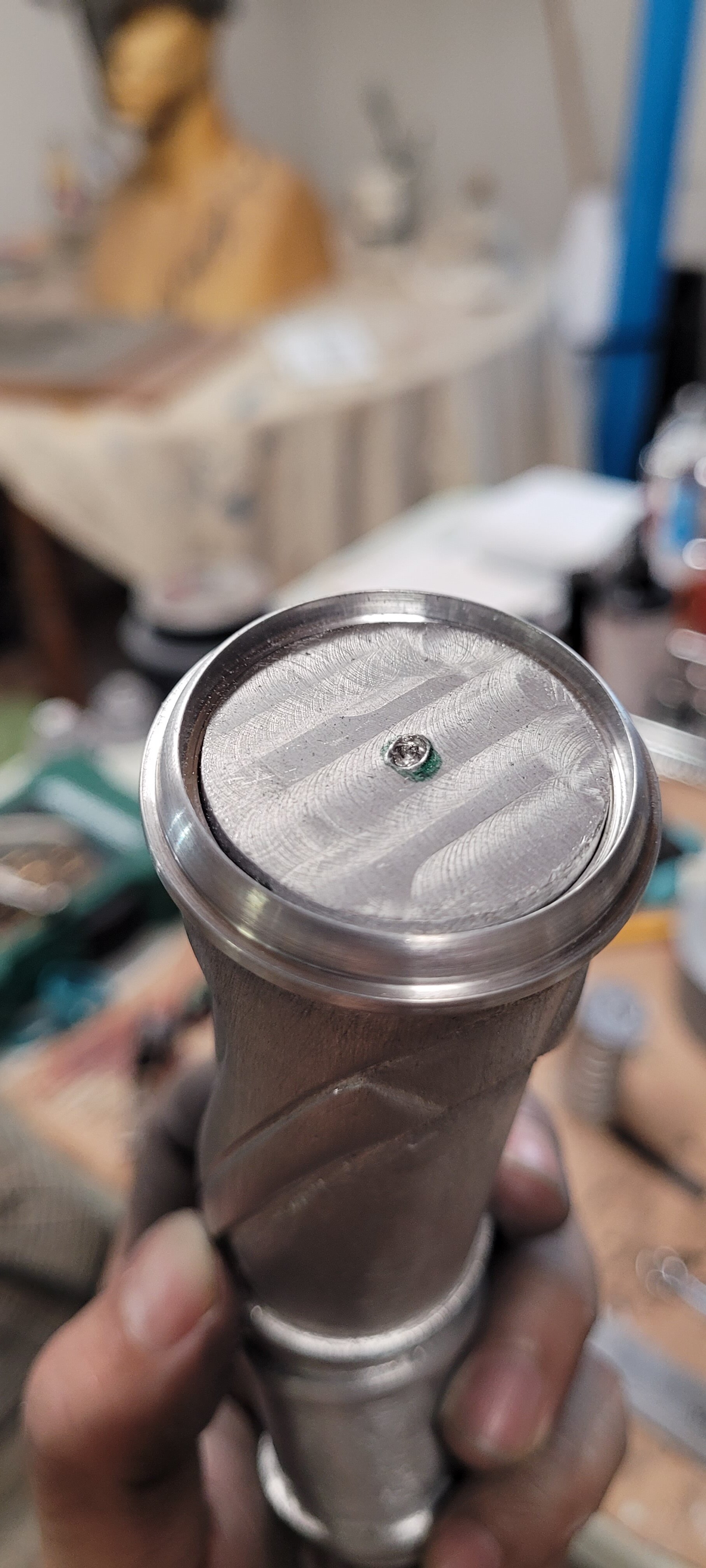

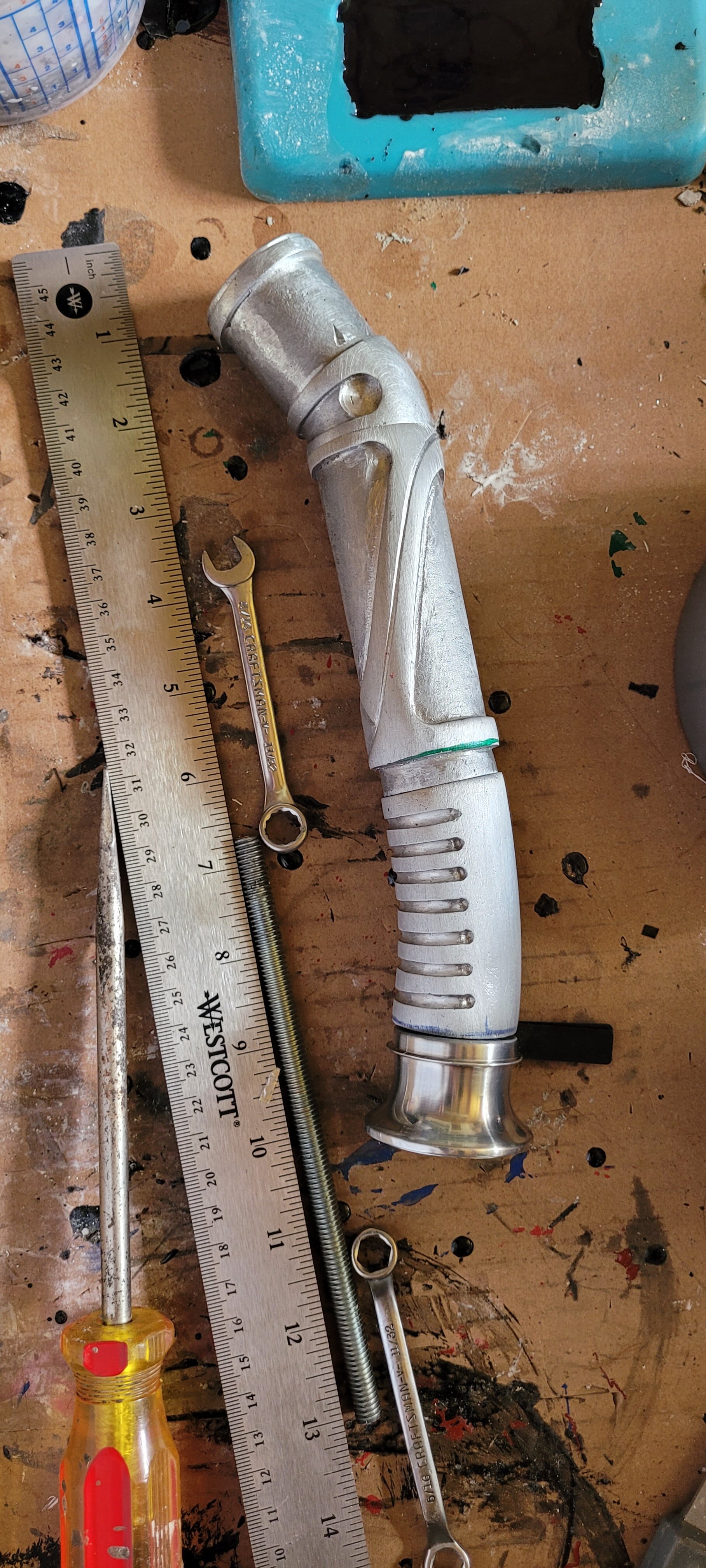

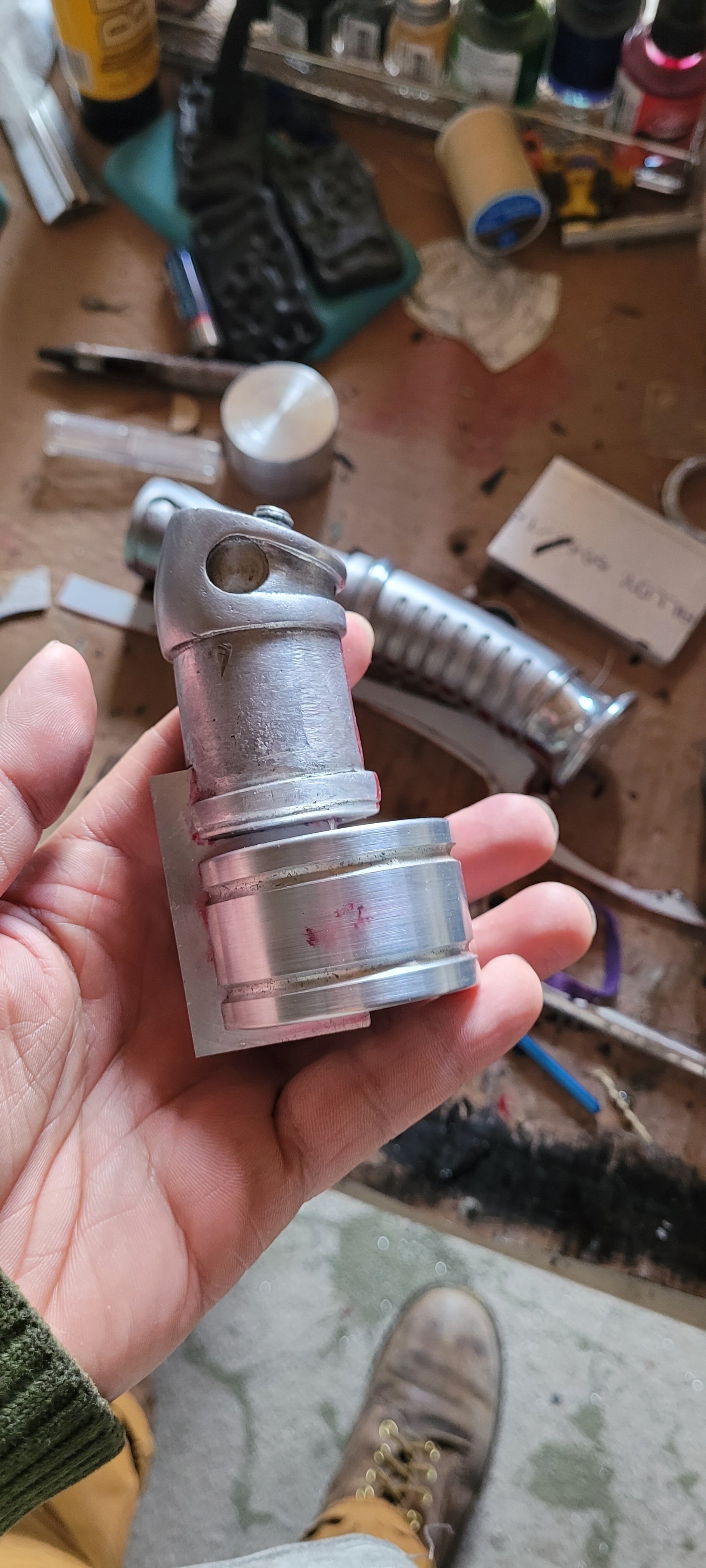

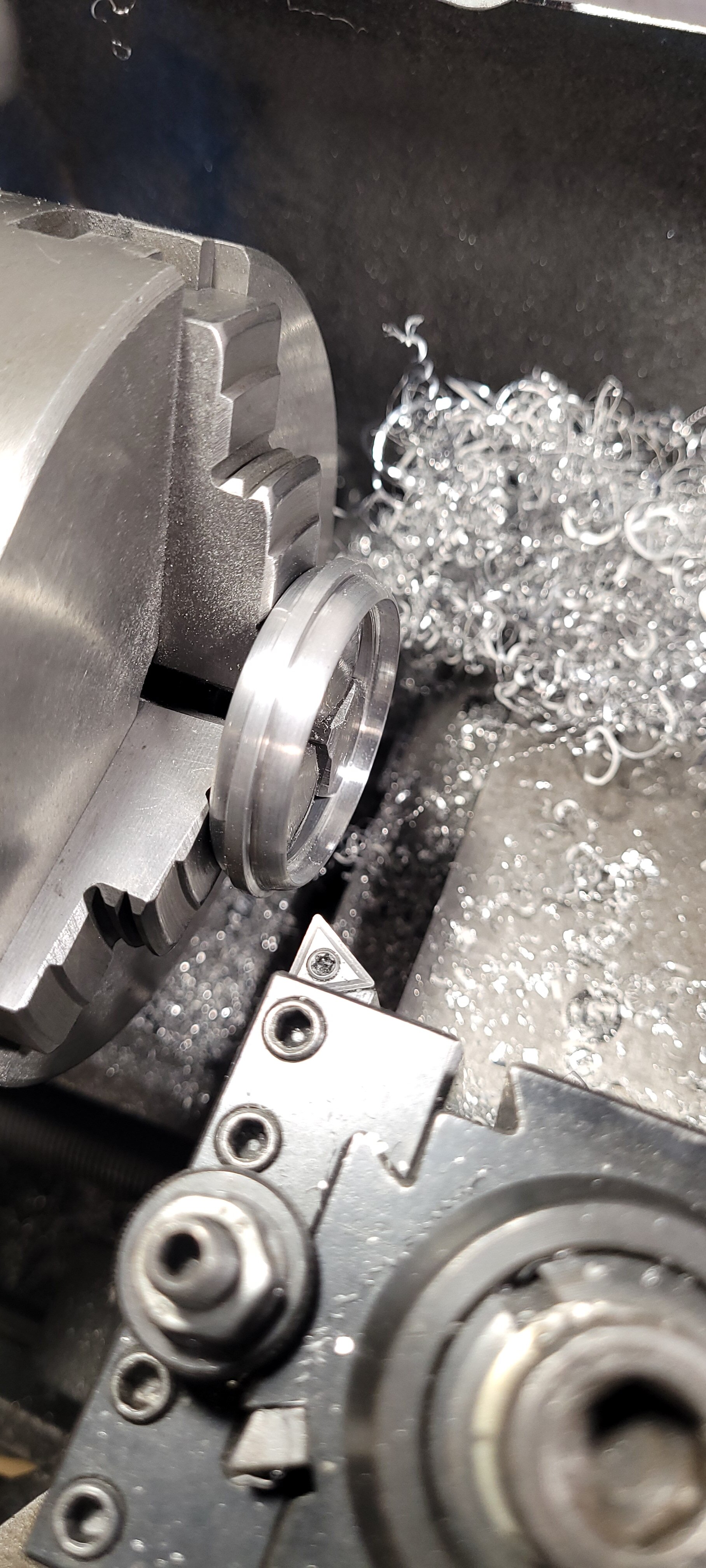

Got my extra materials in recently and I'm lining up the remaining component parts to be machined. Today was spent machining the "ring" that connects the foregrip and the main grip and adjusting the cast parts to fit. The casts parts, being what they are, don't fit perfectly with something fully machined from stock, but getting it fitting 'well enough' is enough of a milestone for me. I may have cut it just a little smaller than it needs to be, as the profile of the prong needs to sit flush with it, and I think I flipped the profile by mistake (as it was done mostly from memory). I think I'll try doing some more to get it to spec but, overall, I'm pretty happy with it. If it doesn't fully satisfy me in the immediate future, I can just cut another.
This is where the hilt sits now for the moment. I like having these little bits on either ends just to better visualize the final goal.

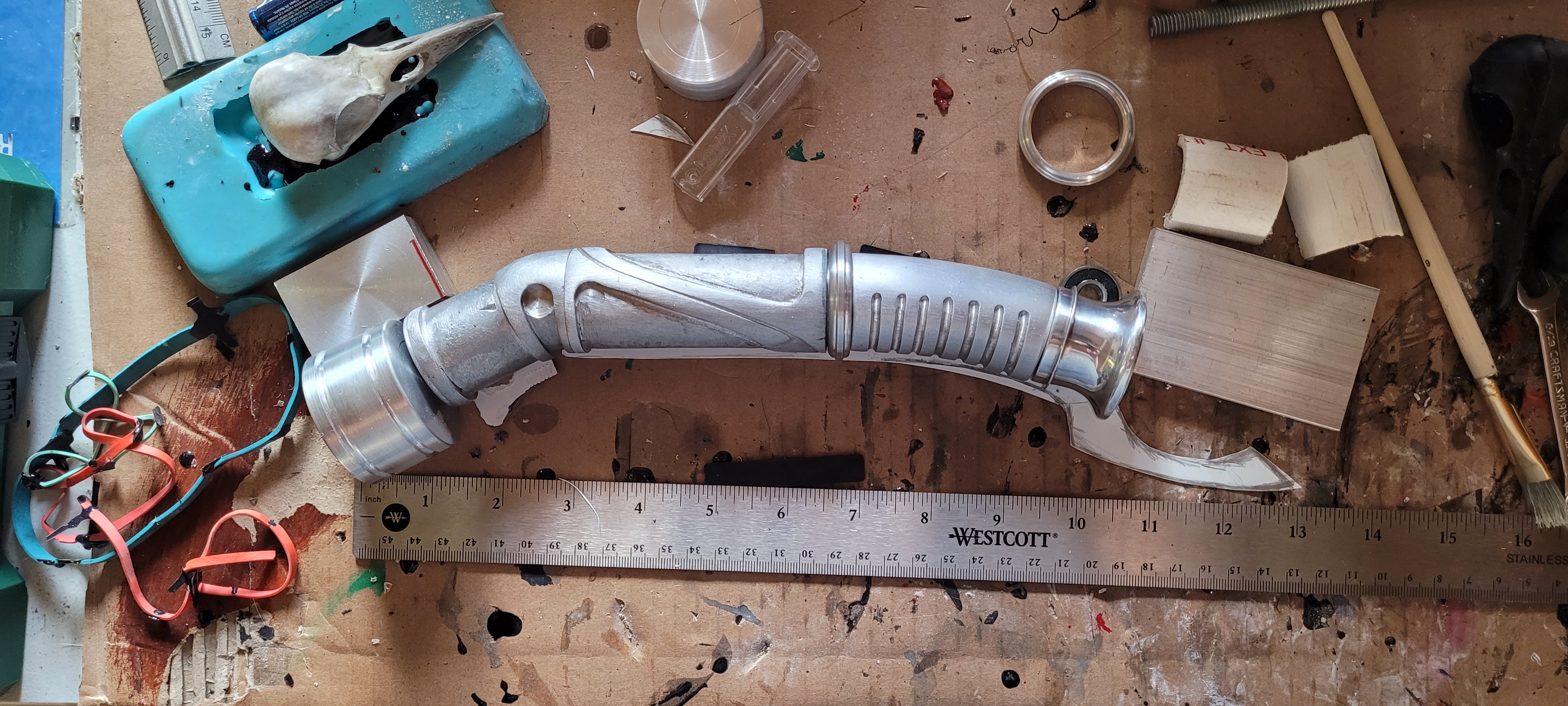

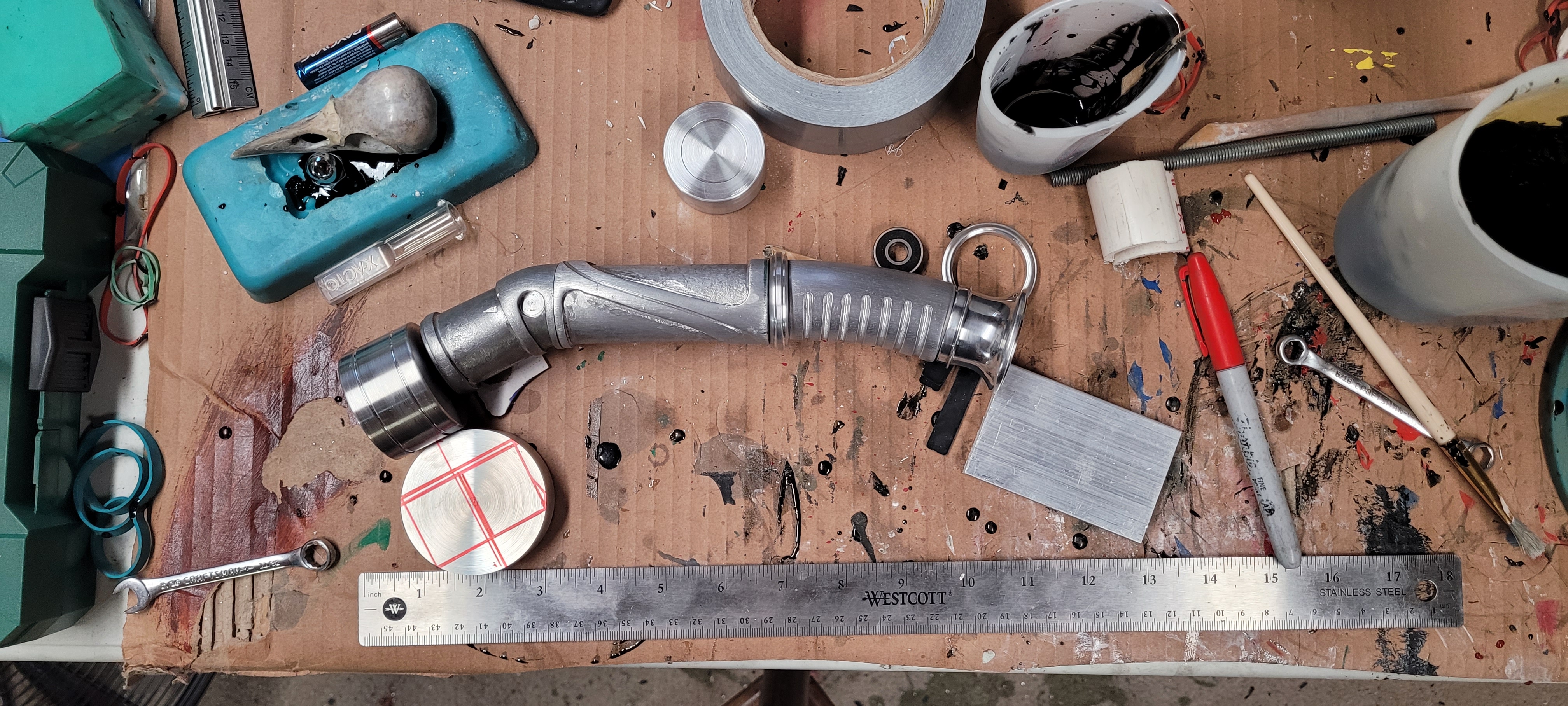

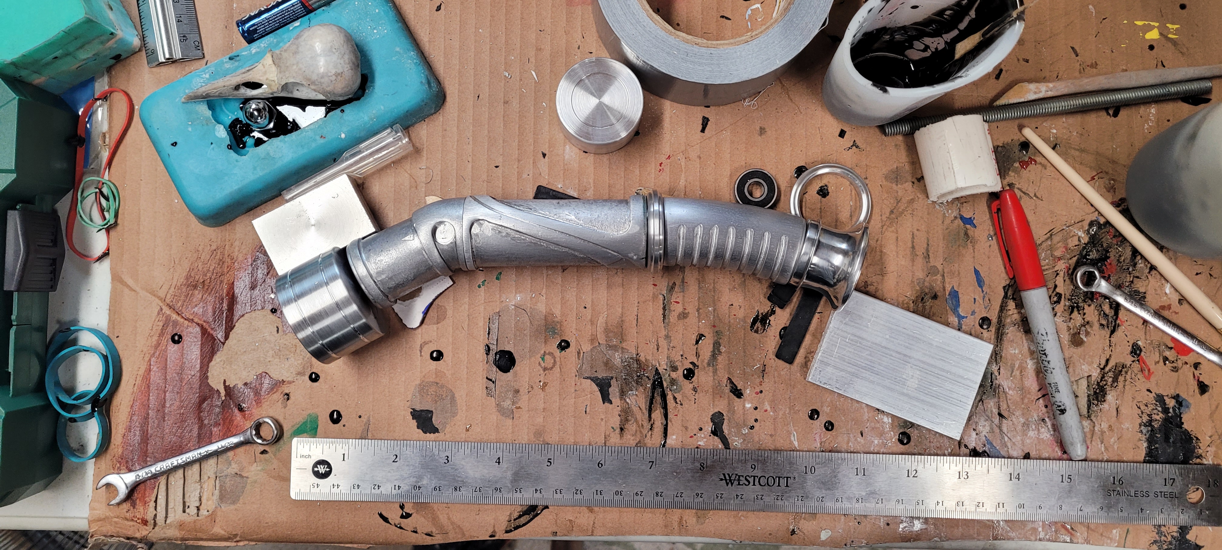

Still slowly adding to this project. It slowed a bit as I'm really not wanting to make any major mistakes that will have me recasting parts again, so I'm making doubly sure that everything I do is well thought out. It's measure six times and cut once for me, at the moment. Some examples exist in the few photos here.

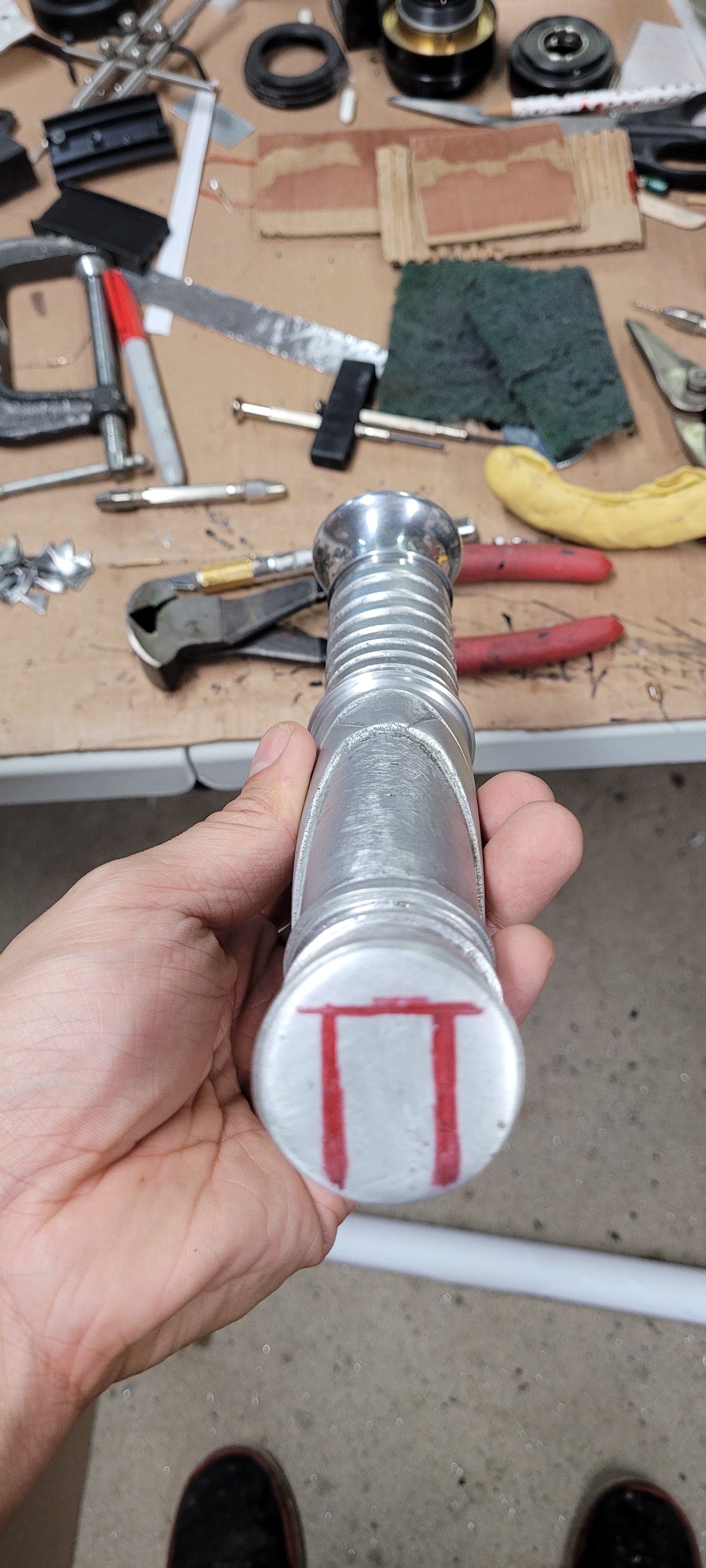

I machined a, what I consider, better transition ring between the main and foregrip pieces and two different pommels. I had a hard time reconciling that the pommel on the hilt is just a solid puck of metal. A proportionately large one, at that. It doesn't seem as goofy in photos or in the movie as it does in individual pieces laid out separately. I made one more "idealized" pommel, and another as accurate to both the prop and my hilt's measurements. I think the idealized one looks better, more modest and looks more in line with the proportions of the rest of the hilt, but my scrutinous nature just couldn't let me commit fully to that change. The pommel 'block,' the square piece that bridges the pommel and knuckle joint, was more straight-forward. I needed one and cut it from my stock 3in round bar.
This is where it is at the moment. I'm working on doing mock-up's for the 'prong' that runs the length of my replica and finagling it here and there to get it to suit my hilt's silhouette, and get closer to the production prop. I didn't take another photo, but I tinkered on this styrene cut out of the prong even further, after taking this photo, so it more resembles the proper shape. I'm very adamant about keeping this prop within the specs listed by Propstore about the Hero hilt made for RotS (within 13" in length). If I could just futz with anything and be happy about it, I would have the prong extend just a bit further.

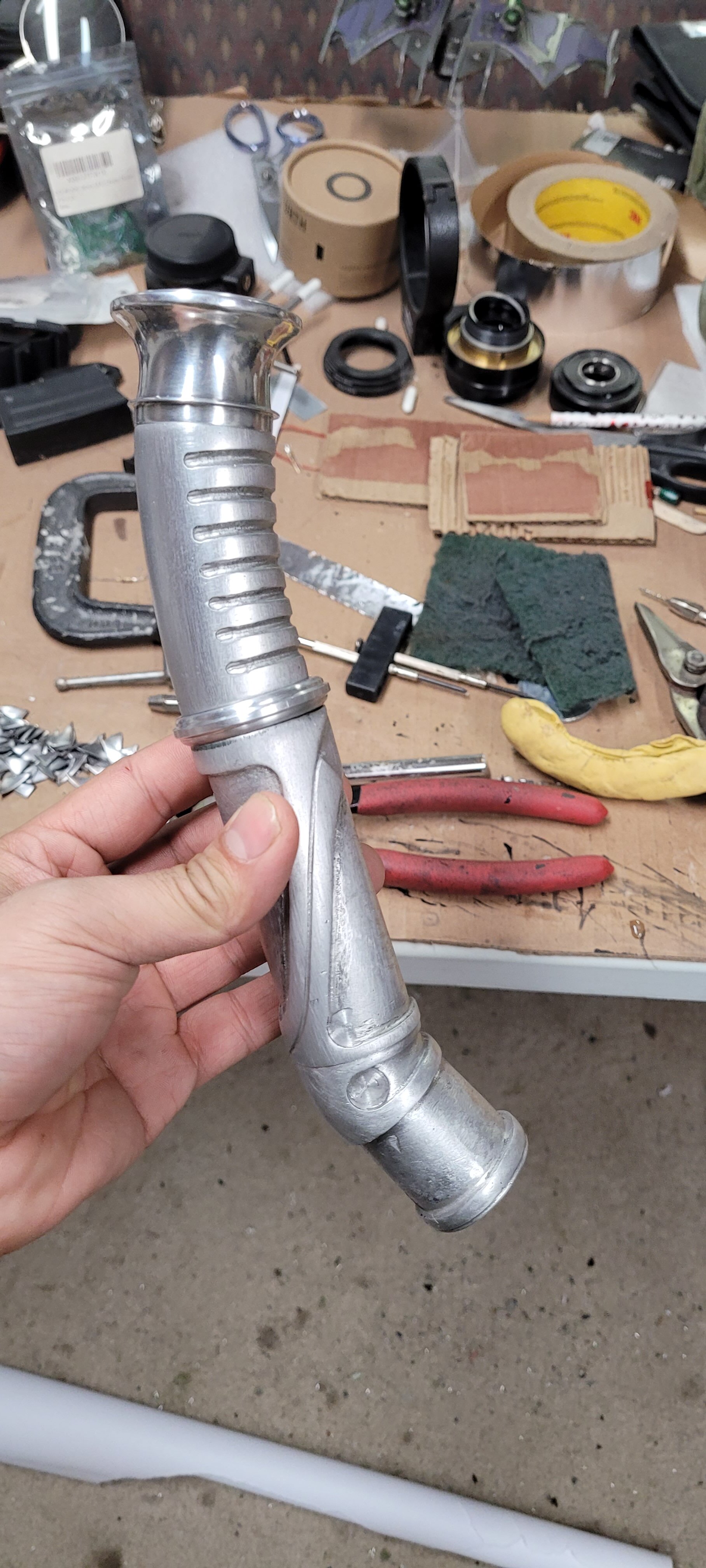

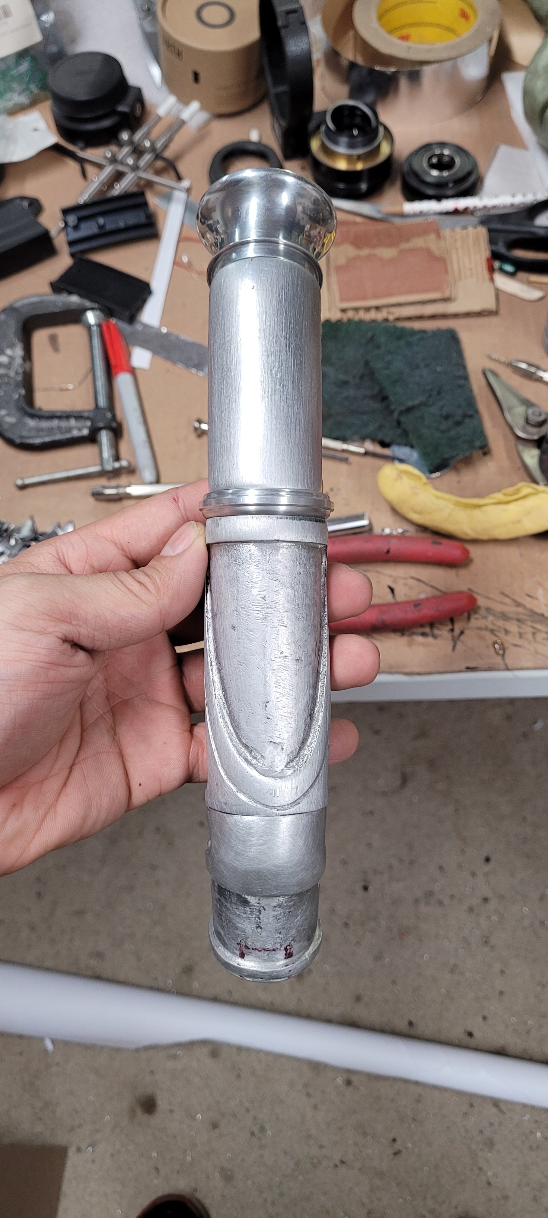

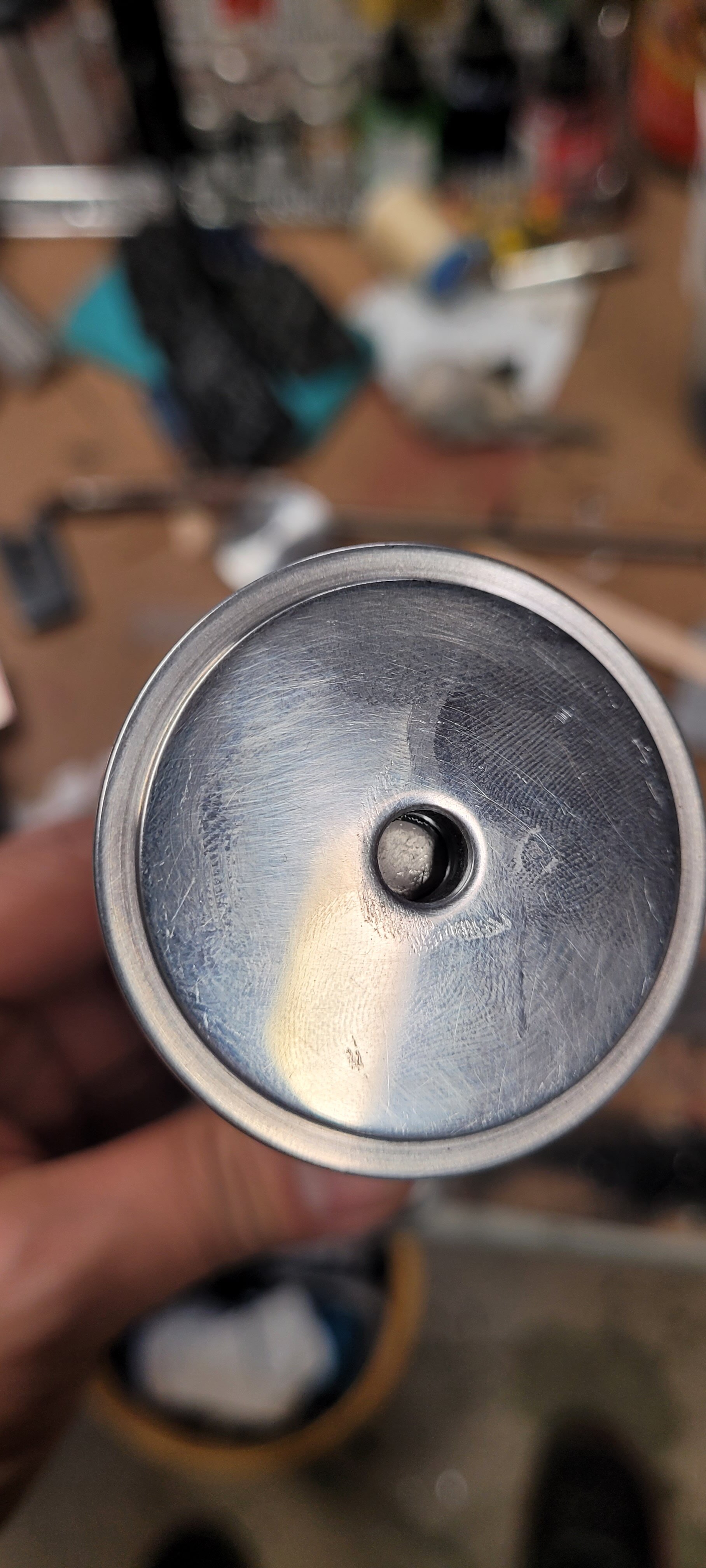

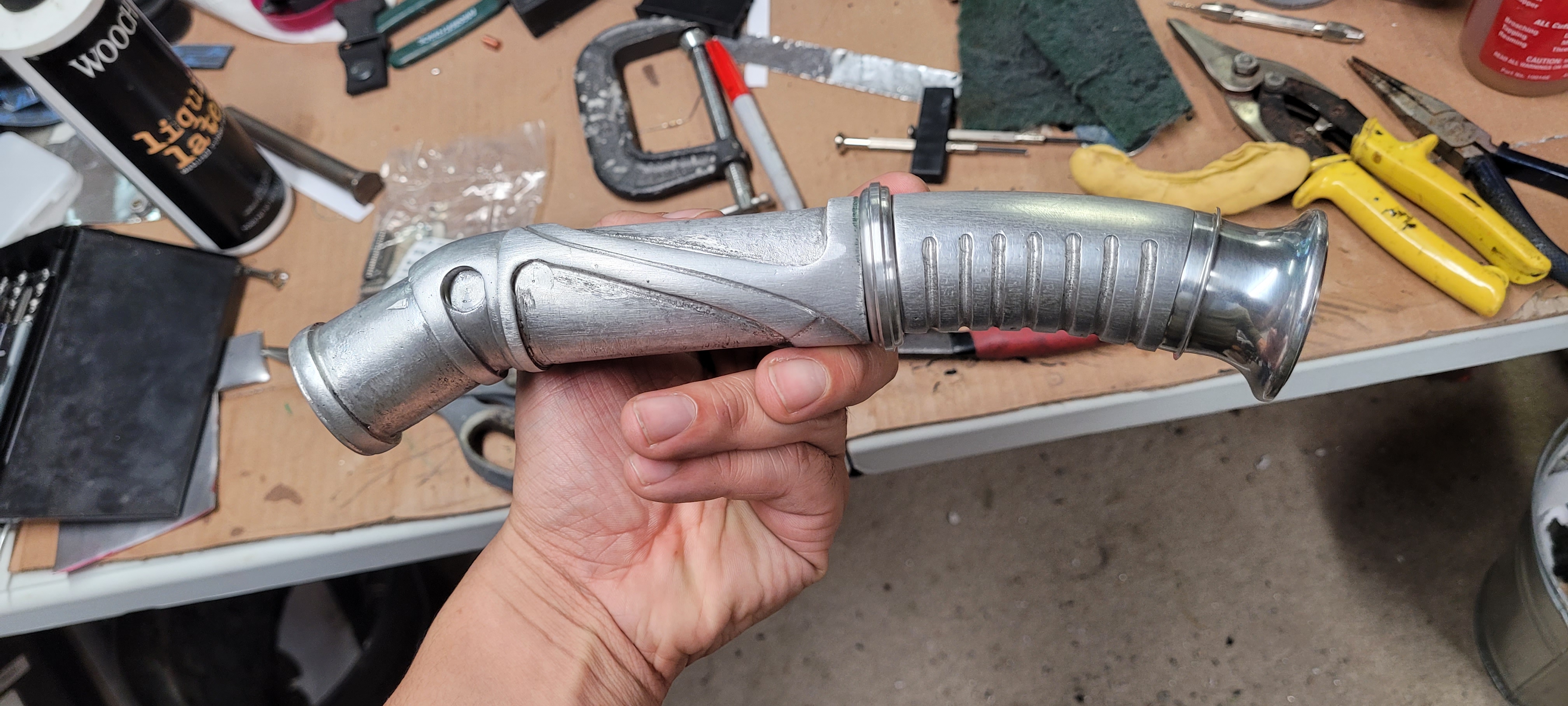

A very minor update to the project: the separate parts are finally threaded all together. I knew it was a matter of time before I messed something up and it turned out to be the threading of these pieces that did me in. Being that all but the emitter is cast metal, nothing lined up and finding center between 3 wonky, oblong, and misshapen parts was much more finicky than I had anticipated, and I took my sweet time as a result working every kink out as best I could.
I had to recut the holes to thread it all together a number of times. I had initially wanted to use a spare 5/16 threaded rod I had, but completely botched tapping and threading every part from the knuckle up. Nothing was aligned. 5/16 is used in the knuckle to fit to the main grip, but either ends of the curved foregrip is tapped with an m12 thread on the face connecting to the main grip, and an m16 thread connecting the face to the emitter. Both ends are then fitted with reducing adapters to mate sections of m8 threaded rod. It took so much finessing trying to find center of these pieces, and incrementally adjusting thread depths so that all the pieces would tighten and orient themselves properly, then shaving areas down to either mimic details of the prop or adjust specific areas to better align. The knuckle was one such part that needed to be shaved down in diameter to replicate the step between the main grip and knuckle that the real prop has.
I also had to mill a more inclined angle to better mate and replicate the curve of the emitter to the prong. That was giving me real troubles as to why my prong design, though nearly completely replicating the real prop's shape, wasn't matching the angle to the emitter.
Now, it's all properly locked together and the tolerances of each seam is nice and tight. I daren't take it apart fully for fear I mess something up again and it not aligning properly after. The knuckle not so much, but the grips and the emitter areas I want to leave as much in place as possible. You can see in the photo below just where I want to cut the space for the pommel block and using that as a sight line to center the prong channel that cuts through the upper elements. I'm incredibly nervous about tackling that. I spent a good amount of time recently aligning my mill so it cuts perfectly straight along the x-axis just to prepare for this. I don't know when I'll get around to doing that but that's the step after I figure out the pommel and block details.
One further thing to note is that this has a very good weight to now; it feels right in the hand. With the remaining pommel and accompanying block and the prong added, this thing is going to be fairly heavy once those things are attached. The heaviest hilts I own are my ANH Kenobi hilt and my bronze Palpy Hero, and this thing is going to join their ranks once it's all said and done.

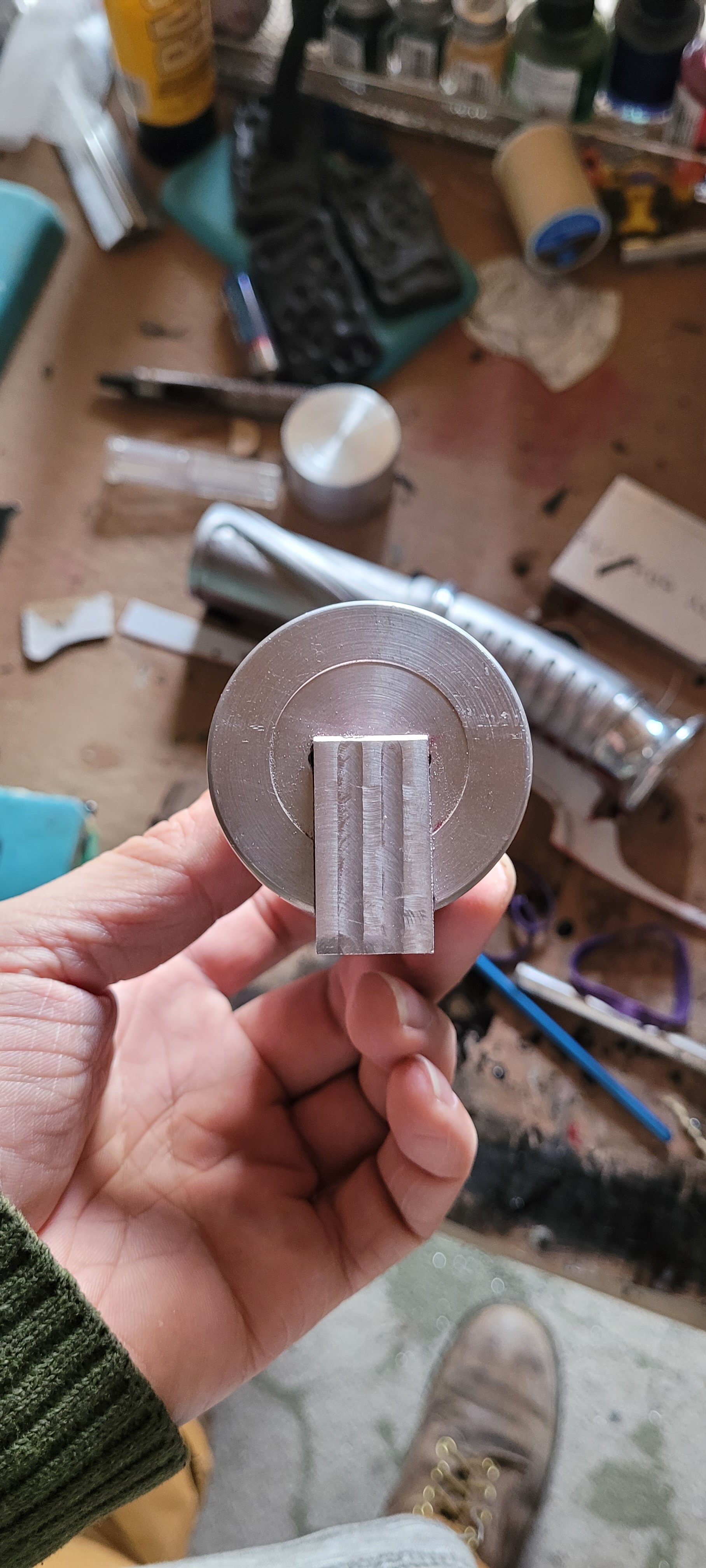

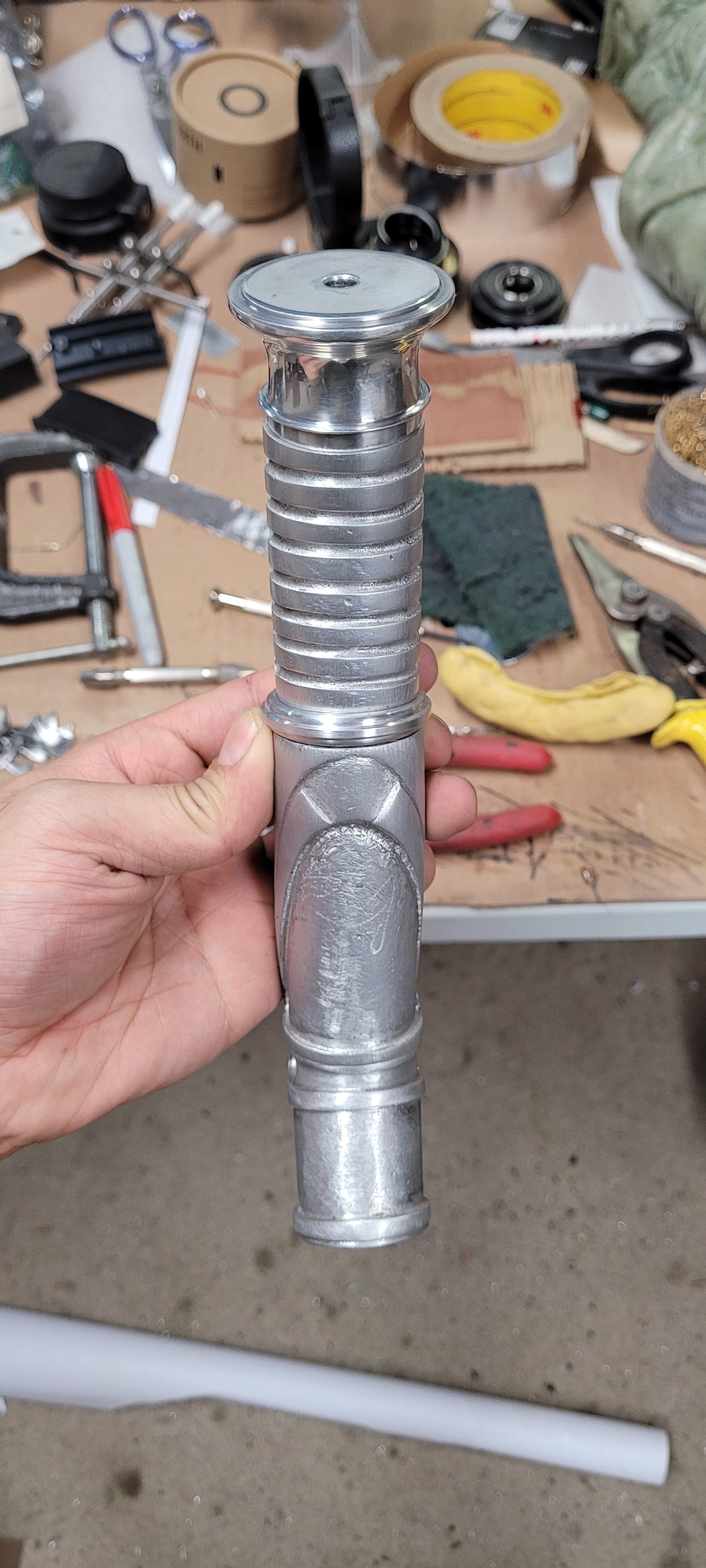

Goodness, I've not touched this thing since September! Well, I finally took the plunge to sort out the counterweight/pommel and the block to connect to the knuckle piece and spent the day yesterday drilling, milling, and cutting the pieces to fit together. I only have the most basic of tools and the most rudimentary of machining abilities, so everything had to be reduced to the simplest means of execution possible.
Cutting the chunk out the center of the pommel required drilling perforations along where the shortest side would be, and then using my deep-cut portable band saw to cut into the perforations. I used my jeweler's saw to hack through the perforations to cut free the block to produce the negative. I originally thought about using the mill to do all of it but it proved too time consuming, and I wanted something faster. I only used the mill to square edges and to get a decent fit to the block. I drilled the perforations just a little wide and there are two small spots on either side of the channel that shows it.
Getting the channel cut into the knuckle was a more sensitive affair as I had to jimmy the piece in the vice with bits of wood to not just keep the piece from marring, but held level with the end mill bit. I foolishly thought about dremeling the rounded edges in the milled channel to fit the block when just rounding the edges of the block would've solved the issue faster. I'm lucky I came to my senses before I risked messing anything else up. Lots of slowly fitting the pieces together as I went (to get decent tolerances) eventually lead to this:
I still cut my tolerances a little loose but I guess I'm just that kind of machinist. I needed to use a bit of styrene as a shim to get a better fit to the knuckle and block. The pommel and knuckle assembly are currently held together with CA glue just for dry-fitting purpose but the results are promising. The next step is going to be milling the channel for the prong and that's going to be a bit of a wait yet, while I muster the foolhardiness to do that. Like many things I attempt, I'm ill-equipped and inexperienced, so I'm taking my time to just figure things out a little more carefully before I commit to taking more metal off. Even in the state it is in now, it feels absolutely great in the hand to hold. The counterweight gives it such a nice balance, keeping the point of balance further down the main grip.
