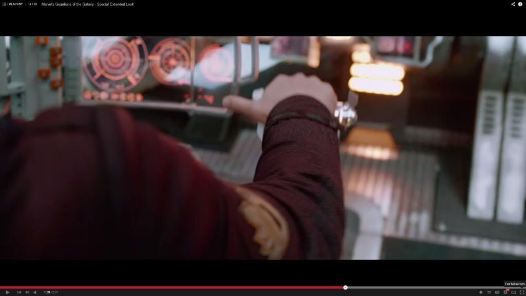

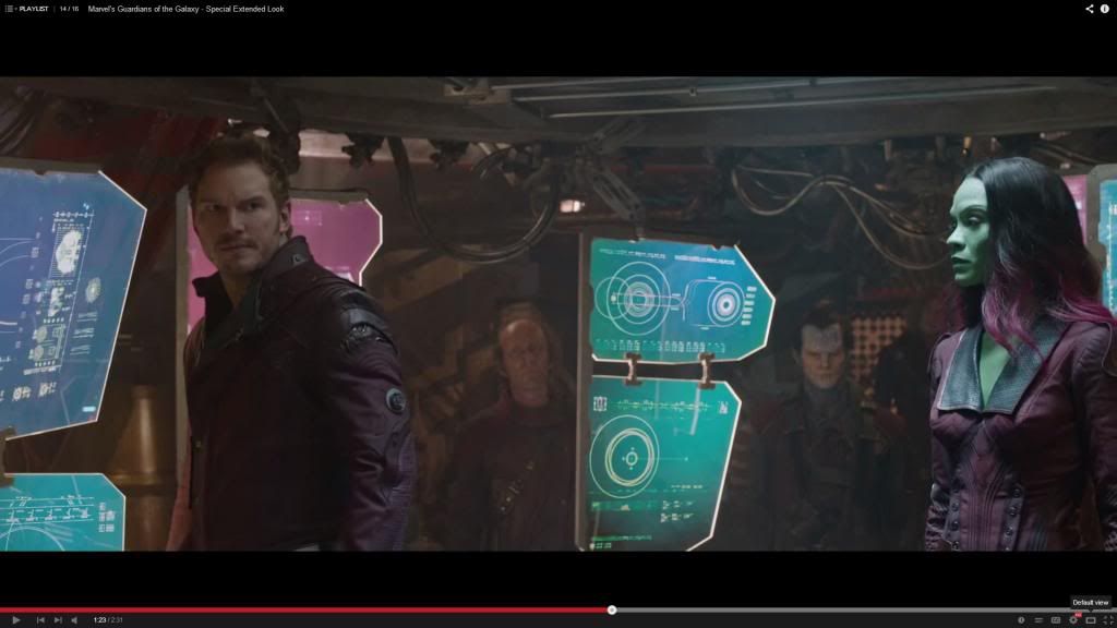

I have to say, I really doubt that the "Team Uniform" version is leather, faux or otherwise, at least not fully. Parts of it (like the shoulders) definitely are, but the rest looks more like a normal cloth. I just can't look at that quilted forearm in the cockpit shot and see it as leather. I think the picture where it does have more of that look is more a matter of the way they've played with lighting. contrast, and color saturation. I took a couple screencaps from this video: https://www.youtube.com/watch?v=EgHeRCHkrwo&list=PLK5HARgNfgj9Nzu9sVTzFzn1aPMm7aGlu&index=15
In this first one, though it's a bit blurry, you can see a definite non leather texture on the arm. that looks like the front of Drax's pants, which you can see as he puts his knives into their sheaths. You can also see the same material in parts of Gamora's red outfit. Then again, the sleeve looks really different in this shot compared to the part where you see Star Lord from the front a split second later, so maybe it's actually the arm of one of the background characters you see in similar red Jumpsuits in the next picture. :p
In the second picture here, I think you can definitely tell from the sleeve and shoulder that there are several different materials in this uniform and not all of them are leather.
