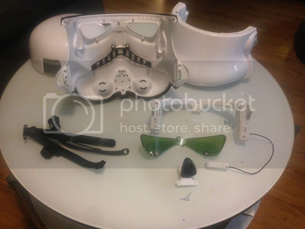

First things first, I had to disassemble the helmet which turned out to be a pain in the backside. The clips that fasten the three sections together have two interlocking tabs that hold it together from two sides, so it took some nerve and muscle to separate them, but I finally managed it. Next, I removed the adjustable headbands along with the lenses, microphone and the rubber nose rest since all it was doing was mashing into my face. The plastic strip behind the faceplate that holds everything in is held on by five screws and wasn't a big deal.

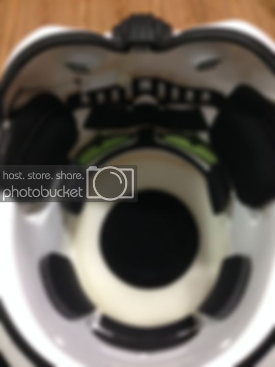

All the interior plastic trim that goes around the crown will have to be shaved back where it's bumping into my brow and the back of my head. I'm using some epoxy putty to add some mass to them and hopefully make it easier to grind the plastic back.
There's a lip on the interior of the back section of the helmet that I want to cut back as well, and checking it against the top of the helmet shows I'll have to adjust the cut to keep it inside the geometry of the helmet exterior.

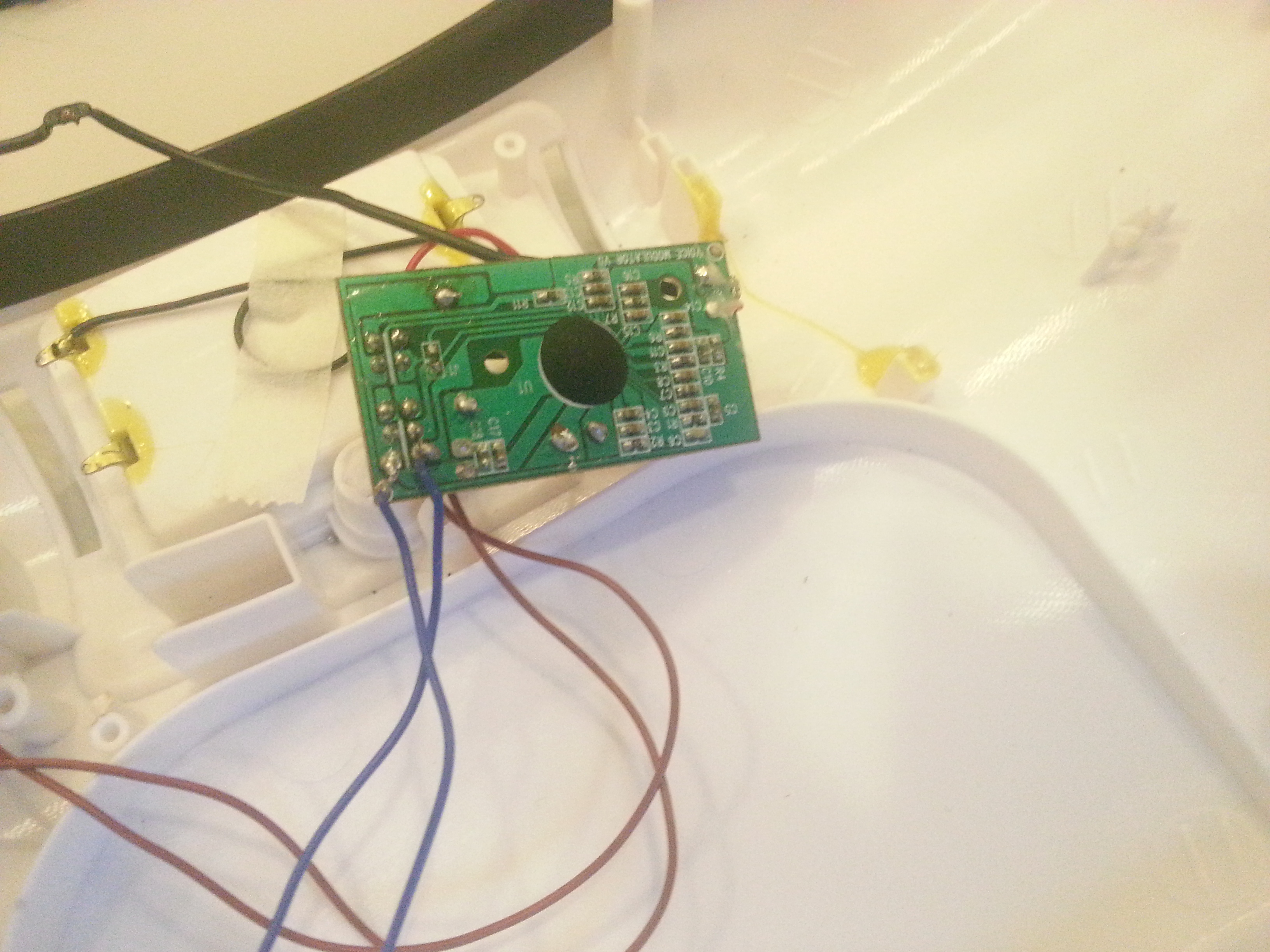

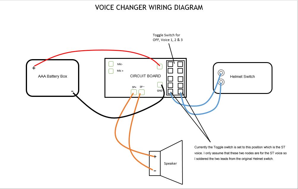

I wanted to use back the original helmet's ON/OFF switch, but I am unsure how I need to connect the two leads from the helmet switch to the Voice Changer circuit board's toggle switch. I'm not confident in doing a clean removal of the circuit board's toggle switch haha, considering this is the first time I touched a soldering iron since I was 19!
Currently I soldered the helmet's switch leads (blue colour wires) to the last two leads on the circuit board which should be the "Stormtrooper voice". But now when I press once on the helmet switch, yes it will turn off the mic/board but after that I can't get it back on. I have to reset the slider switch on the circuit board instead to turn it back on. Is it even possible to leave the on-board slider switch (set it to the Stormy voice) and hook up the original helmet push-button switch to it? I really suck with electrical/electronics!

This is a short video of the mod and my current wiring diagram. Forgive me if the quality or my speech is bad, as I shot the video just before rushing off to work!
Wiring.JPG https://drive.google.com/open?id=0B2BeSbkoEk7qbFh0S1h5dHE0a0k
View attachment 701546 https://drive.google.com/open?id=0B2BeSbkoEk7qbFh0S1h5dHE0a0k
Dude! That's wild, I think we're using the same voice changer (I'm pretty sure I saw the same video you did and tried to order the same one), and I need to know EXACTLY the same thing!! I'd like to keep the functionality of the pre-existing button if at all possible, otherwise I'm worried I'll need to figure out another on/off switch, how to install it and where to put it, and I'd rather my learning curve not get any steeper on this project if I can help it. :D
If anyone here here can shed some light on this I'd really appreciate it!

You stole the words right out of my mouth when you said " I'd rather my learning curve not get any steeper on this project if I can help it" haha! I would really love to move on with this project as I am kinda stuck with the helmet switch issue. I could desolder the blue leads from the helmet switch and just randomly (maybe tape ém down?) touch the solder points of the circuit board slider switch to see which ones work. Haha should've paid more attention in technical school!
By the way I also noted something interesting --- with my current wiring setup, if I were to set the voice changer switch to position 1 (the deep Kylo Ren voice) and halfway while speaking into the mic, I pressed once on the helmet switch, it will change to the position 3 (the ST voice). Then another press of the helmet switch does nothing and sometimes it will turn it off but not turn it back on.
I am throwing this wiring dilemma to a local electrical/electronic forum and see if I can get someone who might help.

The fit is certainly better in terms of space, although I'm still getting some pressure on my brow as it sits at the moment. When my padding comes in I'll arrange it so it's taking off the pressure and I'm not supporting the weight of everything on the bridge or my nose. I'm also planning on cutting some thin craft foam to stick on the bracket that secures to the faceplate so there will be a little padding in my nose. Speaking of my nose, I removed the bracket that used to hold the mic so it eliminates the chances of it catching my nose when I put it on and take it off.
Also, I cut the lip on the back of the helmet. Thank god I checked the tapering, I nearly cut too far and there were almost holes in the back of my helmet! Luckily, it sits perfectly and you can't see anything from the back.

Just to update on the voice changer mod - I finally got it working right! With some help from a local forum, a guy showed my the right wiring I needed to do. You can compare my previous wiring diagram with the right one below.
So I now have the original helmet switch working, BUT since it is a momentary switch, it will only work like PTT (push-to-talk). You got to hold down the switch to talk. This is probably due to the original voice changer circuit design which has some sort of timer to keep the circuit closed before it automatically opens. A trip down the local electrical shop to get a maintained latching push-button will do the trick. Just have to find one small enough to fit

That's great reezahl, please let us know the details of the switch you use when you're done! Also, I think you may have posted the same diagram as before :p If you have a new one I'd really like to see your solution :D
Ooops my bad! This is the actual diagram. But unlike me, it would be better if you have a latching switch to replace the original. Unless you don't mind the helmet switch to function like a walkie talkie's PTT. Yup the original switch is a momentary switch so after swapping out the original voice changer, you have to hold down the switch to speak.
