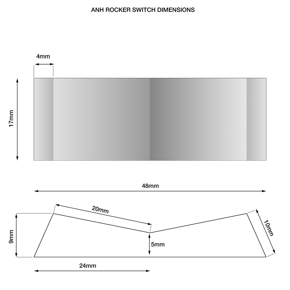

BTW. Here are the dimensions for some rocker switches that were used in the movies. They were measured from some real buttons many years ago by someone here on the RPF - I forget by who.

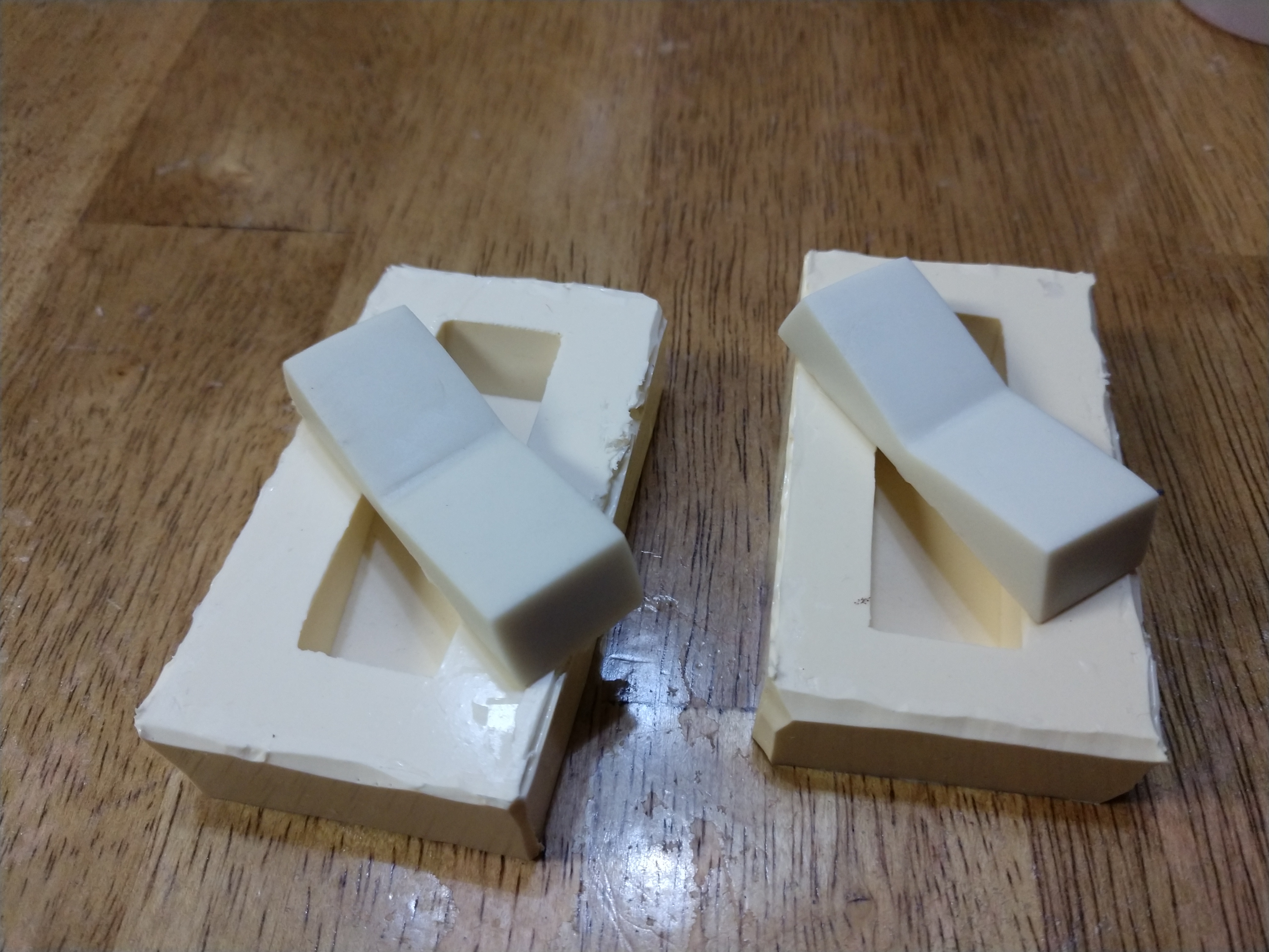

I screwed up my first attempt of casting the mold, but that's ok. I anticipated things going wrong and I learned a few things, so it wasn't a total bust. I started this with the idea of having failures before I had success. So I'm ok with failed results if I'm able to learn from my mistakes.
So I will give it another go later today.
It's probably a overkill, but I'm letting my silicone cure for at least 24 hours just to be certain it's completely cured before I mess with it.
After my first mold failure, the second and third came out great after learning from previous mistakes.
I mixed and poured some resin. I did not anticipate how quickly this resin would set up. I will use up what I have, but I will have to get something with more work time. I'm looking at Alumilite slow set 7?
I don't like being rushed like this. But anyway, my first casts came out good even with a couple hiccups.
I'm planning to continue to make casts until I use up this resin and hopefully learn a few more things.
I've had some nice success with this. I've learned a few things and I'm very pleased with my results.
