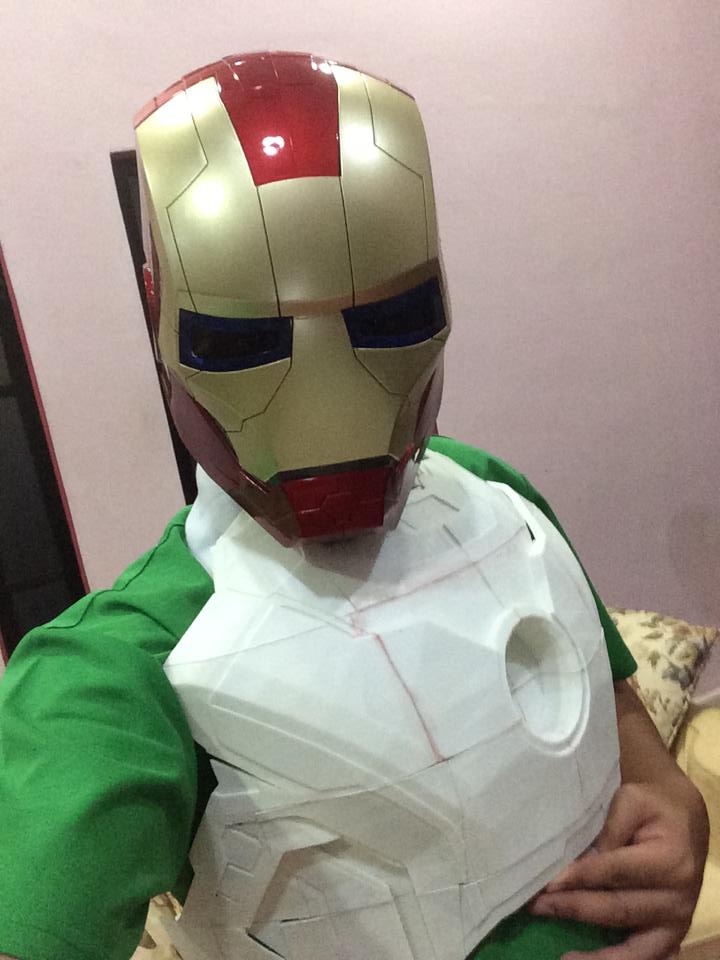

Hi all, recently I 3D printed the MK42 arm by @Abb_eliten http://www.therpf.com/showthread.php?t=166141. I tried to look for 3D print files for the whole suit but to no avail. Hence, I figured out to convert them from pepakura to STL. Files used are by @jackieisrockin & @Helagaks, great thanks to both of them for the awesome files. The parts that I've converted were only chest, back, abs, cod, thigh, shin & boot. Other files are already share within the forum.
![full armor.jpg full armor.jpg](https://therpf-f28a.kxcdn.com/forums/data/attachments/140/140090-3a262f88d83a24b55161a0f7cd9f4f8d.jpg)

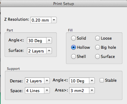

I'm using Up! Mini 3D printer and here is the settings I used:
![Screen Shot 2014-09-08 at 10.05.18 PM.png Screen Shot 2014-09-08 at 10.05.18 PM.png](https://therpf-f28a.kxcdn.com/forums/data/attachments/140/140094-0ec1737e8aea439b51cc1260ae692f1b.jpg)
The parts thickness are around 2-3mm so it will be light when printed but still durable.

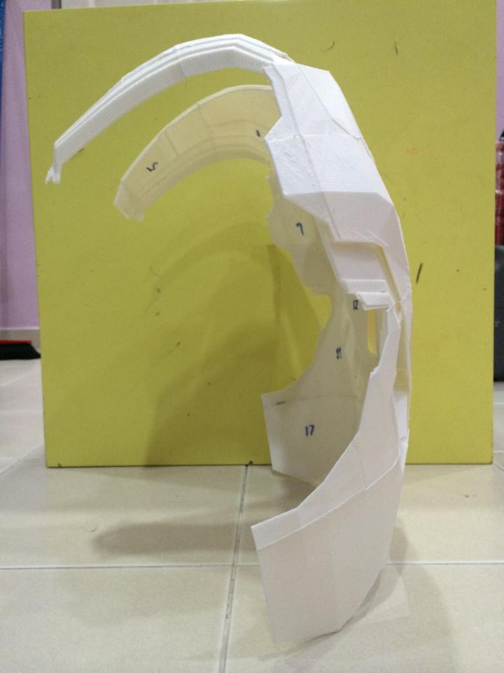

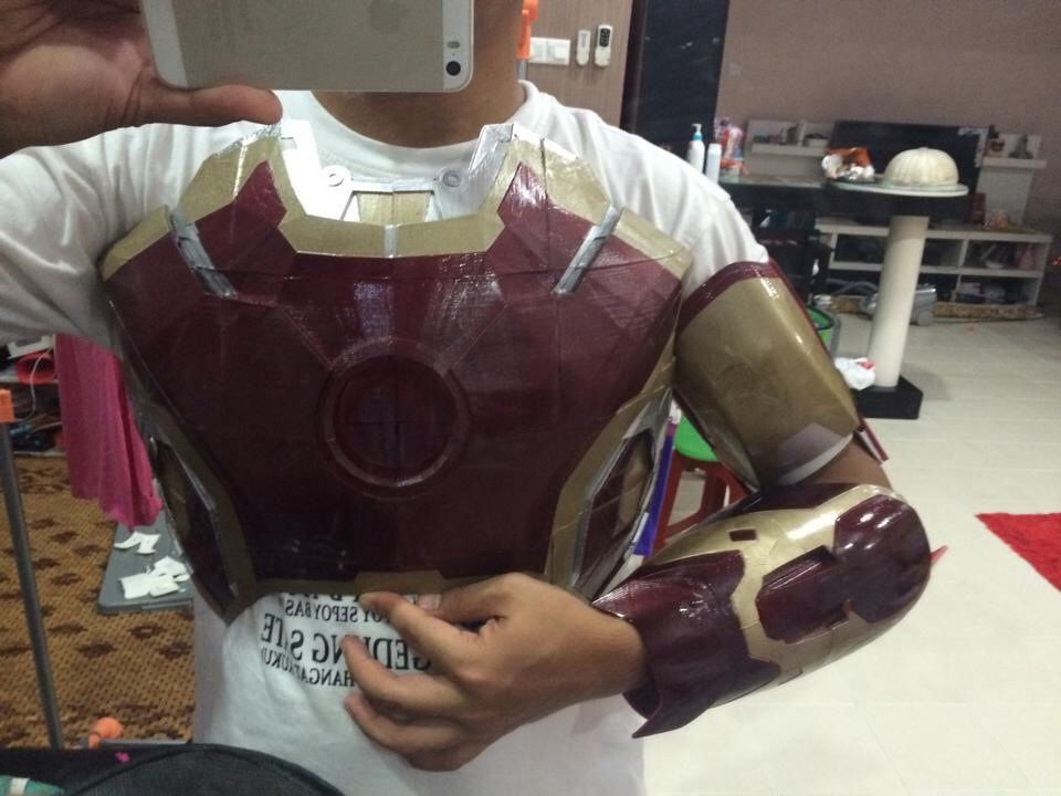

Chest:
Status - Printed
Total print time - 31.73 hours
Material - 325.2 gram
![chest02.jpg chest02.jpg](https://therpf-f28a.kxcdn.com/forums/data/attachments/140/140092-b6229c686e181e60fe577bb6e6e21fb7.jpg)
![chest03.jpg chest03.jpg](https://therpf-f28a.kxcdn.com/forums/data/attachments/140/140093-cf76ffb5b45988961154bdb45c894543.jpg)
![chest01.jpg chest01.jpg](https://therpf-f28a.kxcdn.com/forums/data/attachments/140/140091-dbbb4ca9f6d171140a28ffa04744b6bb.jpg)

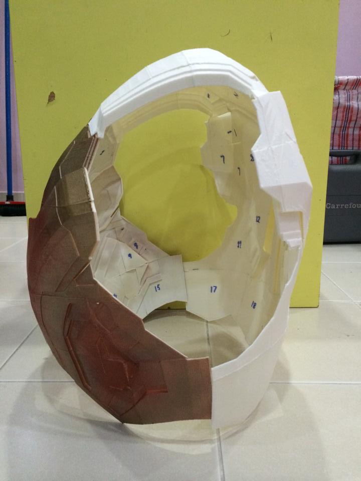

Back:
Status - Printed
Total print time - 44.28 hours
Material - 529.7 gram
![back03.jpg back03.jpg](https://therpf-f28a.kxcdn.com/forums/data/attachments/140/140097-cd6017982f3ea2efd0c5b8271d8279ef.jpg)
![back04.jpg back04.jpg](https://therpf-f28a.kxcdn.com/forums/data/attachments/140/140098-861457d0495b3cfced27cb726f9cea93.jpg)
![back01.jpg back01.jpg](https://therpf-f28a.kxcdn.com/forums/data/attachments/140/140095-5bcd7122d8aba53ca0906a752dbc40de.jpg)
![back02.jpg back02.jpg](https://therpf-f28a.kxcdn.com/forums/data/attachments/140/140096-7b8067339e8f89355900b13de78f38da.jpg)
![back05.jpg back05.jpg](https://therpf-f28a.kxcdn.com/forums/data/attachments/140/140099-ddcda171dcf26e8df482013f9adeb2a2.jpg)
