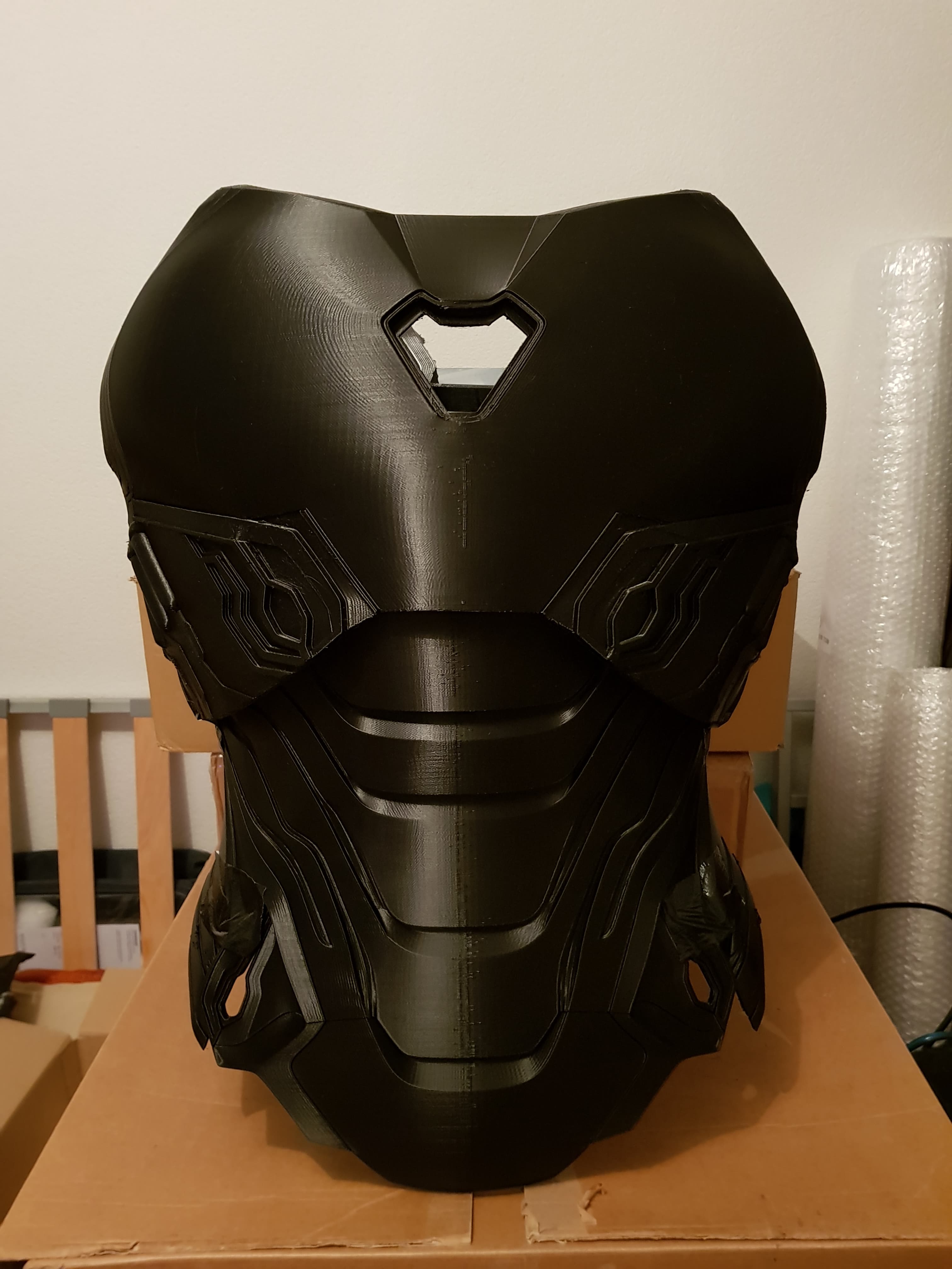

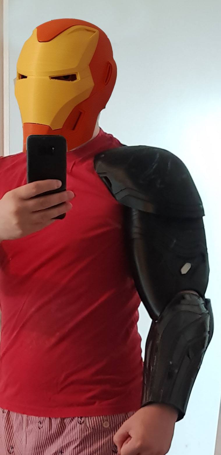

I printed the forearm and hand pieces of the DO3D file. So admittedly not a lot of the suit. Foam, in my opinion, looks amateurish unless its laser cut, however, i have seen some really good foam suits.

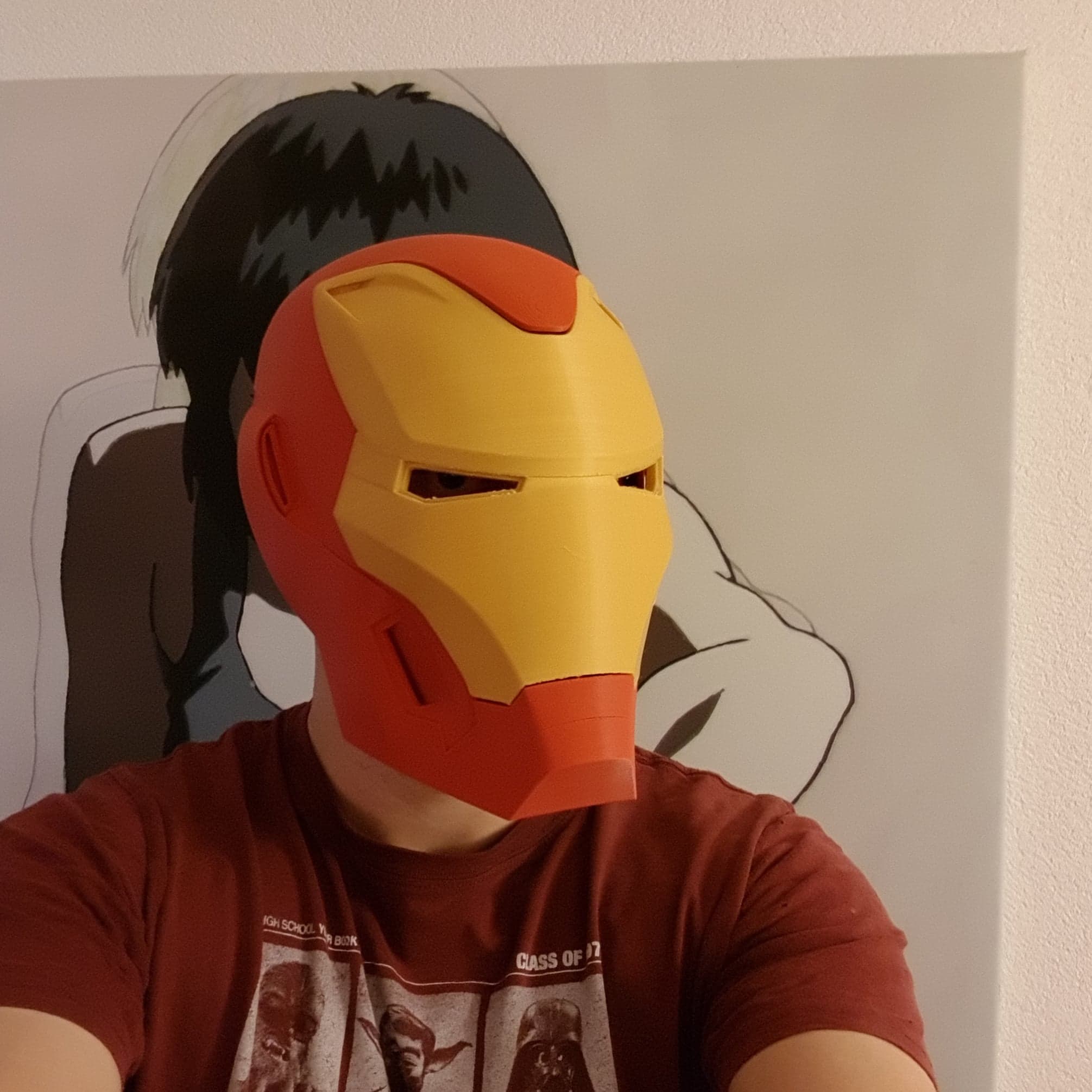

I’ve printed out a mark 50 helmet on the Z-18 at work. Came out pretty well. Thinking the Maxcraft files will be the way to go unless somebody knows of a better set of files.
I had a Bruce Handing Robocop suit, but ended up selling it. Thing was a pain to move in.
Wow! Now that's a fancy machine, I like it! Wife would kill me if I bought one though haha can't wait to see your progress stuff
