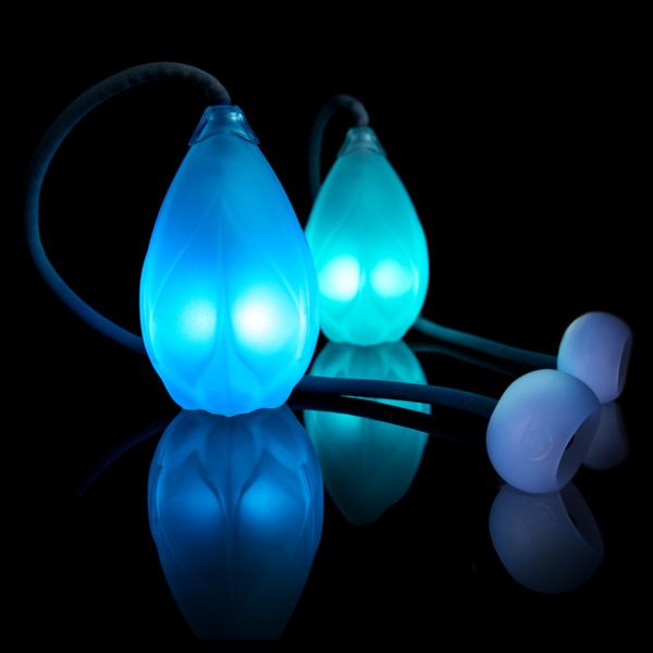

I have been looking for an off-the-shelf product that I can use as the bulb, and so far the best candidate would be the “Pod Poi”, which is basically a 4.5” tall plastic bulb with a glowing light inside. I may experiment with different LED inserts but that’s not an important detail right now.

This is for both dancing like a maniac and low-key head bobbing. I'd also be good if it didn't hurt excessively when I whack tall people with it, which is why I was leaning towards the pod poi. It's very durable and has a plastic casing.
