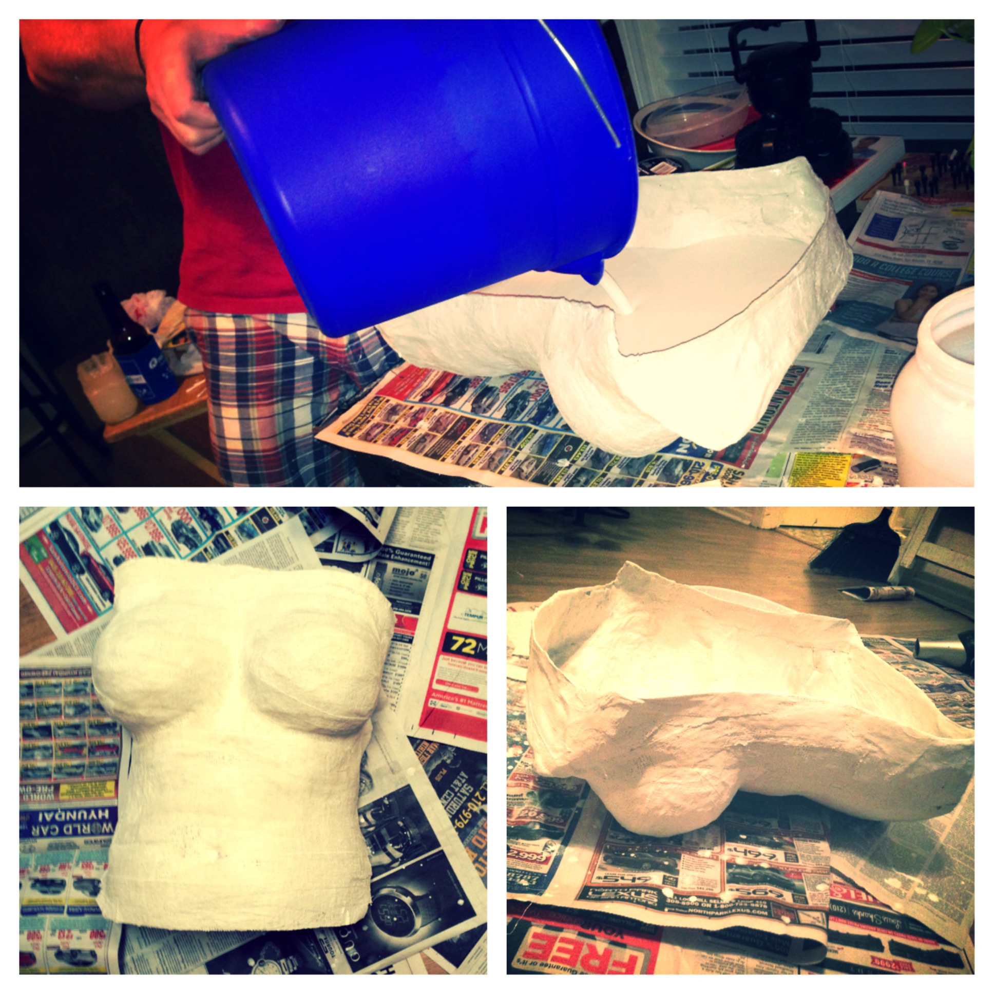

Well, I've made a mold!!
I found this stuff that is skin-safe:
4" E-Z Form Plaster Cloth Wrap | Shop Hobby Lobby
And incredibly cheap. Bought a few of them, had my awesome boyfriend help.
We wanted to make the mold directly on my skin, so boyfriend taped my breasts using masking tape so that they would be in the correct place without having to wear a bra. He covered me in Vaseline and then used the E-Z Form strips from the link above.
After it was dry (dries fast), we took it off and removed the tape. (That part wasn't so fun)
*edit: We built up the sides using duct tape and more of the plaster strips so that we could pour in the plaster.
I covered the entire inside of the mold with Vaseline and poured plaster in!
Once dry, it took a little TLC and help from a cake spatula (which was awesome since its so pliable) and the plaster mold came out!
Now the mold just needs a little bit of sanding, and I'll figure out the rest as I go... :)
Awesome idea! Cool product too, great for making a dress form perhaps. *hmmmmmm*
It would absolutely be good for making a dress form! Just don't fill it with plaster as it would be waaaaaaay too heavy (the bust we made is already difficult to pick up because of its weight).
