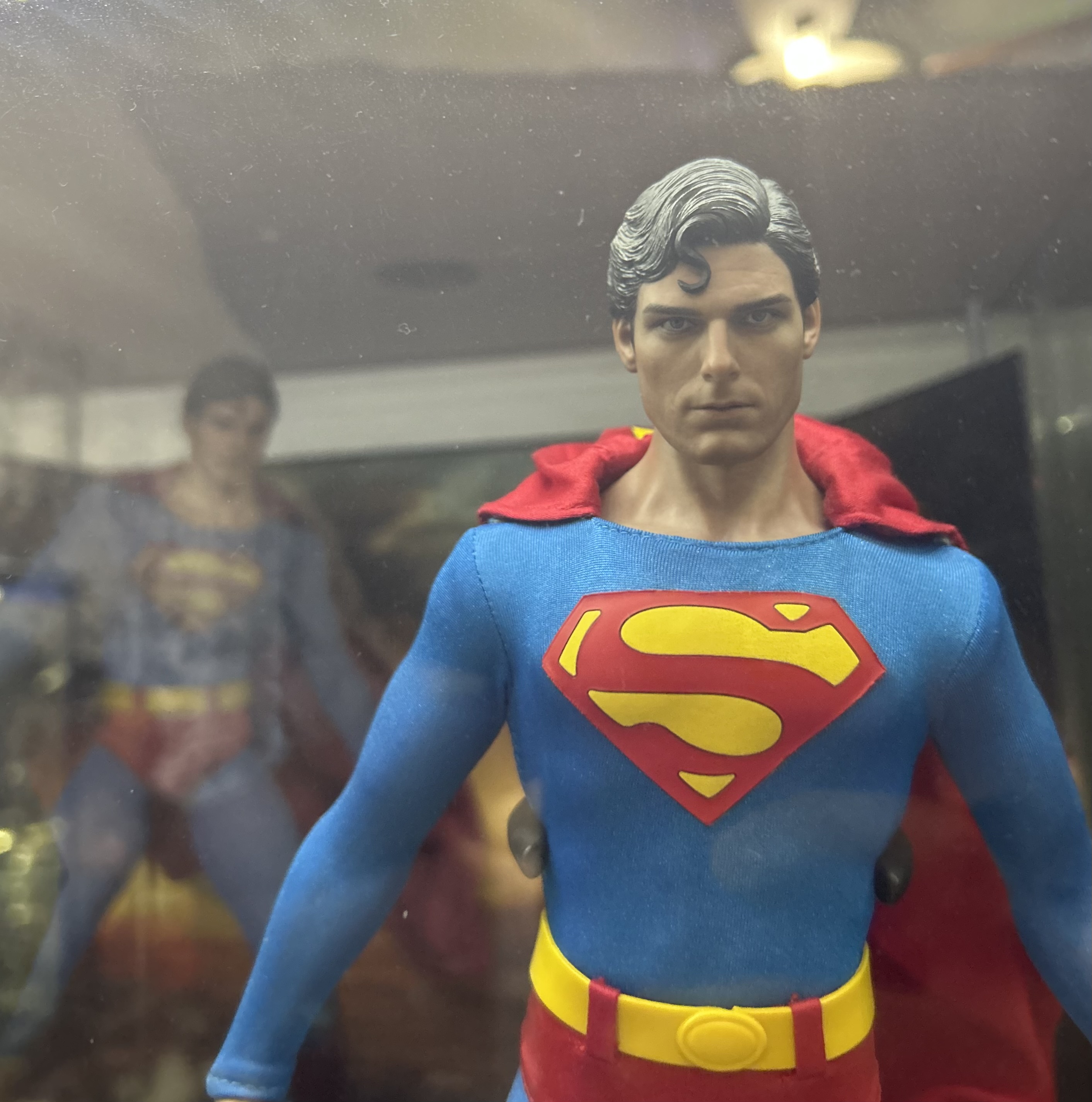

For like forever I've wanted a good 1/6 Chris Reeve Superman figure. Hot Toys came out with a nice toy a while ago, but before it was released I realized that I didn't want to go into debt to get something so, well, toy-like (the true Reeve likeness just isn't there for me).

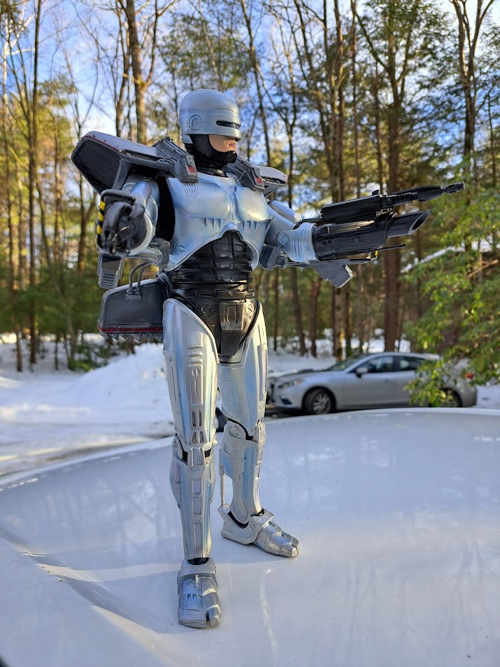

I recently finished a Horizon vinyl 1/6 Robocop 3 (not an easy kit to customize to the desired look),

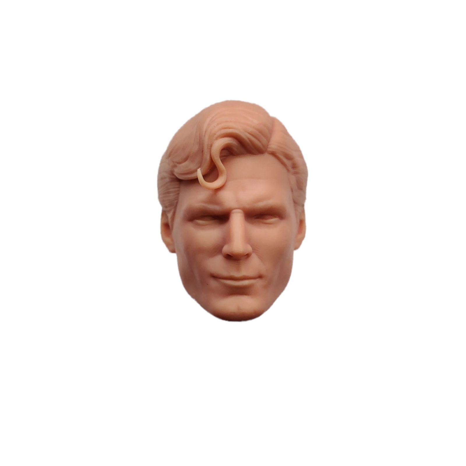

and that gave me the guts to go for the brass ring. I also found a dude in Canada that 3D prints replacement heads for toys, and his 1/6 Reeve head is stunning. THAT made me decide to do it, since I don't have to worry on getting the face right. Caped Wonder has some excellent reference images that I'm studying for the body that I intend to fabricate from epoxy putty, Super Sculpey, or a combination of both. I bought aluminum wire for an armature, and when the head arrives (estimate says the 28th) I'll do some drawings in scale to it and begin with the wire, and aluminum foil, then build upon that.

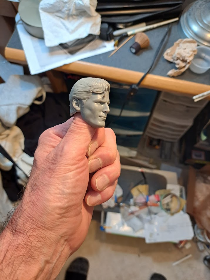

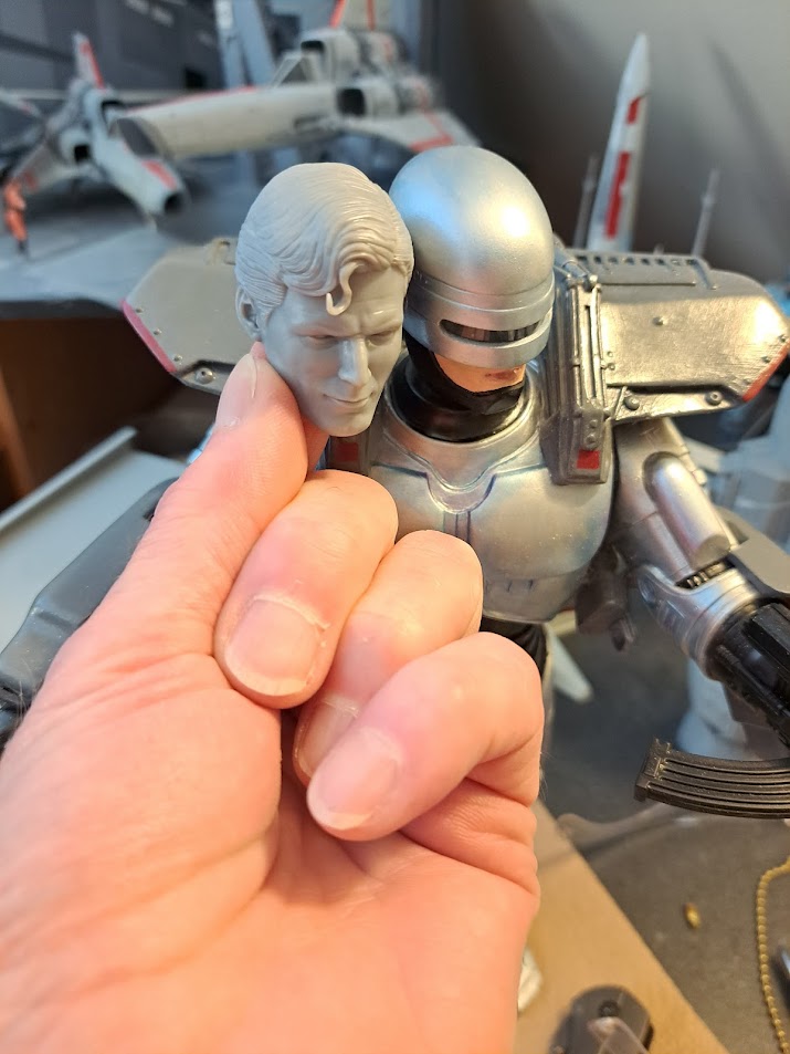

Got the head today, I was surprised that it needs no sanding at all! Looks to be same scale as my Robocop.

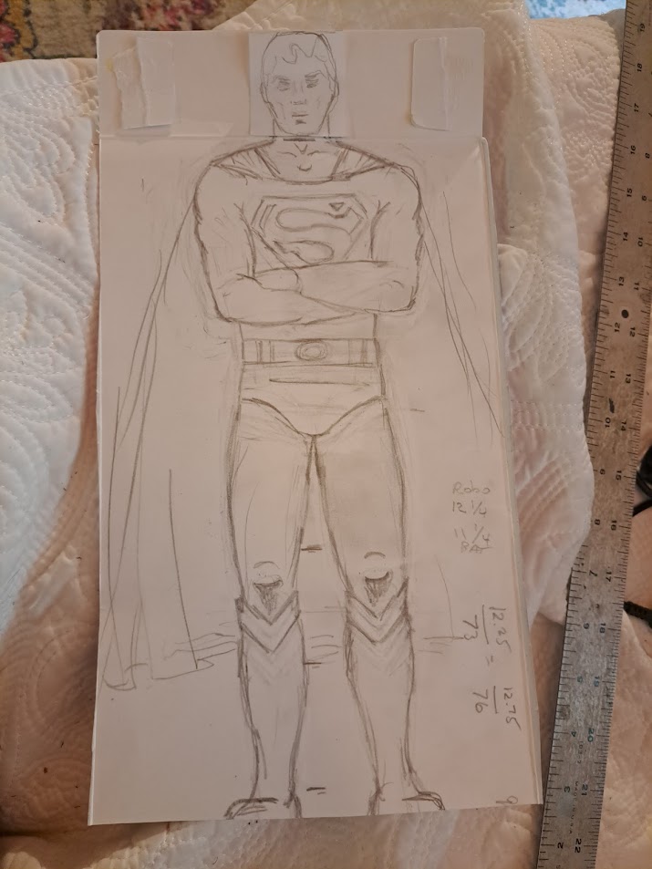

Based on this head which is 1 & 3/4 inches, this body will be nearly 12 & 1/2 inches tall. Compared to my Robocop which is 12 & 1/4" tall.
Chris,
You’re right, that head is incredible! When you sculpt the body, I would suggest using one material or the other. Super Sculpey is good stuff, but it can be a pain to work with. It’s not that strong and prone to cracking once baked. Adding epoxy putty on top is ok, but when it comes to sanding and blending, the two materials are different hardnesses, can be tough to get the results you want. I know many people get amazing results with it, not me! I would recommend Magic Sculpt epoxy putty. You can rough in your forms, and carve and sand and build up with it, it’s a beautiful material and plenty strong. Especially if the sculpture is going to be your finished piece. Good luck with your sculpture, I look forward to seeing your work!

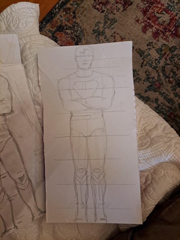

Hardening the target with more drawing now.

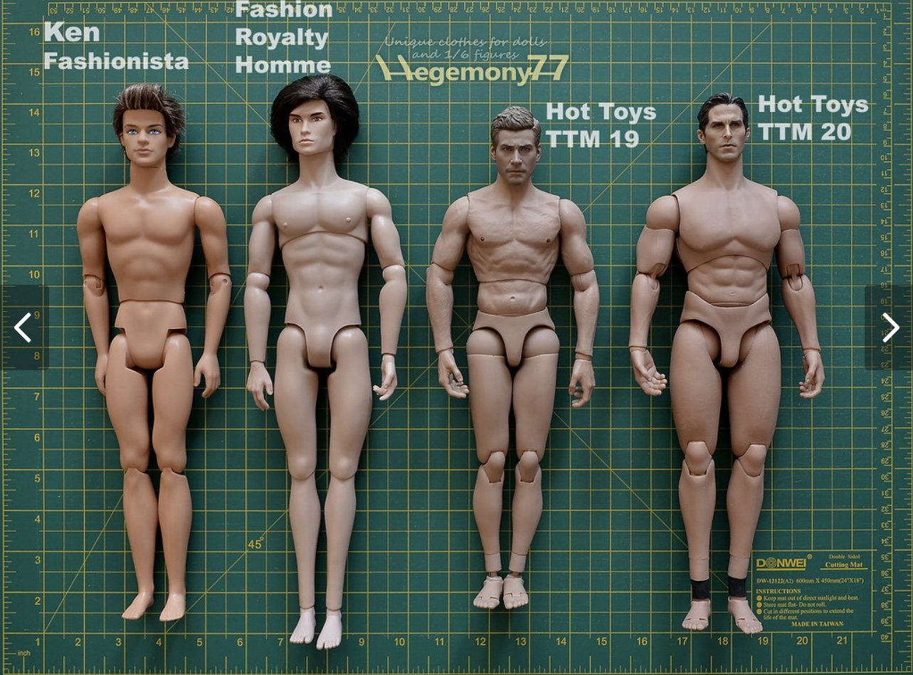

I know you don’t like waiting for stuff, but I would suggest purchasing a cheap 1/6 scale body and modifying that by sanding, cutting, gluing, to get the proportions you want. Then you can add your choice of epoxy putty to shape, bulk, and detail.
Places like monkeydepot has cheap bodies for around $10 plus shipping or Amazon for about $20. It can save you some time and materials, rather than starting completely from scratch.

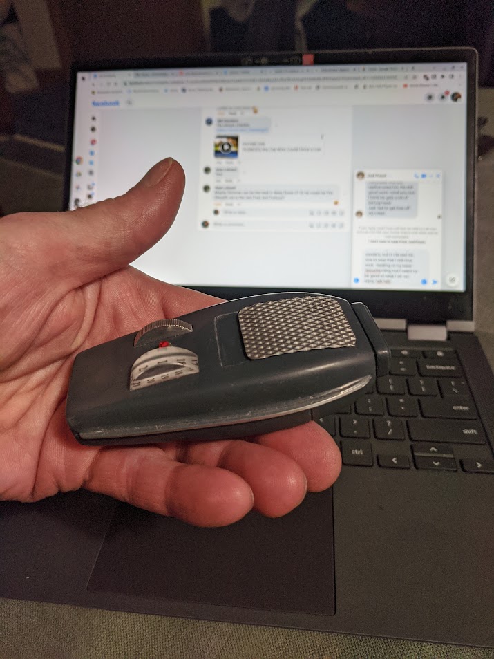

I've worked with JB Weld for years. Trick to it is, carve just after it feels firm (as it's cooling, but before it sets completely). Once it cures it's like stone, and can only be sanded, and even that's a CHORE! I've also used it for plumbing repairs.:cool:

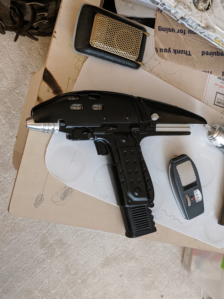

The body of this phaser I made is all JB Weld....

Tweaking the pose a bit. Please excuse the crudity of the head; I can draw stuff, but this is a schematic for proportions for the armature...

Not all 1:6 scale bodies are scaled for a 6’ tall person, there are taller 1:6 scale bodies and shorter bodies. For example, there is a 1:6 Lebron James figure scaled to his 6’9” height. The descriptions sometimes say a body is for a 12” figure, but that is just a generalized term when figures can actually be shorter or taller than 12”.
1:6 is just the scale so every inch of a figure equals to 6 inches of a real person.
So even if you get a standard body scaled for a 6’1” person, you just need to add approx. .5”. That’s why there are ankle extenders for figure bodies that adds more height for taller people.
Since it seems like you’re planning to make a statue, adding height would be easy to a premade body. Heck, you can even buy a cheap poseable Ken doll and add or reduce height as needed.
Here’s an example with a quick google search:
I’ve been a 1:6 scale figure collector and customizer as well as a sculptor for many years and believe me that modifying figures are always easier than making it from scratch.
By the way, I have the Hot Toys Superman and though it’s not perfect, the head sculpt is not as bad as the picture on the first post.
Yeah, his eyes don't seem crossed like in the picture I found. Still, the neck seems a bit too thin (for me). The body is really nice, though.
