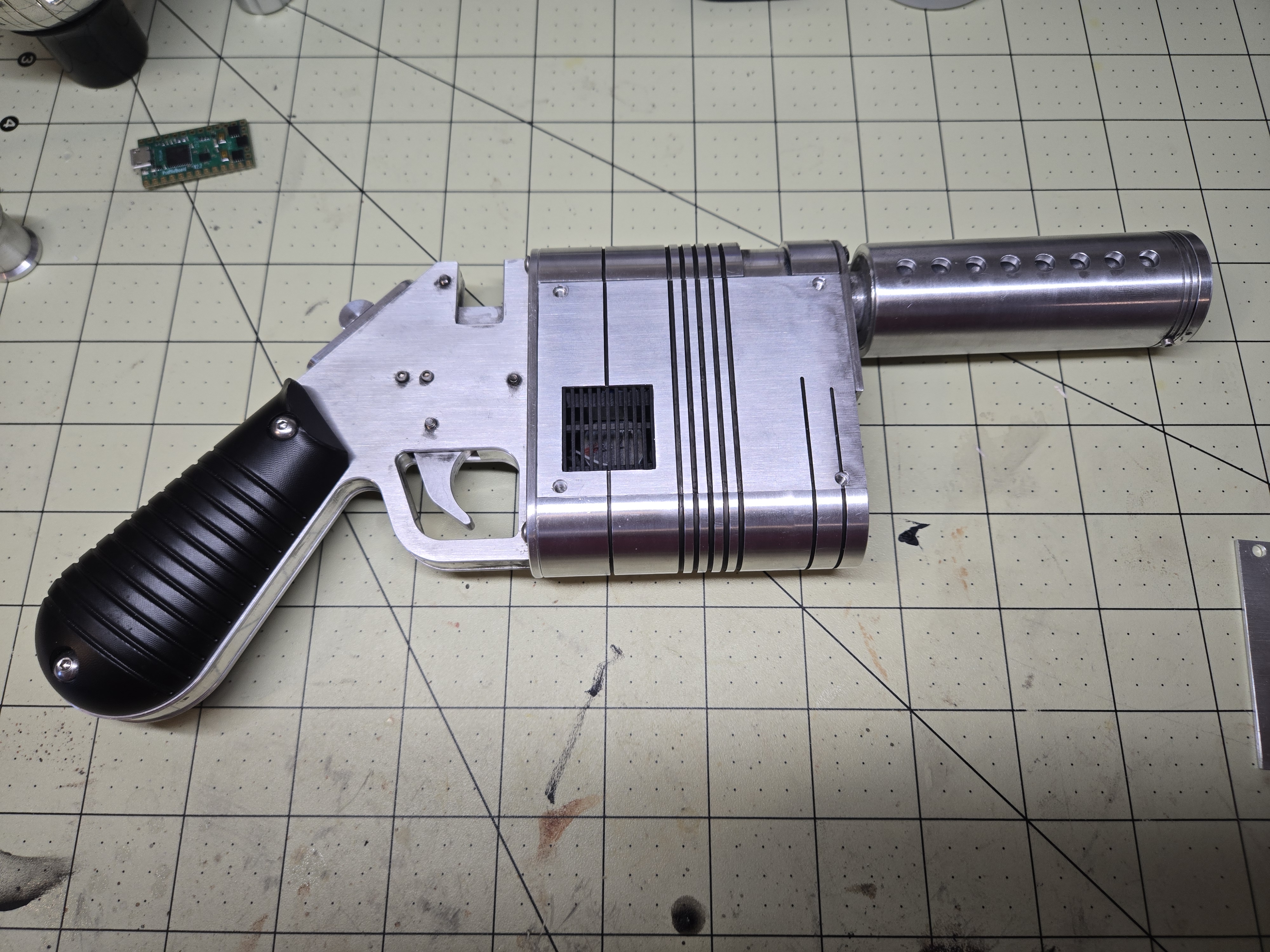

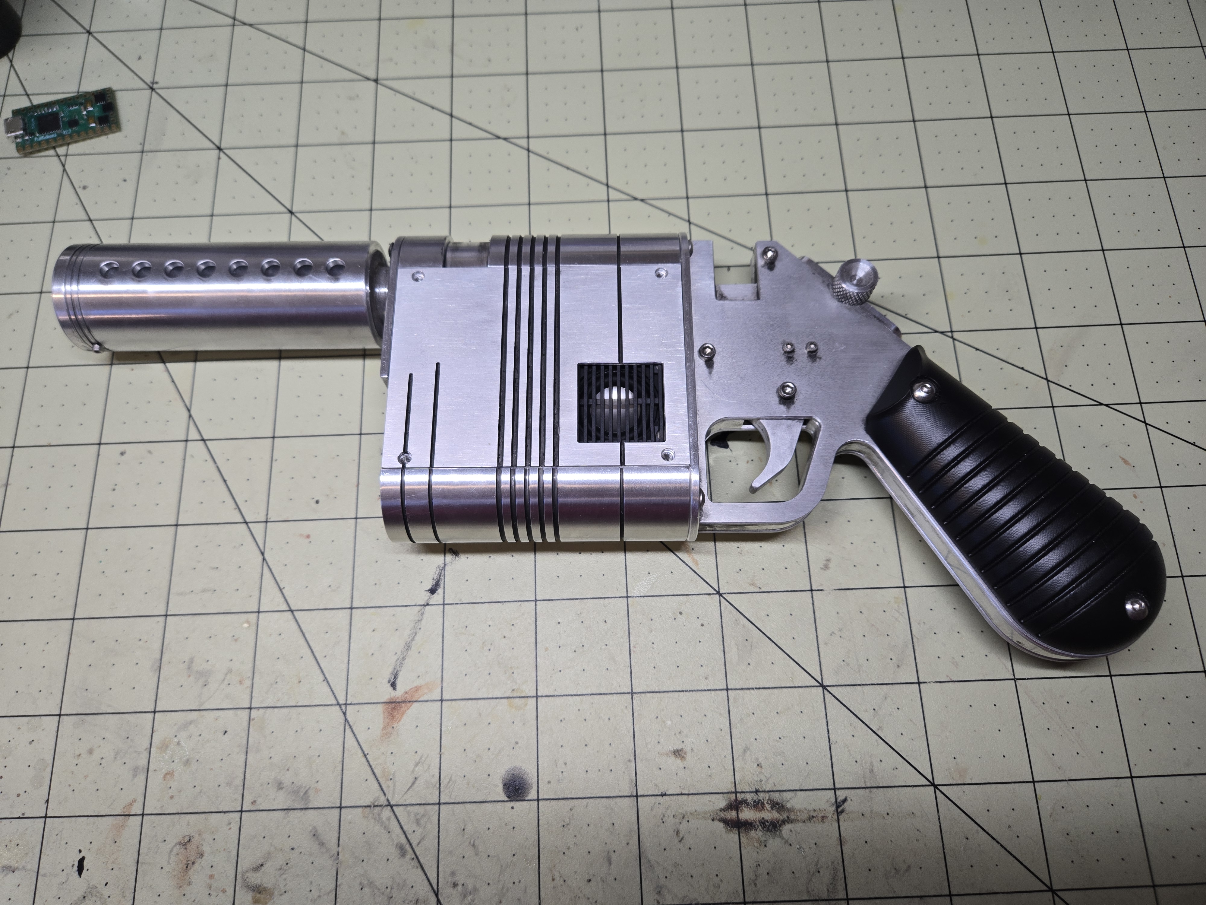

I have had this kit for about 2 years. It is made of aluminum, and is nicely machined, and goes together really easily. A fun kit.
It came with a cfx blaster core and all the other electronics needed, but I got overwhelmed with the blaster core and what was needed for wiring, accents, etc., so I put it away. Until I got inspired to restart it with a proffie instead.

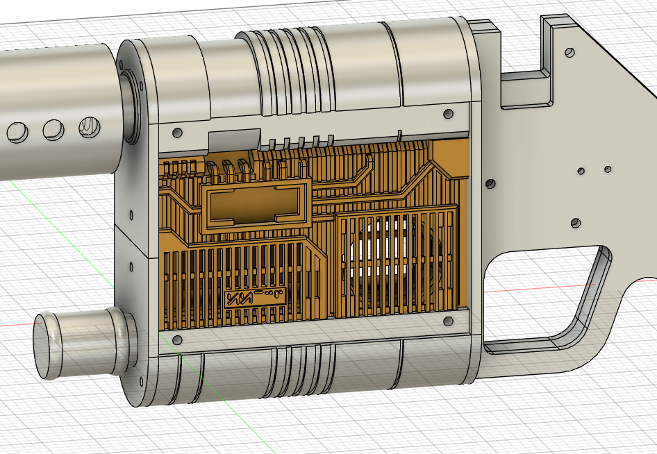

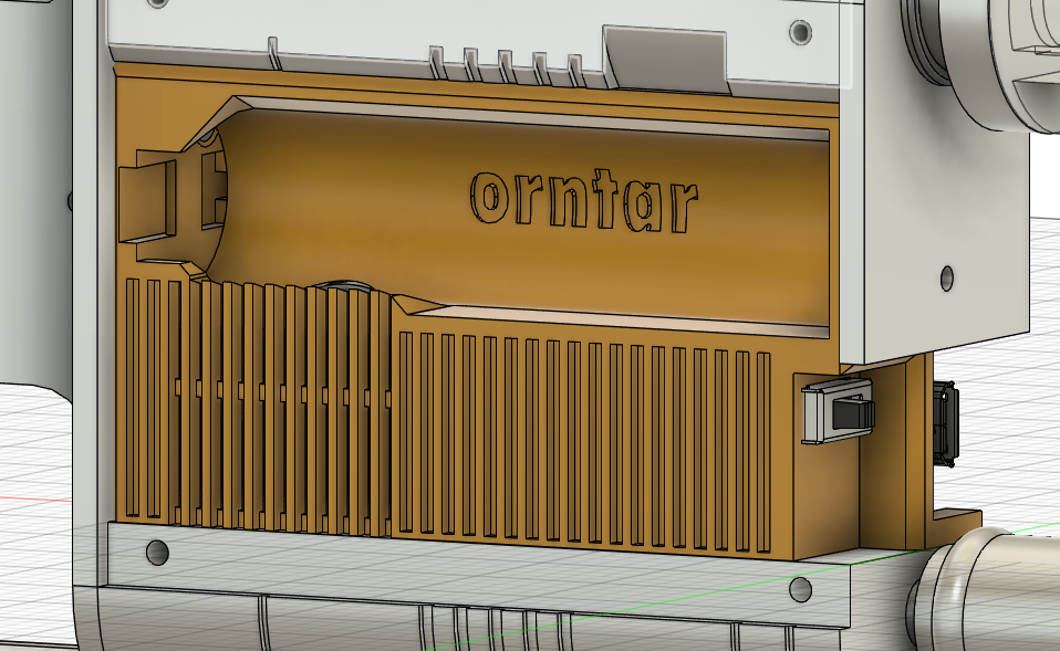

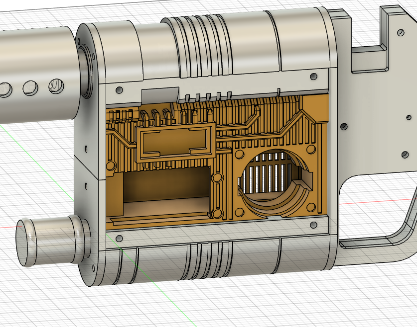

Because I wanted to go a new direction, It meant that I needed to make a new chassis for it.

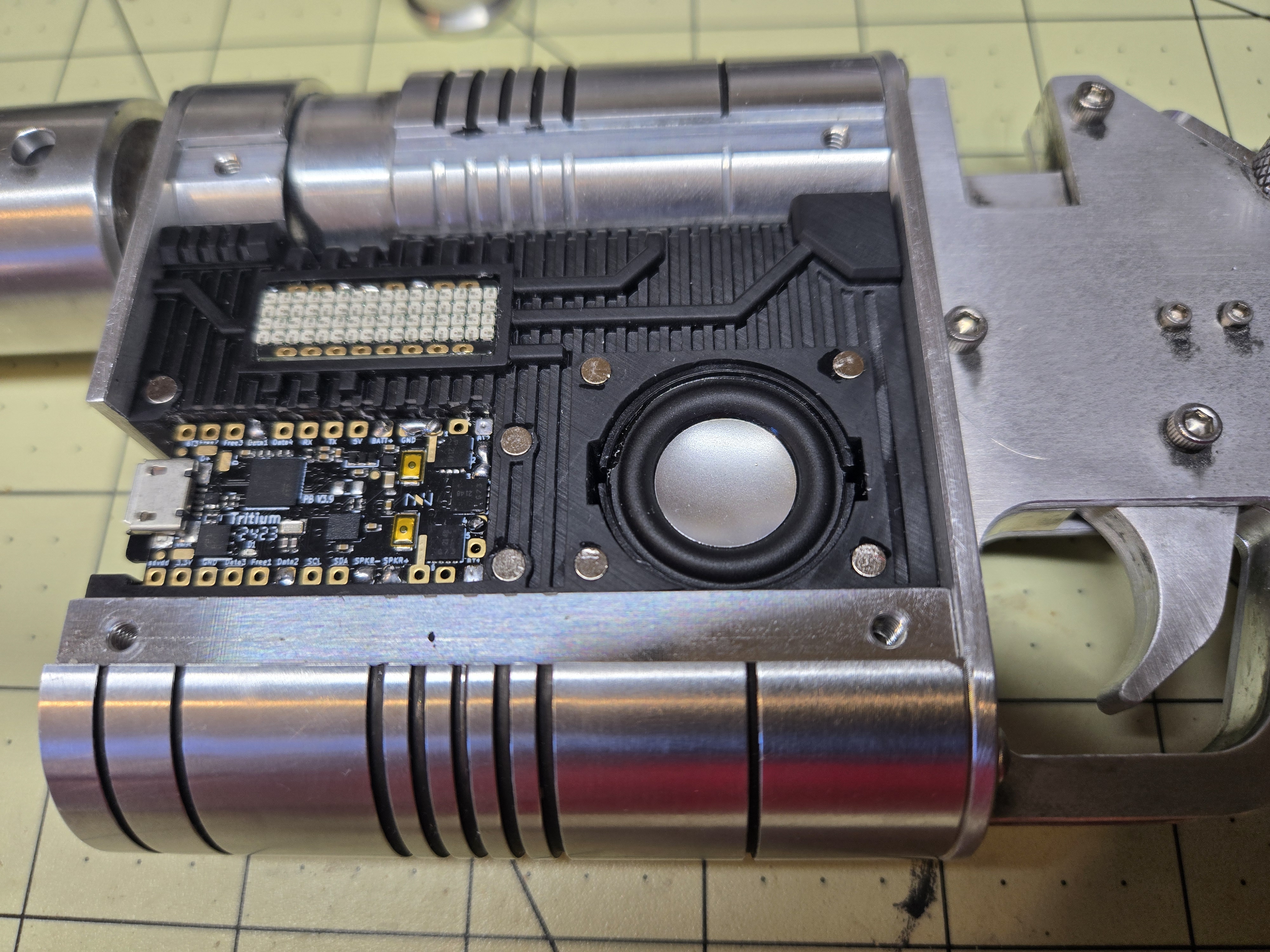

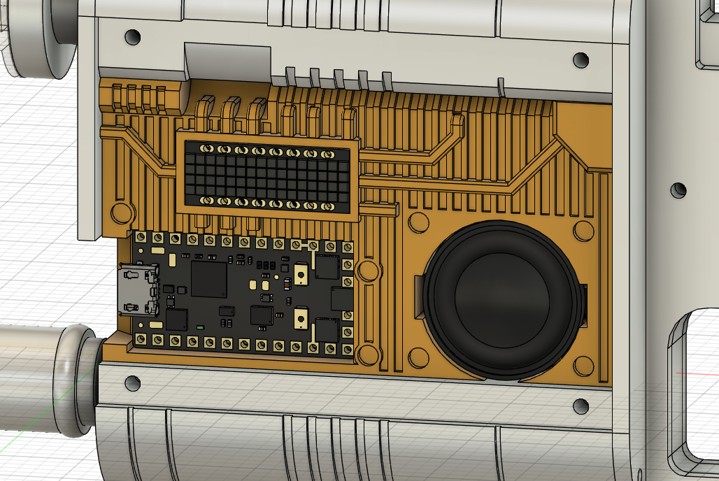

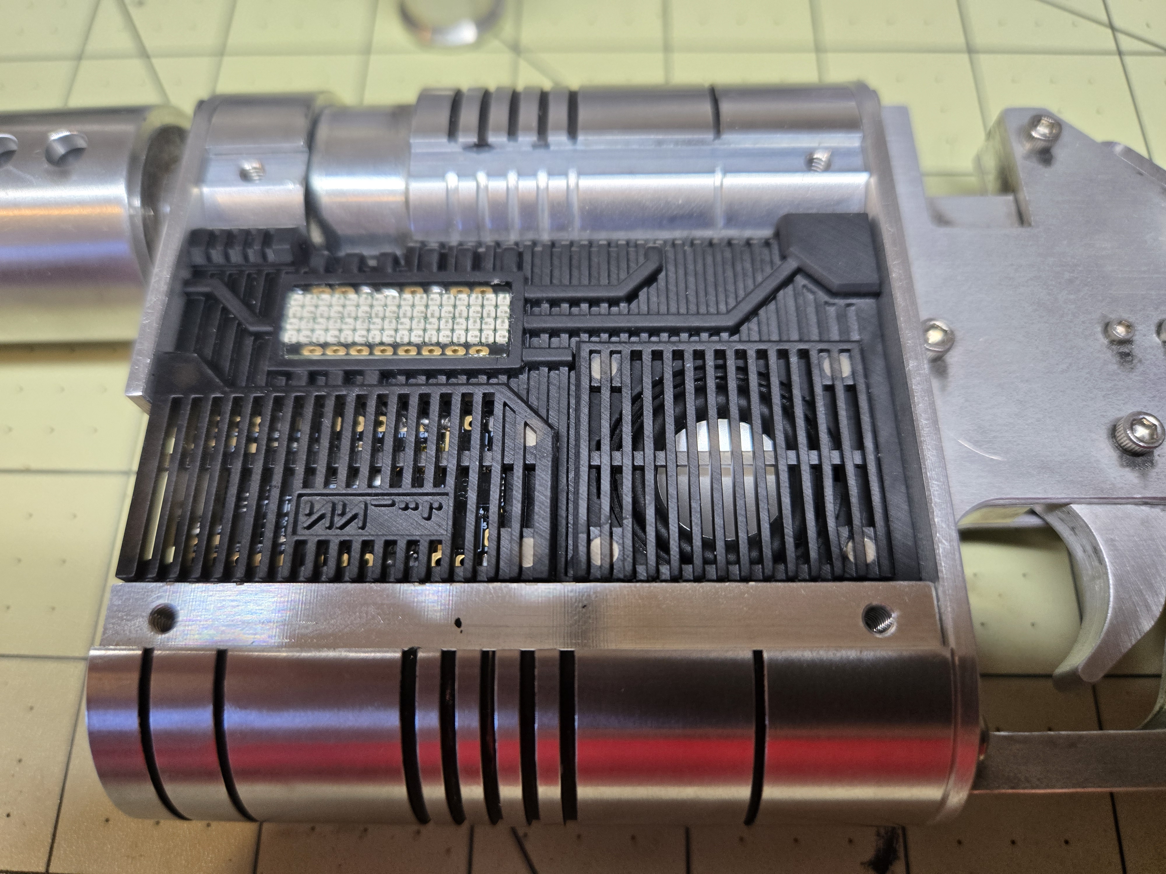

I made plates to cover the proffie and speaker. the speaker opening aligns with the blaster side plates, so it needed finishing.

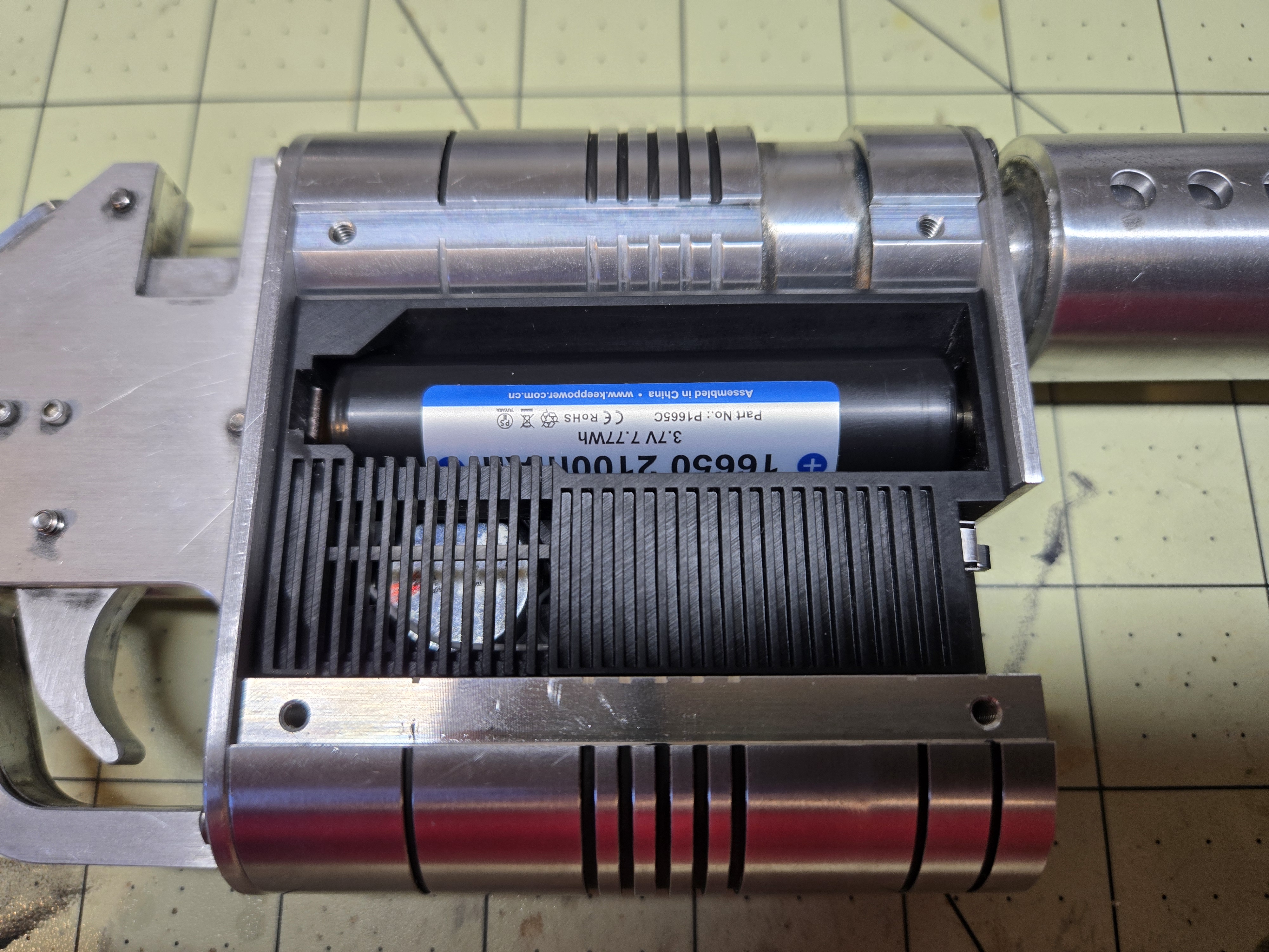

That is the kinda thing I like doing, so I spent some time planning it out. This will have a 16650 removable battery, kill switch, 22mm bass speaker, and a proffie v3.9. I also decided to put a pixel matrix in it for accent.

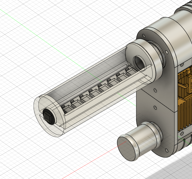

I Also made a clear sleeve to hold the barrel/muzzle pixels and would act as a diffuser. I printed it in clear PLA, but forgot to get a photo of it.
It all looked good in the computer, so i printed it out. It all worked perfectly on the first try. I still need to work on my wire pathing, however.
