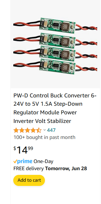

If you go with a 9v battery as suggested, you should get 9v compatible LED's. (with already attached resisters sounds good)
You will need a 9v to 5v dc to dc "step down" voltage converter to power your 5v "audio FX" card. (see attached pic)
Hook the positive and negative from battery/switch to input on "step down adapter".
Find "adafruit audio FX" manual and hook the two wires from the out of the "step down adapter" to the correct pins on audio FX card.

So a single 9V battery (with step down for the board and resistors for the LEDs) would be sufficient miliamp hours, even for superbright LEDs?
