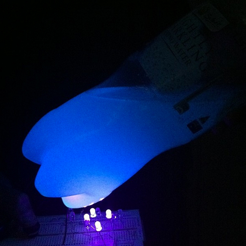

I've been playing around with Quantum this evening and arrived here looking for a better way to set my lights.
Here's some tips for the water. I mixed tonic water with some glow in the dark paint (white) and some face paint that's designed to show up under black light (blue) - UV LEDs are used to make it all glow. The quinine in the tonic water glows blue under UV light, and doesn't look too bad on its own, but it's too transparent to look like the game model. The glow in the dark paint shines when the lights go out too, which is a bonus because I want to use my quantum as a night light for my bedside table.
Here's a pic I took with my phone (sorry, it's a bit blurry). This is one of the tests with the lights off (two of 6 lights are on)

Blue highlighter does not florece. I actually make Nuka replicas and I have tested this. You're better off with either actual blue Glow/Forencense paint and Tonic Water then with Blue Highlighters. The blue is more a colored ink than anything.
TheDickMick - I agree, blue highlighters are horrible! Yellow and green work fine, but blue seems to be normal blue and not bright at all.
leviathanworksh - I tested out different household goods and art supplies (fabric whitener, fluro ink, vaseline) and I kept coming back to the tonic and blue UV paint. The other ingredients worked fine, but made the liquid too opaque for a good finish. Unfortunately the only glowing ink I can find in Australia is tattoo ink. I'm not sure about the clear UV ink you've linked to, I would probably end up mixing it with the blue UV paint anyway. It's nice to have the liquid remain blue when the light is off.
My big scientific question is - does the brightness of tonic water get stronger with a higher level of quinine?

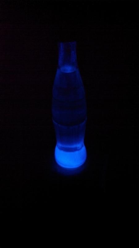

Here's a few more photos from my experiments.
This one is blue UV paint, a small dash of glow in the dark paint and tonic. It glows a bit after the lights go out, which is pretty cool.
This is a comparison of plain tonic (left) and tap water (right) under UV light.
In terms of the qinine, it's a combination of amount of that and the candle power of your UV light. It depends heavily on how translucent the liquid is, too. Absolutly clear isn't bad, but having it a little cloudy helpa reflect the UV light around a bit more. Too much though and you'll blot out the light.
Do you happen to have borax where you are? It's a laundry additive. Works decent as a reflecting agent.
I found a laundry additive with the same ingredients as Borax. I'm pretty sure we have Borax too, I just couldn't find any at my local supermarket. I've mixed up a few different kinds of "Quantum" and left them to settle for a week. So far the glow in the dark paint/UV blue paint/tonic water is winning (if I filter out the floaties).
