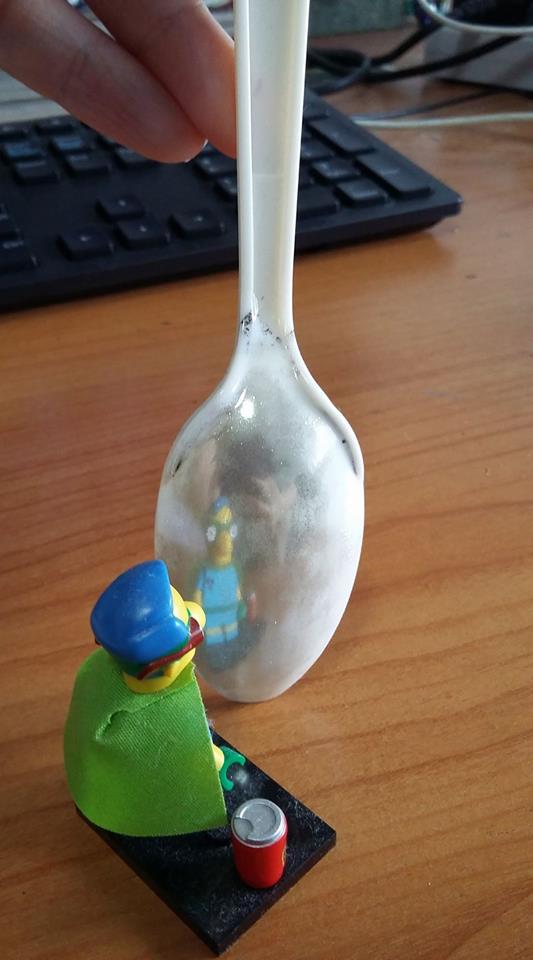

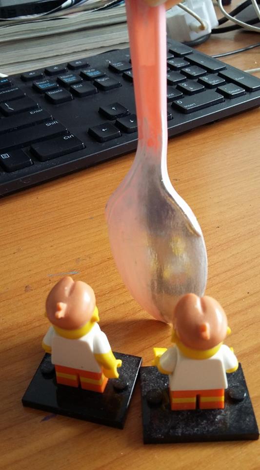

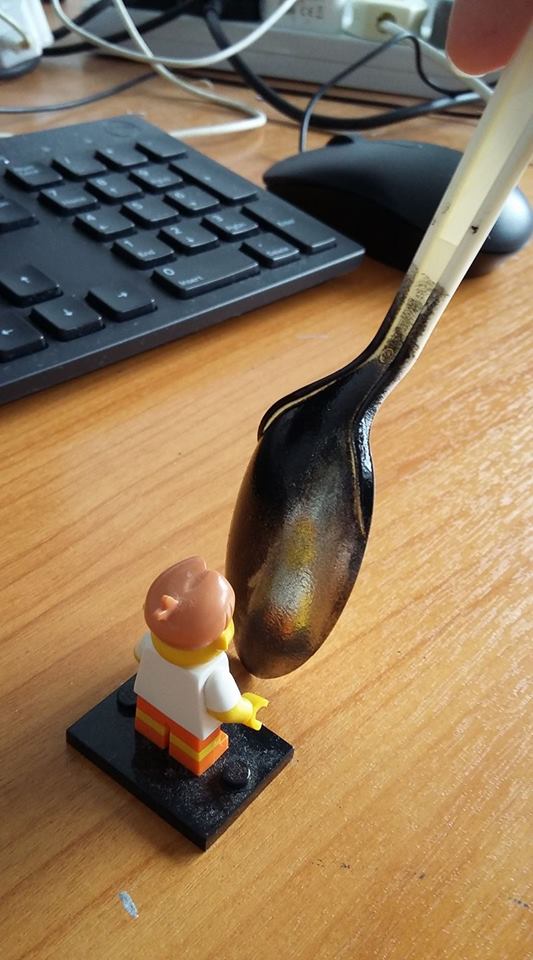

based on "chrome mirror nail powder" that went viral a few months ago.
the key is to use a paint/ lacquer that remains a bit tacky/ sticky after it has dried so that the chrome powder can stick on.
i used a combination of semco black gloss acrylic with and without a layer of Sakura Hobby Craft "3D crystal lacquer". white paint background is Apple Barrel Gloss White.
these are what i have experimented so far.
I have limited amount of paints so i can't do anymore experiments. hope someone sees this and refine and improve on this method.
