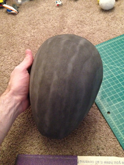

Used 1/4" foam mat from Harbor Freight and my trusty Elmer's glue bottle, filled with contact cement. I went ahead and heat gunned the inside of the helmet, just so it would retain its shape when I start cutting into it. Then I sanded the seams to help get rid of that foam look.

Amazing smoothness for a round helmet! Looks nice, I'll definitely be watching this.
Thanks! I've been obsessing lately over the idea of making foam not look like foam. I think making seams disappear is one of the first steps to doing that.
Sometimes the stiffness of the foam keeps it from bending and you get pointed edges where two pieces meet, even if you cut as straight as possible. The heat gun helps the foam relax and bend more naturally, then of course, cool and stiffen again. I'm going to try it out more in future builds to see if I keep having success with it.
I used watered down paintable caulk in layers to smooth the foam, focusing in on the seam lines. Once I have it layered up enough to fill in any cracks and low parts, I sand it the caulk level and stop right as I start seeing foam through the caulk. I'm not trying to keep thick layers of caulk on there, just fill imperfections.
I tried something a little different this time. I went ahead and got my white glue to mix with water, but instead of 1 to 1 mix of white glue and water, I took a 1 to 1 ratio of white glue to clear glue. I don't know if it's as big of a deal in other parts of the world, but usually you find Elmer's clear glue right next to the white glue. This stuff acts basically the same way, but it starts out clear and actually dries flexible. It accomplishes the same thing as white glue, but none of the cracking when dry! Once I mixed equal parts and had a hybrid glue, I then mixed that 1 to 1 with water for coating the foam. I put on about 4 layers of this glue mixture and no cracking... at all. Totally flexy seal.This method ended up being so successful (and cheap :D) that I think this will always be my new way of sealing. Pretty happy about it.

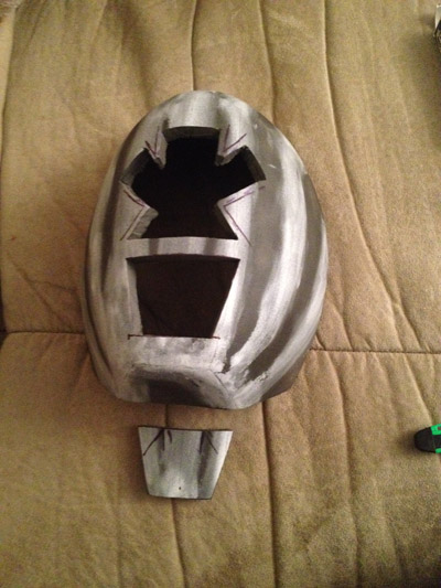

I decided the helmet went a little too far back so I trimmed it to be more of a "face" mask. I marked off where the visor would cover so I could maximize the size of the hole for seeing out.
It's not a lot, but hopefully with a smaller head and eyes closer together, it'll be plenty.
The actual ranger helmet has a little recess where the mouth is. I'm thinking rather than just re-gluing the mouth piece in, I can maybe cover the hole with fabric. It'll let more air in for the kid to breathe, and because I'm sure it's hard enough to understand what a 3 year old is saying, it'll make hearing him easier. in theory.
