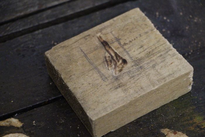

The first job was figuring out a way to shape the metal pieces quickly and easily. So, I took a block of wood and dremeled the design into it:

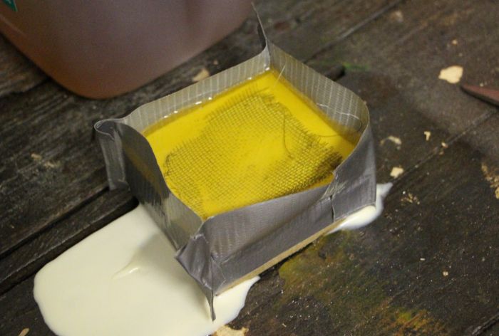

Instead of trying to hammer the design into each one, I decided to make a resin negative of my wood carving to make a press. I used duct tape to make a box around the edge. Before pouring the resin, I made sure to add a liberal coating of petroleum jelly to make sure the resin didn't stick to the wood.
Although duct tape is great stuff... it didn't work so well as a wall for the resin:
But... this resin cures so quickly, it didn't get far, and this allowed me to add a wire mesh to strengthen it before adding another layer of resin.
Once I removed the duct tape, I had a nice solid piece of resin for the top of my stamp:

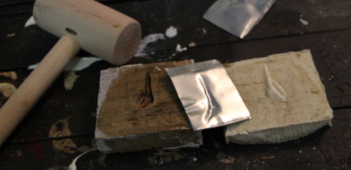

Next up... the actual pieces! So, first thing to do was cut the lunch box up into 16 pieces of metal:
Each piece was laid in between the wood and resin pieces and then given a few hard whacks with a wooden mallet:
Lots of stamping...
