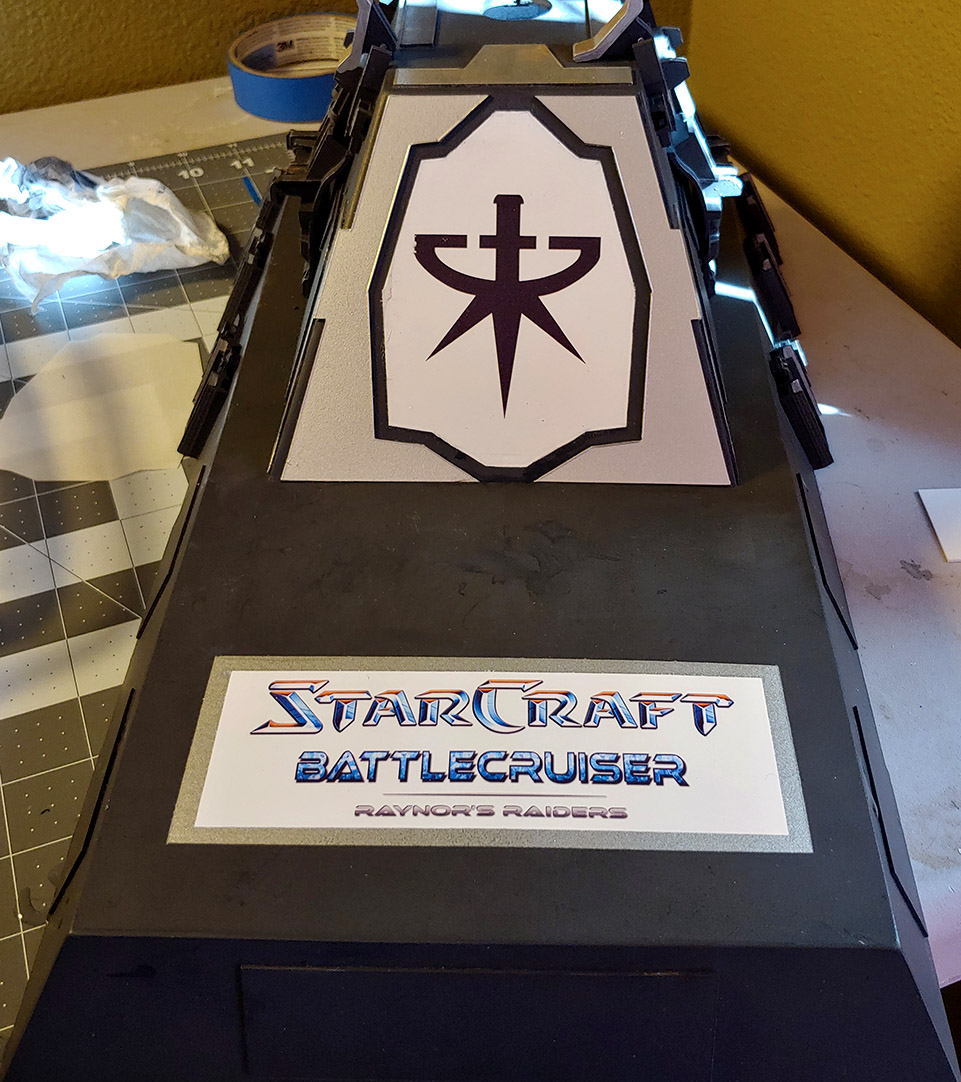

Heres one I made from last year. The main emblem, which the left side was still having some issues, the words. That was all printed on clear with the model part painted white. They are quite large, which tends to have more issues then a smaller decal.
...And, how they all look printed. (Didn't even remember taking this picture)
The left was printed on white and I had to cut it all out, BUT....I ended up messing it up and had to change it. The piece with the words is quite large and it just took a few tries to get right, and the printer was starting to run low on black, so that was changed....but the big emblem, I had cut it out, but just could not get it to spread out and lined up right, so they was changed to solid black and reprinted on clear so I could cut it out the shape it fit into instead of the actual emblem.
