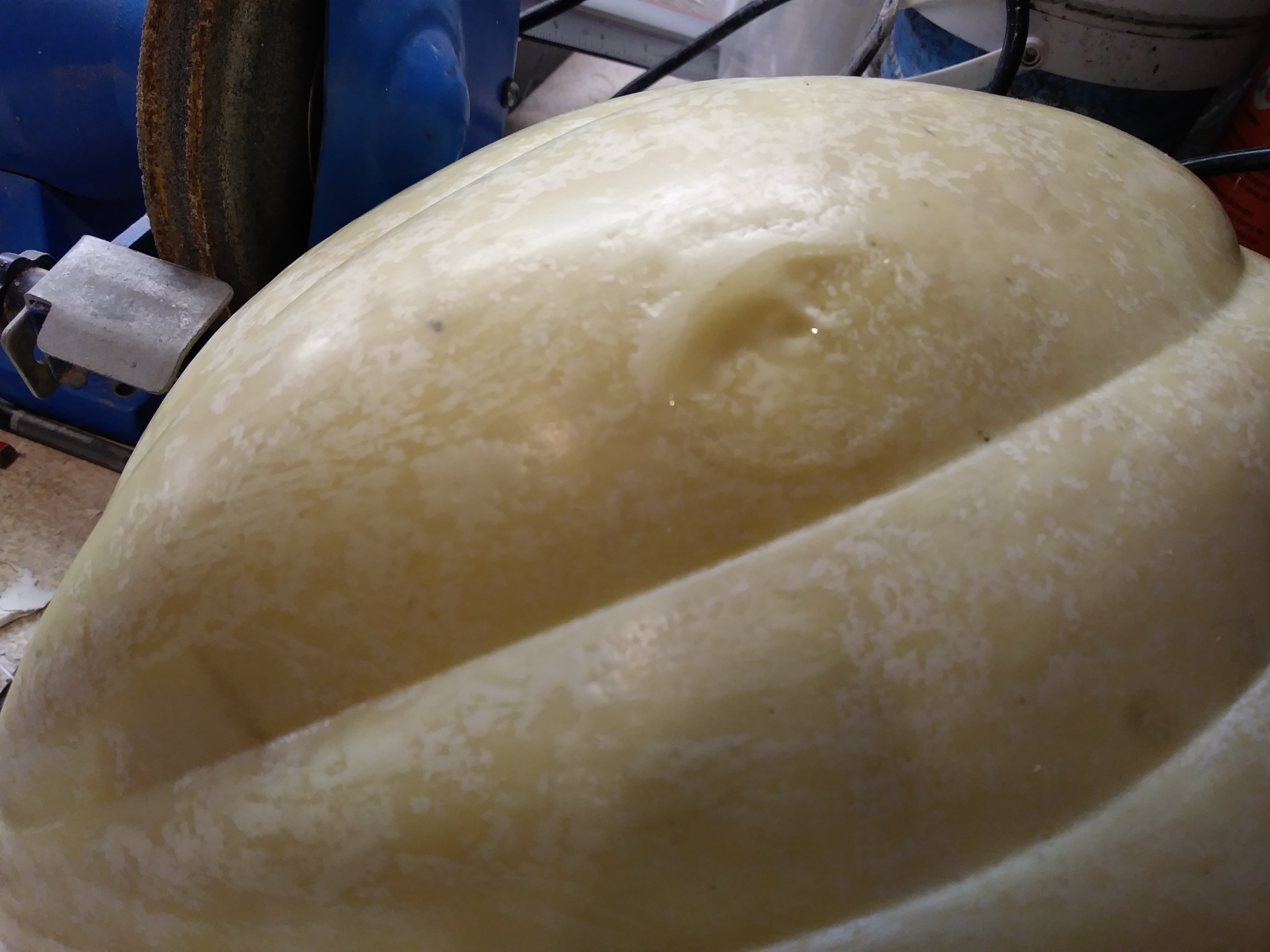

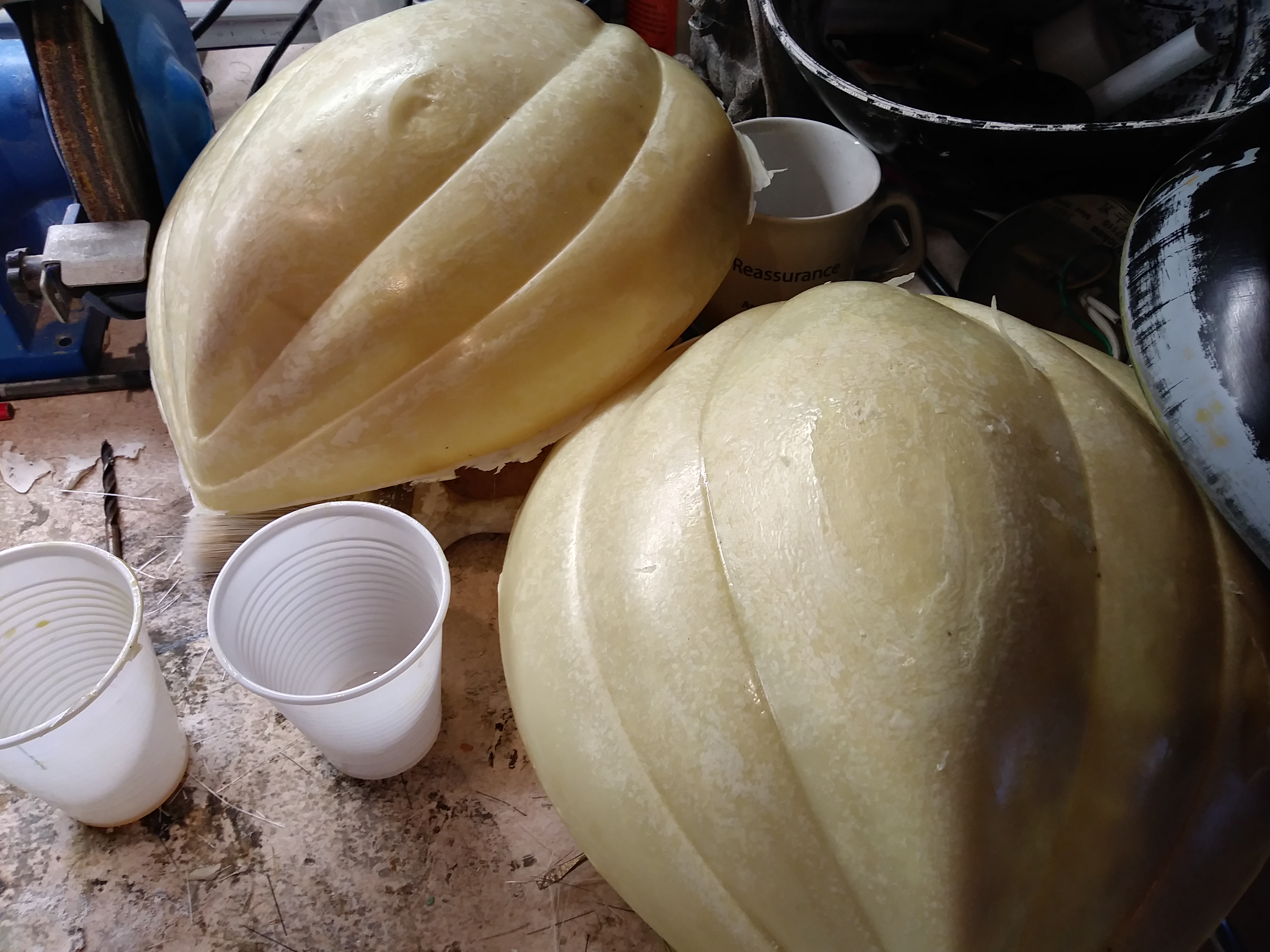

Hi everyone. I'm trying my hand at slush casting using isocyanate A and B. Both of the tests I have done seem to have air bubbles or delaminate. I have some photoes

There are a number of reasons you can suffer the problems you note:
Could be the urethane. As noted above, some urethane are not suitable for slush casting. I don't know if anyone still makes it, but there was a "model making" urethane that it's components were water thin and it could be be poured into tiny, detailed molds with minimal air bubbles. But the material was crap for anything else, as it was brittle and had a very high shrinkage. This material was the same color as the pieces in you'er pictures.
It is very important to fully, completely, mix, as in, longer than you think...mix the components before you proportion them out. Some urethane's are not homogenized and the chemical components can separate in the can in only a few hours. So making sure they are fully combined before measuring out you components is important. One of the effects of not properly mixing before measuring, is the more material you use, the more "lopsided" the material becomes, as you pour off the chemical that rises to the surface of the can of either your "A" or "B".
Making sure the two sides are thoroughly mixed together. If you have even small amounts of the "A" or "B" not blended when you pour, these will give you "oily" spots in the casting. Also, Do Not wipe the stir stick off on the edge of the cup. The stick can easily trap unmixed component on it's surface, and when you wipe the stick off, this unmixed material will cause the issues noted above.
Cleanliness! Do not use old cups that you have already mixed in. Reusing the storage cup of "A" side or "B" side is OK, but only for a few hours, after that replace it with a new cup. Do not use old stir sticks. Make sure your work area is clean, make sure you component cans / bottles are clean and the lids seal. Not just screwed on OK, but the lids are free of crap and seal. Oxygen and moisture from the atmosphere will ruin urethanes.
I notice you are using ribbed plastic cups, I'd wouldn't use this style of cup. The ridges can easily trap unmixed components and cause the oiling unmixed material problem. We use waxed paper cups. Some people will tell you waxed cups a re bad, but for nearly 40 years of casting materials, the wax is never been an issue. But, it does keep the cup from getting "soaked" and leaking material if left on the counter.
