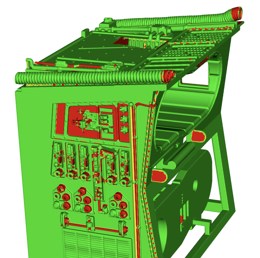

But worse, they have silently changed the print guidelines for the plastic, increasing the minimum wall thickness, etc. That means that many of us with Shapeways "fine plastic" products have suddenly got products that are rejected as unprintable. As you can imagine, reworking all the products is a massively time-consuming problem.
See those areas in red? Those all have to be redone on this design. A design which passed fine the other month. Multiply that by each design I have.
