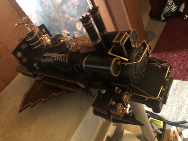

It's a great kit. Resin being resin it's a lot of work and I often rebuilt details in plasticard, rod, brass wire etc rather than clean, fill and straighten the resin parts, I just found that approach more satisfying and I don't have the knack of getting resin pipes and circular parts cast parts sufficiently round!
Your painting skills look well up to the task, it looks a really nice build.

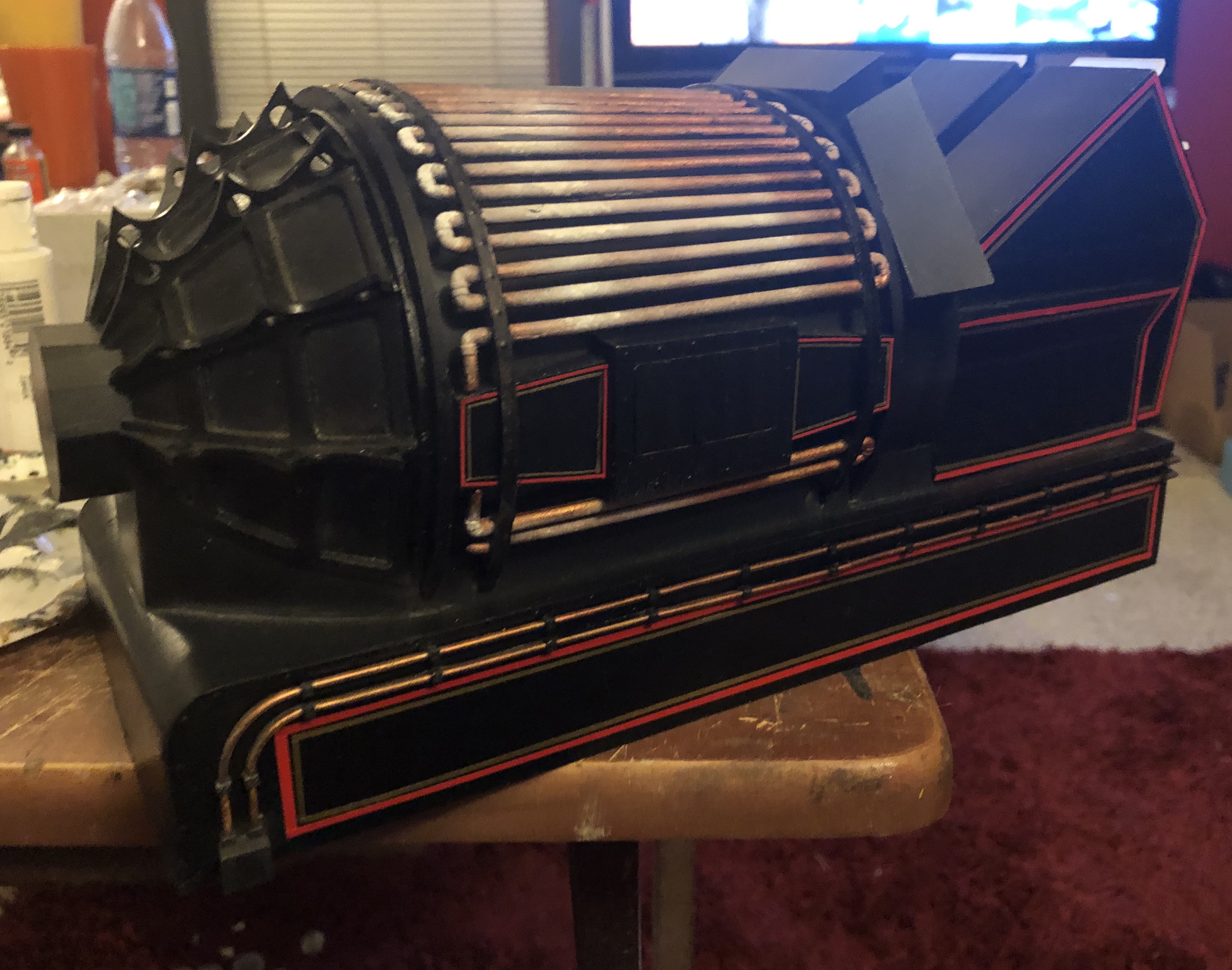

I admit that since the wheels face downwards, I didn't pin stripe the faces of the wheels.
Your stripes look really sharp and straight, do you have any tips/advice?
I used a combination of masking and straight edges and mostly fine line markers.

I used Cricut vinyl from the scrapbooking aisle of my local craft store. Cuts really nicely and stays down even after a clear coat.
I'll probably use a paint pen on the wheels.
