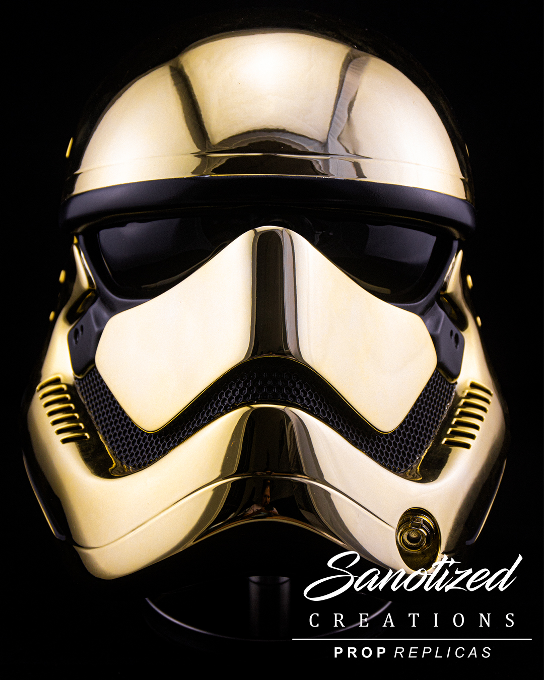

I used a Phoenix Props TFA style helmet as a base, got it painted in gloss black and got it gold chromed in the UK.
The problem I have is mixed ref. In the animated series, Pyre has black bands around the helmet, but theres no black brow present (also not at the normal TFA TKs) .
The realistic HASBRO figure has NO black brow and NO black bands. So thats kinda .. mixed. I actually like it with the black details as it gives more contrast. There's also a YouTube video of the making, including Liams message.

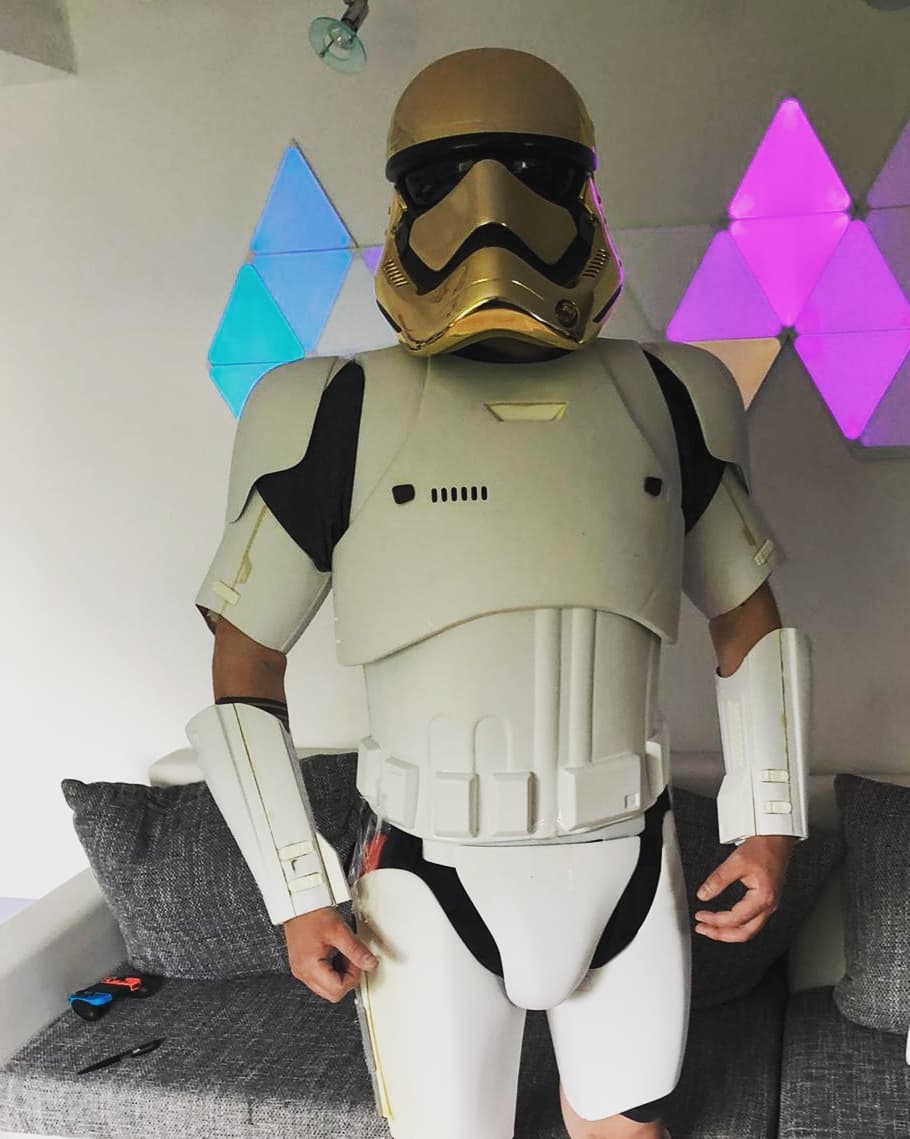

Further, I have an old BETA Anovos First Order TK armor set. Pyre is technically a generic TFA TK, although there are some minor changes, like 2 bars at both lower leg armor.

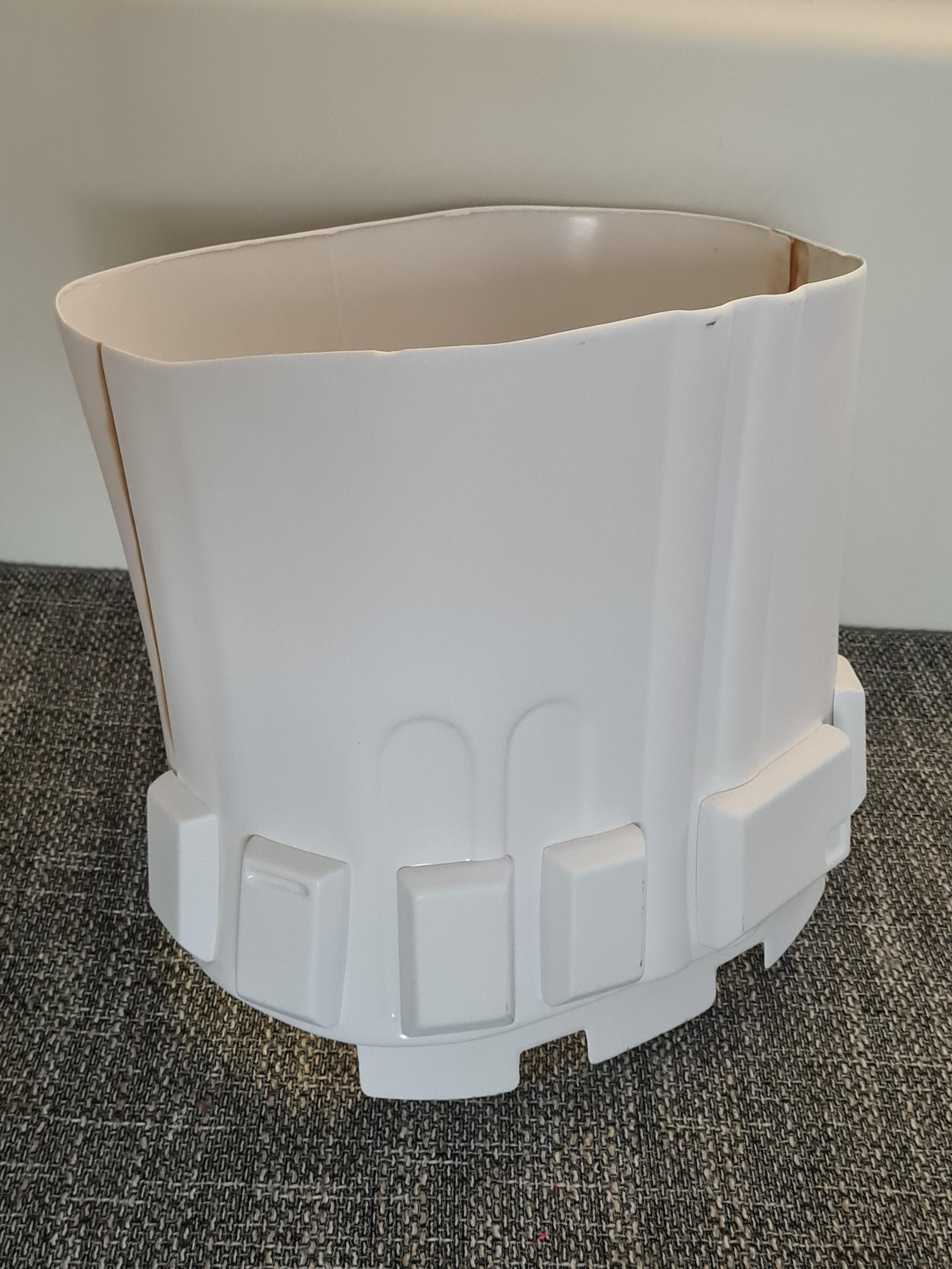

Arms:

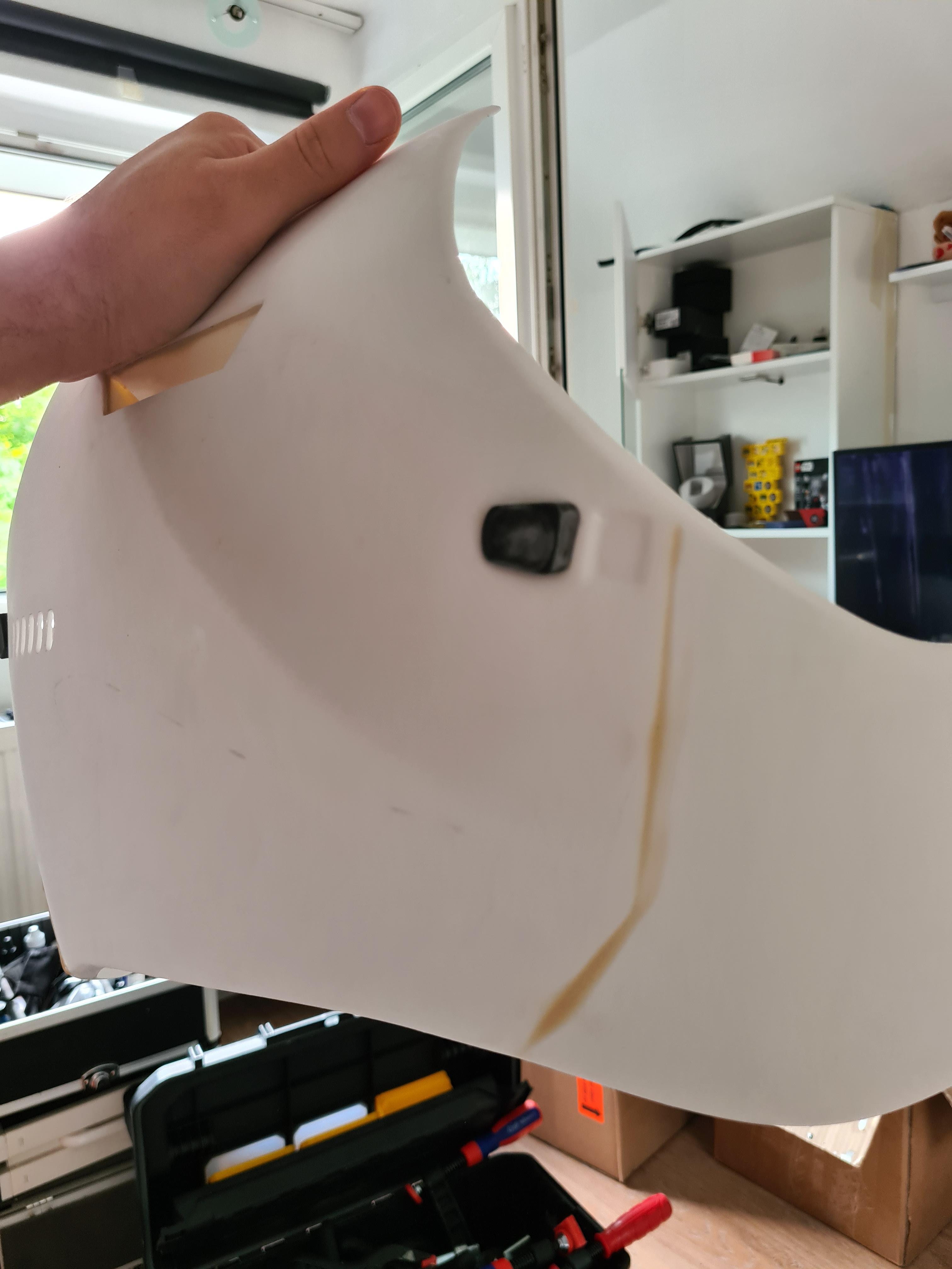

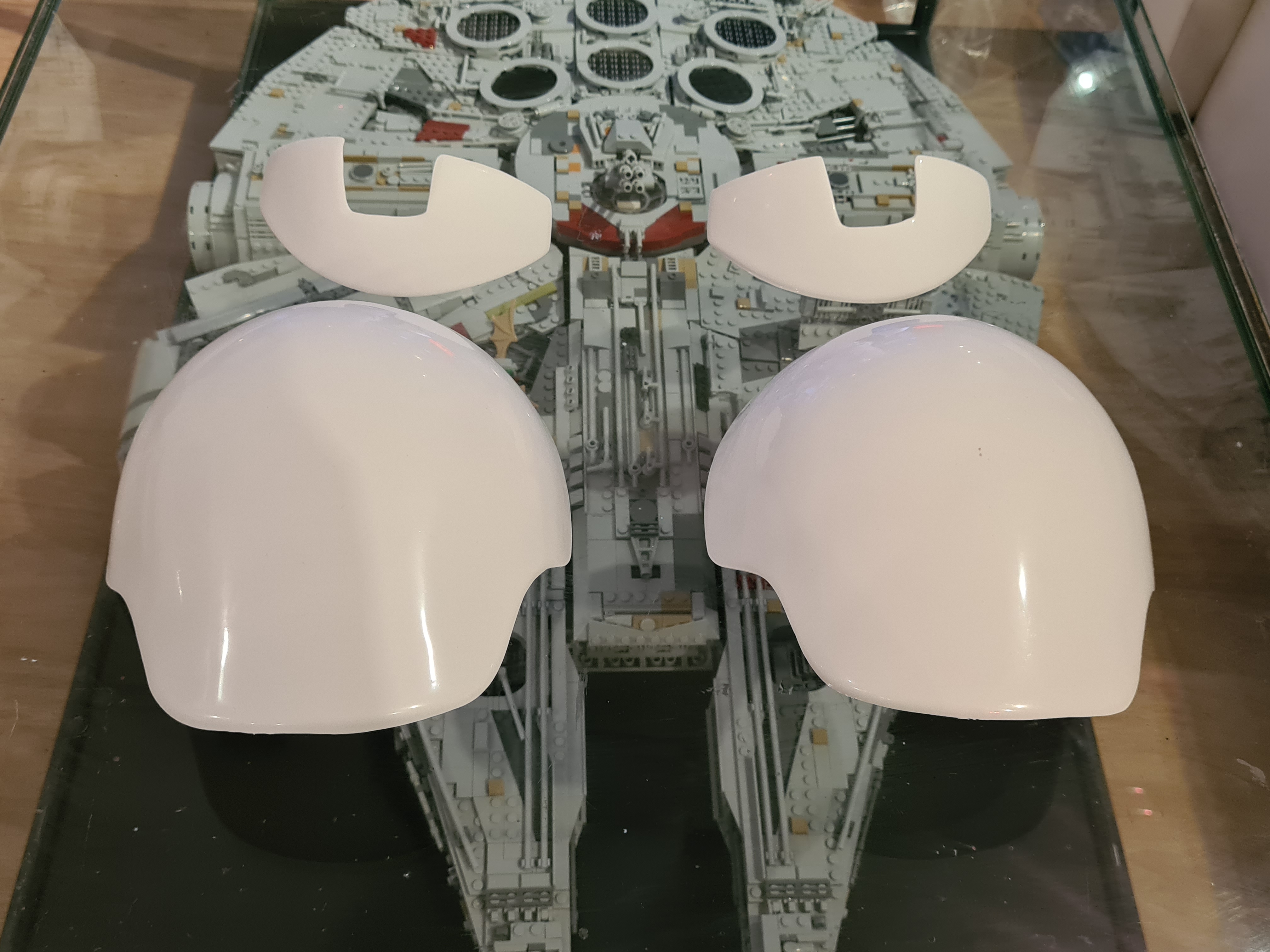

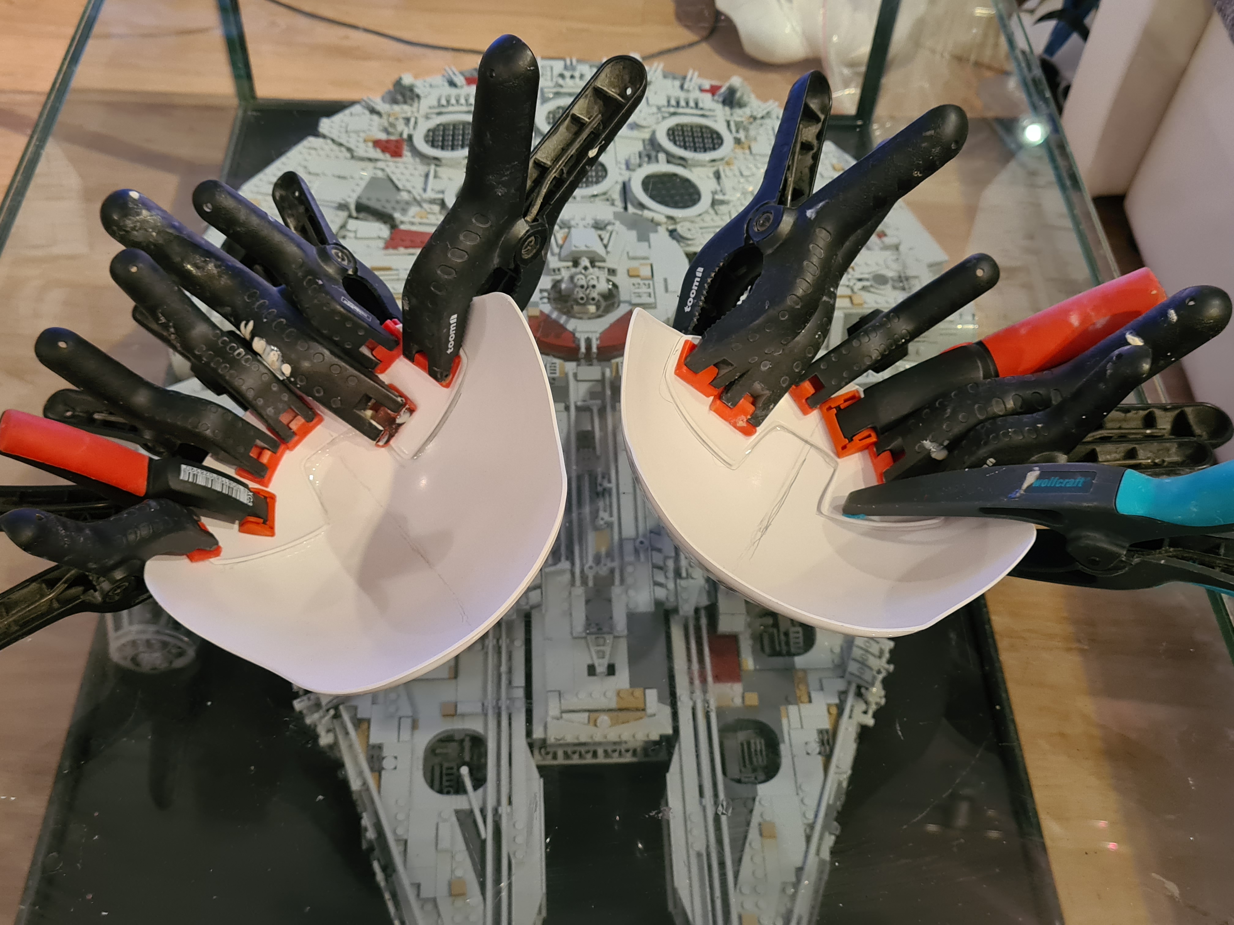

The shoulders were kinda simple. Just trimming the excess ABS and glueing the tabs on.

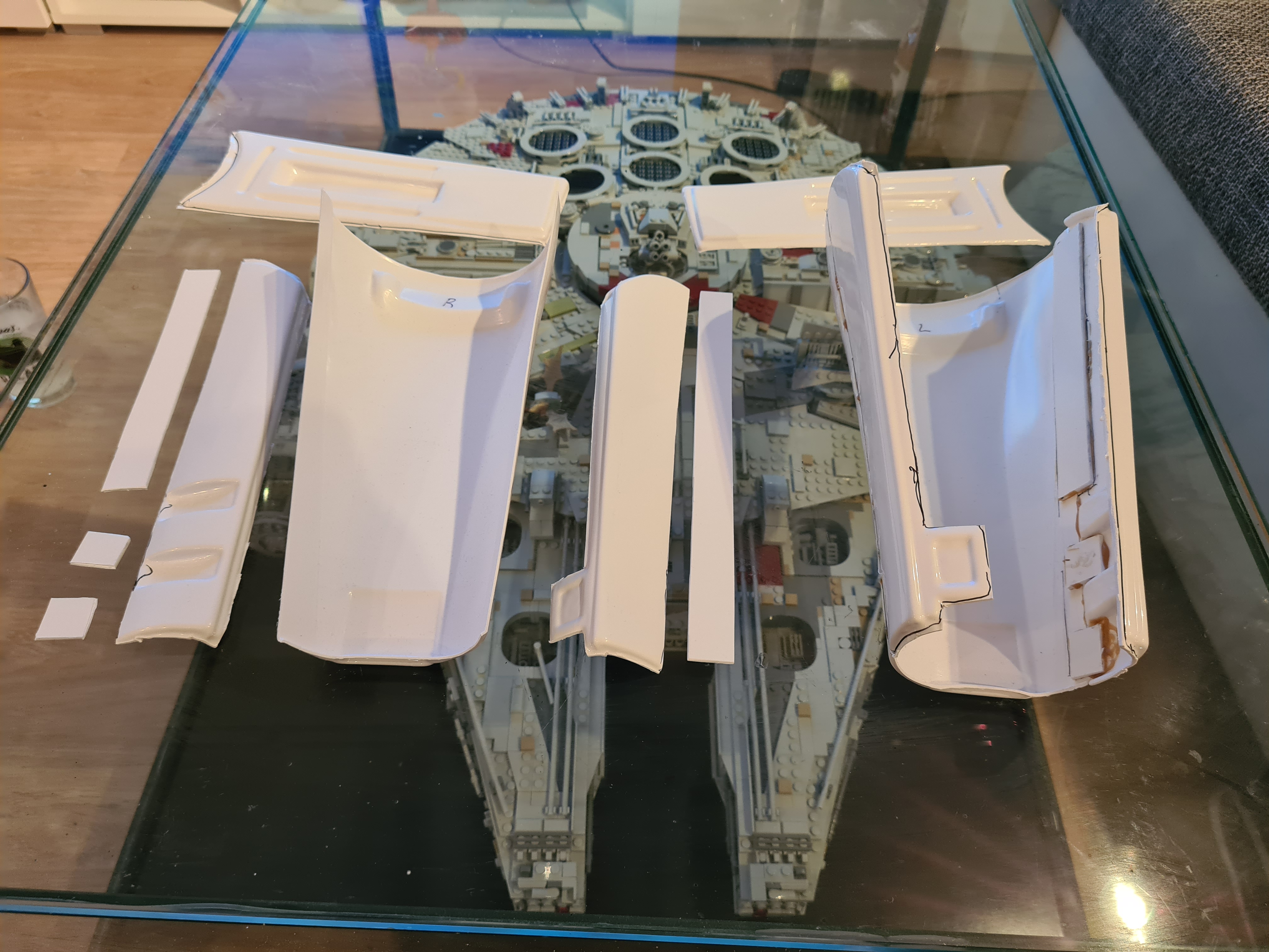

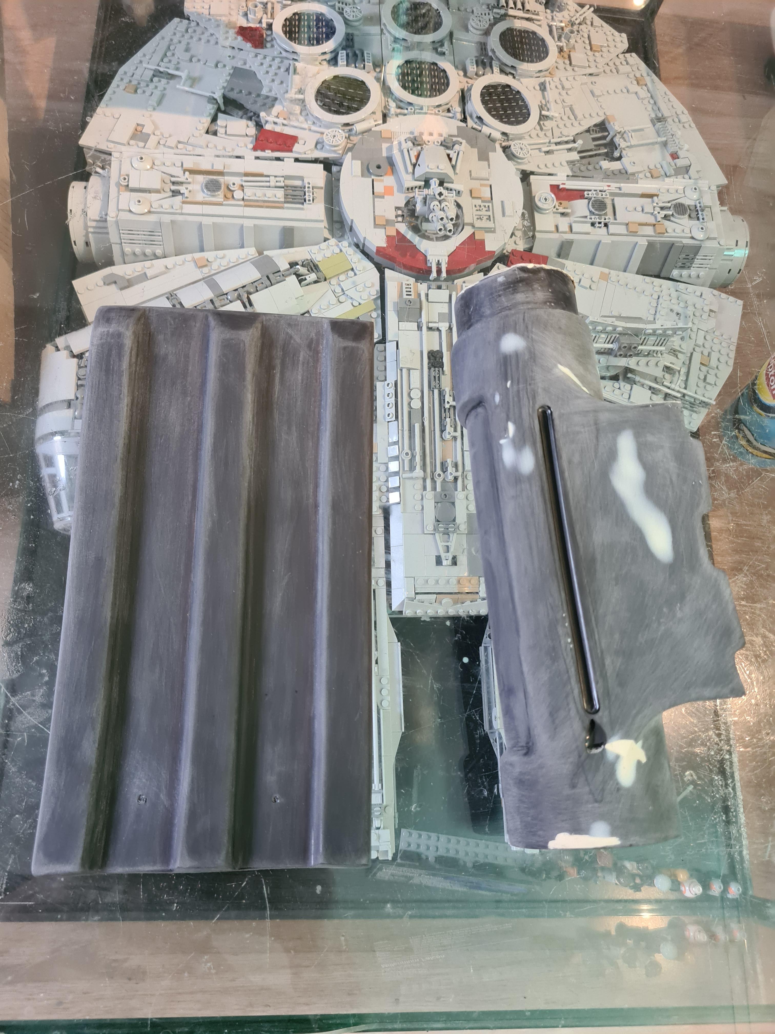

Bicep armor:
Here my perfectionism hit me with a bat. I didnt like the soft details that happen due to the bac forming process, so I filled it and carefully filed the new details in. I used 2 part epoxy glue to glue and fill.

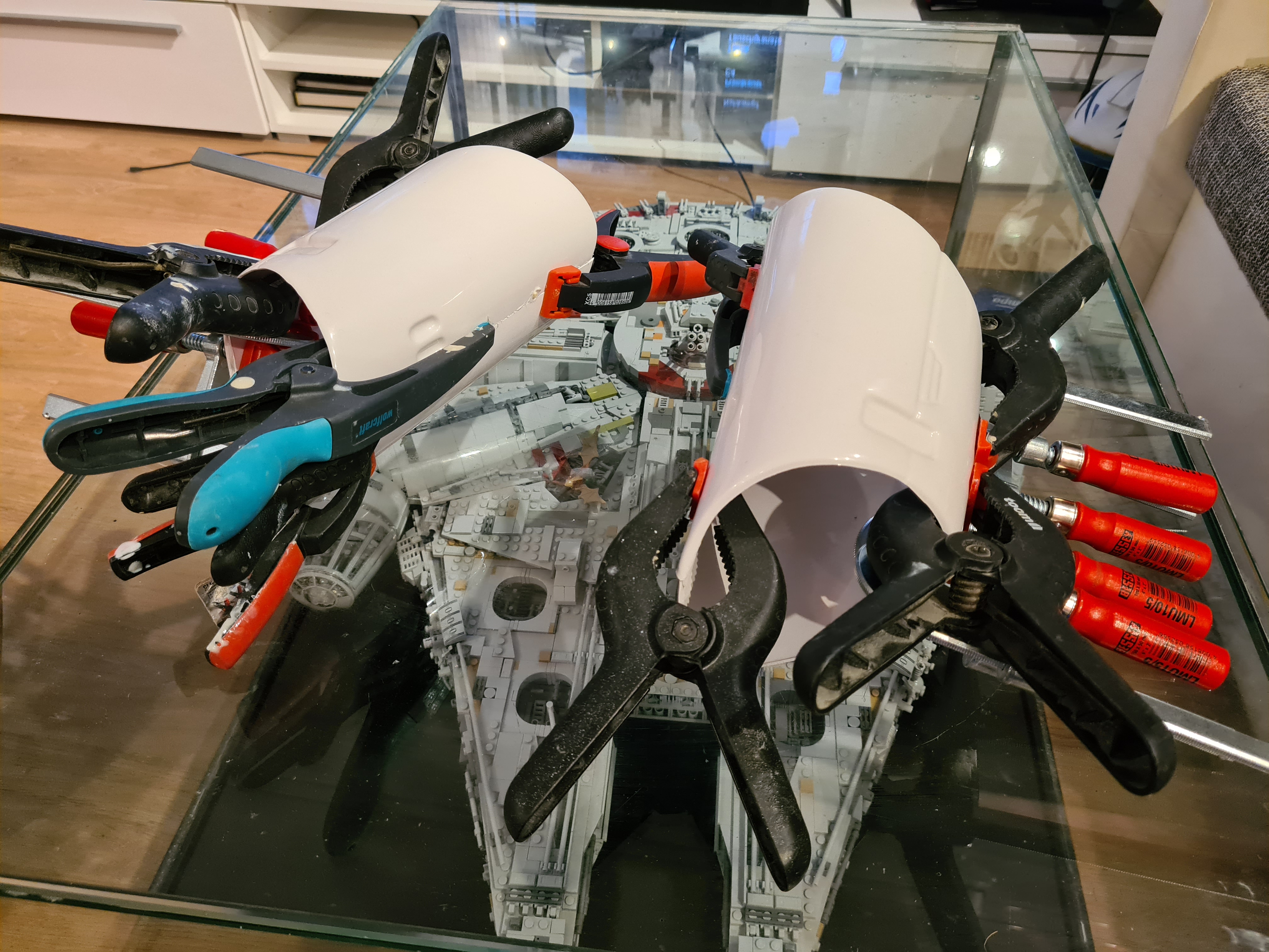

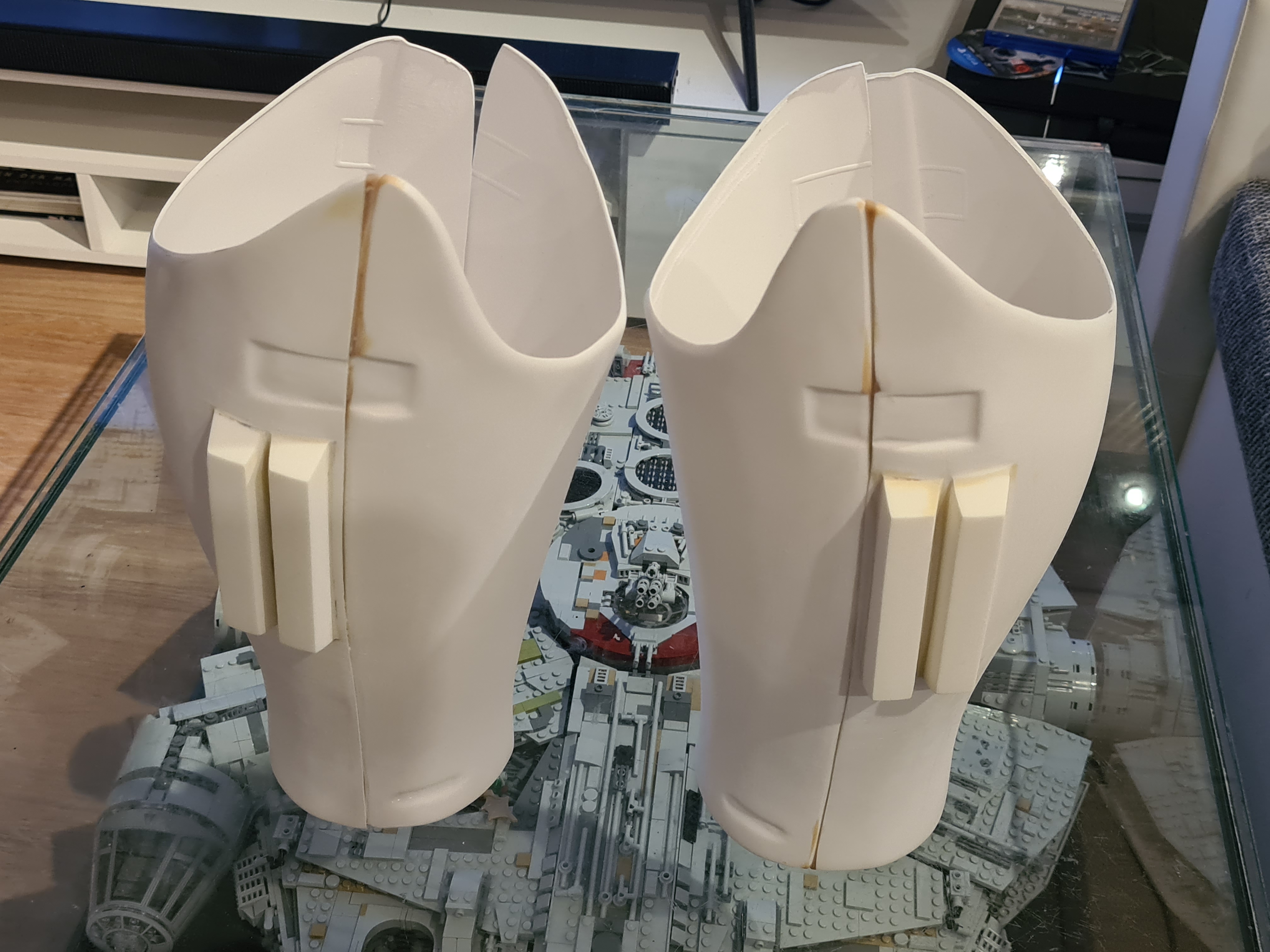

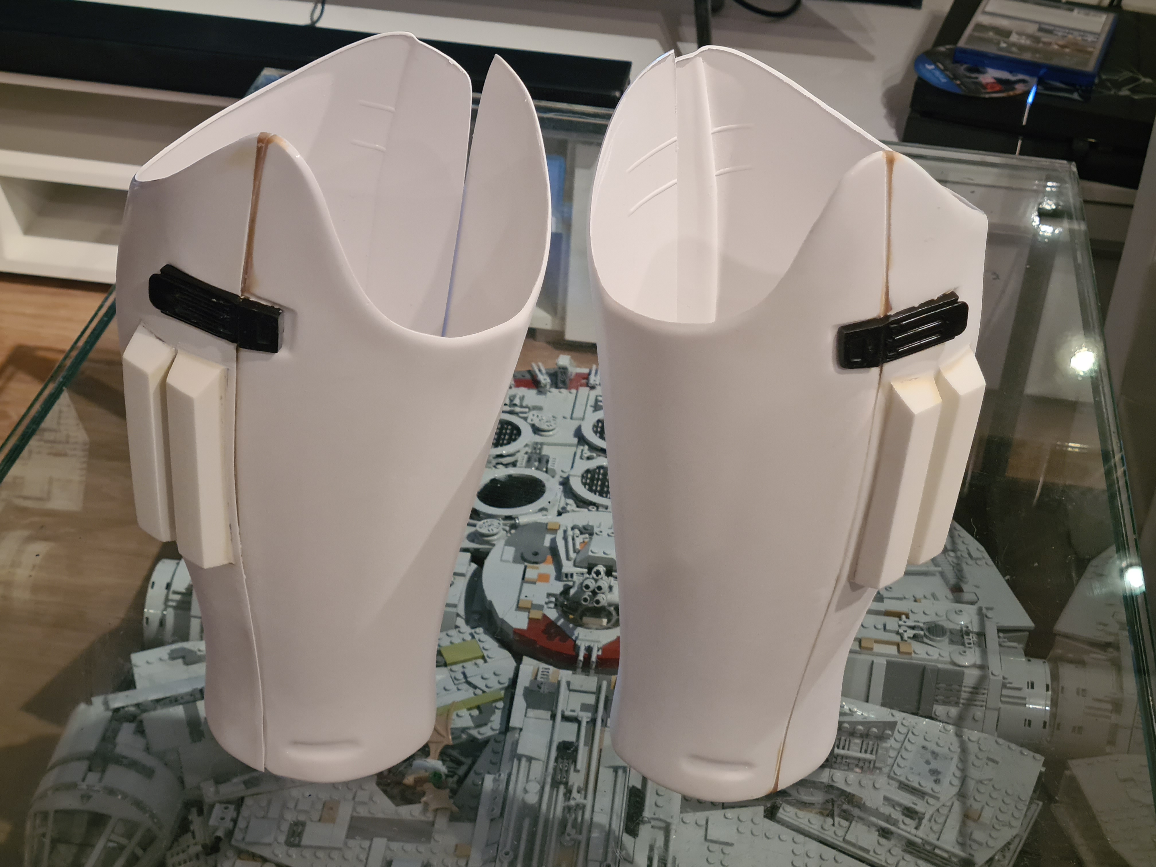

Forearms:
For the formarms I didnt use the ABS box, instead I used my resin box which has sharper edges. I made that box years ago for the First Order Gunner costume and for Phasma, I mirrored the master and made a mold of it. So why not make use of that for my personal costume as well
Handguards:
CFO Handplates from Dan, filled and sanded

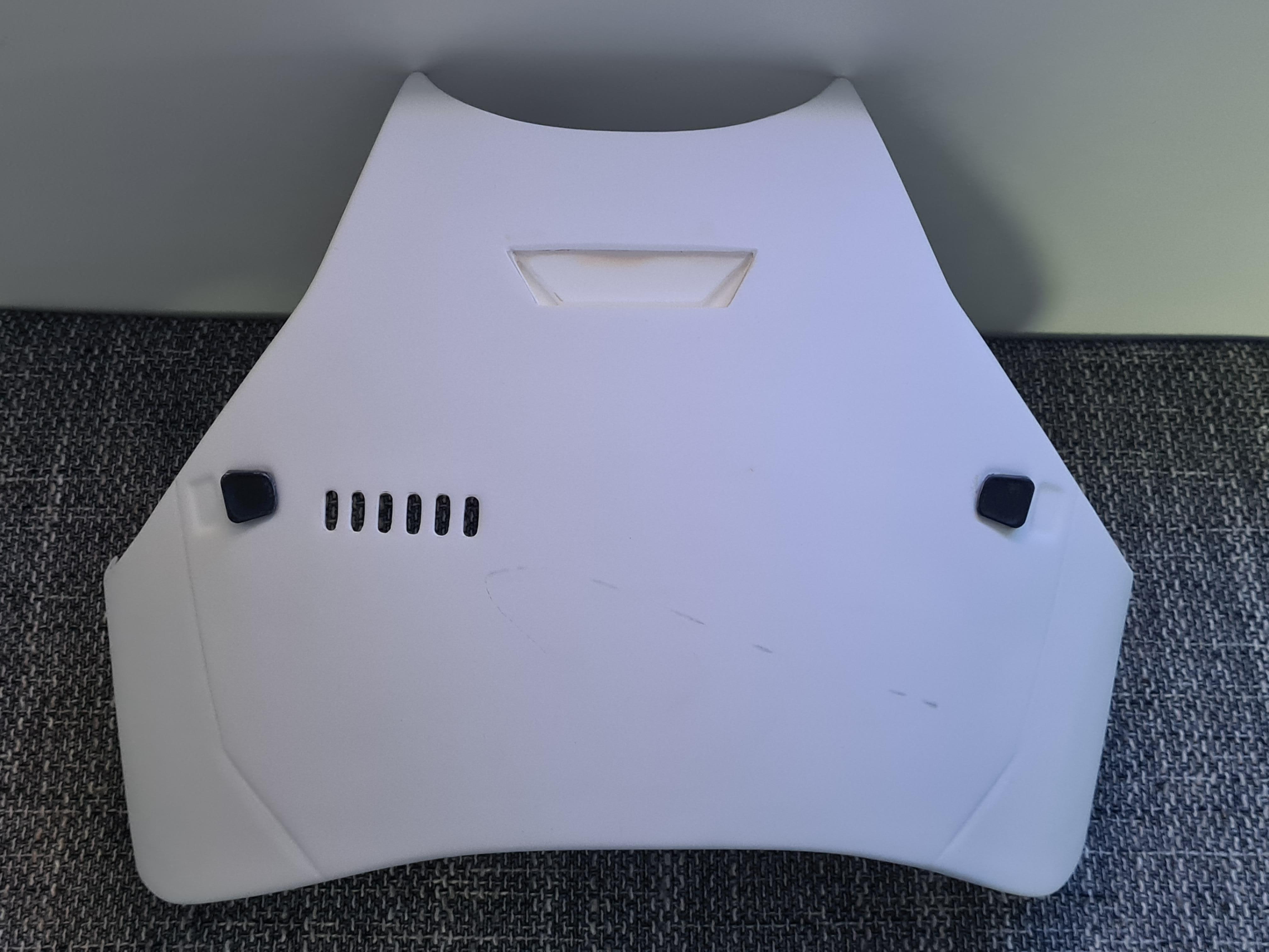

Chest:

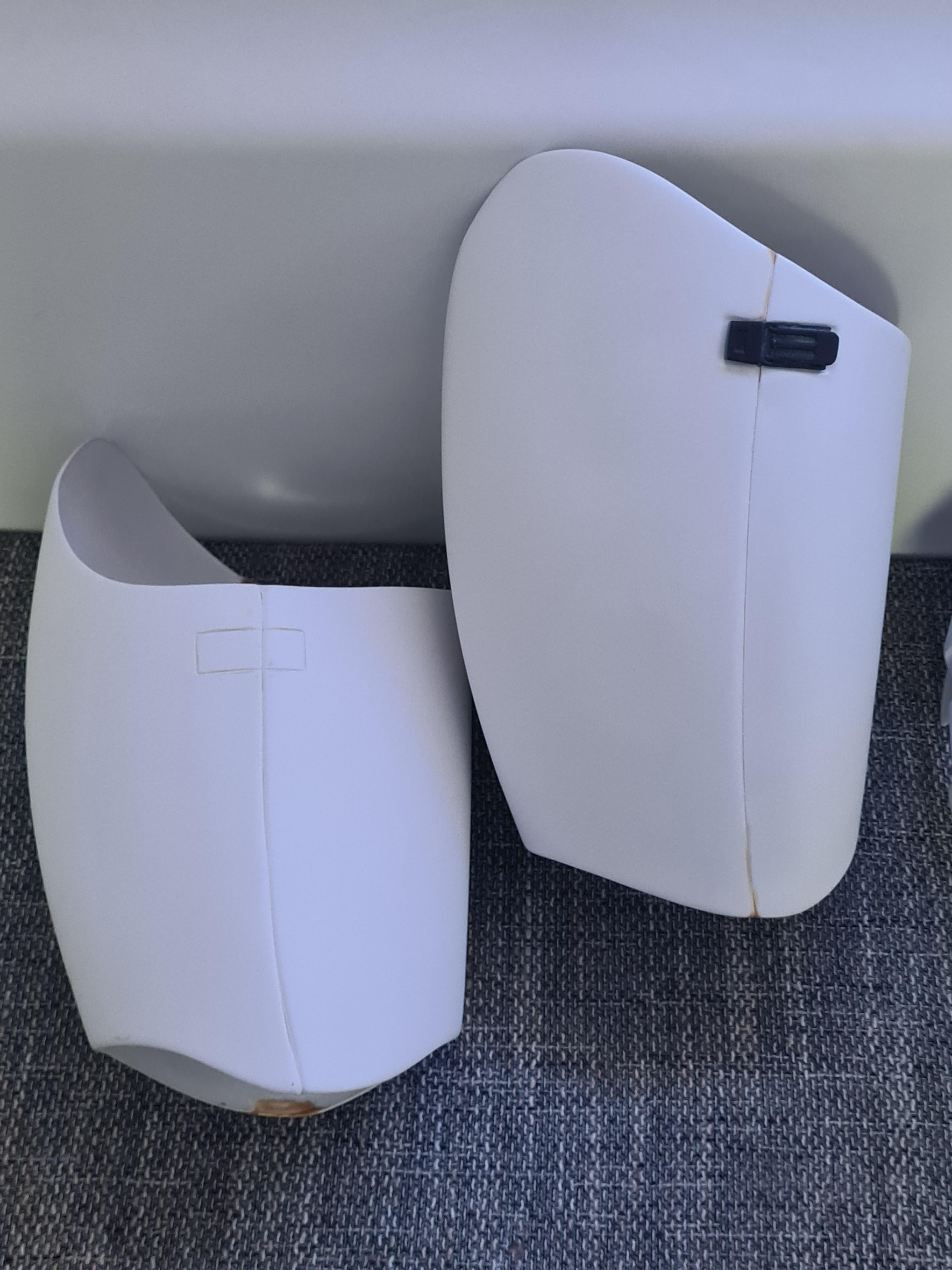

Thighs:
Here I also filled the soft pulled detail and refiled the detail

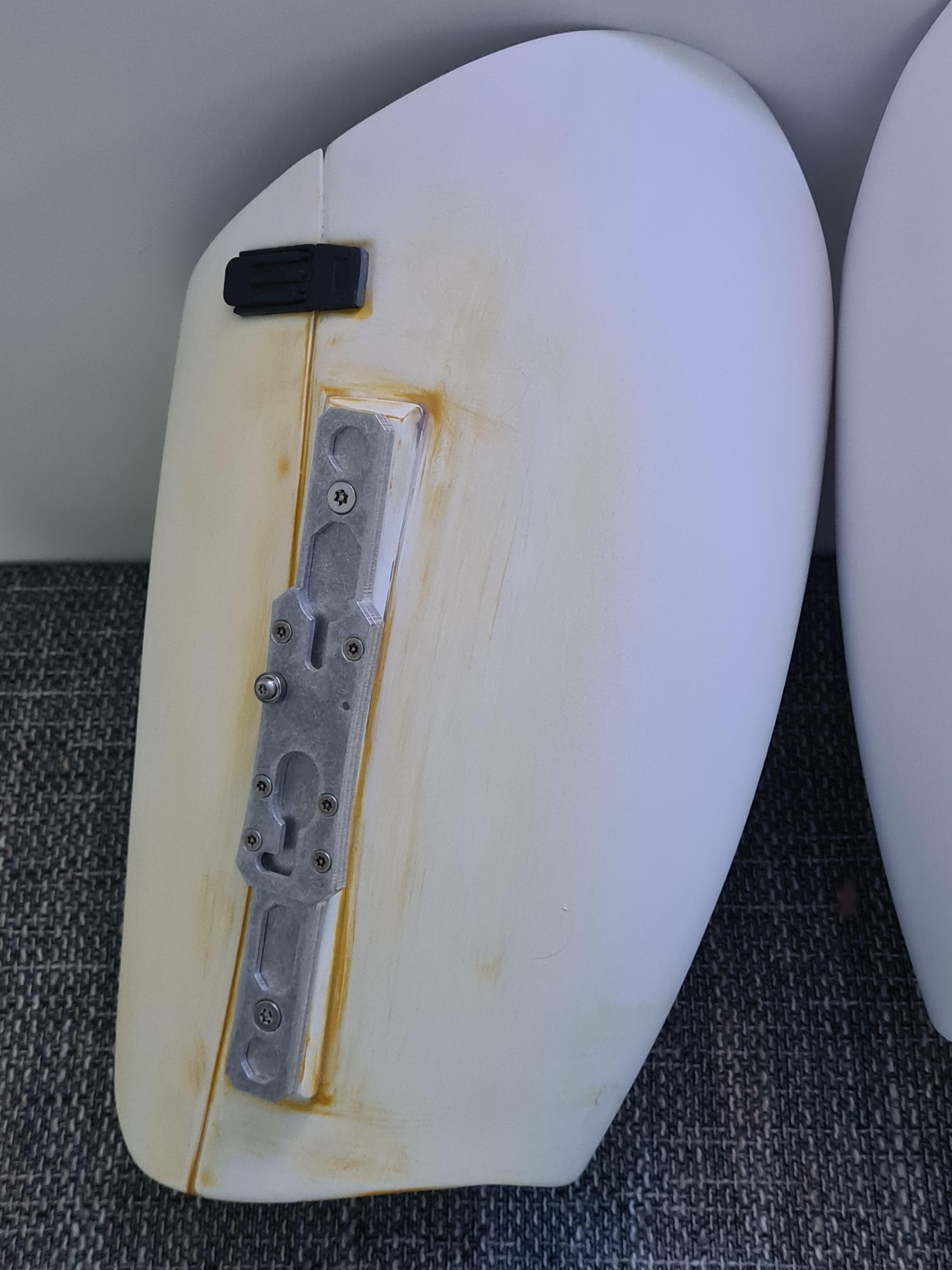

Shins:

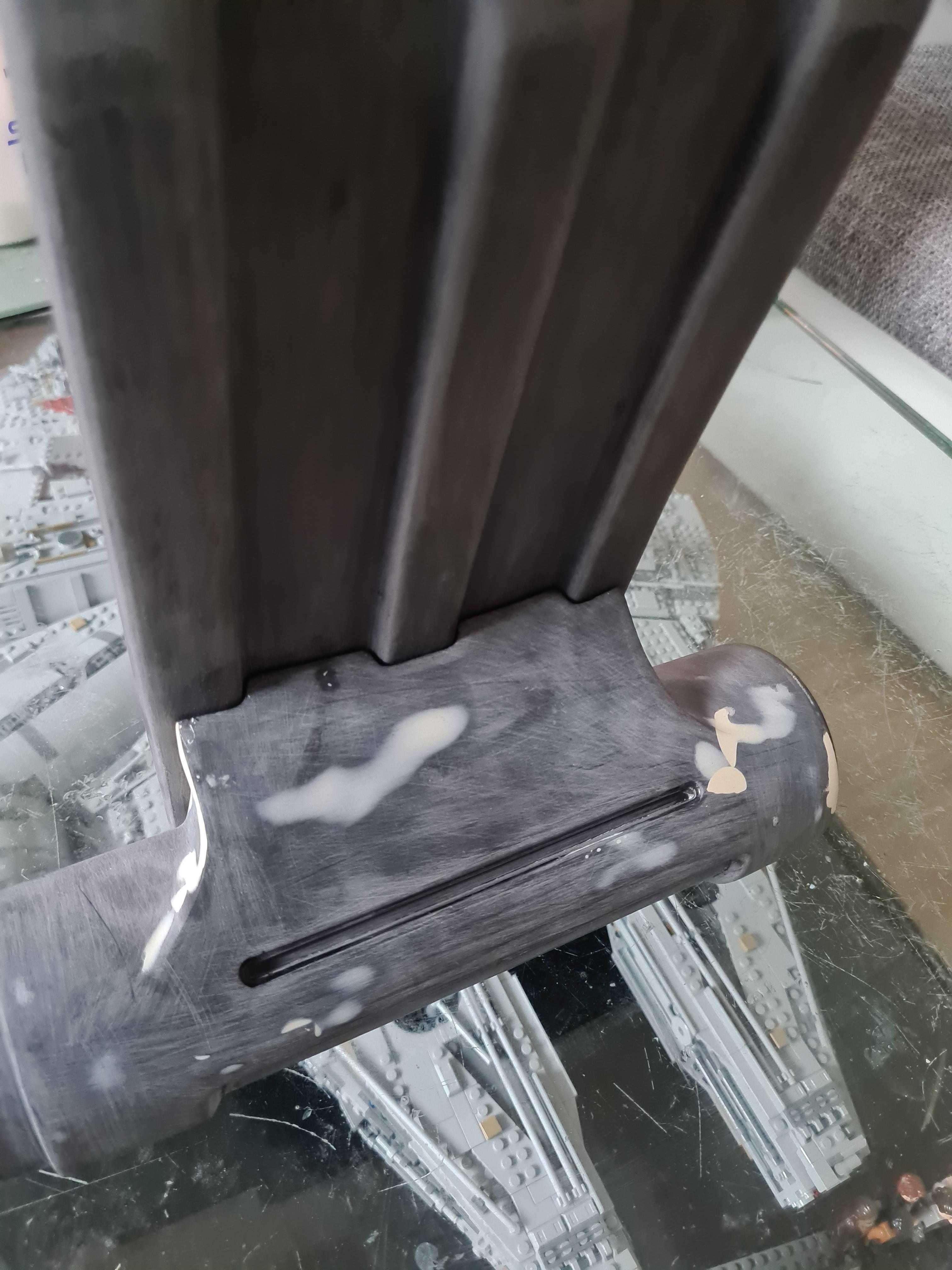

These were kinda tricky. I asked a good friend to help out. Unfortunately both halves werent fixed enough so while the glue hardened, it slightly changed position. To fix this, I filled the seam with 2 part epoxy and refiled the seam.
As I already stated, I got the 2 shin bars 3D scanned. Then I mirrored the parts and printed the left and right version out.
CFO Clip Greeblie

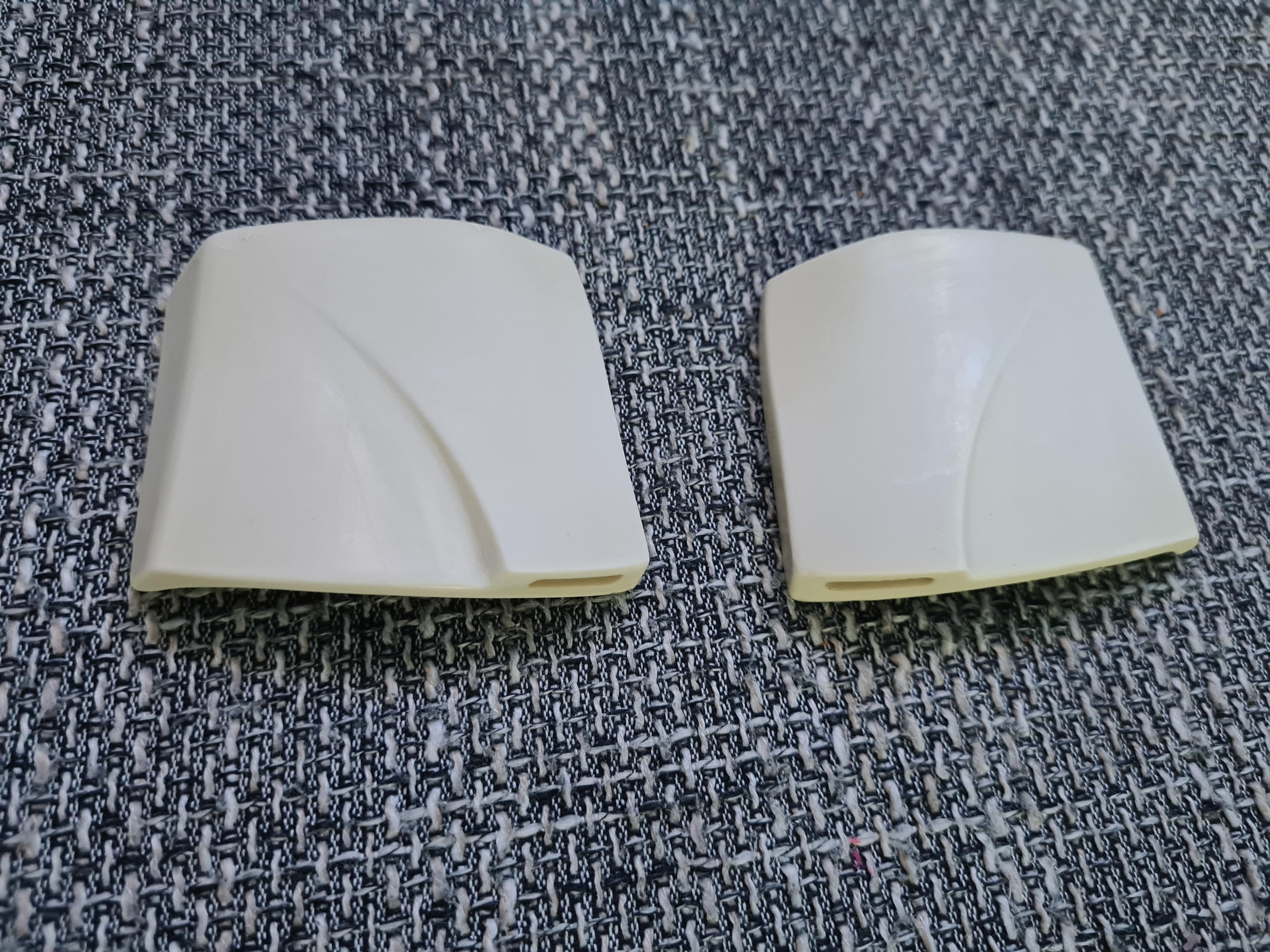

First I thought I can simply make the boot plates by myself, but I know myself, being lazy here and there, got the Imperial Boots FO TK boots 3d scanned and got the plates modeled nicely to fit the boots perfectly.
Was the expense worth it? Depends.
Now I dont get headaches of how I get the plates perfectly symmetrical etc.

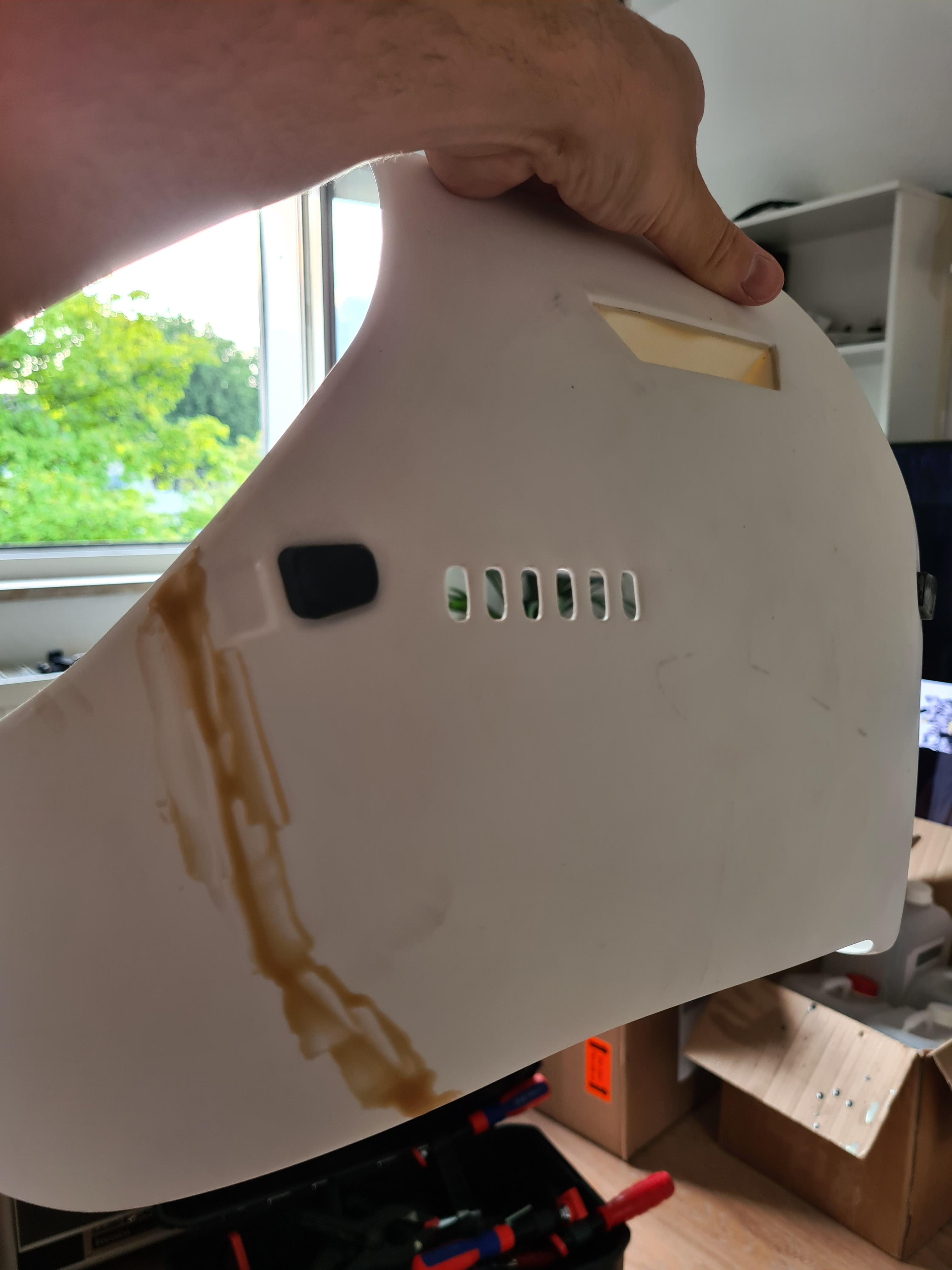

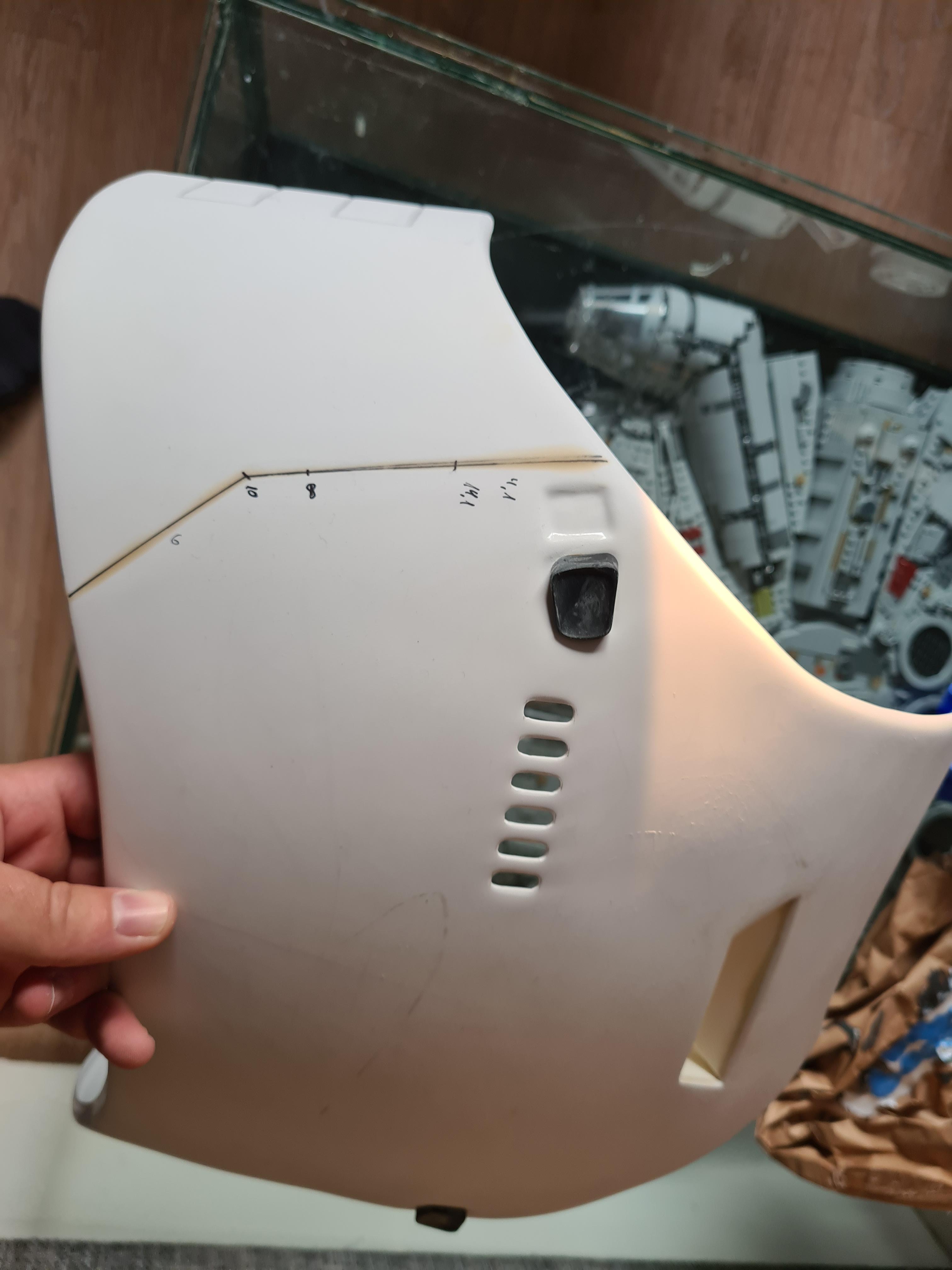

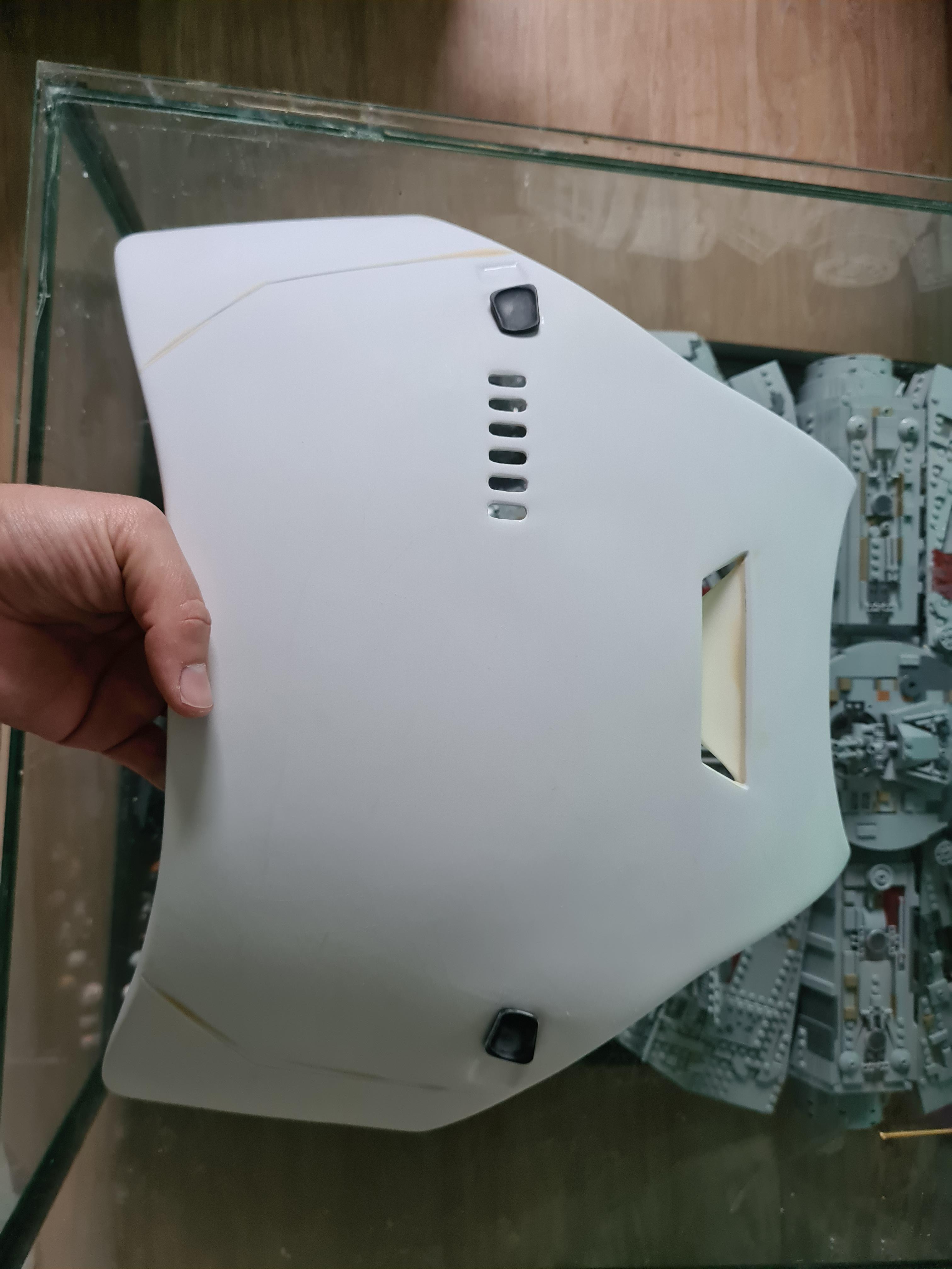

So I spend the entire day to finish up the detonator and did some mods on the chest plate.
The cfo detonator has a foam core. I dremeled on the left side a little hole into the foam and filled it to the top with resin. With a hand sized gas burner I eliminated all air bubbles on the surface, minimizing the clean up work.
The mod on the chest was fairly easy, I thought. First I filled them with 2part epoxy glue and sanded everything down with a mouse sander. It turned out those engraved lines are not symmetrical. My inner OCD triggered af taking out the measurement band..
Once everything measured correctly, I took the cutting tool of my dremel and pre cut the new lines and then refined them with a regular file. Then I cut out the slot detail by simply sanding the back side of the resin block. Done

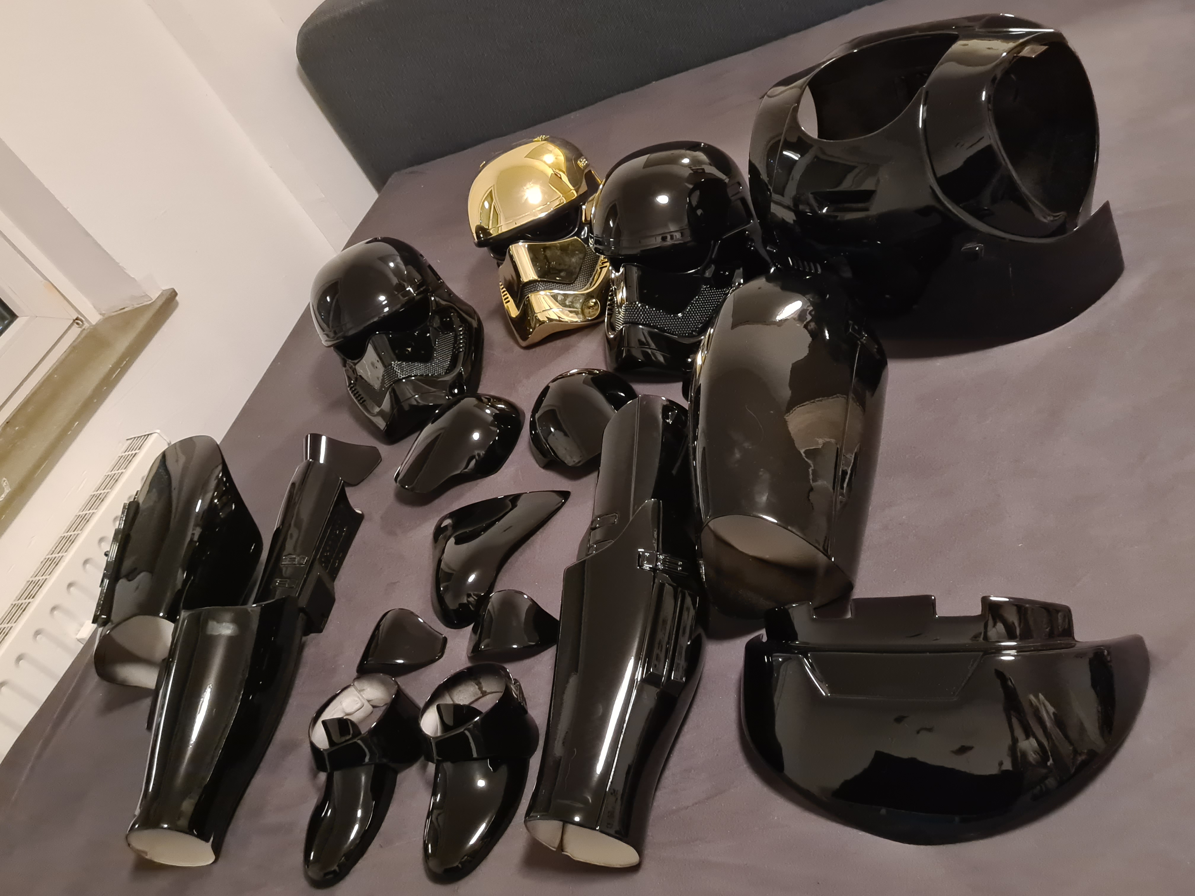

In general, I can only say: I didn't think that everything would work out like this, but the stress was absolutely worth it. Sunday was definitely one of the best days of my life. Here are the pictures
A new helmet is needed for the CRL. The helmet is already gold chrome-plated and will then get the black details at some point in the days.
+ taking photos for the CRL of the individual parts
