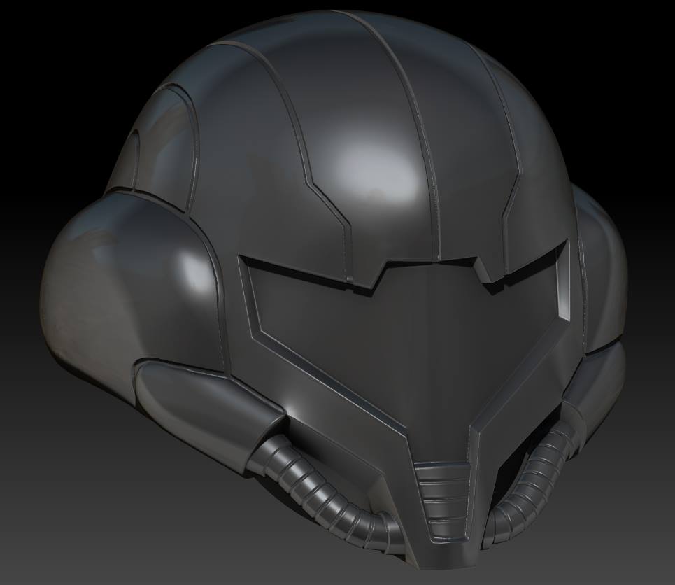

My digital sculpt was done in 3ds max 2015 and Zbrush 4r7. Please excuse the othographic screencap.

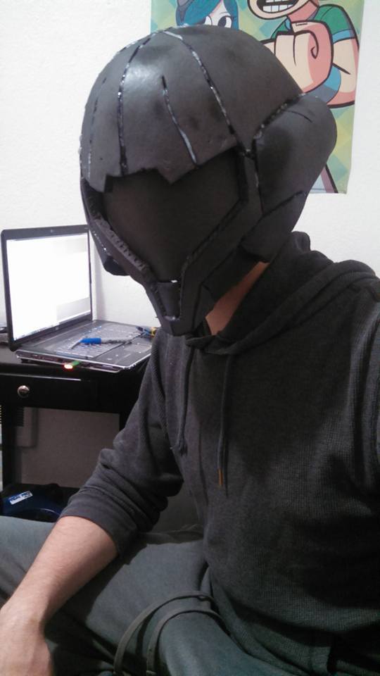

This is my version of the helm from Metroid Prime 3. I initially went with a pepakura foam build because of the hefty cost of a 3d print. The results were...underwhelming.
Ok so the results were hilariously bad. Obviously I had to change tactics. I've been casting things in silicone and fiberglass for a while, so I picked up some casteline and discovered I didn't care for traditional sculpting. I attempted to go through Shapeways to print pieces of the helm, but it was way over the top expensive. I decided that instead of spending around $1000 on a single print, I'd rather spend $1800 on a personal 3d printer that could get my props at least 70% there. I'm a professional game artist, and sculpting things out in 3d is a relatively trivial exercise for me, so this method really played to my strengths. After getting the hang of printing I started to print the Samus helmet.

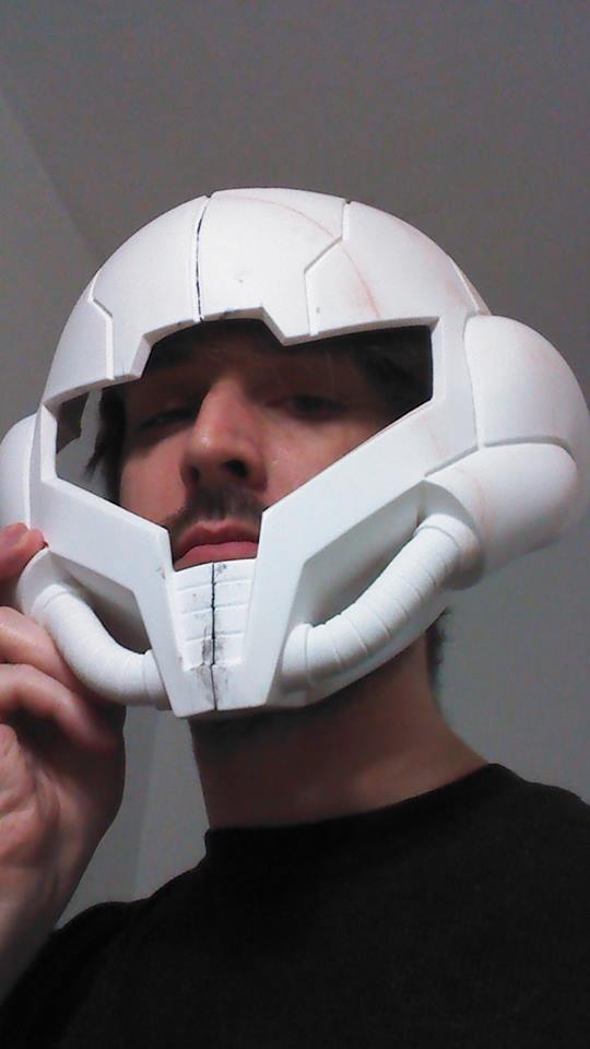

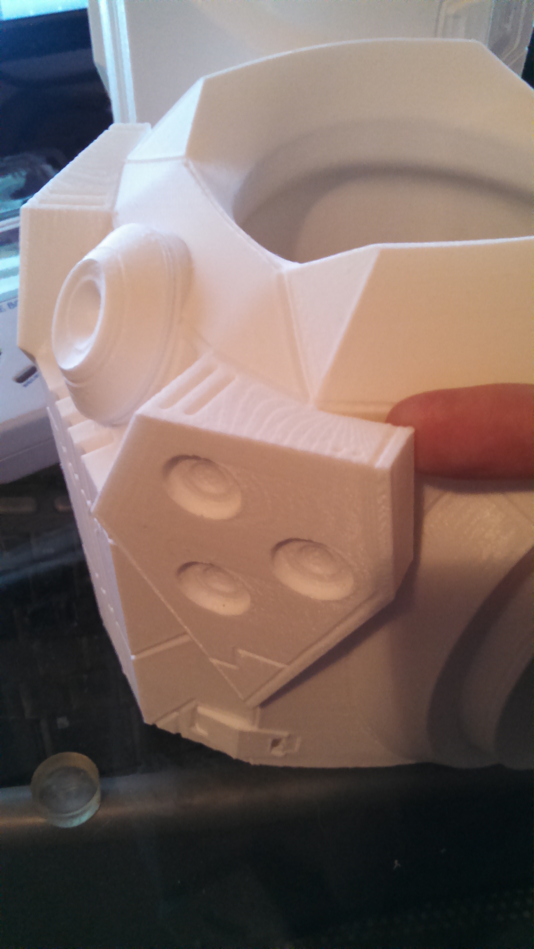

Obviously if you've ever 3d printed something you'll know that there are a couple major hurdles for creating high quality props: the print lines, and the bed size. To address the bed size issue, I ended up splitting the helm into 5 sections and printing them all separately. Then I used JB Weld 6 minute epoxy to glue them all together.
The other problem is the print lines. I spent about a month messing with my print settings to find ways to reduce this effect as much as possible. Then I had problems with the print warping because it wouldn't stick to the bed. Printing on bare glass and using aqua net hairspray was the eventual solution to that (thanks internet). Sadly I was still experiencing these problems when I printed the helm and several of the pieces ended up fairly warped. I ended up sanding the unholy poop out of them and using bondo to smooth out the warping, print lines and seams. Hitting it with a coat of primer was super useful to see what areas still needed attention.

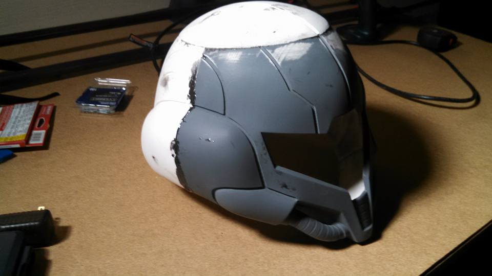

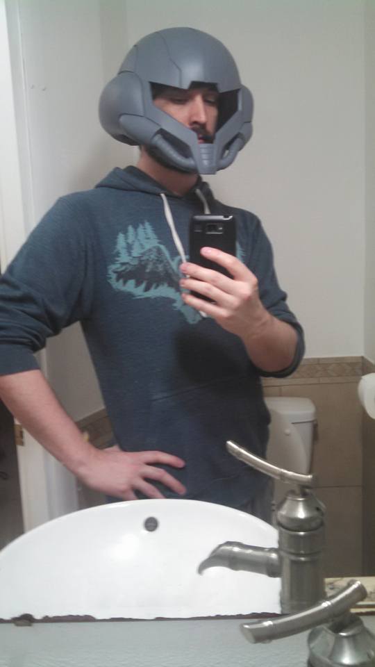

This is where I'm at now. I'm probably going to be using Duplicolor barcelona red paint for it, since I think that's what Talaaya used, and her red looks spot on.

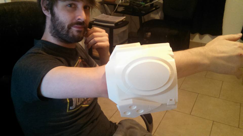

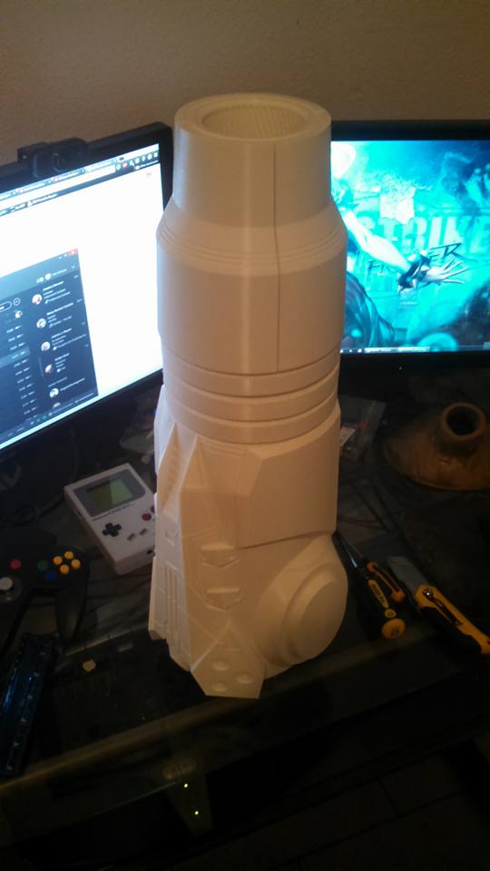

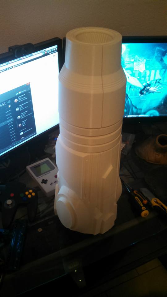

And I started printing the gun as well:
Still unsure about how to paint the gun, or how to tint acrylic green for the visor. Does anybody have any suggestions?

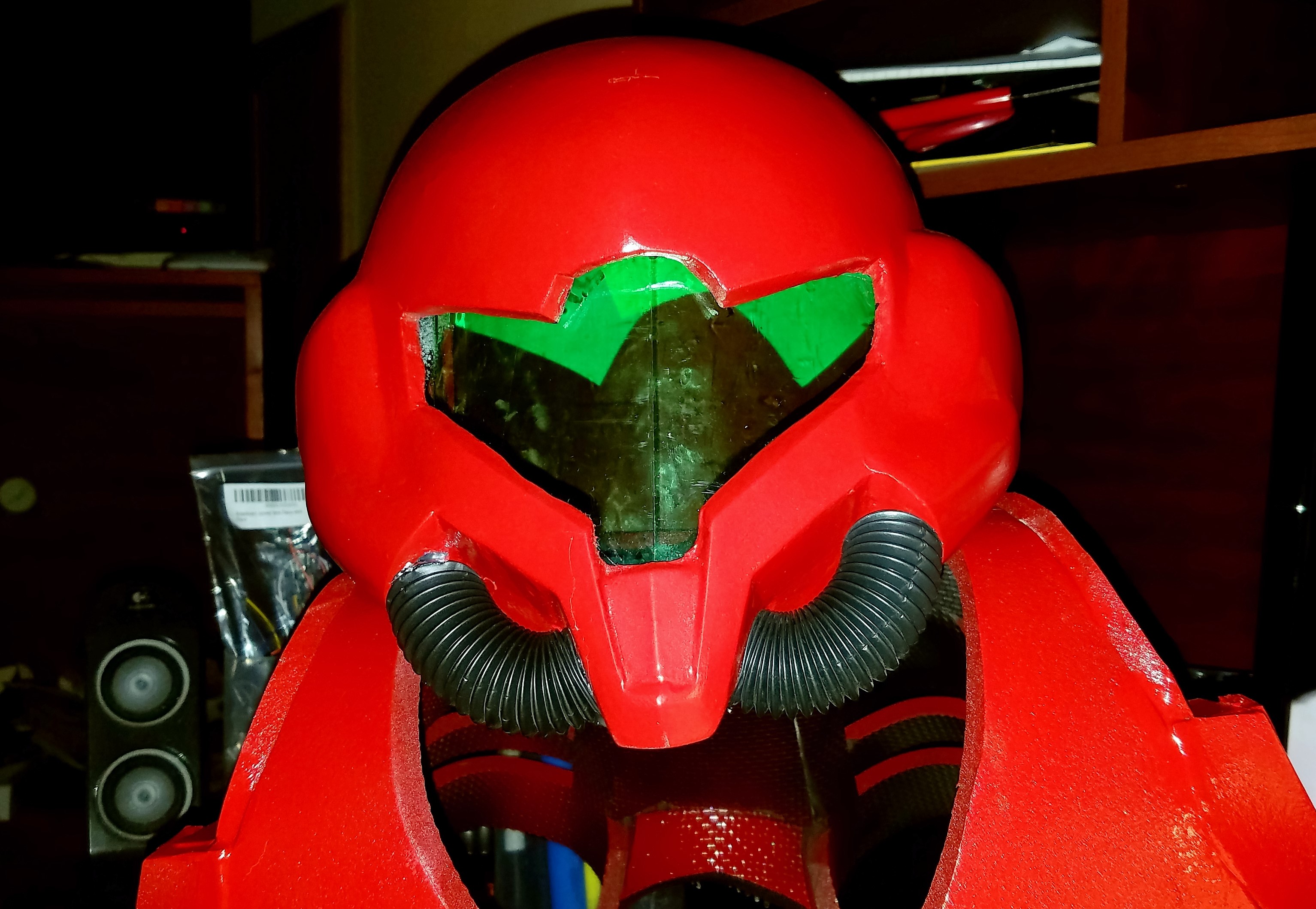

For the tint on the visor, there are several ways to do it, I did the old cheap way, and just cut a green 2 litter bottle up and used that to color the clear face shield.

Other options that I have seen used, are the same that people use when making Halo helmets, use motor cycle face shields, you can find them in all colors and get them pretty cheap from Ebay. I may go back and replace the face plate on my wife's Samus suit with one from a motorcycle helmet, but I have a short deadline and under funds at the moment :).

As for the visor, I can't recall if I explained in my own thread how I did it, but if not: I used fluorescent green acrylic. To shape it I 3d printed a negative of the visor hole which I used as a mold to press the acrylic into after I heated it up in the oven. It was really hard to get it to stay uniform and really get pressed into the mold with just my hands. Next time I think I would create another print to press it into the mold evenly. To create the mirrored effect I got some 2 way mirror window film which is normally applied to house windows. As long as it's darker in the helmet than it is outside of the helmet I can see perfectly well and no one can see in no matter what. The caveat with using this stuff, however, is that your surface has to be perfectly even on two axes; the film does not work on compound curves. I tried to keep it bent on only the one axis but like I mentioned before, it was hard to press it into the mold evenly. There's a small spot near the bottom of my visor which sometimes gets an air bubble but luckily you don't really notice.
If you don't want to go this route there are other methods I've seen where people actually do a light coat of paint on the inside of the visor. Halo visors are the most common example, but MWiggs wonderfully explained the technique in his Terran Marine thread.

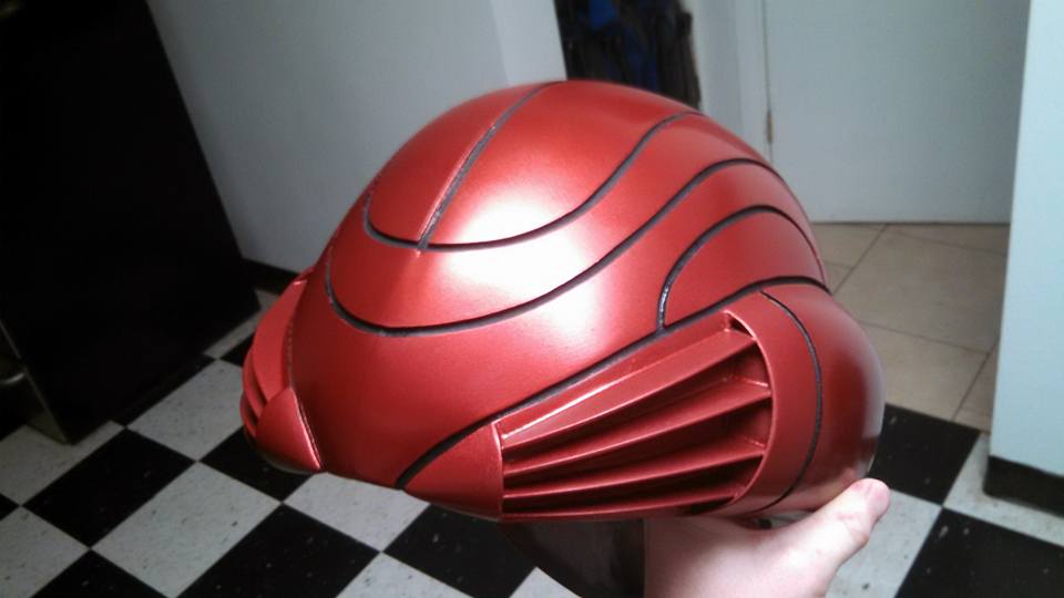

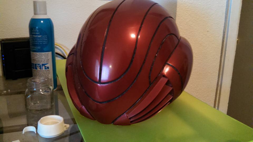

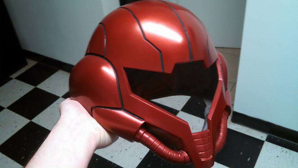

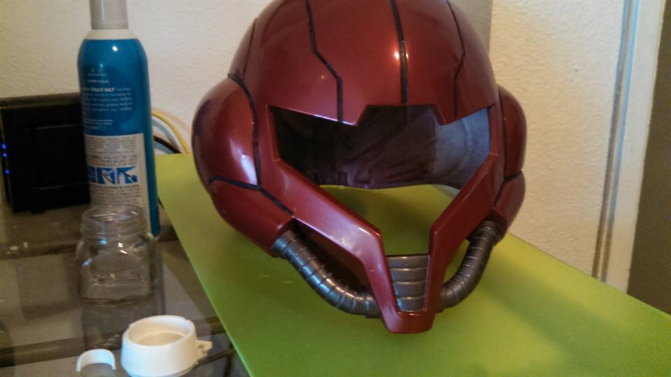

Painted the Samus helm red, and spent some time painting some black into the grooves to really make everything pop. Still have a lot of work to do. It may look shiny now, but this is without any kind of coating. I'm going to wax this thing to a mirror shine. I also have to paint the tubing and mouthpiece grey, make a headpiece and padding for the inside, and do electronics. I also got the acrylic for the visor, so I'll have to mold that stuff. Getting there!
I also printed the rest of the gun. It's not epoxied together or anything yet, but here it is

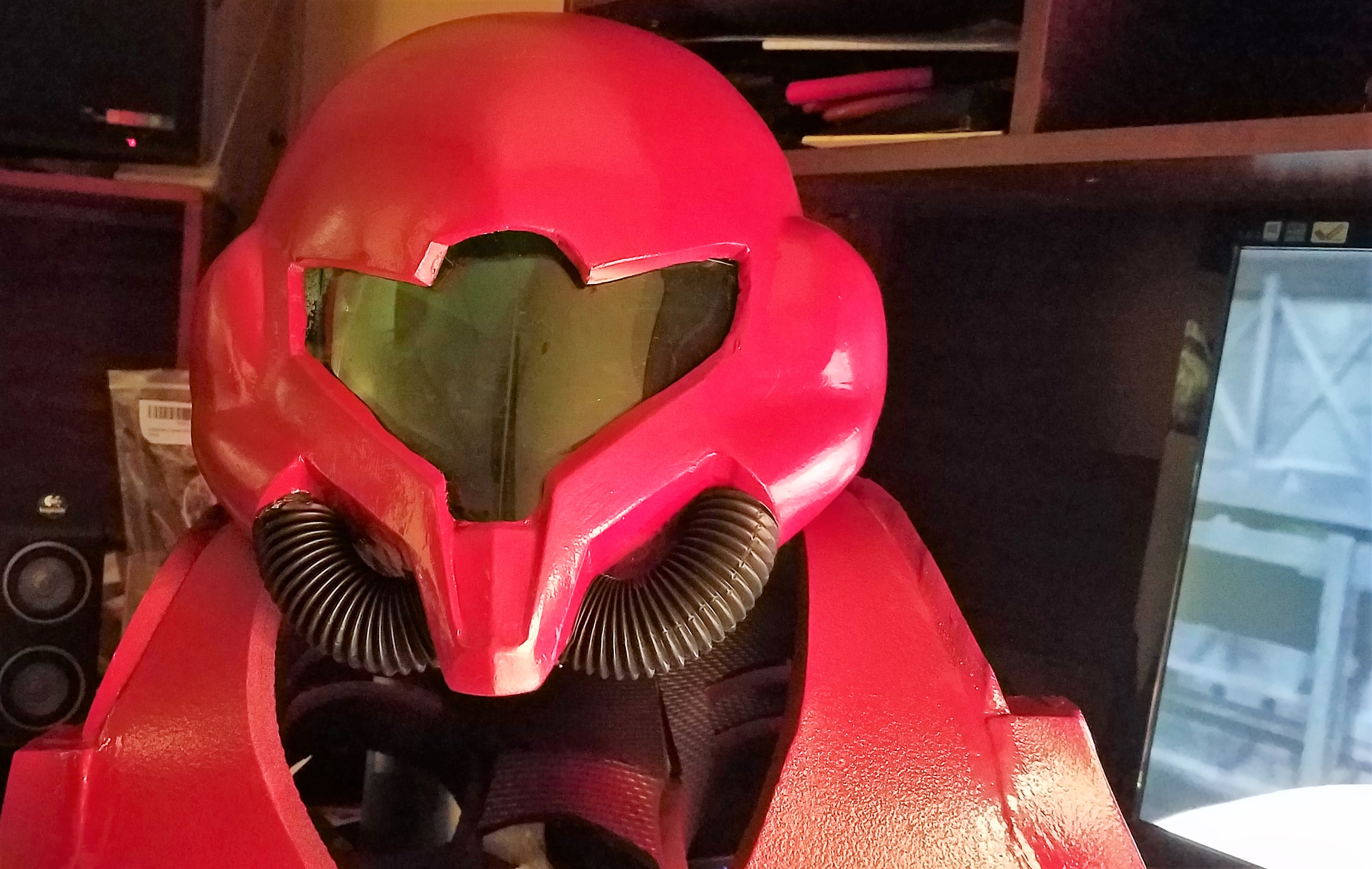

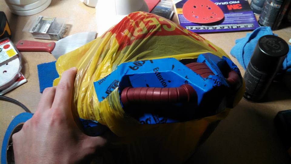

Quick update! Got my grey paint in the mail and finished the paint job on the helm. Taping and spraying behind those tubes wasn't easy.
After that I got busy wet sanding, waxing and buffing. At this point I'd say the base paint job is sealed and finished. And shiny! Weathering pass is next, followed by molding the visor.
Awww yiss! Looking great! And I can definitely empathize about masking and painting the tubes. Gah.

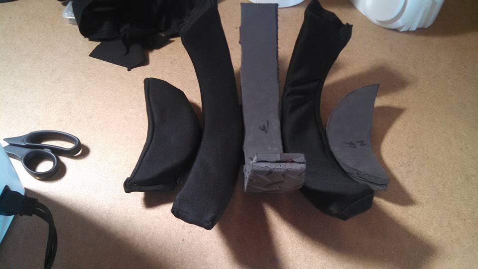

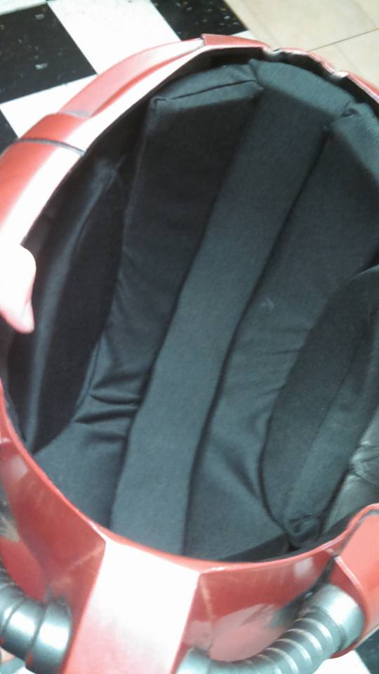

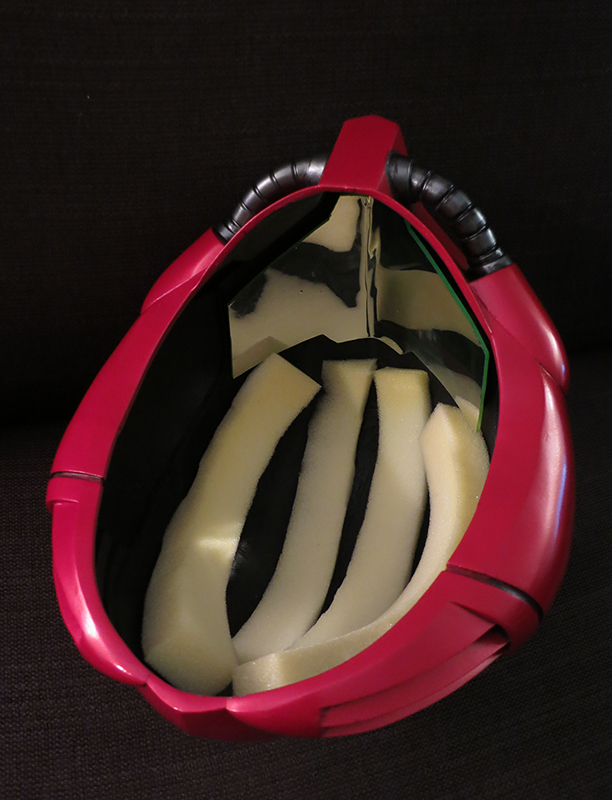

Still working on this, amidst being sick and working a bunch. I did a subtle weathering pass on the helm and did the interior. It's now fully padded inside and super comfortable.
To get the pattern I grabbed a plastic grocery bag, stuck it inside the helmet and traced out strips, then traced those strips onto the foam. The folds in the bag made it difficult, but I managed to get a decent result. This padding is just a double layer of eva foam. I grabbed some soft fabric from the store and sewed little pouches for the inserts, just to class it up a little and make it more comfortable to wear. I attached it all using velcro in the helmet so I could easily remove it later if I needed to.
Now that the inserts are in, the helmet doesn't slide around at all when I move my head. The foam makes it sit properly on my head and hugs my chin perfectly. I guess I didn't oversize it after all! I could wear this thing all day. I still might make one more little pad and attach it near the base of the skull in the back so that it doesn't slide around when I look down.
