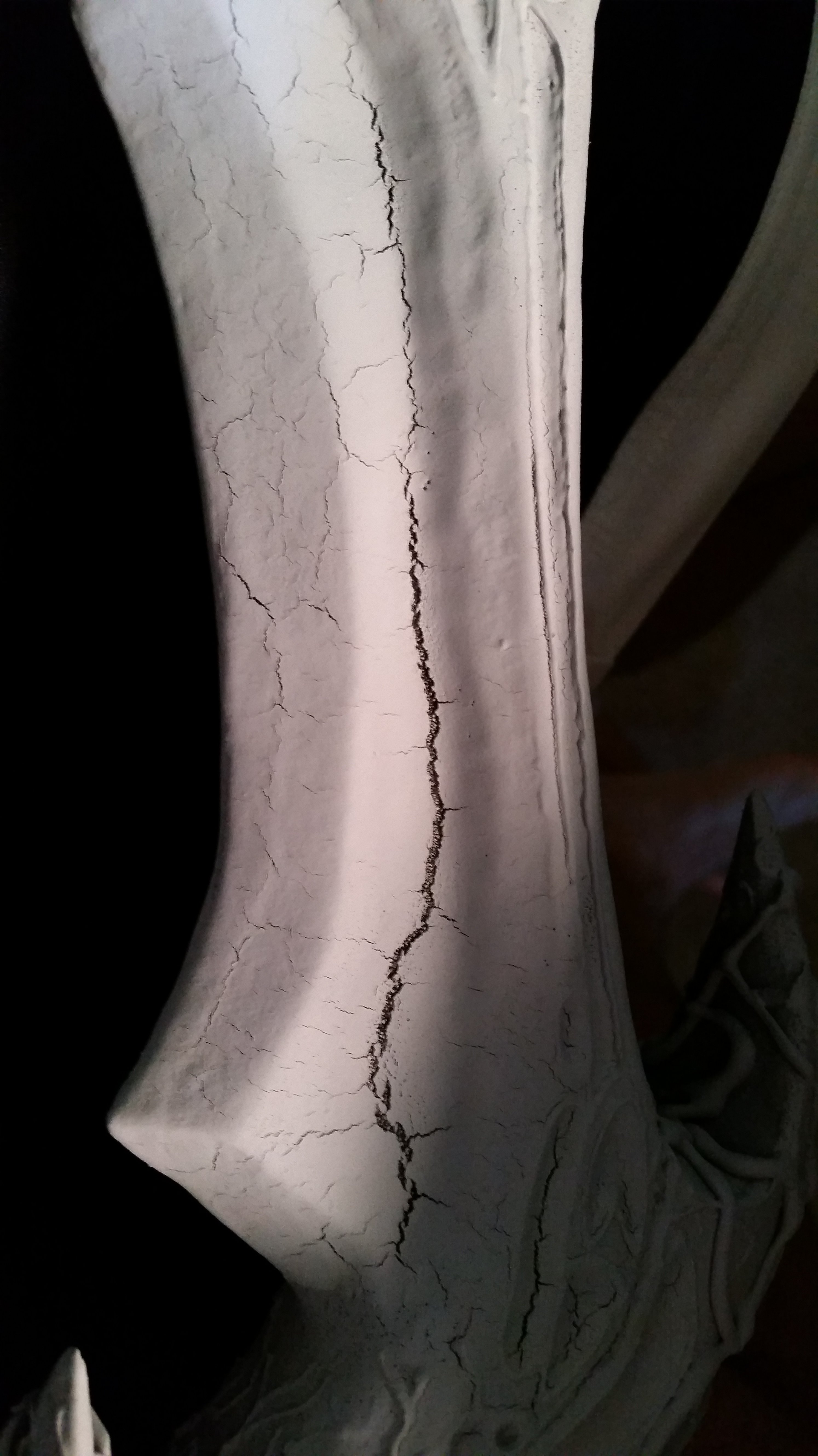

Hello,
I have two different queries: first, I have been working on a Daedric sword using EVA foam as the base. I've gotten to the point where I'd like to begin painting it. I used a few coats of spray plasti-dip followed by a coat of automotive filler primer (which I had used before on resin/bondo pieces) but the end result was that the primer cracked as seen in the picture. How would I go about fixing this? Try to cover it in more plasti-dip or more primer? Should I use a different type of primer for EVA foam? I'd also like to point out that I didn't try to bend/flex the sword at all, that is just how the primer dried, so maybe it shrank in the process.

I'm wondering the same thing. I just tried my first project using 3:1 PVA (wood glue) mixture, 3 coats with sanding in between which was recommended on another post "The definitive guide to sealing foam..." It didn't work at all for me. Cracked like an egg and now I'm trying to figure out how to fix it. Sounds like PlastiDip might be better but I've heard it looks muddy and imperfect. Just FYI.
I did extensive research on just about every coating/sealing process you can think of, and much like you, dkasai, PVA just cracked liked crazy for me no matter how much I watered it down or how thick I put it on. Mod-podge was a little better but still wasn't able to take an impact without cracking. I even tried using just paint directly on the EVA foam but even that had a hard time. I used straight Plastidip in the end and after 3 coats of primer and some light sanding with 600 grit the surface came out more smooth than I could have hoped for. Still won't be smooth as glass, but unless you're polishing the surface to a high gloss that shouldn't be a problem. What works for one may not work for all. Just my 2 cents. Good luck!

The problem that occurred with your project was probably that you used bondo AFTER plasti dipping. Bondo isn't the best becuase it is rigid and the foam is flexible, so when the foam flexes, the bondo can crack. To seal cracks you need to use a flexible paintable caulking. I used Kwik Seal by DAP. Use caulking first to seal the imperfections, THEN plasti-dip and paint.
