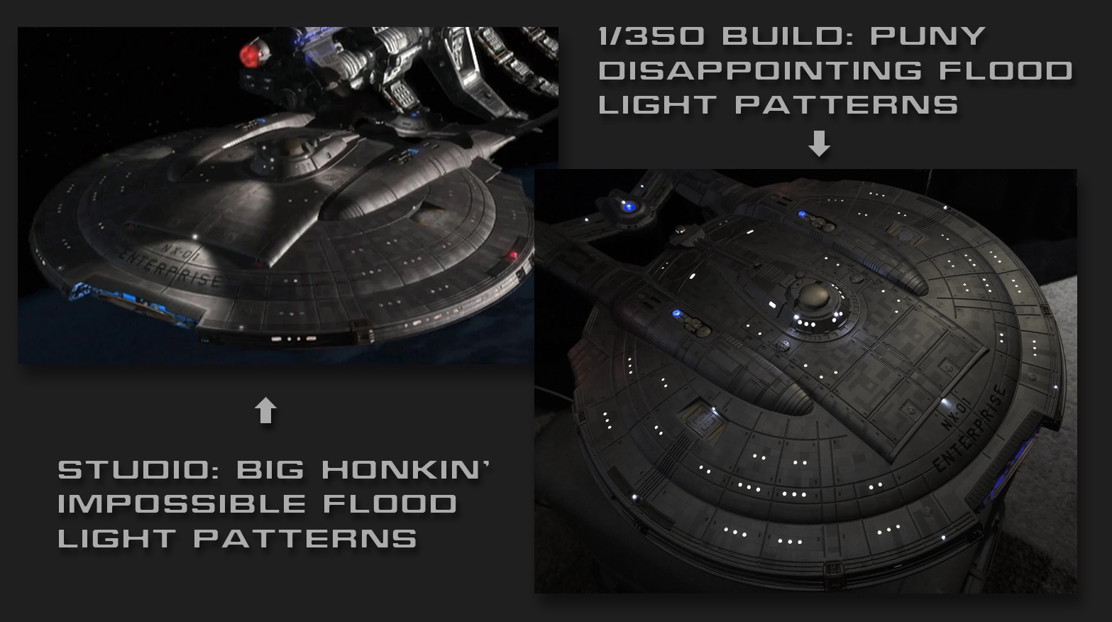

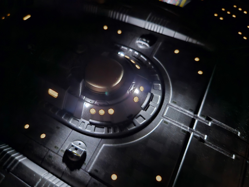

Thanks! For some of the floods, I think a different surface treatment would probably help. I used Dupli-Color Matte Wheel Finish for every layer of clear coating, and there are several layers. It's really interesting stuff in that it provides a matte finish but is still perfectly slick so you can slide decals around on it, but it seems to kill gloss by almost eating the light that hits it. I don't know exactly how - maybe it just refracts it around internally until it dissipates - I don't know how else to explain it. Anyway, I'm certain that is at least a portion of the problem, but I'm hesitant to try to dull it up any further in fear that it would lose all of its metallic look. For this model, I'd probably choose something different if I was to do it again.
I get semi-ok results if I adjust the rest of the lights down really low and adjust the exposure on the camera, which makes me think you're absolutely right about the type of clear coat helping for at least some of the floods. (I apologize for not dusting it first)

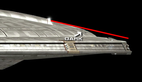

The biggest problem with the NX-01 is the registry flood. It's physically not possible to cast light across the curve of the saucer from the super low-profile spot where the flood lives. There were several things about the first 100% CGI Star Trek ship that made it a challenging build, but some of the lighting is literally impossible, no matter what kind of lens you throw at it.
I played around with shining a little pen light at it, and it looks really good. This is why I'm thinking that at least for this one, something shining straight down on it might be the only hope to give it that look. The real question is, what can I use? Cheapo digital mini projector? Mini slide projector of some kind? Flashlight reflectors with LEDs shining through film with patterns? Surely someone has done something similar at some point.
The low light results seem to come very close to the CGI model... hmmm. Now I'm thinking 'shadow box' techniques, with a turntable, deep black interior and some 'star field' masks for the background, even one with 'warp streaking'... action viewed through an inset window to reduce outside light 'polluting' the effects... just brainstorming.

The floods in the model are all 1mm fiber optics with a poor-man's lens at their end, formed by holding them a couple inches over a lighter until they just started to melt. 1mm is way too big to be scale, but the minimum diameter I found that could transmit a reasonable amount of light from a 5mm ultra-bright LED.
I am painfully aware of the inaccurate lighting of the CGI model in the show; there are always what seem to be at least 3 light sources present for the render whether or not the ship is supposed to be inside of a solar system. I plan to have an Arduino-controlled bright white flood shining down on the model as a whole from an angle in the hood of the display case for the sake of making it look more like the on-screen ship. I assembled a "video study" of the NX-01 pretty early on, compiling about 4 minutes of just rendered cenes from the show. I must have watched it a hundred times, and learned something new with nearly each viewing.
My goal is absolutely to make it look as much like what was seen on-screen as possible. The thing that made me build my own lighting solution from scratch in the first place is the fact that EVERY after-market lighting kit just blinks nav & strobe LEDs instantly on and off without paying any real attention to the timing, let alone the fact that the CGI strobes & navs took 100ms or so to fade in and out. A couple of frames of fading might sound trivial, but I think the fading adds significantly to the sense of scale. It's mind boggling to me how little attention is paid to detail by companies who make money from selling lighting kits.
I get that a lot of modelers strive to duplicate the studio model (which there was none in this case), but my personal preference is to come as close to what was seen on screen as possible. I'm way more interested in reproducing what I remember than I am in reproducing the tool that was used to make the memory.
Just for fun, I'll leave you with a little side-by-side test I put together to double check my work in emulating the CGI timings.
