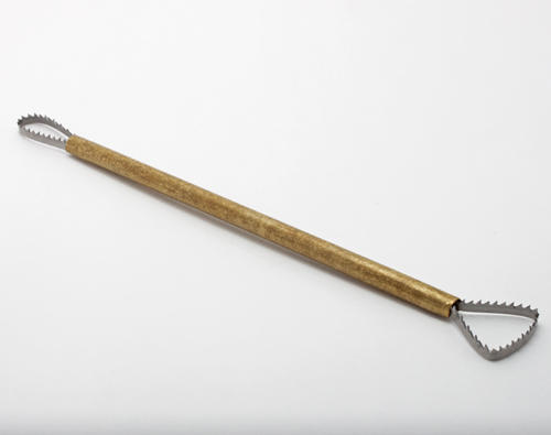

Before you get to actually using a solvent to smooth the surface, you should go over it with a rake tool, to help blend in the bumps, and help you better discern high/low spots.

You need a mechanical tool before you get to the Solvent part. A tool such as a metal kidney, a Rake, or Loop, will even out the surface.
