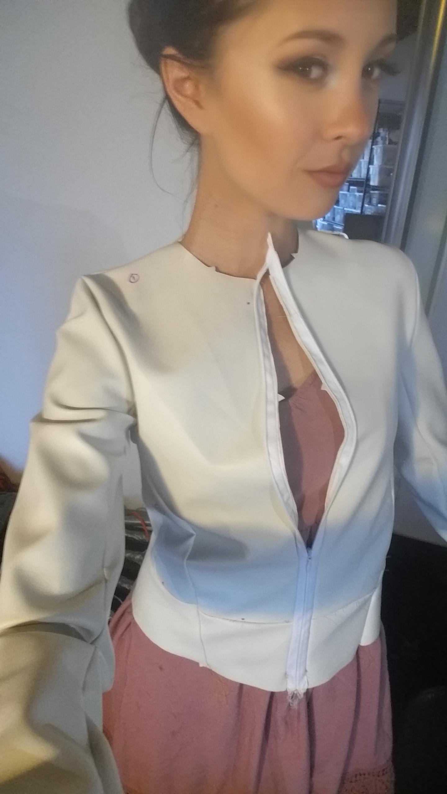

I first sewed a mock-up by throwing together a Vogue pattern for a leather jacket. Then I drew all over it with a sharpie to figure out the pattern and how to layer all the pieces. Then I cut it up and did a second mock-up to make sure it was right and would fit.

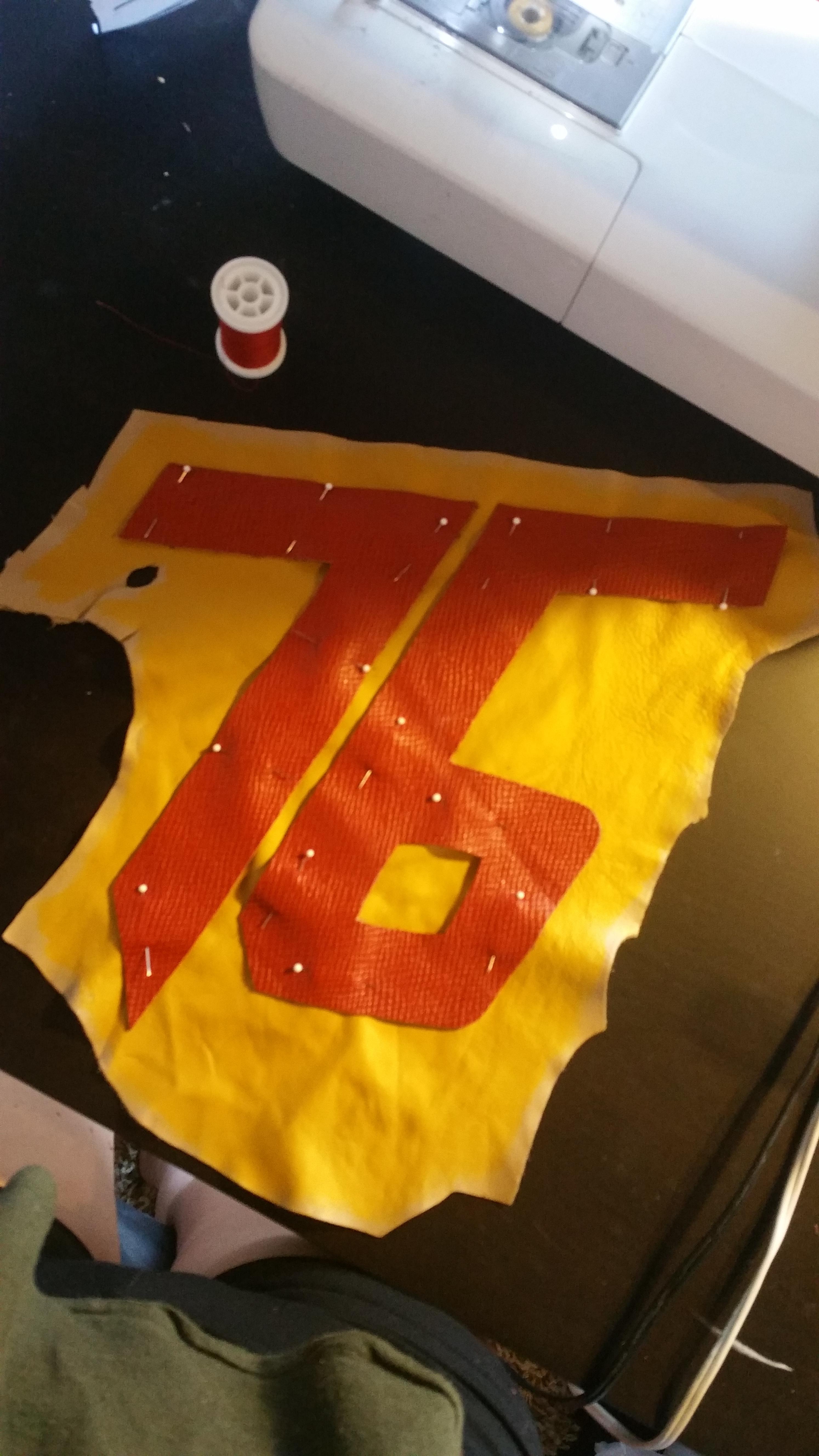

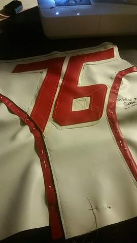

I used normal polyester thread, but a leather sewing machine needle which helped a TON. I started with the 76 on top of yellow, then on black, then on white, then on red. Then I sewed that piece to the black. There is basically a full black jacket under it all to sew the various pieces to.

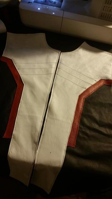

The front is layered white on top of red. I cut out the pocket shape and lined it with half of a zipper, then sewed it down to the front. I know it should be a functional zipper, but I didn't want to deal with that since I didn't want to have functional pockets anyway. I'd rather it lay flat on my stomach; Soldier has hella pockets everywhere anyway. Next I sewed the blue trim down the front. I also sewed the sleeves in layers, and tested them for length before sewing them to the jacket. There are like 7 layers at the sleeve seam, so i had to sew VERY slowly and my machine wasn't happy, but it did it just fine!

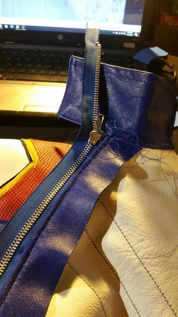

I also sewed down the belt part at the bottom of the jacket, and gave it loops to feed through. The type of zipper you need is called an "Open End Separating Zipper" and has the thing you hook on at the bottom so the jacket can open. After the zipper was on, I sewed blue leather to the inside of the jacket so it looks finished on the inside when it's open at the top.

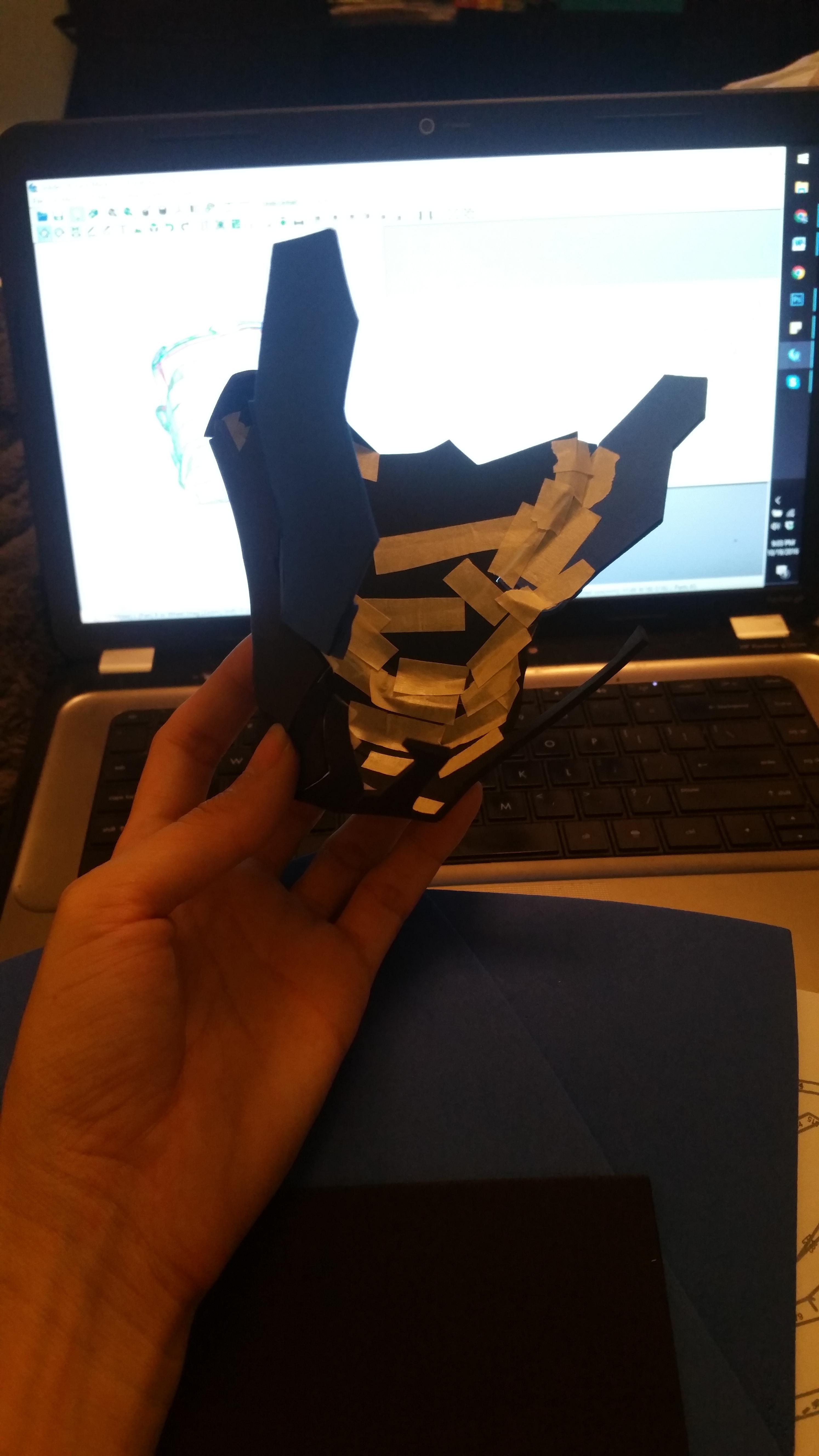

My pep file is from papercraft square (I think). The file name is Soldier_76_Face_Mask_2.0. I printed out it 3 times before I finally got it right; ended up with a 149mm height on a 16.0 scale. I built only the chin to nose piece for each resizing I did so I could see if it fit without building the whole damn thing.
I happened to have 3mm craft foam in black and blue, so I cut it onto that so I'd have a good idea of the color and shapes. Since I plan to use a combo of EVA and craft foam, I printed without flaps, pinned the tiny pieces to foam, traced, cut, and used masking tape to hold it together from the inside.
This is the final shape! I want it to stay pretty thin, so the parts around my mouth will probably be 3mm craft foam wrapped in worbla. The side pieces I'm going to make out of 1/4" and 1/2" thick L200 EVA foam so that the edges and bevels are cleaner. I want the visor to be detachable, so I am probably going to rework how it's shaped around the eyepiece and use magnets. I have a fluorescent acrylic red sheet for the visor as well as EL tape. Just gotta wait for the magnets to get here!
