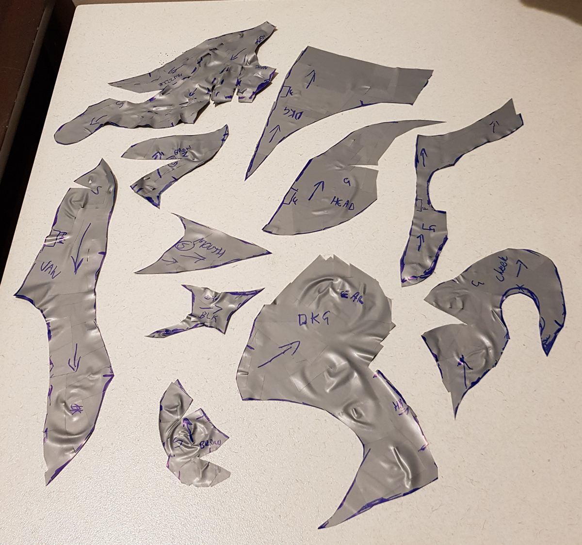

Then, it's patterning time. I used this mask to make a tutorial back when I had a patreon going since it's such a complex shape. Simple duct-tape patternmaking method, never fails if you make sure to do it carefully and mark it up correctly. Results:

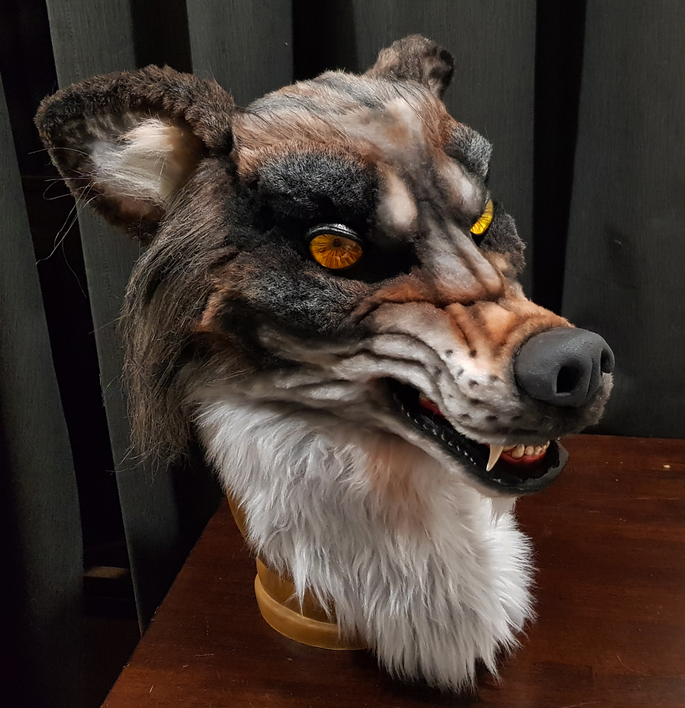

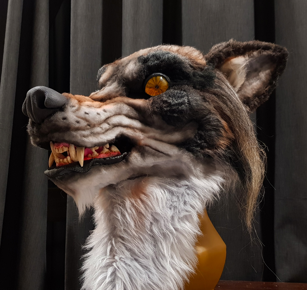

Messy! Still, not terrible. After that, it's finishing touches - namely adding the neck piece and airbrushing. I didn't add a back neck piece since this one's going to have a raised neck piece attached to the bodysuit for that "hunched" look. Airbrushing is freaking magic though, I swear. The difference is crazy. Thankyou, magic awkward finger-hurty loud PSSH pencil.
Steve face - DONE.
I love this one. It's a nice combo of creepy and silly, and it'll go great with the dumpy office werewolf dadbod-muscle suit combo I'm going for. Aww yiss.

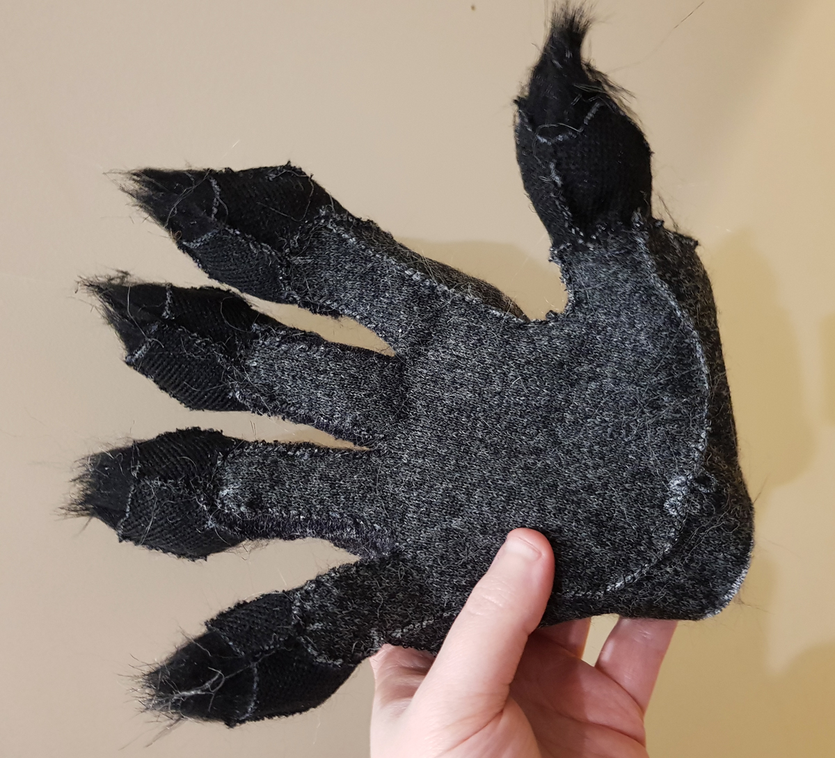

Super simple foam, as you can see. Can't really get too crazy with detail when you're using faux fur because the pile hides a lot unless you shave it almost to the backing, so best to keep the shapes pretty basic. Anyway, next was patterning the skin. 18 pieces per hand, because I am insane. And it needed that many. Inside-out hand-stitched hand skin:

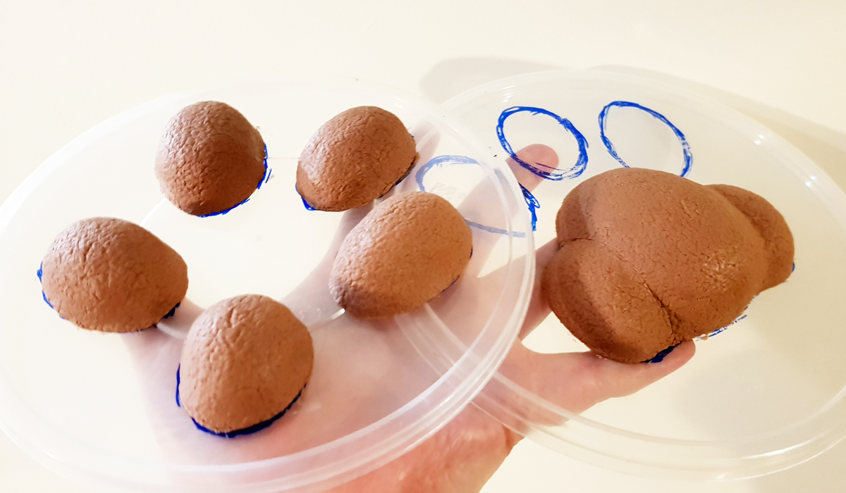

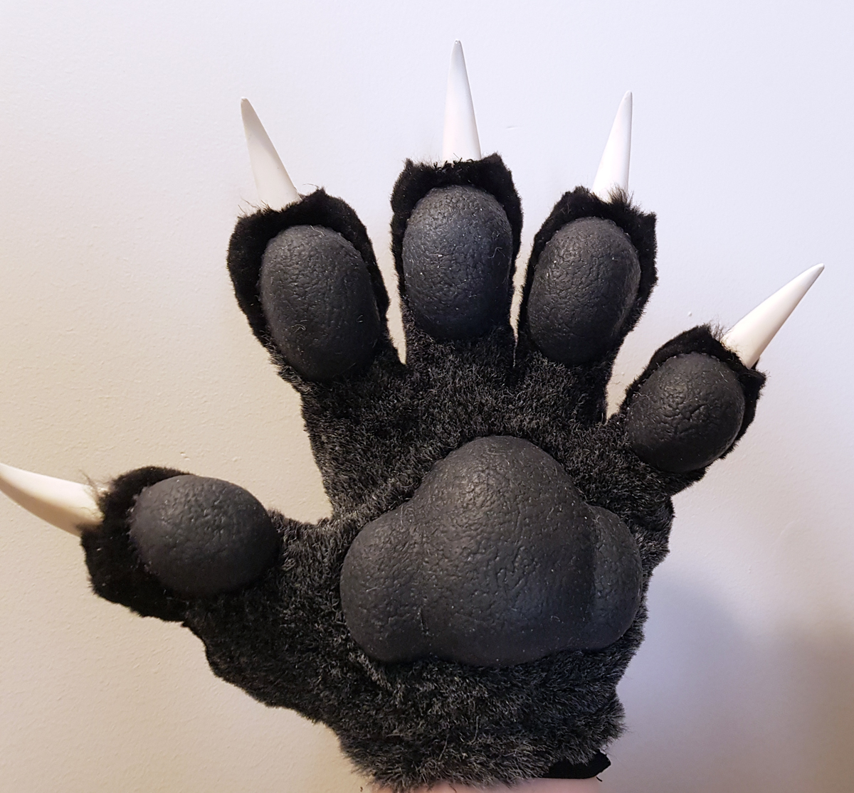

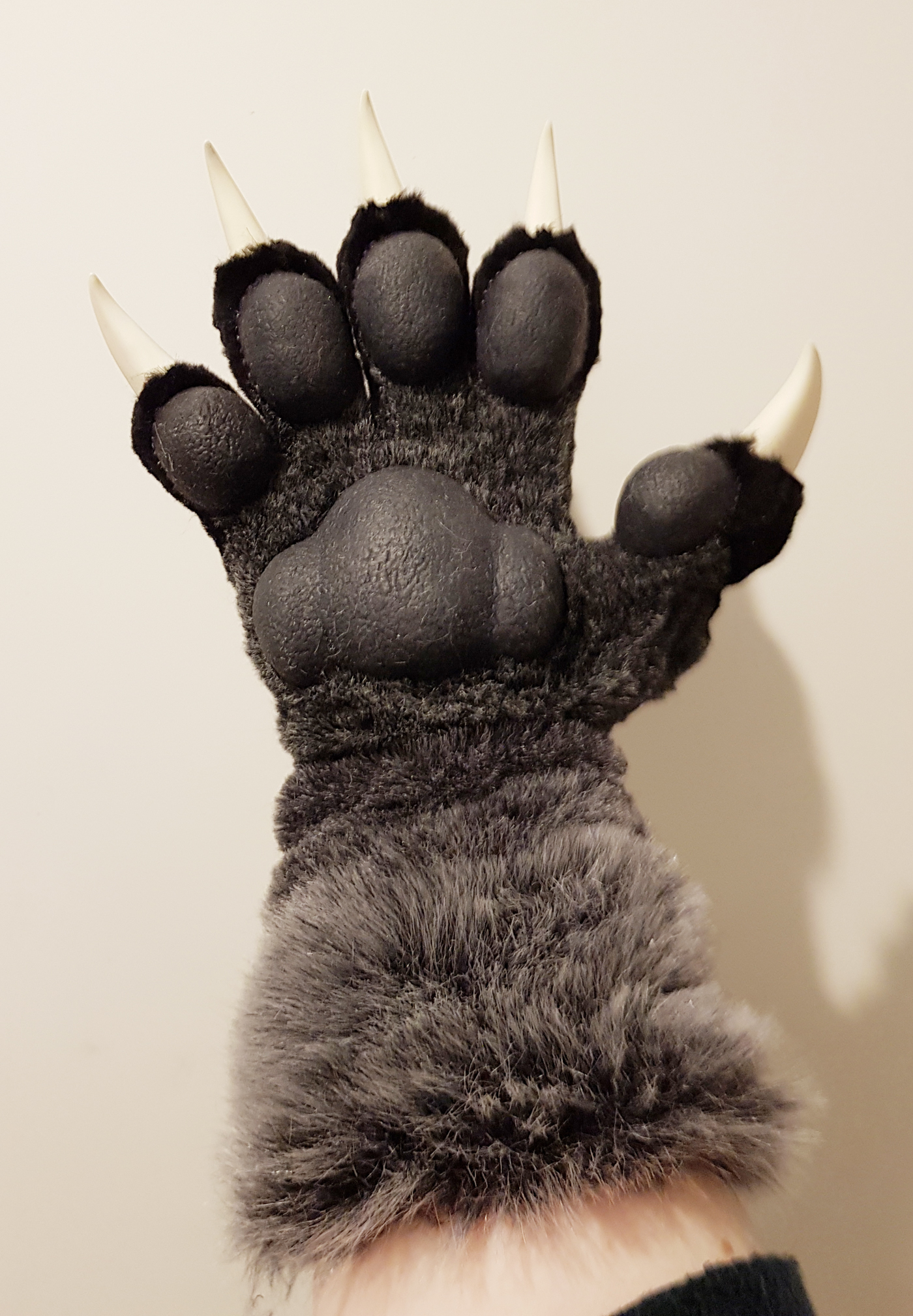

Next, pads. Now I could have tried to find some for sale, but again I am insane so I decided I wanted to sculpt, mould and cast my own. So I did. Monster clay, shell shock backed with hydrocal for the moulds and cast in black-tinted dragonskin silicone backed with fabric for ease of sewing and gluing.
Then, sewed 'em on. Bit of touch-up gluing around the fingers and to help keep the skin down in between the knuckles and such, and they look pretty good.

To finish for now, I just added a wrist piece to each one and shaved a gradient into it so it'll marry well with the eventual sleeves. They'll get airbrushing later on with the rest of the pieces.
Not too shabby, I think. Tested them out last halloween. They're clunky to use as hands but I managed to use a computer mouse with them and write very, very badly. Very fun :p

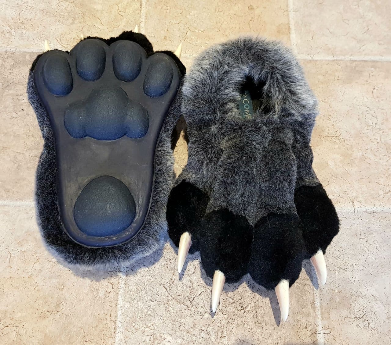

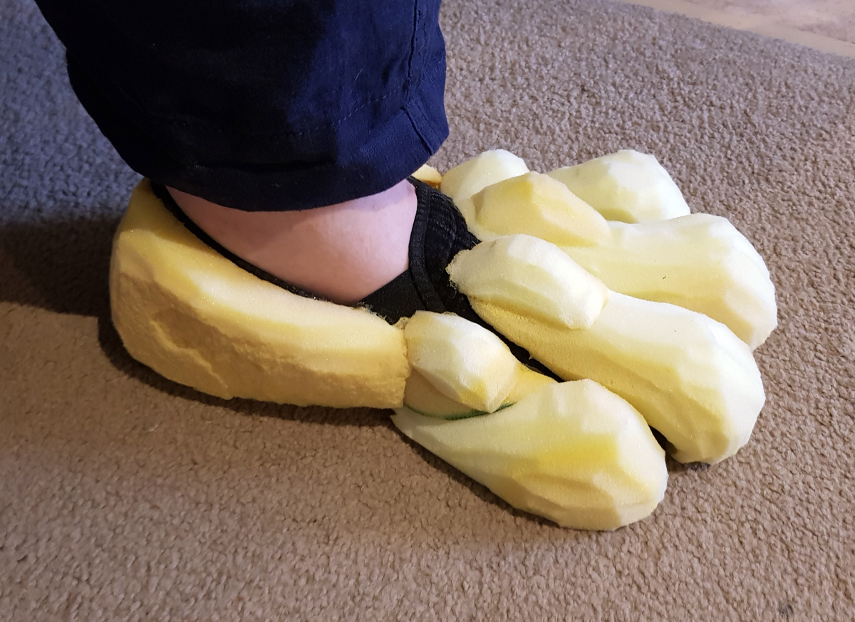

Steve's feet I built on slippers because ain't nobody got time for uncomfortable feet. The foam's rough as heck like with most of this suit (again, because it's for me) but it works.

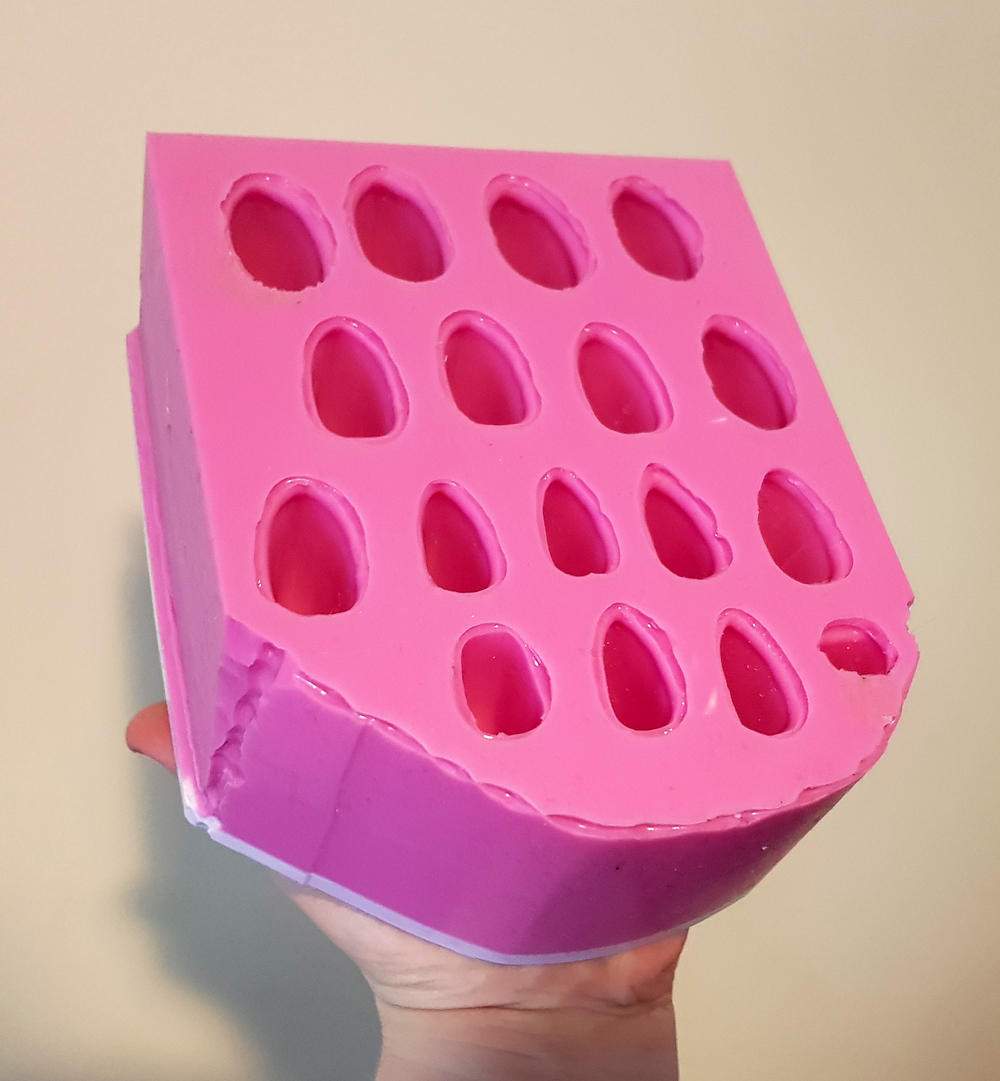

Forgot to mention them before, but I made all the claws for this build too, since I couldn't find any for sale in the shape I wanted. I made three sizes and did a giant mould that has sets of five along with a couple of bonus ones so I could cast quickly:
ANYWAY, back to feet. Covered with the fur, which I patterned similarly to the hands, and popped the claws in. Shaved after, same method as the hands and all.
Course, I also wanted pads for these, but I didn't want to fur the bottoms and have them be unwearable and gross on grass and stuff, so I... uh... sculpted entire soles with pads for the stupid things, and cast in the same silicone with a higher shore hardness. These things are DURABLE. Noice.
They're a little bouncy to wear but a lot more comfortable than they probably should be. As with the hands, they'll get airbrushing at the end to bring everything together.
