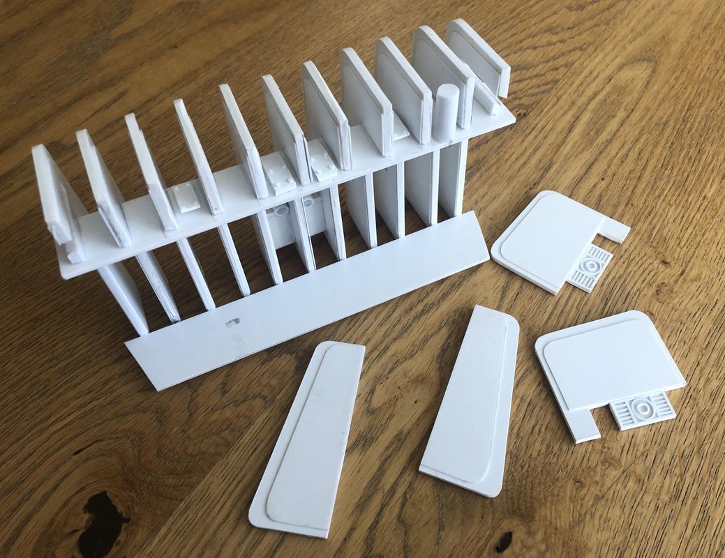

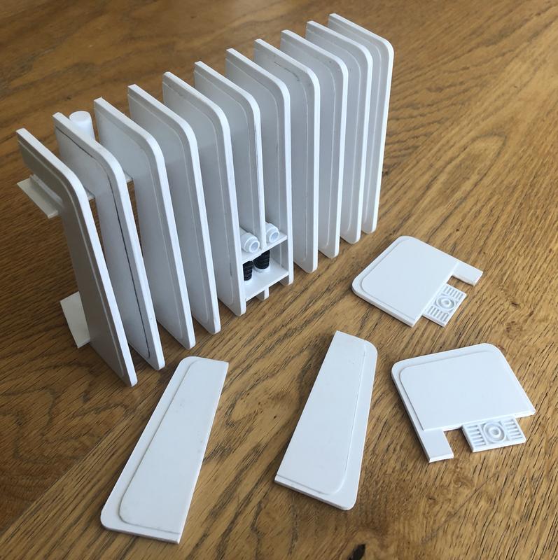

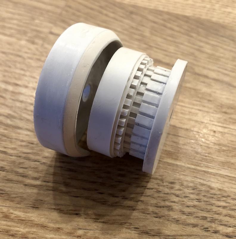

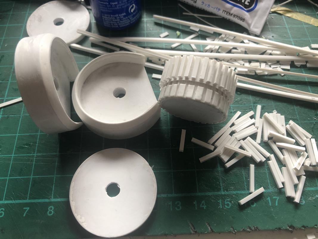

I have rebuilt the diffusors with 3mm styrene sheets.

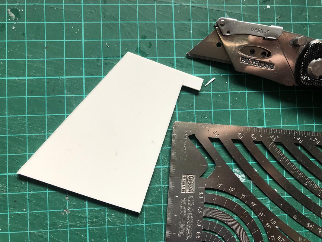

Speaking of , I’ve had difficulty when cutting out (multiple) identical shapes i.e, vertical support pylons for my Deago MF build - out of 1.5mm styrene sheet with a steel ruler and hobby knife/scalpel.
Could you please share what method/s and tools you’re using to cut multiples so consistently like the diffusers above , especially considering they’re cut from 3mm styrene sheet !?

Thanks a lot Ged, this is very friendly of you!
I have attached a picture of the knife and metal ruler (Hasegawa) I always use, nothing else.
For the diffuser I am cutting out as many angular plastic sheets as I need. They have all identical shape and measurements. After this I have used sandpaper (400) and dragged each angular sheet with the edge over the sandpaper and turned it at the same time around to get the round shape. Than I am holding them beside each other to see if they look the same. If not I repeat the dragging over the sandpaper.
I hope this helps. Good luck!
Mark

The beauty nail file can work as well, especially when the styrene is thin. However I recommend sandpaper, something between 400 and 800 strength, just try it.
Regarding the knife it should be definitely a heavier one. The blades can be changed easily and if they are fresh they are sharp enough to cut also smaller parts.
