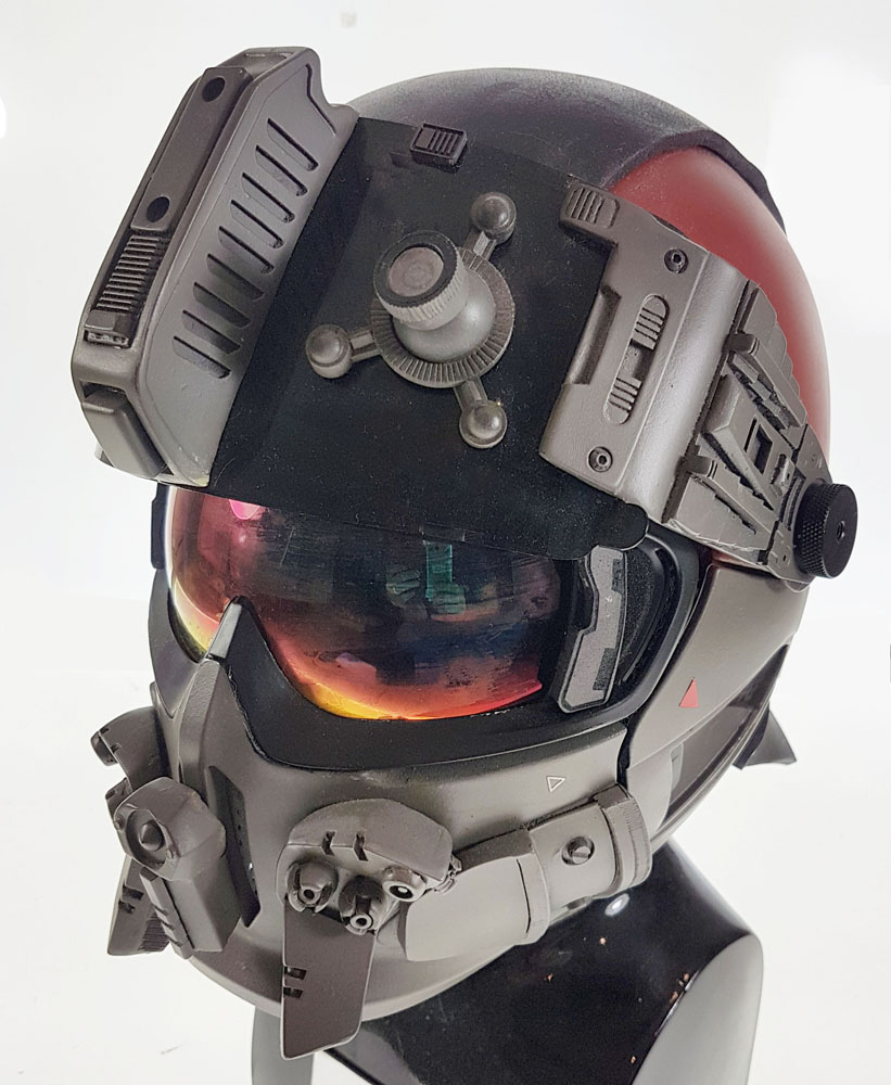

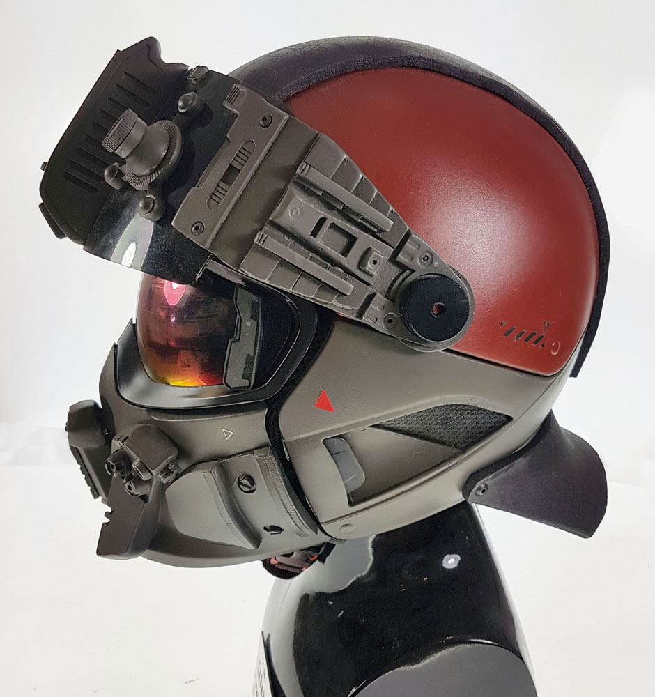

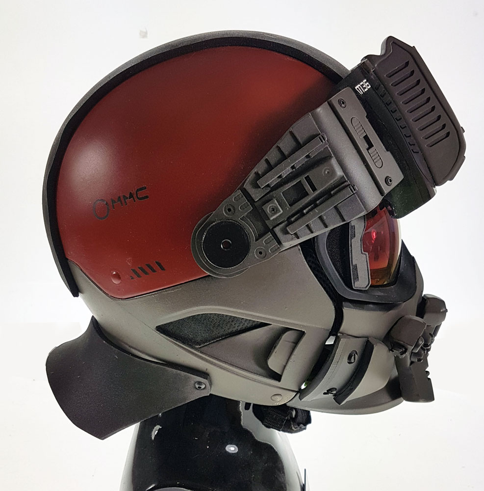

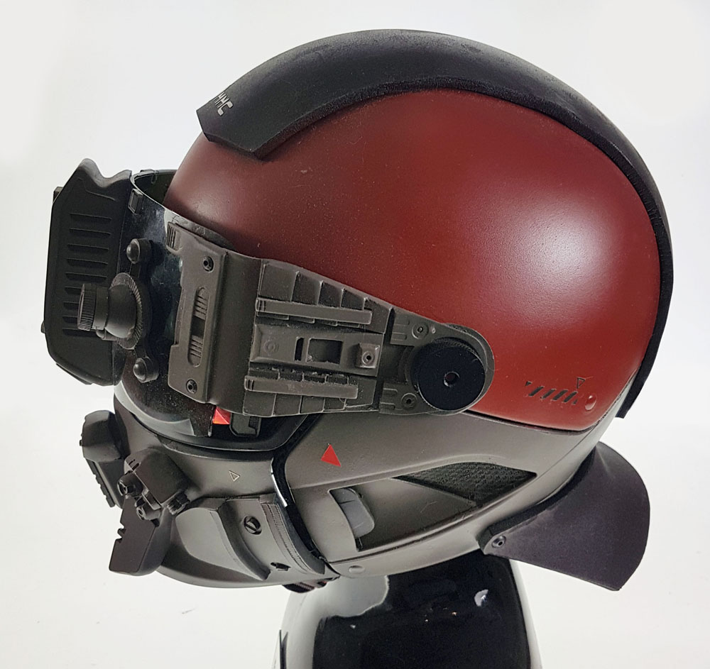

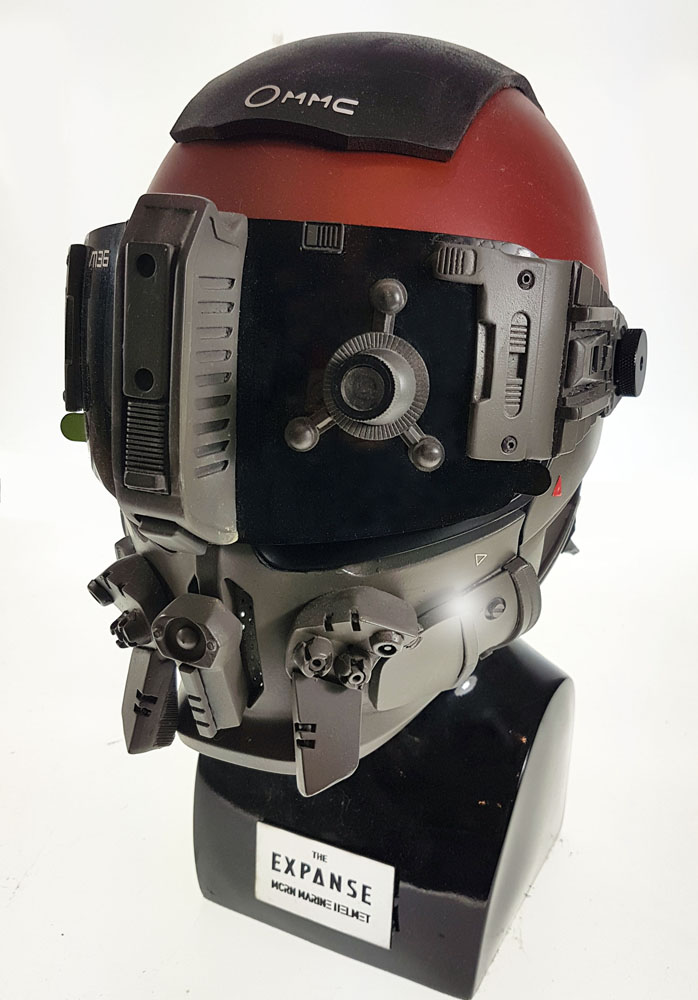

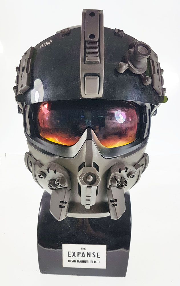

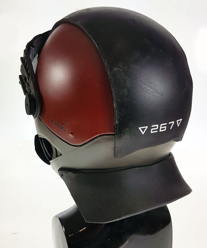

First is the MCRN Marine Helmet:
This is the Season 1 version, which is better. They apparently decided it didn't show enough of the actor's face, so it was re-designed with a full face plate, which is a bit rubbish, imho, but since they continued with the originals in S2 as well, in universe the second version comes across like a pilot version, since it's mostly seen in cockpit scenes. Anyway, I'm rambling.
The base is a Ruroc snowboard helmet:
The visor on my replica, and the original, is a welding eye screen. Thanks to the guys at the MCRN Costuming Facebook group, who contacted Walterklasson Studios, who created the helmets, in order to get the right model.
The visor connector wheels are camera tripod thumbscrews. Pretty much everything else is scratch-build. There is a red LED strip inside, but I found it pretty ineffectual at illuminating the goggles, so it isn't switched on in these pics.

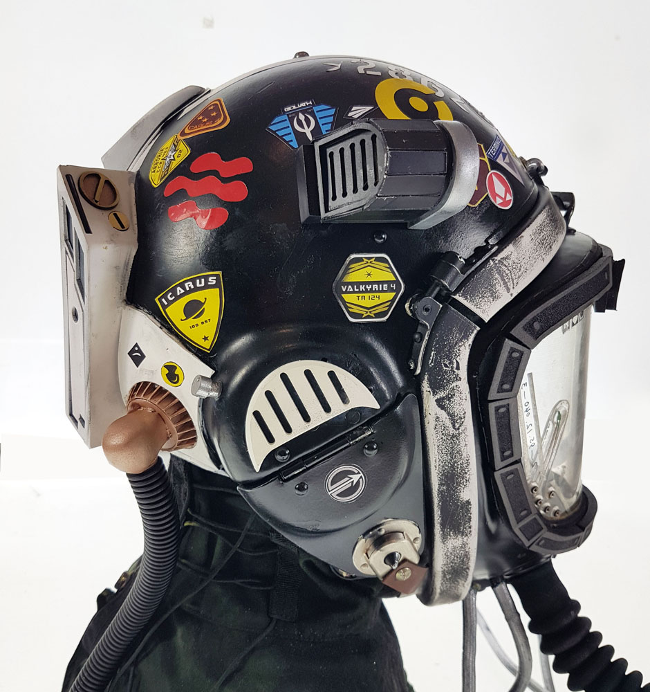

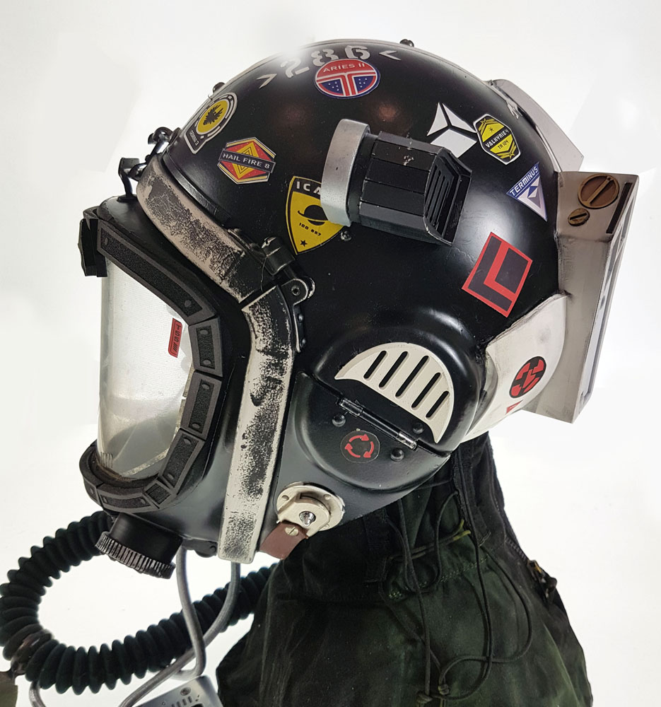

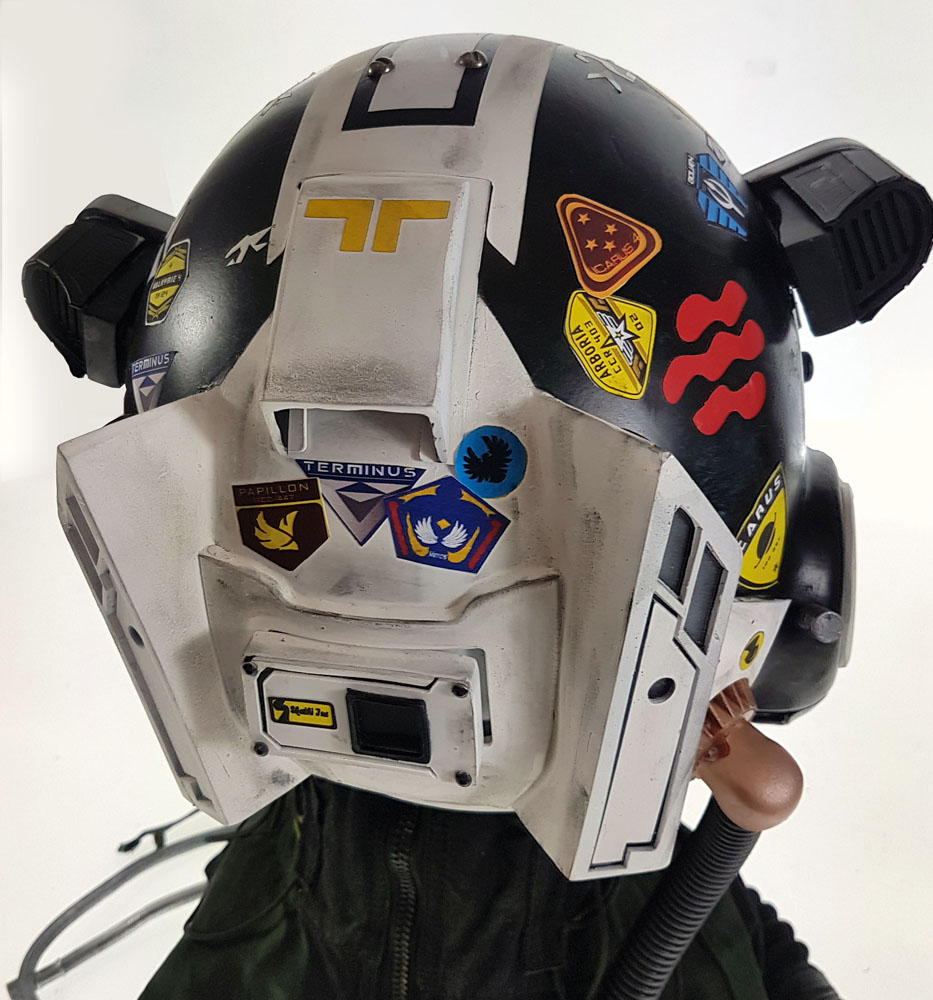

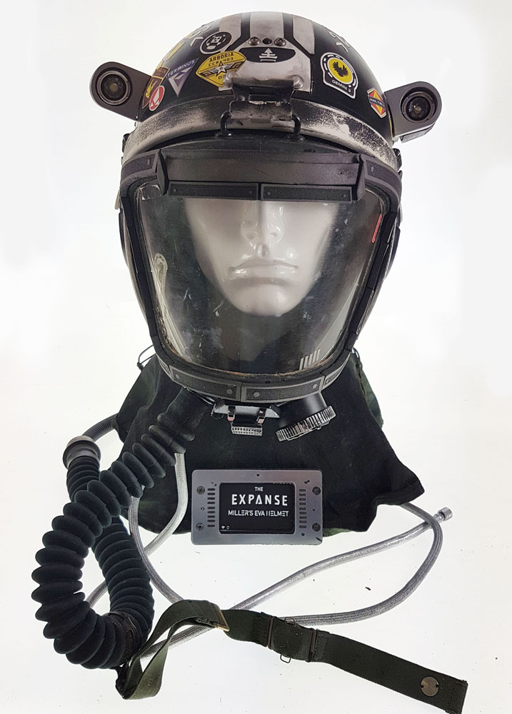

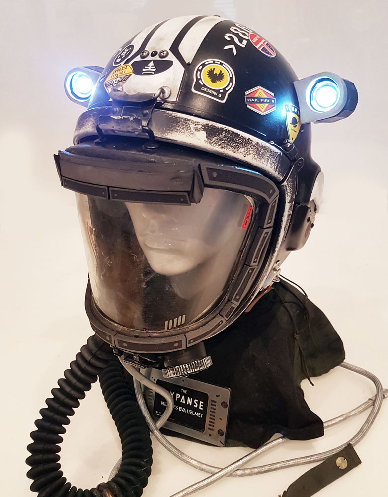

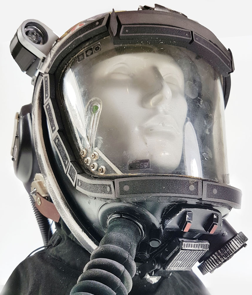

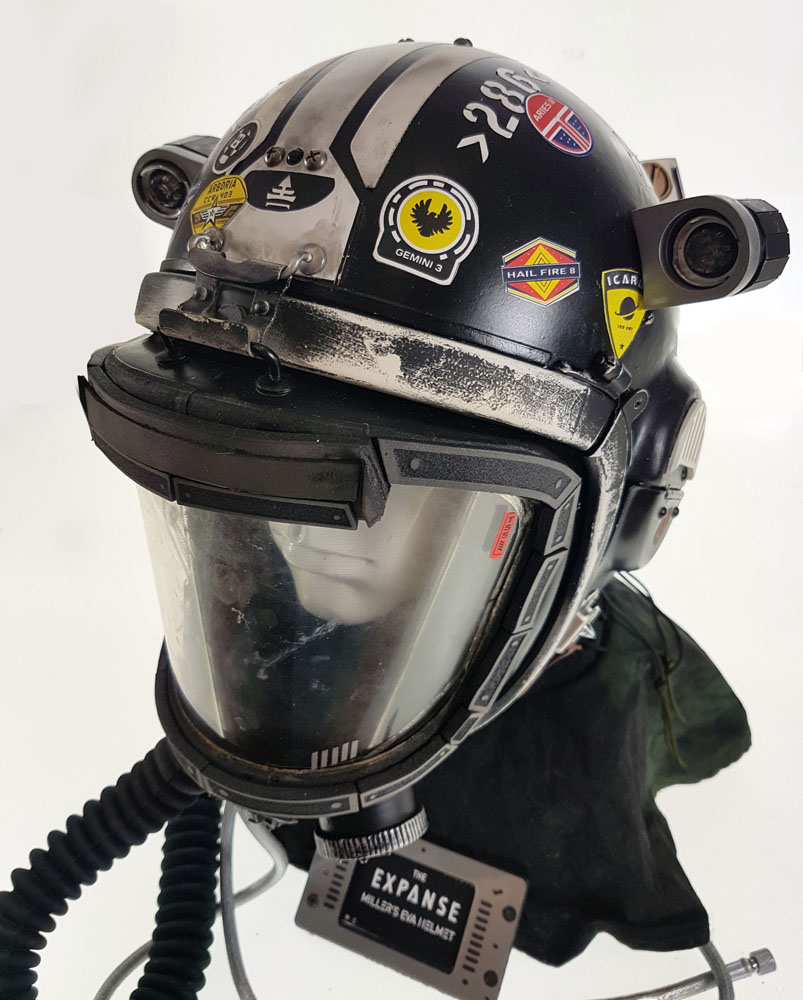

This one was pretty fun.
Miller's Belter space helmet from the end of the 'Leviathan Wakes' plotline in S2.

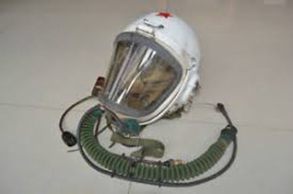

The base is a Chinese Mig high altitude helmet, as with all the S2 belter helmets. Like this, only not in crappy resolution:
So, just as I started working on this, my laser tube crapped out AGAIN! The upside of this, was that it gave me plenty of time at the computer creating the seemingly endless stickers on Miller's helmet in Illustrator. I screen-capped the hell out the bluray episodes the suit appears in, but it was still a best-guess at many of the graphics. The lights are a pair of led cycle lamps in a custom shell. I made a display placque based on the malfunctioning bomb panel, and there you have it. The end!
Really, that's it. Go home.

That is beautiful. Is there any "surgery" that needs done to the high altitude helmet, or is just add ons essentially?
It's pretty much strip down then add-on. I guess with the amount they had to produce, that makes sense, though the detailing varies from helmet to helmet. I tried dyeing the material part, but couldn't get the dye to take, so I just lightly sprayed it with matt black paint, which worked fine.
Would you be willing to share how you made the visor trim?
Yeah, I used laser-cut and engraved 4mm EVA foam. I played around with painting it, but eventually the original colour (sold as black, actually grey) worked best. Each segment is individually cut and then glued on. The large section at the top was made from multiple pieces, layered and glued together.
