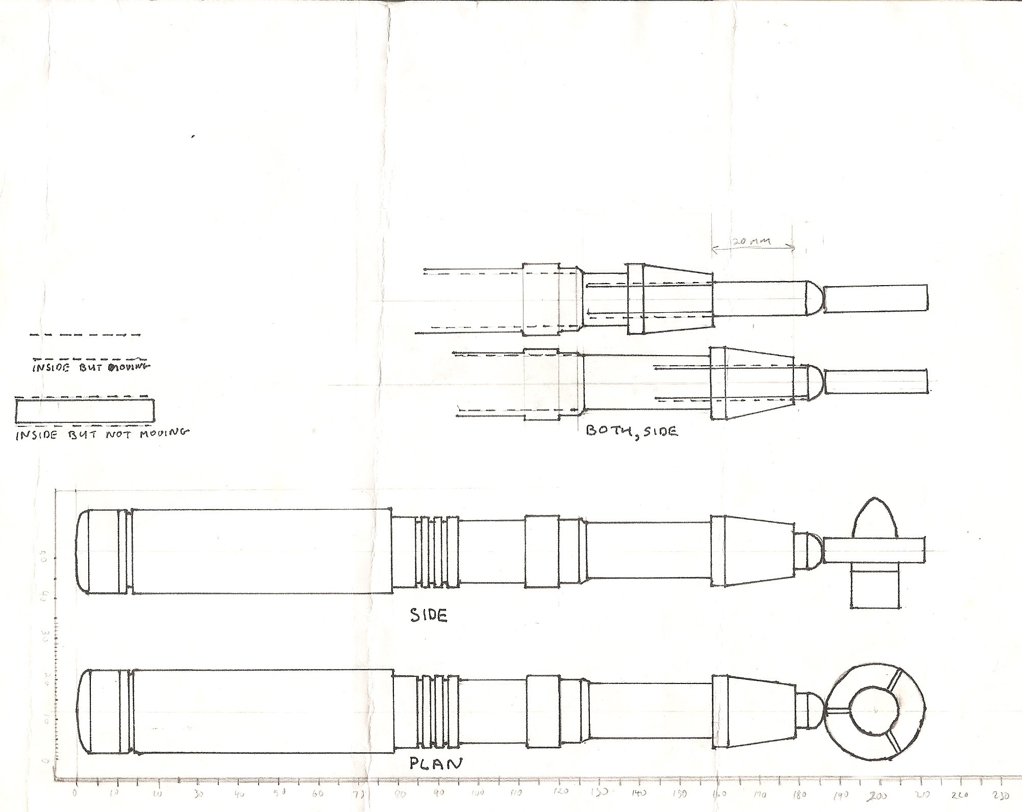

I did what I believe to be a reasonably accurate scale drawing of the 4th Doctor's sonic screwdriver. I jives pretty well with the Character Options one that is/was available through the BBC. I can scan it for you if you are interested, just let me know.
Don
Hi Don, yes I'm definitely interested, thanks!
Jamesbeat,

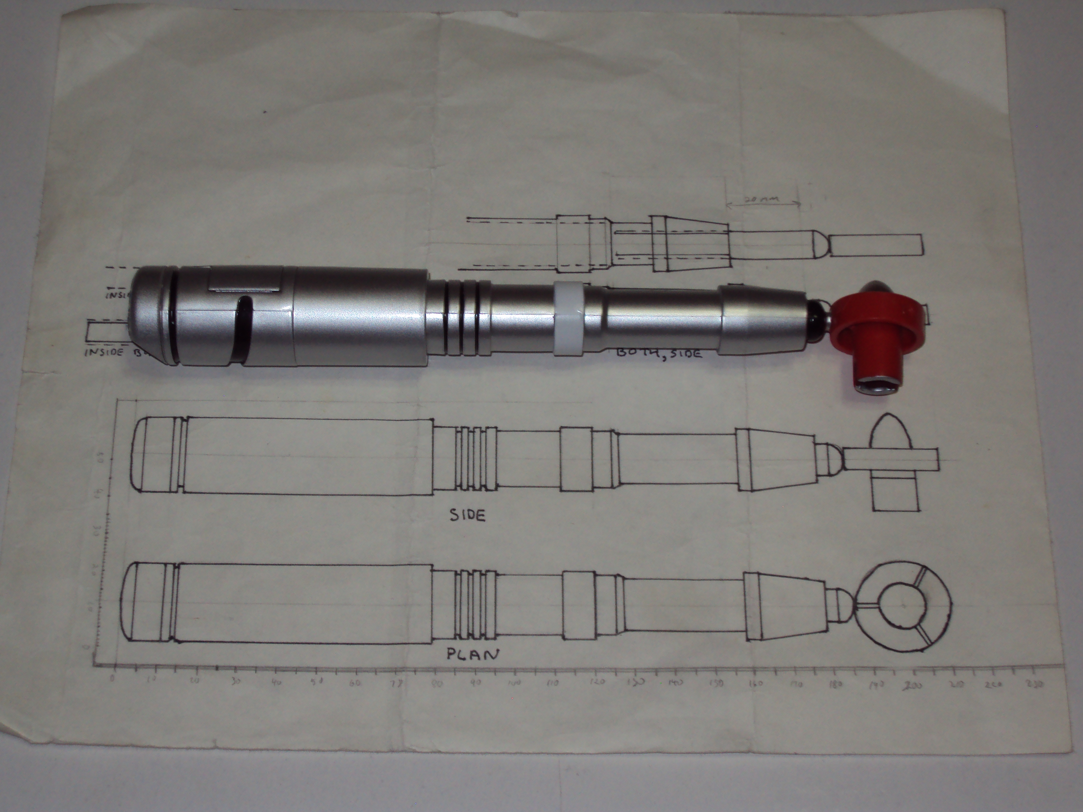

A small disclaimer here, I did the drawing about twenty years ago. I still believe it is a good basis from which to start. I had originally planned to have it made out of aluminium with a spring action, never quite worked out how I could work in the sound though. The second image is of the 5th Doctor's sonic screwdriver and the main differences are easy to spot. Baker's sonic screwdriver did not have any coloured bands on it. I hope this help you.

Don, those drawings are great, thanks so much!

Your drawings appear to have a thinner handle, much more like I expected it to be.
Your drawings look a lot like the Russrep version, but I have seen a lot of posts by people saying that the sixteen 12 version is more accurate than the Russrep.

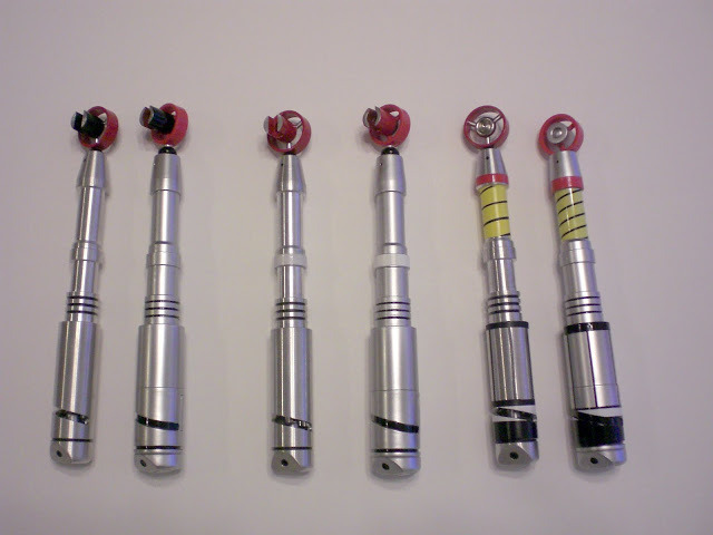

The CO toys handles are fatter, this is a pic of them compared to the Russ Rep sonic's.

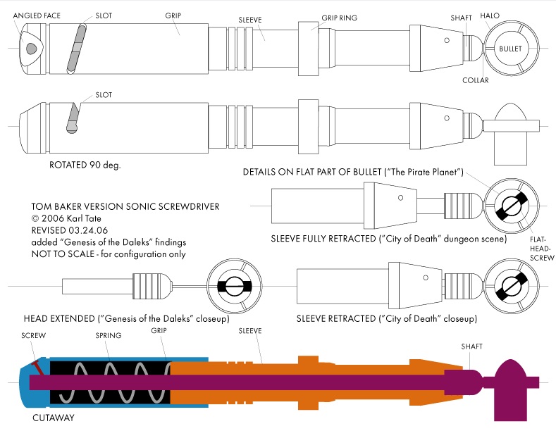

These are some plans I started going by from the tardis builders that I liked overall but then I thought the activation ring looked a bit wide so was going to go back and adjust some things.

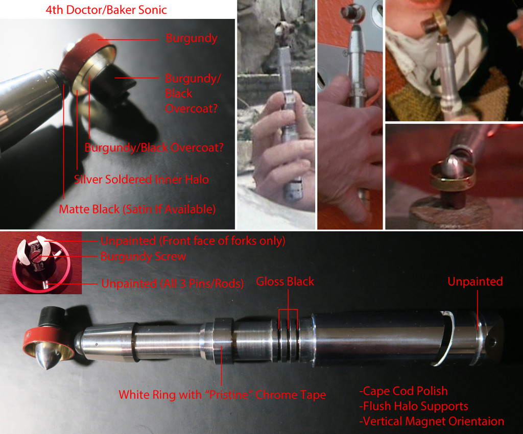

And though it doesn't look as pronounced as Davidson's as it looks repainted the band/ring on Bakers does seem to be chipping away to a degree with some color variation there, this is a color where I was trying to figure out the classic color's for a run that's going on on them. Thanks to Terrasolo for some really good references and back and forth!
The 'toy' sonic screwdrivers are too fat. That is so they can cram in the batteries, electronics and speakers to allow for the sound. It is like the original Star Wars toy light sabers, they were too big because that was the size needed to accommodate the plastic blade inserts. Neither of these, the screwdriver or the saber, were meant to anything more than a reasonable likeness of the original. They were marketed as toys, very nice toys, but toys none the less.

Thanks for those plans, I've seen them before.
They are actually what I based my first build on, and I agree about the activation ring being too wide.
I changed that and a couple of other things, but I don't feel like I have quite got it right yet, hence this thread.

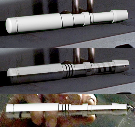

Not really in "plan" form yet but I started trying to model it based off the Thunderbirds screencap, overlayed it and compared it to the other just to see how it held up. Only a WIP trying to get the proportions right at the moment but I don't think it's TOO far off. Where the "activation ring' on the old plans above appeared to large it seems to me to just be the same size as the lower collar with the grooves but I'm not for certain what the right size is. I've seen right around 8" suggested and I guess that's pretty close to the CO version.
