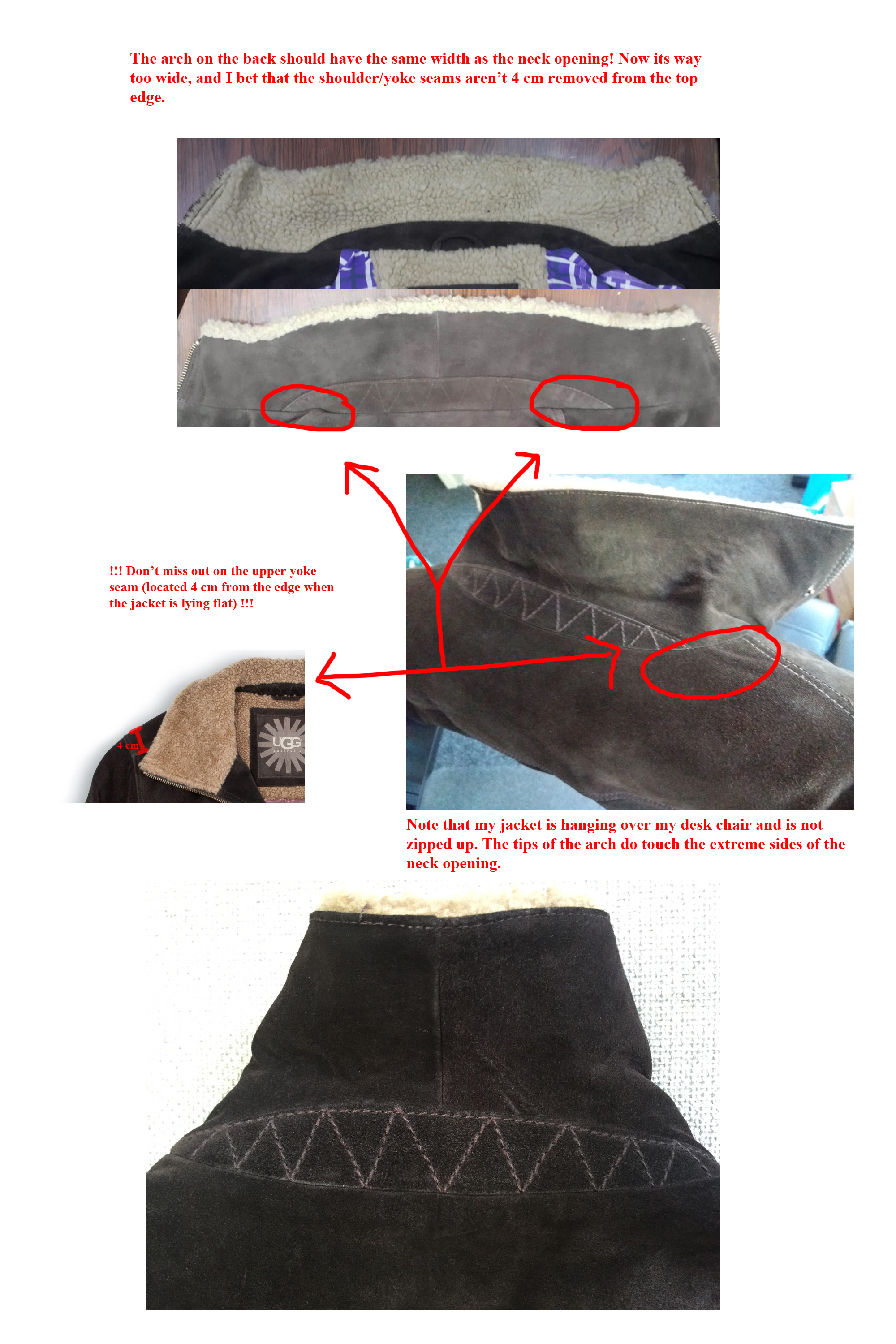

Ok, I've had another more sober and critical look at it and although the experiment with the collar looks pretty promising, there are a few things that aren't right and that causes me some worry overall (to say the least).
1) The arch on the back of the neck is way too wide (also the curve is kinda meh in that picture, but that may be a bit skewed, because the jacket is lying flat). It should be the same width as the neck opening and basically cover only the back of the neck (not the front). As you can see the tips of the arch extend well over the yoke/shoulder seam, which also brings me to point 2:
2) The yoke/shoulder seam looks like it's not located 4 cm lower from the top edge (if you lay the jacket flat). A quick look would suggest that the tips of the arch and the yoke/shoulder seam should swap their respective locations.
But, what worries me the most is that pretty much everything (read again: EVERYTHING) has been documented fully with pics, texts and measurements for both L and XL and STILL glaring errors in the design remain. I don't know if it's because there's some standard template for jackets that's being used or that for specific parts measurements of the XL are used for a size S making the whole thing skewed or something else...
I'm sorry to point it out, but to those who do the design and/or those who actually produce the jacket: read. the. - fill in for yourself - . documents. I'd suggest to take the measurements from either the L or XL in the documents literally and actually draw it into the model of the jacket on a piece of paper/cloth or what not and the design with its typical features should flow from there. Look at the pictures and other info that's provided. If you get that, you see how the pieces fall into place.

I'll check the measurement of the length of this piece (I believe it is 23cm on an original UGG) as well as the placement of the shoulder seams.
That's the thing, it's dependent on what size (S, M, L, XL) the jacket is. It's 23 cm on an L and 24 cm on an XL, both corresponding to the width of the neck opening of 23 cm for an L and 24 cm for an XL.
Razor's photo has been added to our pattern study so the next jacket we made will be updated using this info.
