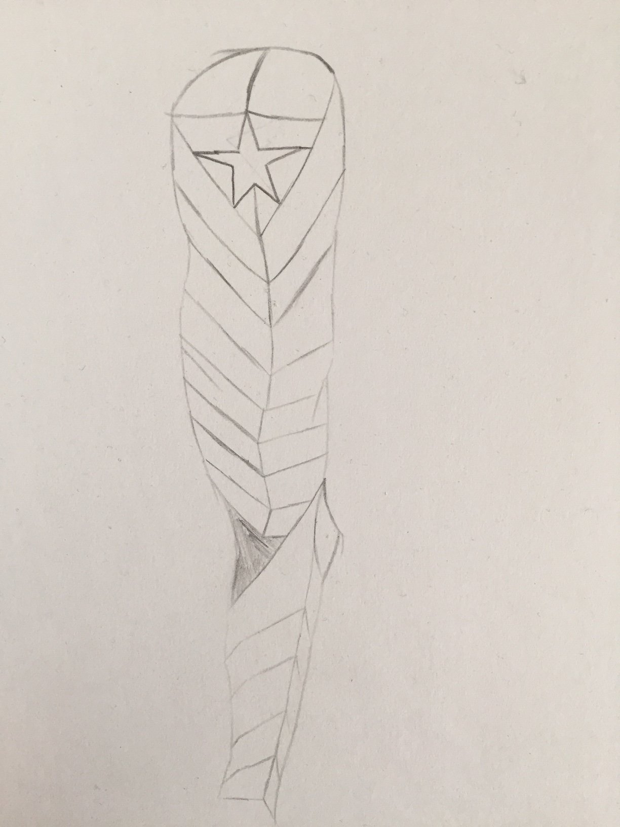

Using different images from online and a black permanent marker I drew the various separations of metal across the template, this gives me the basis of the shapes that will be made on the real arm and makes sure the template is the perfect shape to fit on the actual costume piece

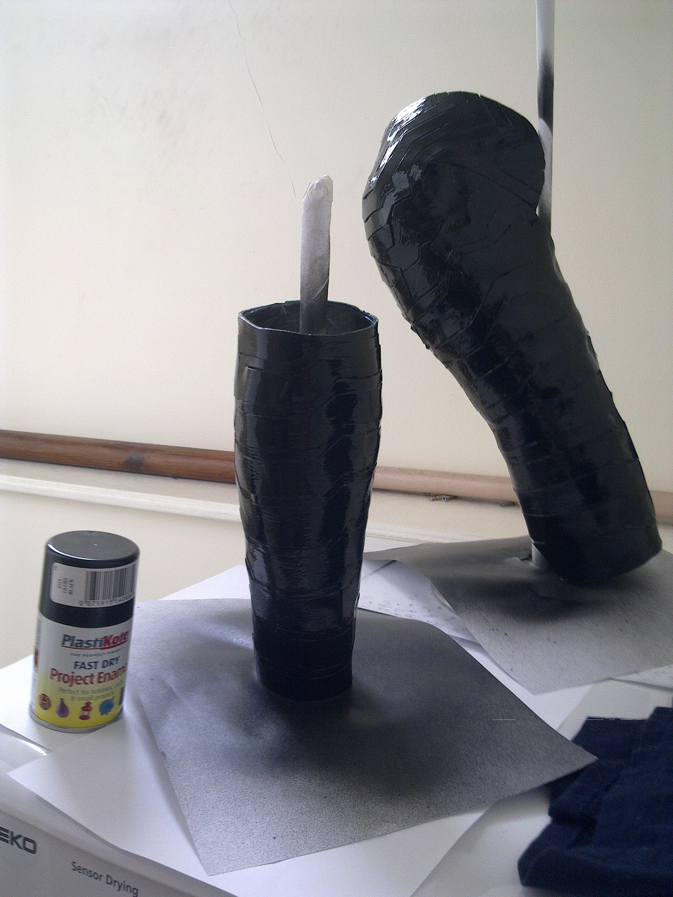

Using a black spray paint, I sprayed all of the arm to cover the colour of the foam.
After this has dried, spray paint all over again using a glossy silver spray paint, metallic effect is the best :)
