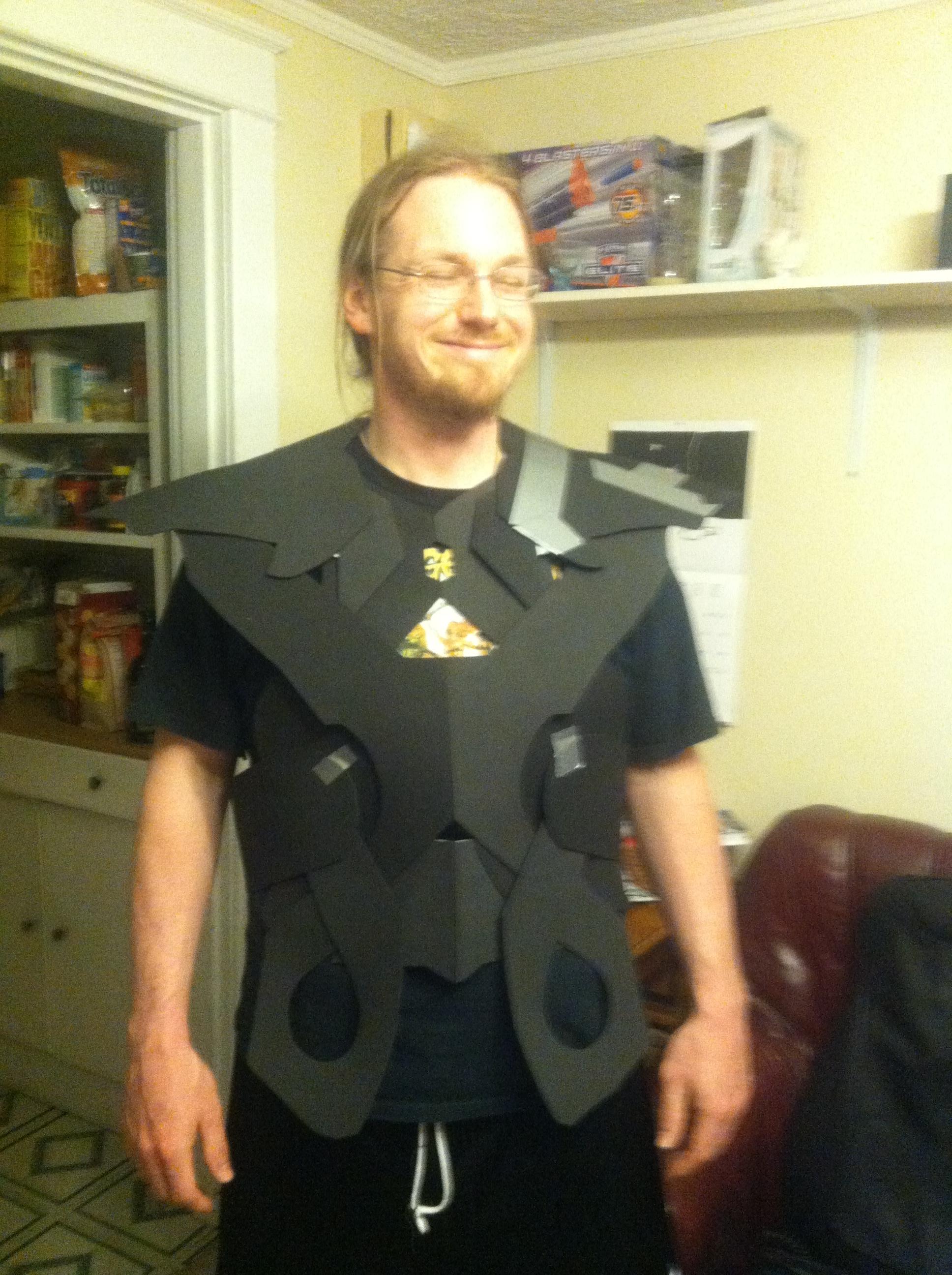

We have been working on this (and going to the gym) since April 2013, but setbacks and real-life jobs get in the way too often! We have assembled the chest armor seen below and found that the torso needs to be shortened to adjust for how much weight he has lost. I'll update more soon.

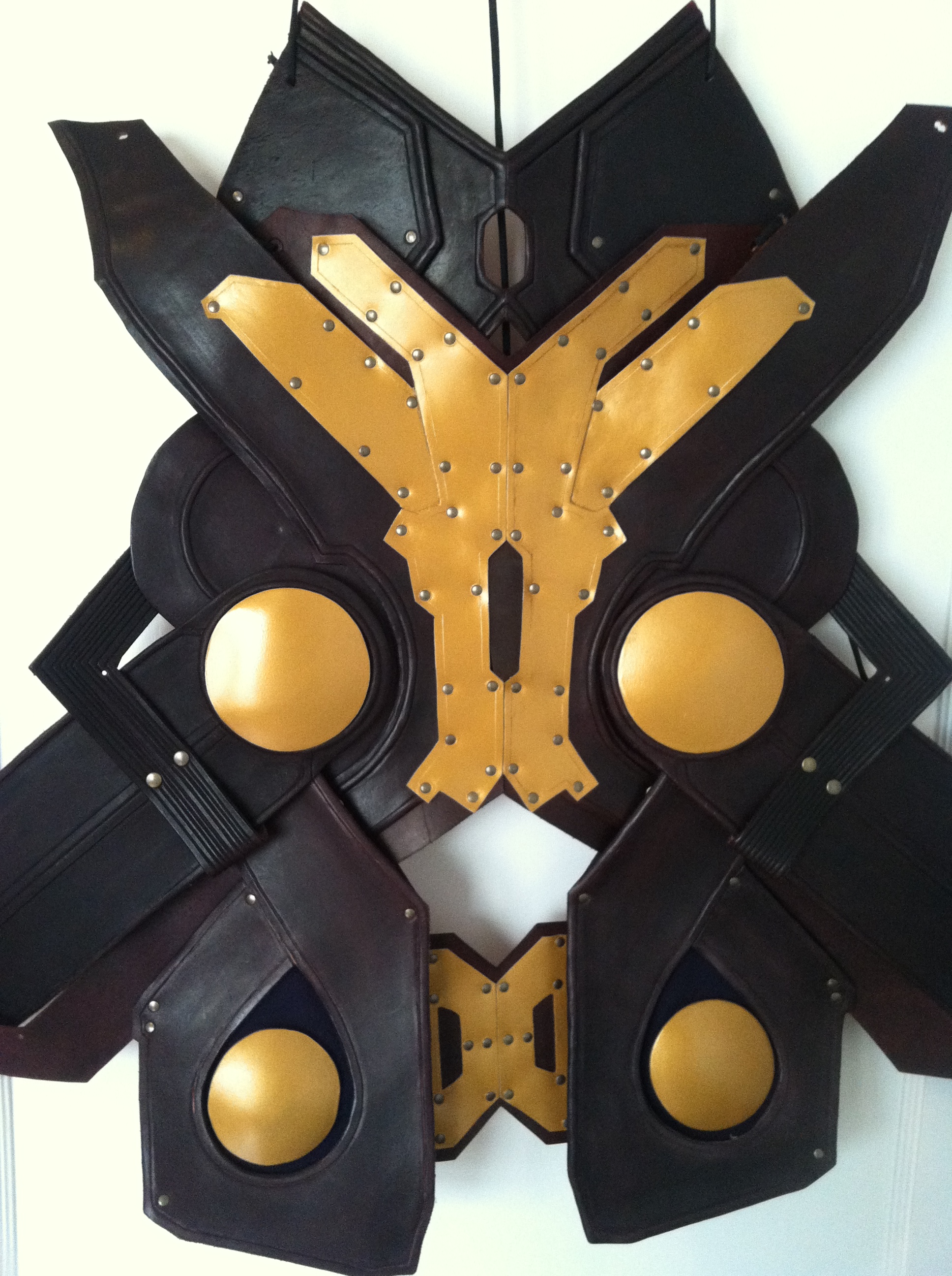

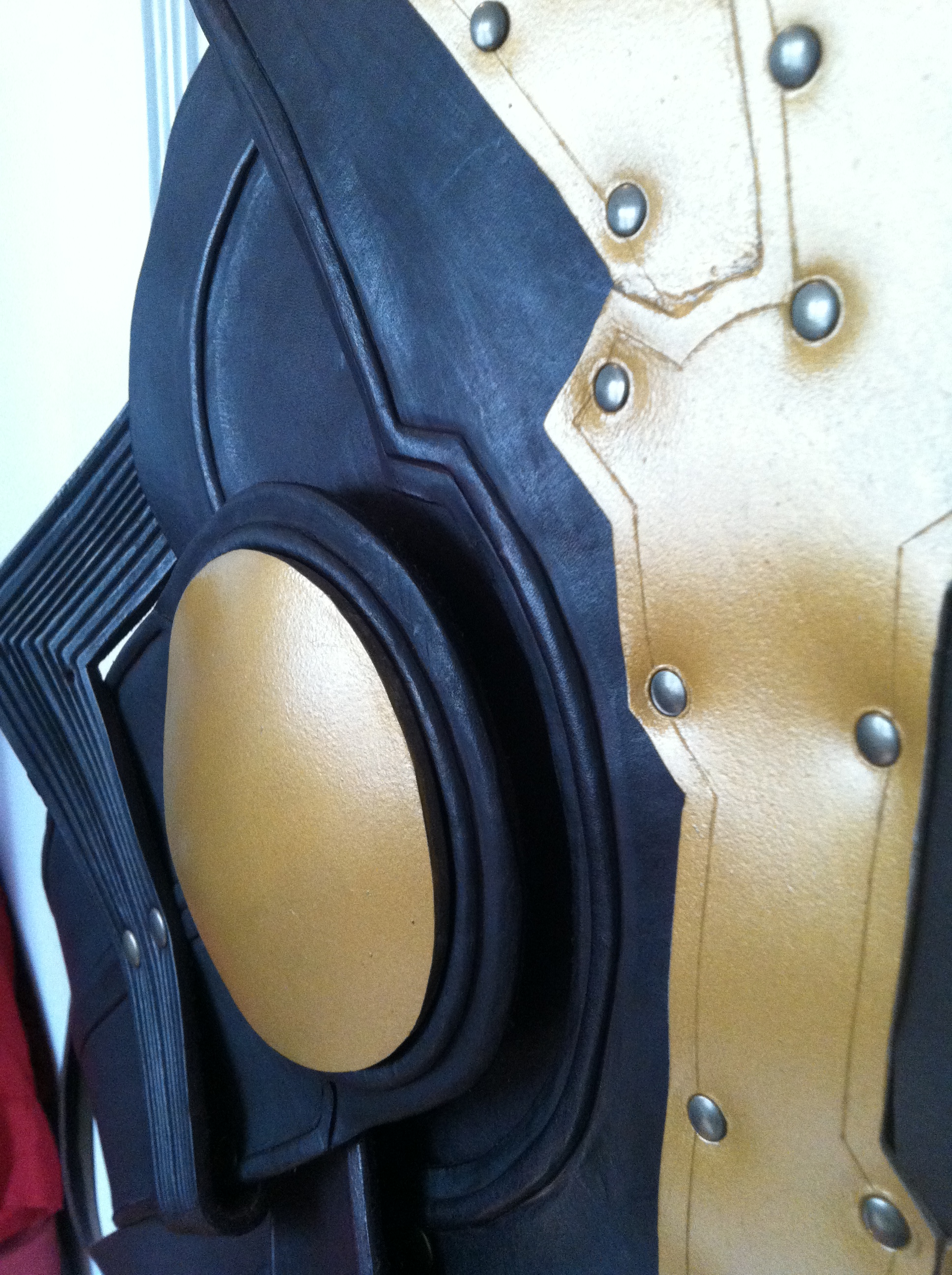

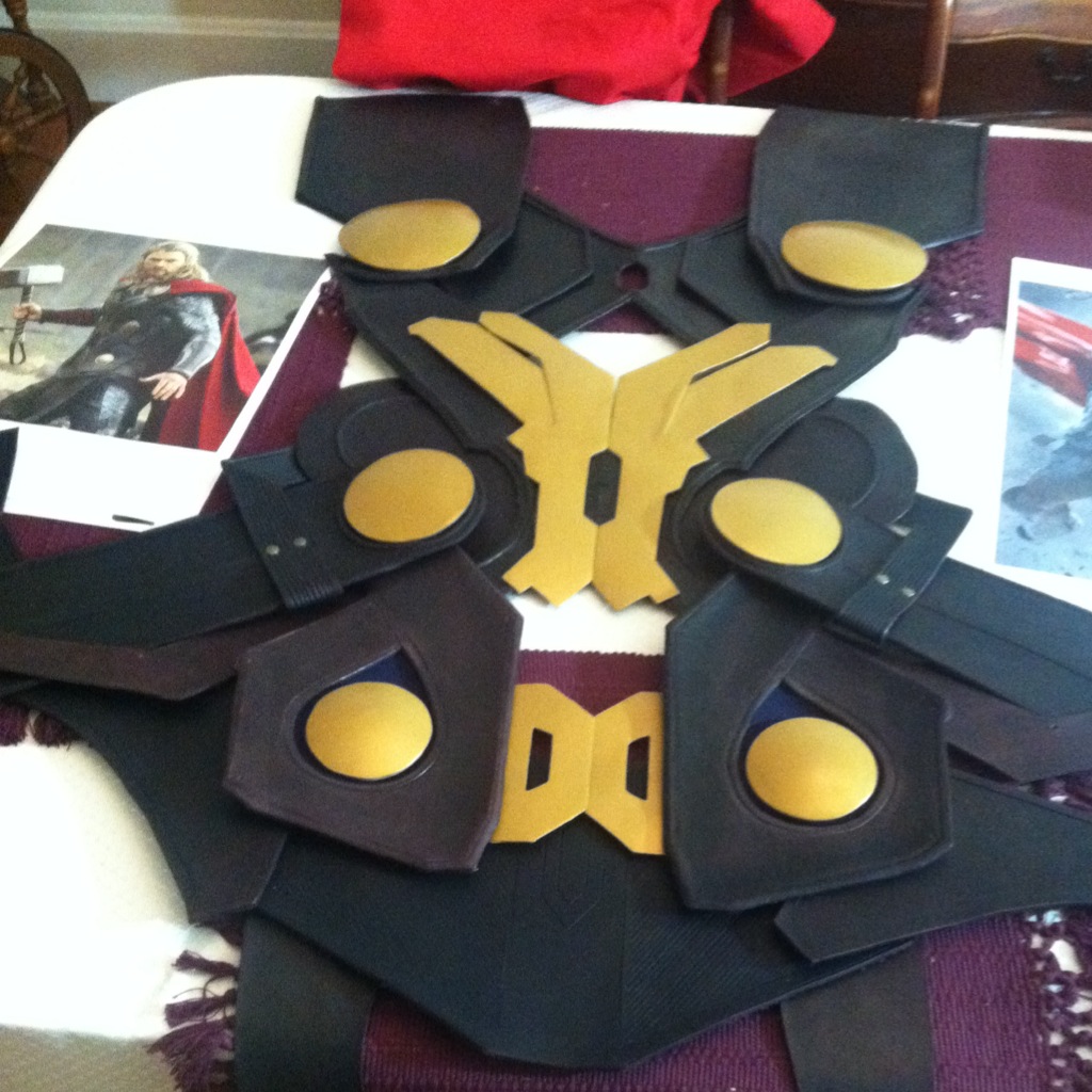

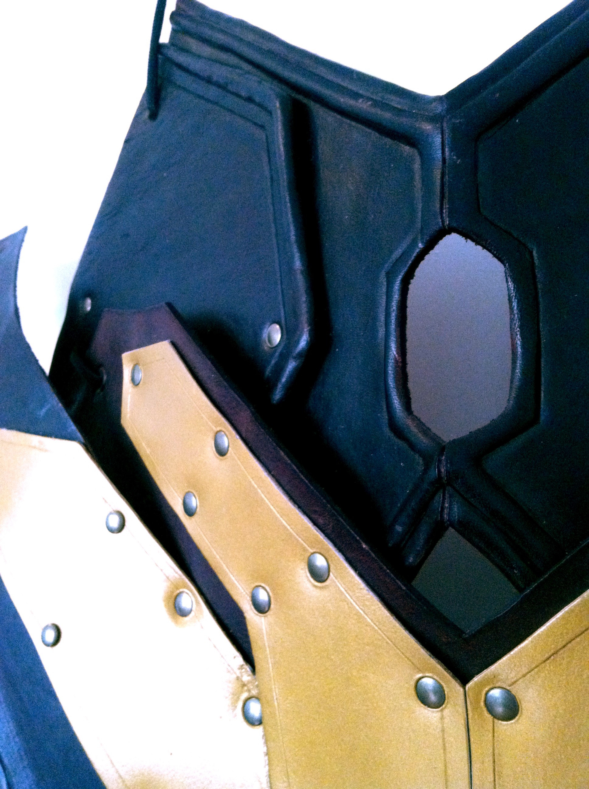

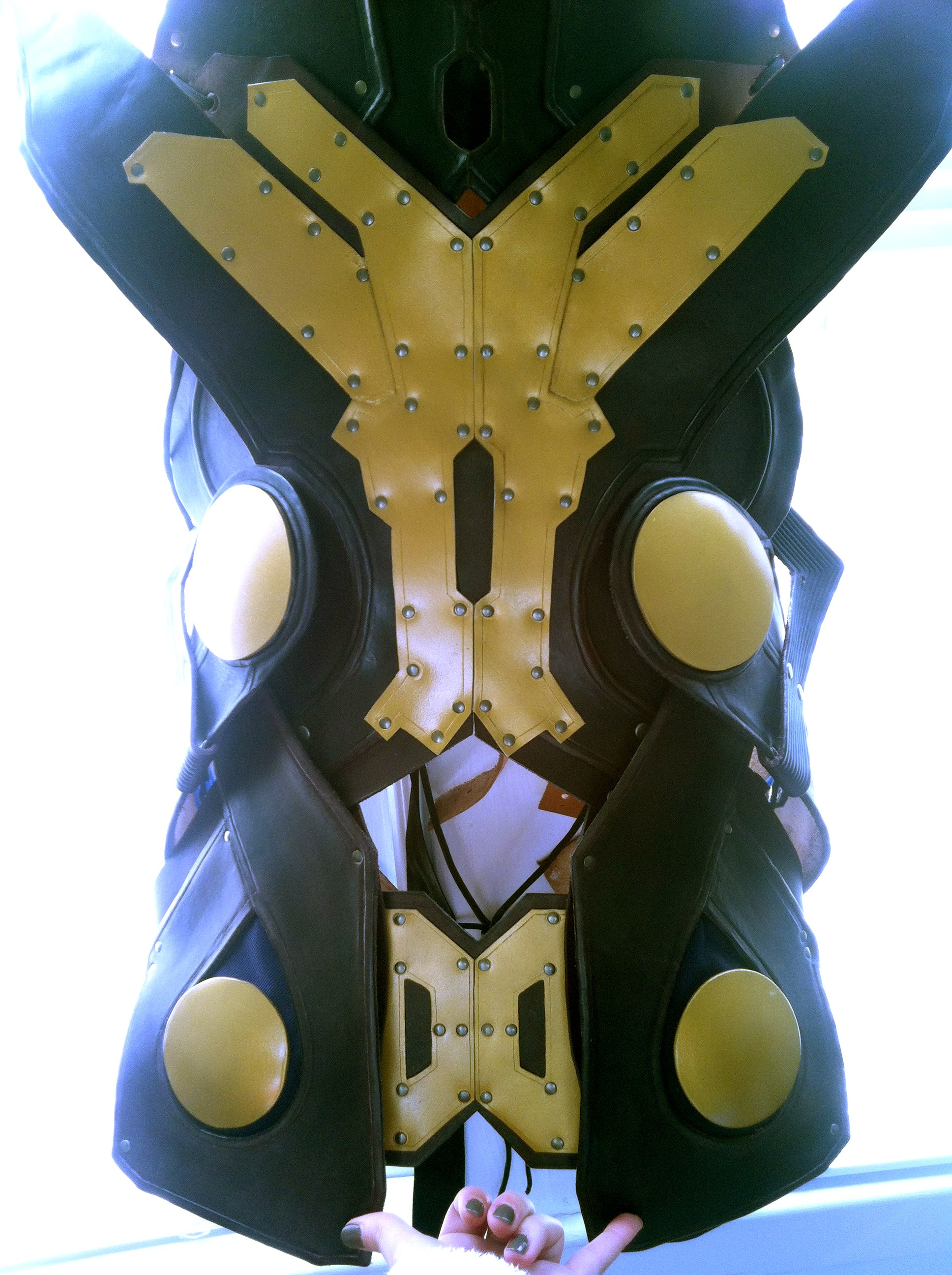

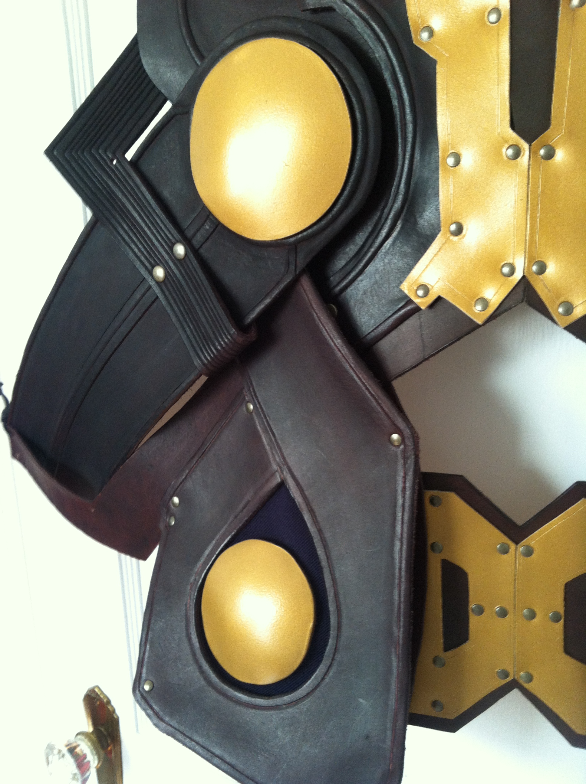

Here are some photos of the assembled chest armor (we chose not to attach "loincloth" pieces directly to the torso assembly). The coloring needs some tweaking; using several different types of leather means they will not all take the EcoFlo dye to the same concentration.

Fiscalia, that is remarkable. Your use of the leather with the other materials is very well done. This is the best Thor:The Dark World armor I've seen yet. Keep up the good work, give us your WIPs when you can, and I look forward to your final costume.
Massively jealous!!! How did you get the patterns on the loin cloth area and with the strapping? I'm planning on a Dark World build as well...but doing it solid black and silver rather than brown and gold...

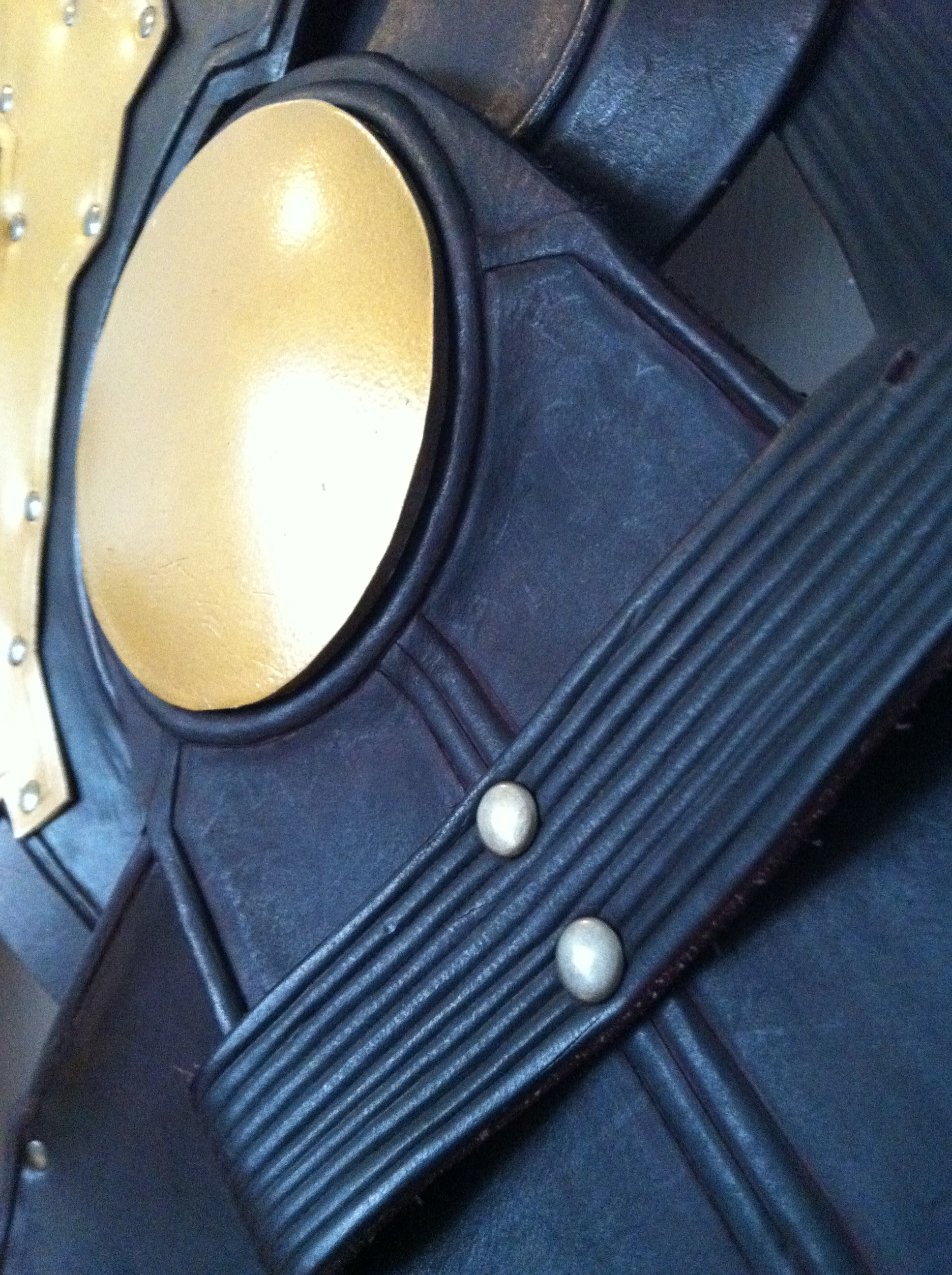

The patterns on the loin cloth area and strapping-bits are just very careful tooling work on the leather! After using a scratch awl to lightly mark the parallel lines on the leather and then swivel knife to engrave the lines deeper, I used this Craftool beveler the "wrong way" - meaning, not as a stamp, which is what it's designed for - but instead to make the etchings appear deeper with a bevel-y rounded-up look (and, oh gosh, so repetitive! my back hurts just remembering the long hours this required!!).​
I'm absolutely positive there's someone more experience with leather out there who will tell me I did it totally the hard way, but... Eh. We did our best!​

The button-things on the gold armor are just super-tiny brass rivets from Tandy! I was going to use painted sewing-pin heads, and just snip off the backs, but then had my "oh, dummy, you're already using rivets everywhere else!" moment....
