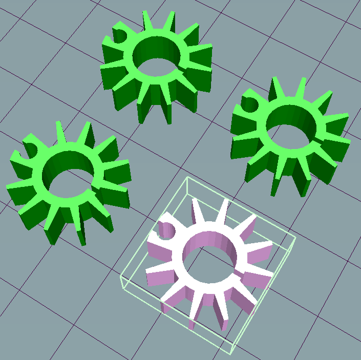

Trying to light x-wing engines. The engine nozzles need a bunch of triangles cut out. What is a good way to do this? Drill corners and carve with xacto knife?
depends on the scale, why not print it/them out :unsure:
