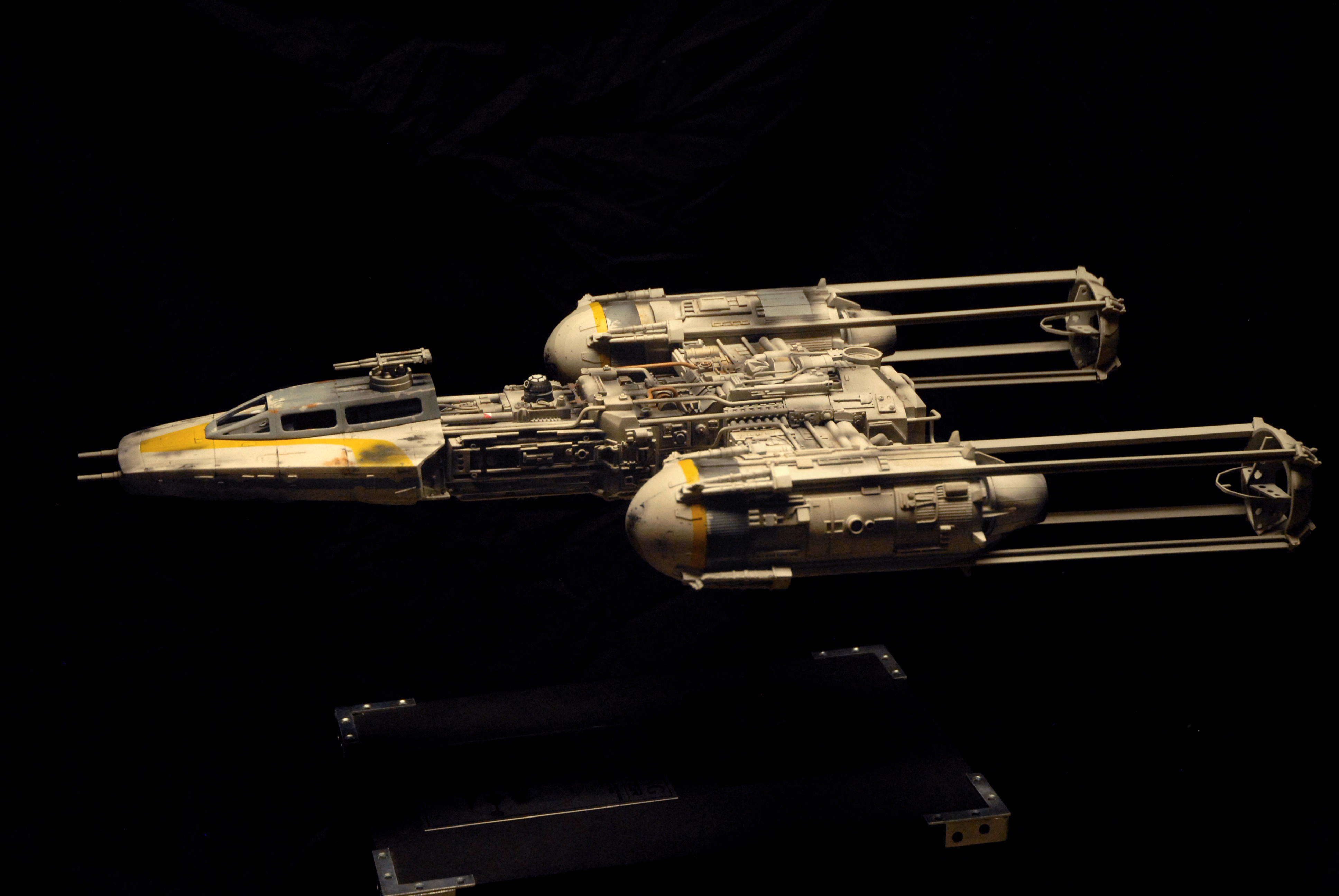

I had a couple of people ask me to post some photos of this build of my Studio Scale Tie Killer Y-Wing. It's a kit from Galactic Resin. It measures in at about 27 inches and has lighting in the cockpit and engines.

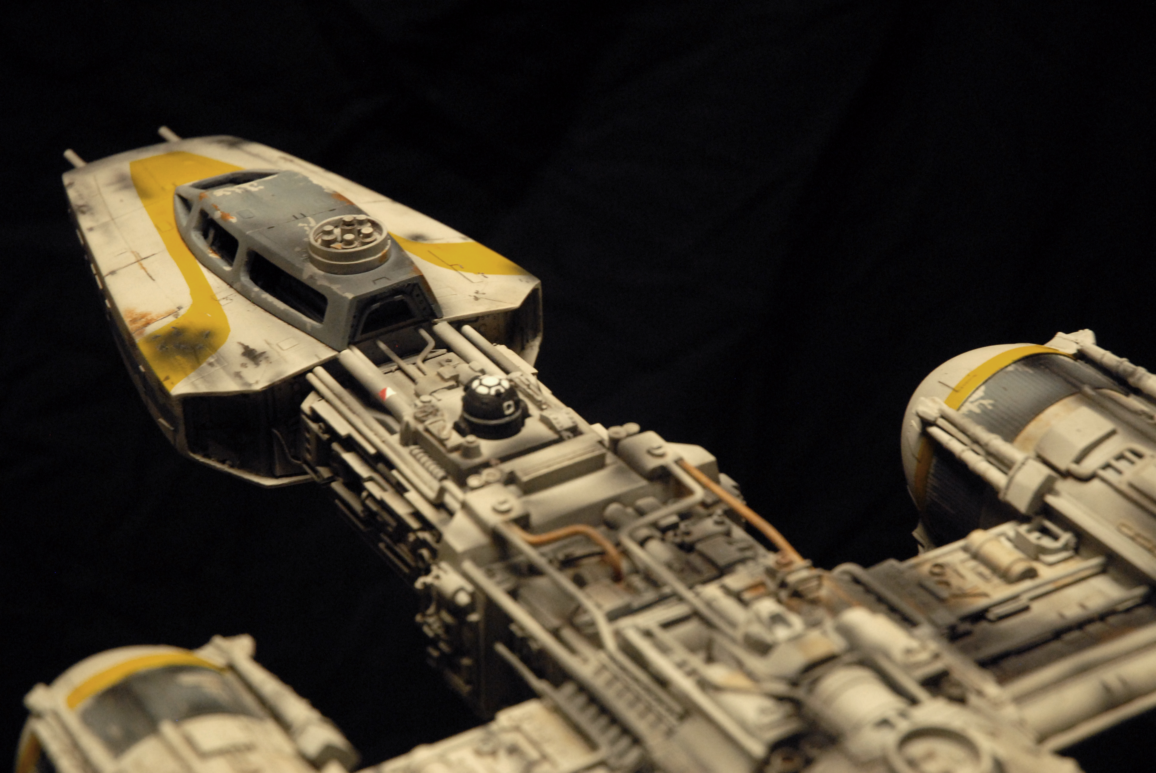

I found this kit to be a great starting point for creating my version of Gold Leader. There were some things I wanted to add and change to look more like Gold Leader. No, every piece is not exactly like the filming miniature, but I did add quite a few that are. The most noticeable changes I made from the original kit were adding some width to the rear section of the head to look more triangular like the original. This required me to add styrene and re due the panel lines and greablees.
I also shortened the neck a little and made it skinnier to look more like the filming miniature. This is easiest to see from above.

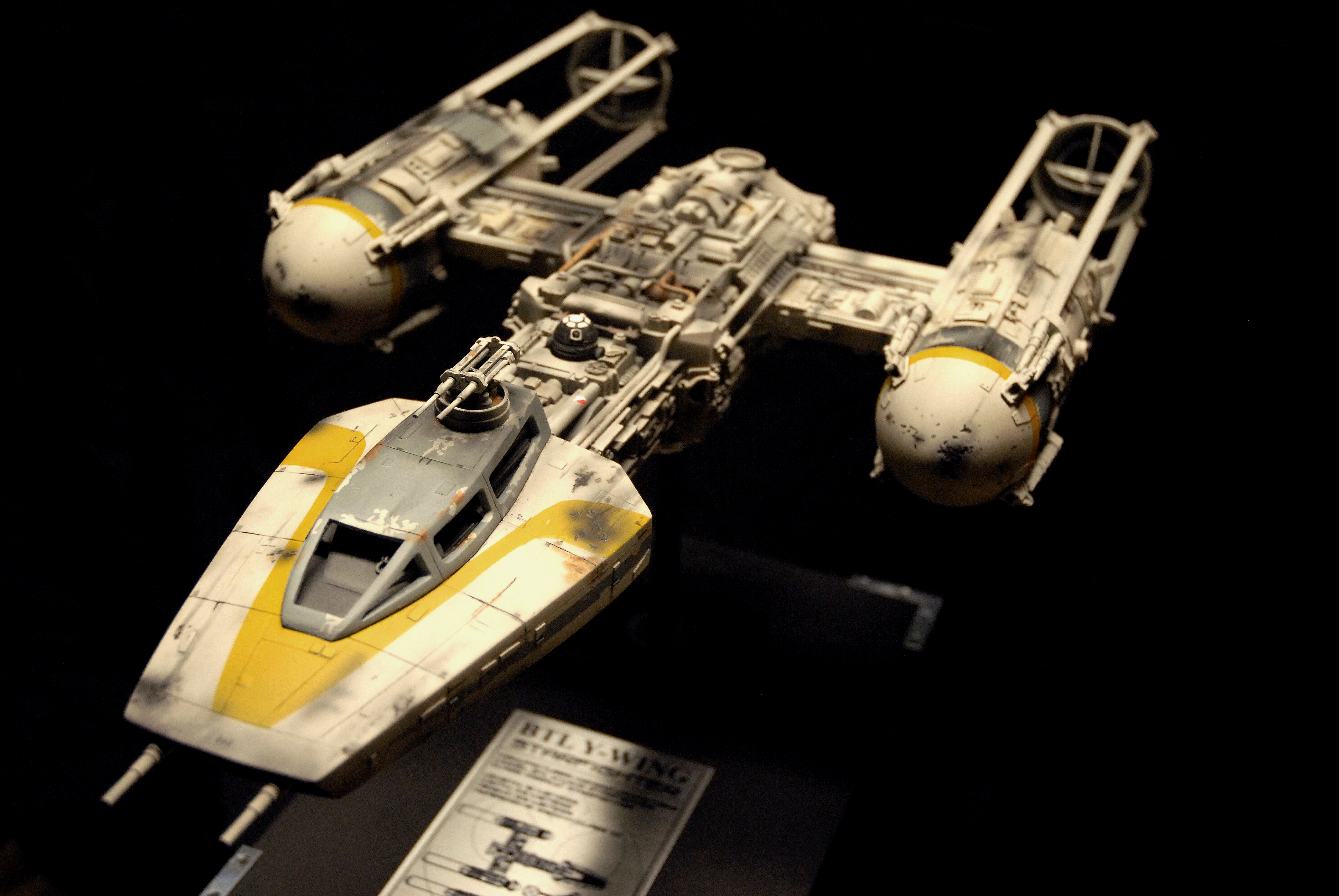

These photos are of the finished bird. They are a little more yellowish and saturated than it actually looks because my sinc chord for my photo strobe lights was not working and I had to use what I had

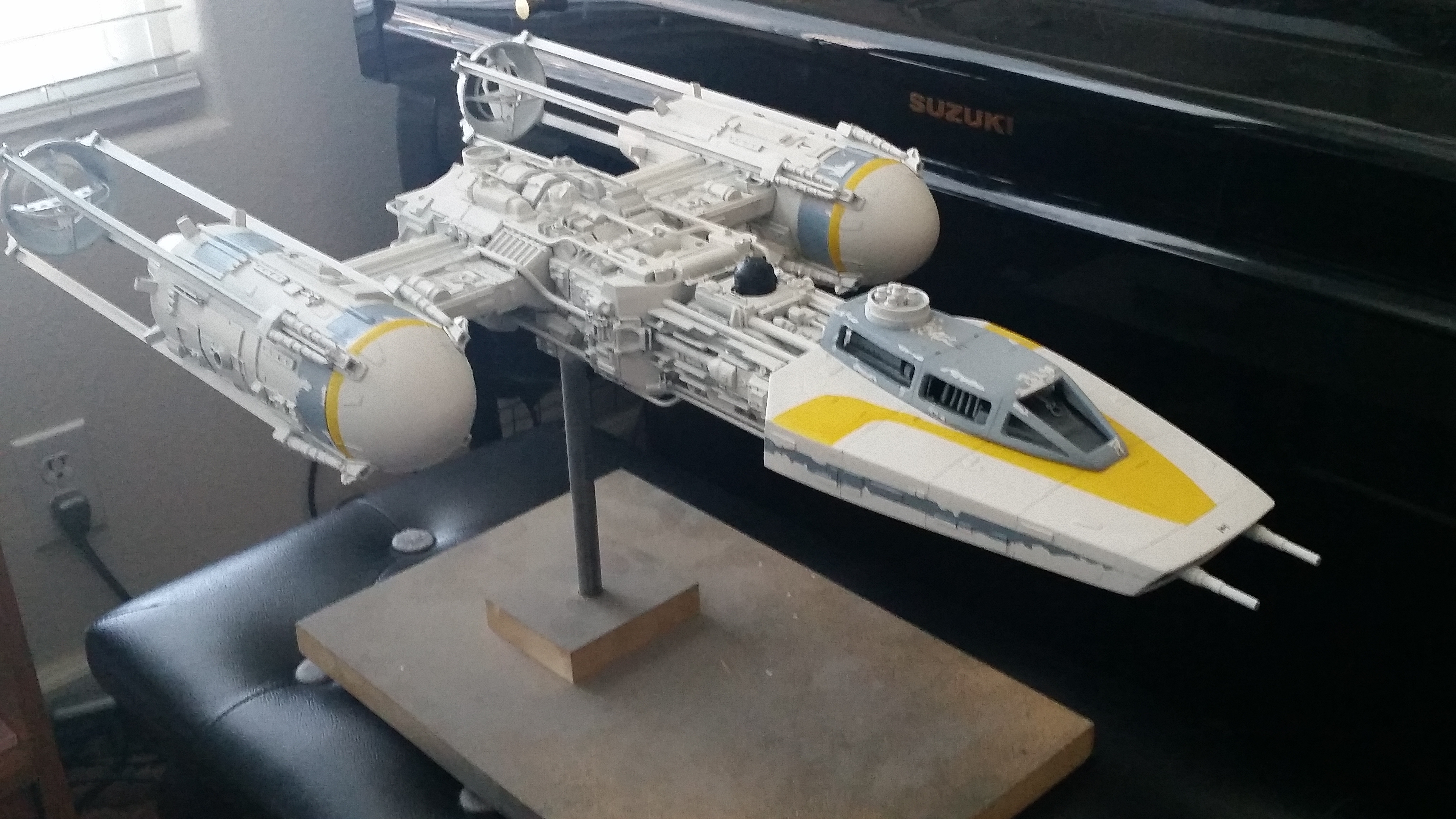

Thanks! I really appreciate that. Painting is my favorite part of model making. I start off with a dark primer, usually a flat black krylon primer for plastic. I really make sure I get the primer paint in the scribed lines and recesses of the model. this will help the detail pop later. This particular model I used Tamiya Insignia White as my base coat on top of the primer. I've heard guys say that insignia white is too cold or grey, but I find if I apply multiple coats it warms the color up. I will also give it a light, light spray of my airbrush of a mix of deck tan and white to further warm it up on the flat panels. I then added the yellow stripes with the airbrush with Testors daisy yellow. Again the more coats the darker the yellow gets. I used Tamiay Haze Grey for the cockpit canopy and the grey on the engines. All my chips in the paint are a combination of using liquid mask and me beating it up with the Dremel after all the base colors are down. Before the weathering process began it looked like this.
Ill post more later.

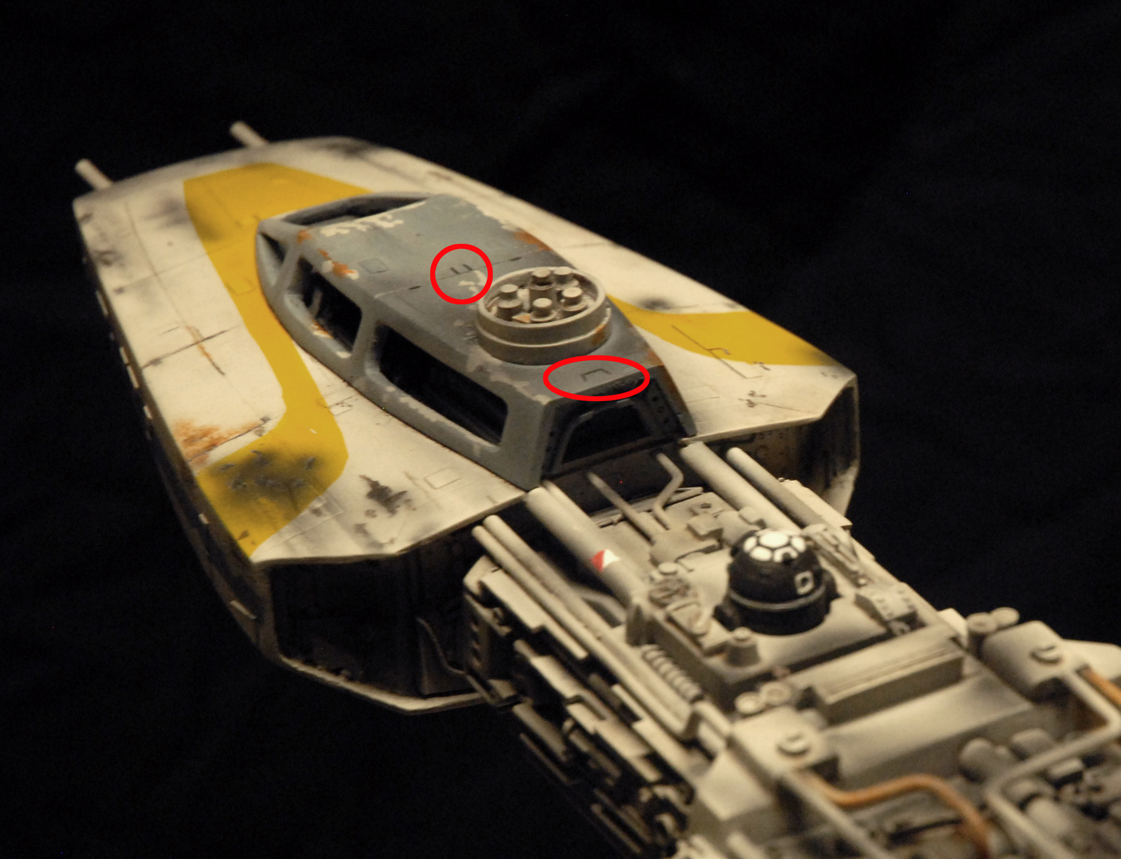

For weathering I do a combination of the dremel, brown and black washes, airbrushing, oil paints (because they go on beautifully), and pastels (for the streaks and grime). It's all about the layers of each to make the weathering look good and natural. Don't try and do it all in one night. I even will use a sharpie and ruler to draw in lines and marks like these:
