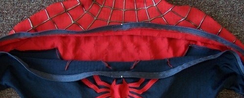

Thanks Luna. This is really interesting because I am in the process of repairing a suit with a zipper problem. The problem - it was not hidden. More like hideous!
Not to mention there was no stretch across the back when reaching outwards. See photo. ebay Spidey (5) - Copy.jpg
So I had a local seamstress remove them and sew it back up. I asked her to put in 1 hidden zipper across the bottom of the belt line meeting in the right hip with another hidden coming down from the armpit (L-shaped); Essentially a modified U. She tells me that wont work because the hidden zipper is not open on one end. Likewise cannot be guided on like a regular zipper on a jacket. And that would effectively create a point of cloth attachment making it 2 circles. Not sure that makes sense.
Therein lies my other issue and question. Locally these hidden zippers can be found in max lengths of only 24". That leaves about 22" to get into the opening. Are there longer variations? Is she correct?
Any help would be appreciated. I have been reading for weeks on what is best and it isn't clear to me how this can be done.
