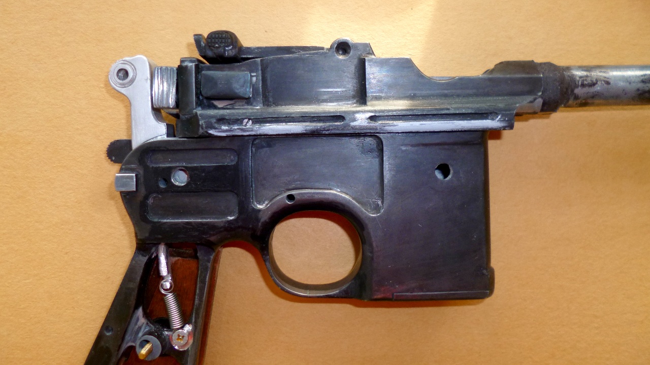

Denix mods
I have had a resin-cast of an MGC for many years, and I found it to be a great reference for the dimensions - although many details differ from the real Mauser C96. Because it is a resin-cast, it is a little bit smaller than a real MGC.
I think the smaller size has been to my advantage though because where the Denix is smaller than the real thing, I found that the shrunk cast
seem to match those dimensions quite well.
Compared to the real thing, the Denix Mauser has features too far back: cutouts, trigger hole and upper
receiver. The biggest mod has been moving those forward. This has involved both cutting and filling.

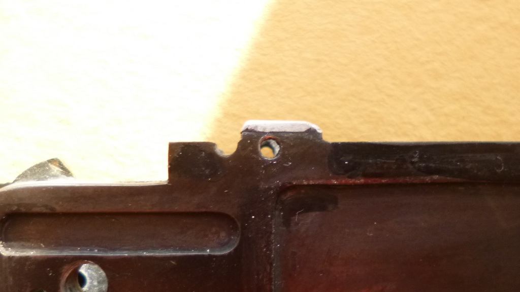

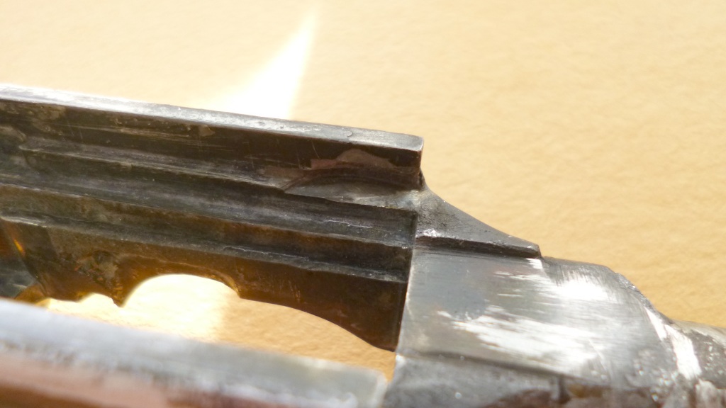

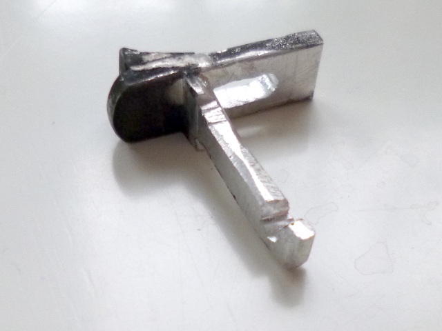

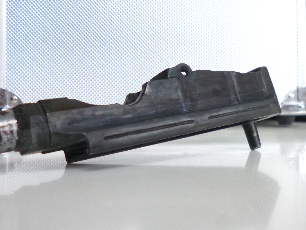

Slide moved forward 5 mm and down a mm.
On a real Mauser C96 the "slide" (upper receiver) and "frame" (lower receiver) are slid together on rails. The slide even moves a tiny bit when the gun is fired.
Because the Denix is cast metal, it does not have rails. There is only the tip of the rails left, for show - the part that protrudes in the front, and on that is a very visible screw that holds the two parts together. In the back, the slide and frame are held together with two short pins force-fitted in there. There is also a plate inside in-between the slide and the frame which the bolt is supposed to slide on.
The holes in the locking pin in the frame are on bumps that are supposed to fit in recesses in the bottom of the slide.
To make new bumps, I epoxied in aluminium L-brackets as reinforcement that I cut flush. Then I drilled and tapped
new holes to fit a bolt.
Instead of two pins, I opted for one long bolt made from a threaded rod with a slot at one end for a flat screwdriver.
I filled the hole on the left side of the slide. I also had to mill away some inside the slide and cut the sliding-plate into two to make it all fit.
I attached the rear part of the sliding-plate permanently to the back of the upper receiver and filled that to make it more accurate -- on the real Mauser that is one part with a large hole.
At the front, I removed the screw and filled in the holes for it.
I cut the start of the channels into the slide and let the frame catch into that. This means that I don't need the screw in the front any more
to keep it together.
![channel.jpg channel.jpg](https://therpf-f28a.kxcdn.com/forums/data/attachments/312/312475-687259025d573cfa702086713c7fb623.jpg)
![newbolthole.jpg newbolthole.jpg](https://therpf-f28a.kxcdn.com/forums/data/attachments/312/312476-3577afb2c1d4d73dbb44464204502fb0.jpg)
If I were to do this again, I would try to put in the effort of making full rails. Mill the channels in the slide, and build rails on the lower frame with aluminium L-bracket.

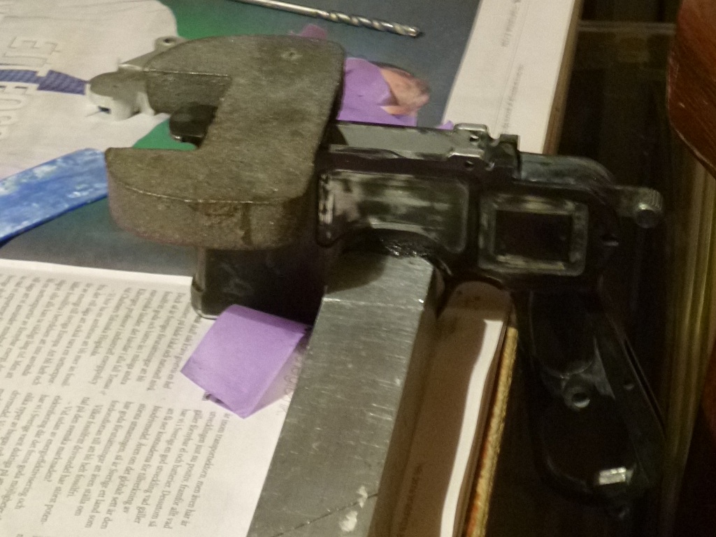

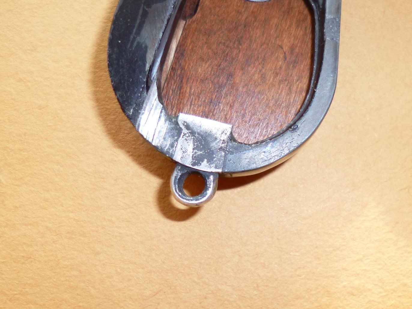

Trigger finger hole moved forward
- Cutting the base of the trigger guard and bending it. Oops, it broke.. Epoxied back in.
Apparently the Zamak alloy that the Denix was cast in is very brittle.
- Filed away material in the front
- Filled.
![benttriggerguard.jpg benttriggerguard.jpg](https://therpf-f28a.kxcdn.com/forums/data/attachments/312/312477-7502a0fd0c4f65daef3d84f2d8f6fe0c.jpg)
The shape of the hole is not that easy to do by eye. I have reshaped it many times.
Eventually I found ways to visualize the hole and make sure that the ceiling of the hole is flat.
The top and bottom of the hole should be flat, and the top should be precisely 3 cm above the plate, so what I did was that I applied epoxy paste and let it cure sitting against a part protruding from a piece of square tubing that is 3 cm wide.
The square tubing was taped so as to not stick.
I visualized the shape of the hole as two ellipses where each one's origin is the other's apex.
I drew the shape on the computer, glued it to cardboard and cut it out to use as a sight-template for filing the curvature
of the hole.
![flattriggerholeceiling.jpg flattriggerholeceiling.jpg](https://therpf-f28a.kxcdn.com/forums/data/attachments/312/312481-27961c62833caa3dcdd89193d2f63474.jpg)
- Filled.
of the hole.
